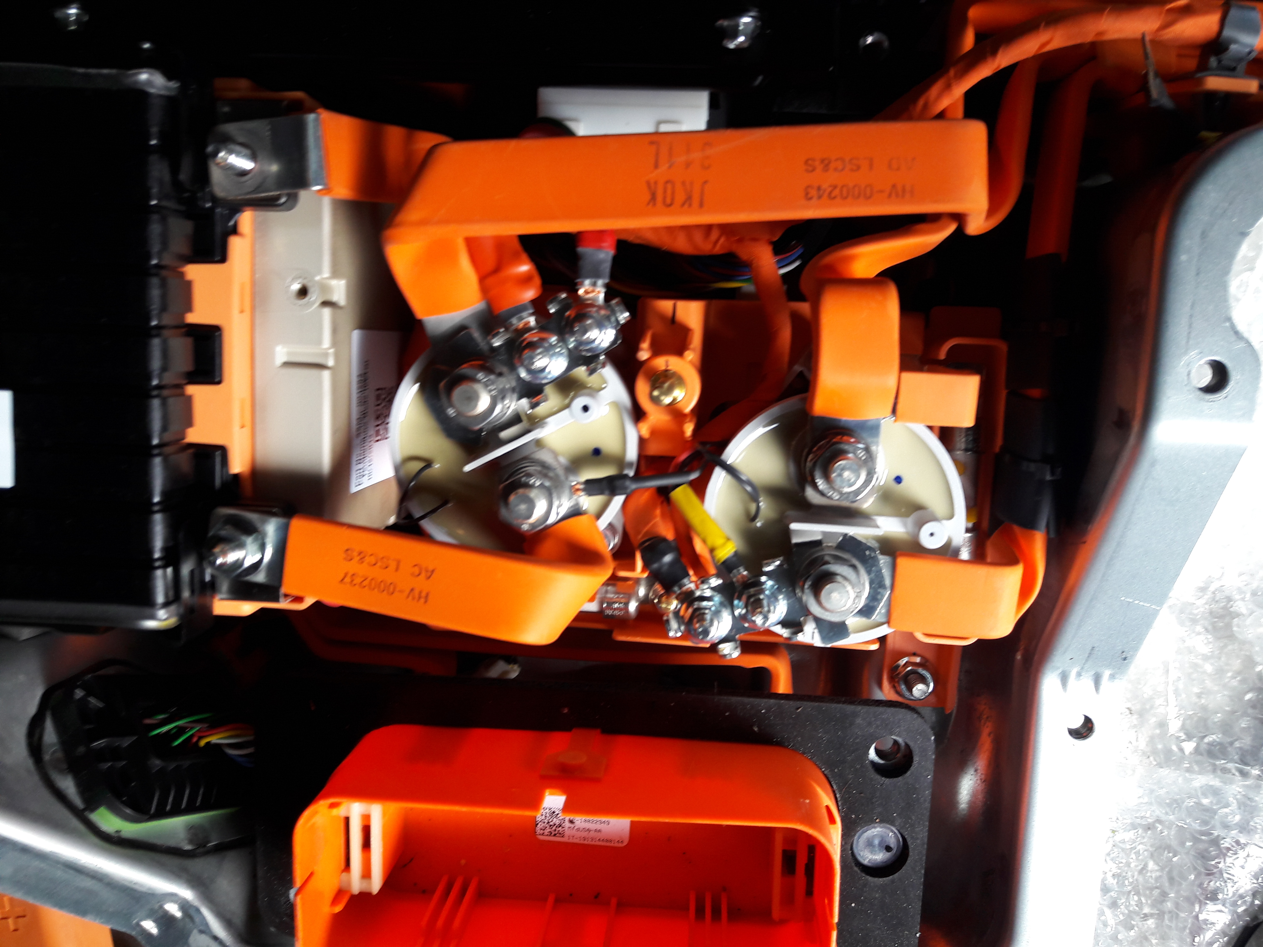

Hi! There are two orange cables between the battery and inverter. The electricity who flow through them is AC or DC?

I got hold of one of these battery’s from a V60 hybrid.
And i would like to use it in a EV-conversion to put in an old Volvo 940.
I found a connector that fitted on aliexpress: https://vi.aliexpress.com/item/10050057 ... pt=glo2vnm
The pinout i looked in the wiring diagram and i think it is right, see picture.
I got some CAN messages when i set 12V on pin 1+3+4.
HS-CAN 500kbit

So i wonder if someone have more info on the CAN protocol, how to close contactors, and read voltage and temp, directly from the BMS?
And does anyone know how precharge is done, in the pictures of the internals i only see 2 contactors?

there are 3 smaller contractors under the big ones.
and there are 2 precharge resistors in there as well.
I don't know how there are controlled. assume via CAN
