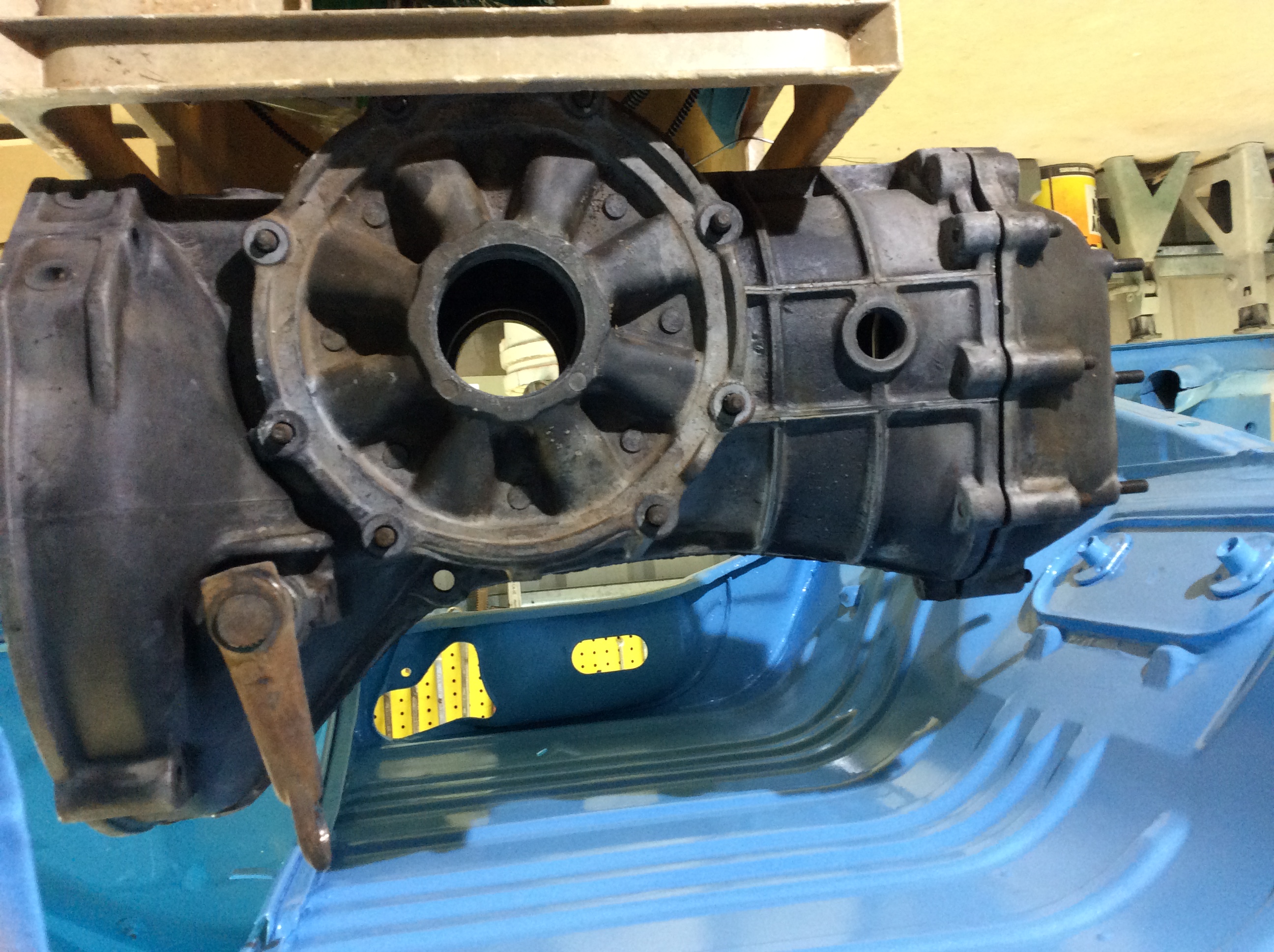

Hi, I’m new here and not quite ready to start my own thread. I have a 72 super beetle in pieces and I’m considering replacing the original traction system with an MGR. In the photo the gearbox is as close to its original position as the cardboard box will allow.
If it doesn’t fit (maybe with a slight tilt to the front?) I will look at the Outlander rear motor unless someone has cracked the addition of a cooling system and/or oil cooler/pump system to run the MGR in reverse.
Thanks in advance,
Chris
PS if I click on the image it turns the right way up! What am I doing wrong?
I’m wondering if one of you kind souls could run a tape measure over an MGR and tell me if it will fit running in it’s original direction? The axle centres are approx 250mm below the floor and 125mm in front of the firewall leaving around 355mm clearance to the front.If it doesn’t fit (maybe with a slight tilt to the front?) I will look at the Outlander rear motor unless someone has cracked the addition of a cooling system and/or oil cooler/pump system to run the MGR in reverse.
Thanks in advance,
Chris

The axle c/l to top of MGR = 7" (180mm) and to the front edge of the mount casting 14" (355mm). Looks like it will fit just fine
If I find cooling is needed, I will just install a low pressure BOSCH (or similar) fuel pump to circulate the oil thru an external cooler. But, these motors will tolerate temps well over 150*C, so am hopeful that added measure will not be needed.
The one measurement I do not have is the flange-to-flange width of the stock VW transmission.

Thanks for the prompt reply Zookeeper. I’m following your progress with interest as we look to be approaching a similar project from opposite ends! My gearbox is in a million pieces so I am not sure that I can work out exactly how big the flange to flange distance is but I will see if I can assemble enough of it to get a measurement.
I have downloaded a working drawing and images of an adaptor plate that someone created to join a diff to VW axles but I failed to record the source and details of the diff involved. I will have a search this evening after trying to find a suitable MGR downunder.
Chris
I managed to put together enough pieces from my diff jigsaw to get a pretty good idea of the distance between the flanges. It’s a 72 super beetle 112 2890 748 if that is the same as the square backs.
Looks like it’s about 258 overall but I can’t guarantee the accuracy as there may be spacers missing from the assembly.
Chris

Thanks Chris, that measurement is really helpful! The MGR is about 280, so shortening will be required
My current plan to join Toyota & VW is to mount the flanges in a lathe face-to-face, true them up and start melting metal!

Anyone know if there is anything holding the differential side gear shafts into the diff casing on the MGR other than the bearings and seals? I don’t particularly want to split the case open just to find out.
To reuse my original VW CV joints/axles I need to loose 8mm per side and I’m thinking that cutting back the flange with the 4 studs and welding a flat plate to the stub with threaded holes to match the VW would be better than trying to shorten the shaft.
Chris
Chris
Re: Toyota MGR Transaxle - Alternative Orientations?
They typically have keepers, no case-splitting needed, just "Excessive Force".
Ha! That is similar to what the VW guy told me to do! His suggestion was to remove the studs, chuck both the Toyota and VW parts up in a lathe, get them dialed in and just weld them. I suppose, material permitting, one could take off the needed material from the flange and VW axle cup.To reuse my original VW CV joints/axles I need to loose 8mm per side and I’m thinking that cutting back the flange with the 4 studs and welding a flat plate to the stub with threaded holes to match the VW would be better than trying to shorten the shaft.
Chris
There is also the potential to use shorter aircooled shafts, I think there are like 4 common lengths.
Thanks for that, My neighbour just suggested that as I was not using the VW diff I could cut the stubs off the back and weld them straight to the Lexus stubs and not have to bother with drilling and tapping the steel plate. I had a look at a table of VW axle lengths but saw that many of them had the 100mm flange instead of the 6 hole 90mm. So many options!
Before I do any cutting I need the MGR in position on the floor plan to see if it fit in between the fork or if it will be offset in which case I will need uneven shafts....
Chris
Chris

I THINK the shaft splines are the same so 100mm and 90mm CV joints are interchangeable on the driveshafts.Ctwidle wrote: ↑Tue Mar 02, 2021 1:14 am Thanks for that, My neighbour just suggested that as I was not using the VW diff I could cut the stubs off the back and weld them straight to the Lexus stubs and not have to bother with drilling and tapping the steel plate. I had a look at a table of VW axle lengths but saw that many of them had the 100mm flange instead of the 6 hole 90mm. So many options!
