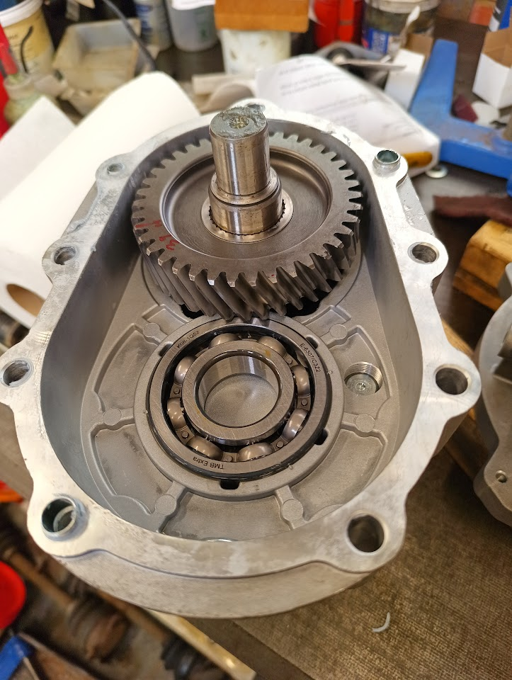

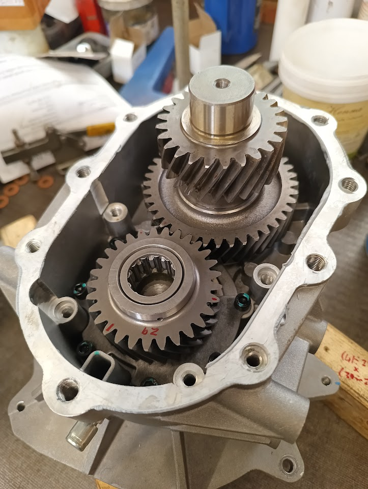

Do you feel under-whelmed witch parting lost of £££ for that?SciroccoEV wrote: ↑Thu Mar 21, 2024 2:28 pm Some pictures of the Felten (Zero EV) rwd gearbox internals.

I found some more data on the torque rating of this gearbox.
It's 350Nm input and 600Nm output.
For the 2.2:1 ratio version, that means that the output torque will be the limitation.
