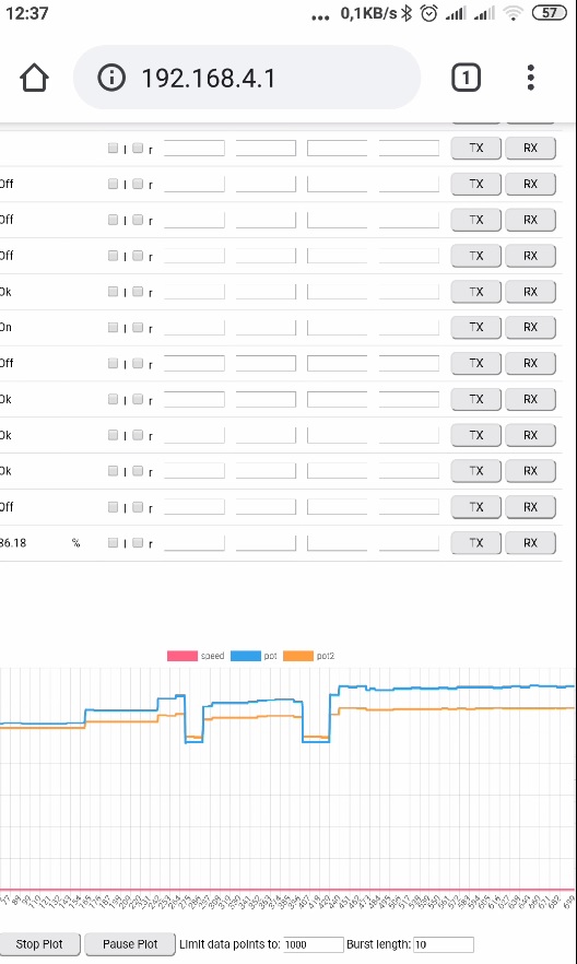

I cleaned the rev2 board with nitro thinner and dried it i uploaded new firmware and there were no more OC trips. I went and checked for errors and i got several warnings. It seems throttle signal was falling out. I tried to record the throttle movement very slowly and i got attached pic.
Why do you think that would happen?

arber333 wrote: Fri Mar 06, 2020 2:22 pm several warnings. It seems throttle signal was falling out. I tried to record the throttle movement very slowly and i got attached pic.
Hmm, bad power connection to throttle? Because both channels show the same drop

johu wrote: Fri Mar 06, 2020 5:58 pm Hmm, bad power connection to throttle? Because both channels show the same drop
I think i need to buy a Prius throttle pedal connector. I thought i could get away with small 3mm fastons but i guess they are somehow loosened up on the header.
Lesson learned again; "car is high vibration enviroment!" we need to designaccordingly.
