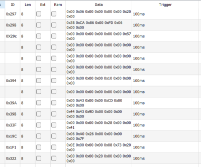

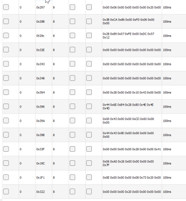

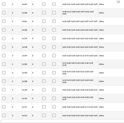

For the charging you need these frames:
Then to reset you need to change that to this:
It is mostly just 297, and 29C that change I think. In here is also the DC-DC messages.

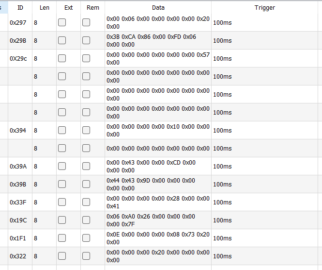

Had another play with the charger today.
Managed to cut down the messages required for charging to the following:
I have yet to move this to the zombie test module to confirm. But it's looking promising so far.
I also think I have found the current limit message in 0x29C, the last two bytes.

johu wrote: Sun Jun 08, 2025 8:24 pm The one that reads 0x57? So 87 decimal. Does it charge with 8.7A right now?
Or 0x5700 22272 mA?
I have some rather vague data from my notes. At the time I could only get AC current as that was easily read from the socket meter.
When everything else was 00, byte 6 would have the following effect on the charge current.
0x47 is 1 amp AC, 0x48 is 2 amps AC, 0x49 is at least 8 amps AC as it maxed out the 2kW EVSE I was charging from at the time. Changing byte 7 did have some smaller effects, but I couldn't get anything uniform.
Damien has suggested it's a value spread across bytes 6 and 7 and I think he is correct. I just need to do some more testing to verify. I'll also try to get some DC amp data as well.
With it set to 0x57 as it has been so far for testing it would max out the MG charger from a 7kW wall EVSE.
