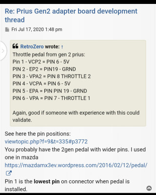

RetroZero wrote: Tue Jun 17, 2025 7:53 pm Is this what you used as reference?
viewtopic.php?p=14153#p14153
I connected my resolver the way Damien did in the tutorial video. Is it correct or should I change to
pin 1 = yellow ( enc b)
pin 2= green and brown (sin a and cos a)
pin 3= red ( enc a)
pin 4 = black r1
pin 5 = white r2
For excitation I have blue and pink not black and white.

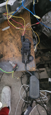

I changed my resolver connection today and connected it as pair discussed in the screenshot attached below.
I tested first without it connected and I got the same results of having the Delta connected light bulbs connected on the inverters three phase output light up and turn off again continuously. The inverter goes into run mode when I set udcsw to 0 and this blinking behavior then starts even before I put any numbers in the manualid. Please see video attached in comment above. On angle when the light bulbs started blinking an angle of 63 degrees showed up even without the resolver connected.
Then after I connected the resolver and shortly after setting udcsw to 0, the light bulbs turn on and they stay lit. This time around they don't blink but they say lit. When testing with a scope the PWM wave shows but it doesn't move. It stays in one position. On angle under spot values the angle was 239 degrees but kept changing by a value of 1 either increasing or decreasing when I pressed refresh even without turning the drive shaft.
I went on to connect the throttle pedal also with the discussed instructions on the screenshot below and tested with both the resolver and the pedal connected. Now the light bulbs didn't turn on and the inverter didn't go to Runmode it stay off even after setting udcsw to 0. While on previous tests I set udcsw to 0 because that was the only way I could get the inverter to go Runmode because even with manual start turned on, the inverter would still be on opmode> OFF.

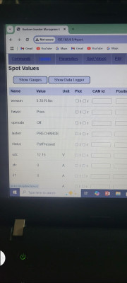

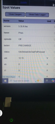

When I had the throttle connected STATUS on spot values first showed "PotPressed" and on another test it said "UdcBelowUdcSw|PotPressed" .
Please see attached pictures.

Just to be sure.
You have 2 seperate batteries. 1 for 12v circuit, & another for High Voltage circuit. Can you check that they are well charged.
In spot values, please report back on UDC voltage & Pot1/Pot2.
The pedal should read 0 , if not, it requires setting. I think there is a set-up in the adapter board thread. Once set up correctly, check by pressing the pedal all the way and verify you have 100%

Below I've attached my entire spot values, please go through and check for all the settings you want to see pot1 and pot2 and any other that are important for testinh stage.. Also please check for faults that might appear.
I'm planning on connecting a high Amp 12v battery for my next test to my HV supply. On UDC now it says 11.87v.
I forgot to mention that now that I have connected both the resolver and the throttle, I cannot get the inverter to go on manualRun. Even after setting udcsw to 0, It stays off.

@voti: the screenshots are hard to read. Please just attach the contents of http://192.168.4.1/cmd?cmd=json instead
UdcBelowUdcSw means bus voltage (udc) is smaller than udcsw . So at this point it cannot have been at 0

I pressed my pedal and Potnom remained 0% all the time. What changed was the values on pot1 and pot2 the valus kept increasing until they reached 4095 when fully pressed. I could only see the changes of this values by refreshing everything I press harder and harder.
I also changed start and add it a switch rather than having it hooked to 12v all the time.
I also put in a fully charged 12v car battery for my HV input and disconnected the 55w ligjt connected in series with the positive line of the battery.
I still couldn't get the inverter to go into Runmode. I even disconnected the resolver cable but still not going for Runmode. Does it mean my pedal is not correctly configured because like I said, potnom didn't show any reading when the pedal was pressed.?
Below I've attached json files.

The pedal is not configured correctly. If the dump contains the "not pressed" value then potmin must be 2090. Also you will a series resistor (viewtopic.php?t=5075) but that is for later.
For the current test you can also disconnect it

OK. So I swapped pin 3 and 6 and happened to might have happened to get it right for the pedal. I disconnected my resolver because I think that's where the problem is but I'll get to that shorty. I had my inverter in Runmode and the Delta connected light bulbs lit up. When I pressed the pedal, they started blinking and the motor jerked like it did prior. Below I've attached a link to a video of this whole process.
By the way potnom was always on 0 % throught out this test. Is that OK?
Coming to the resolver. Each time I connect it, everything just stops working, the light bulbs turn on but the pedal then stops working and when I press it nothing happens.
I disconnected the HV and tested pins 1 to 5 which are the resolver pins and tested for AC waveforms. I've attached pictures below of these waveforms for each pin. I've also attached a picture of the pins configuration that i also found on other topics.
Please remember that the only parameters I'm putting In are changing udcsw to 0, DefaultForward and adding values on manualid only. Should I still set ocurlim -1 even on the new FOC firmwares updated version that i'm using now ?
