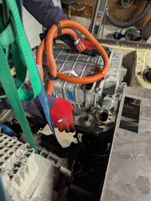

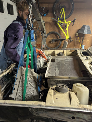

I couldn't get the PDM to fit in CAD so i went and tried to fit it in the drivers side front corner in real life and it didn't fit. So i chopped off some random little brackets and it kinda fit, but not with the giant radiator in. Next to do: see if i can get back with like a half size radiator for cooling a 2013 leaf stack with the 80kw inverter. Then going to consider rotating the motor and inverter about the transmission center to make more room for the PDM. That's what's shown below, and the most promising orientation for the PDM is fully upside down. After viewing Johannes' teardown and noticing the cooling channels are all planar i'm not concerned about air bubbles or anything regarding orientation of the PDM. It also looks like both the bottom and top covers of the PDM are oversized and maybe i'll consider making smaller custom covers for the PDM to do a honey-i-shrunk-the-PDM!

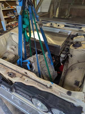

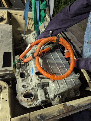

since the inverter is not centered over the motor, it turns out tipping it to the right meant i could rotate it all the way to 90deg if i wanted, and create way more room for the PDM on the left side. Last night i did a test fit with the prototype battery box in place and it fits!

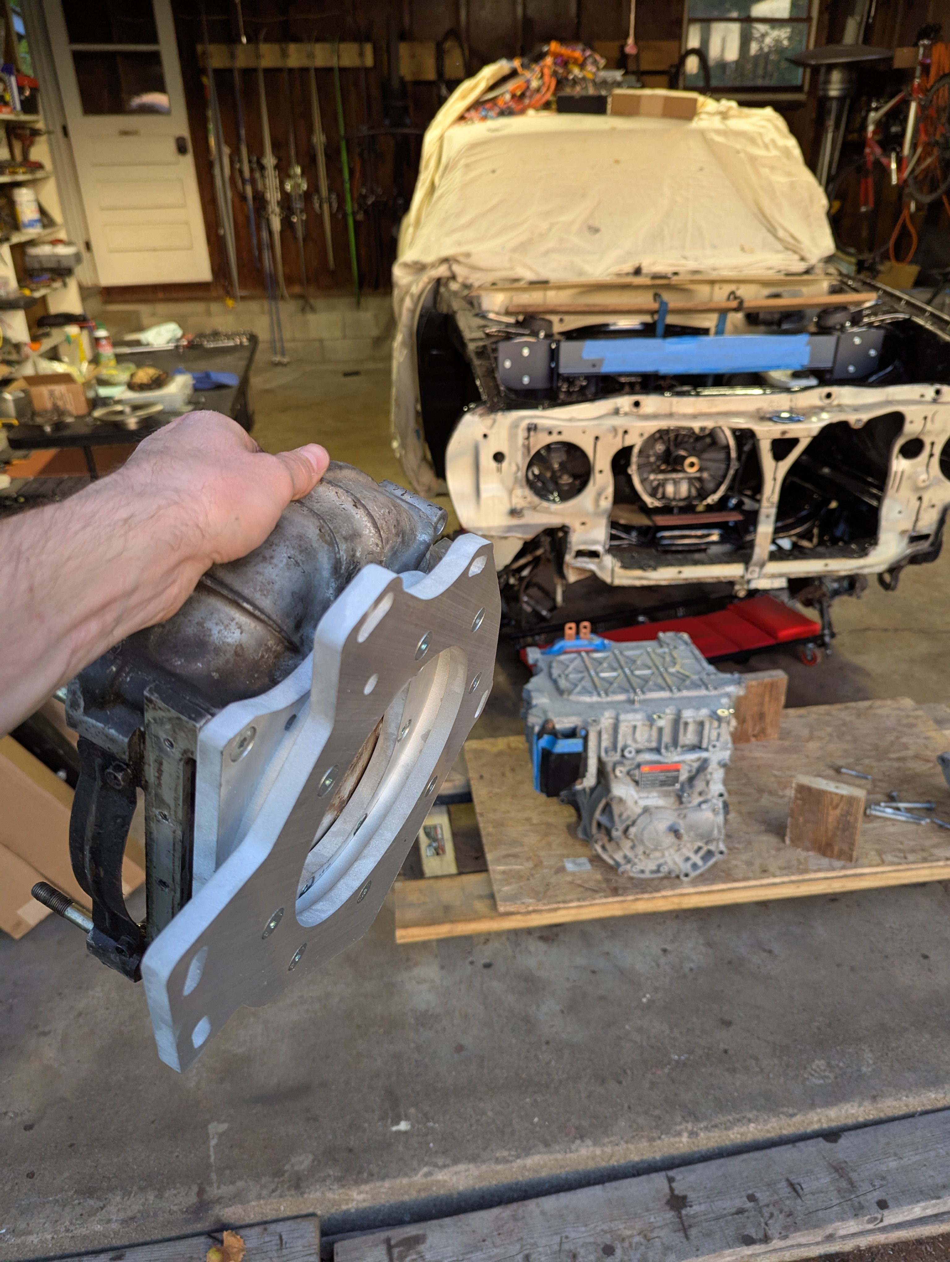

This means my adaptor plates need a rotated hole pattern. It looks like i could add a rotated set of holes for the NEMA B-face pattern in order to achieve this with you adaptor plates, @bratitude?
I haven't found any other conversions with the leaf motor tipped over like this. and tipping it this way puts the coolant ports at the bottom, which creates the possibility of bubbles trapped in the cooling channels in the inverter. i'm willing to take on this risk and monitor inverter and motor temps, and if there's a problem i'll replace the PDM with a smaller DCDC and OBC so i can rotate the motor back to vertical.
now that i've confirmed i can fit 1 battery 4-pack under the hood i can carry on with designing the remaining 3x 4-packs for under the chassis!
Yup! Beautie of the nema pattern is you can clock it any angle you like

i've found conflicting info on whether or not the EA71 bellhousing has the same mounting pattern as the EA81, mostly searching through old engine/transmission swap threads on ultimate subaru message board. here is my hand measurements of the bellhousing i have, and i'm hoping i can get the measurements from the EA81 adaptor plate to see if the holes line up. This was made pretty hastily just to capture the rough hole pattern. i haven't found any markings on the transmission that would indicate what kind i have.
Posts: 997
Has thanked: 174 times
Been thanked: 359 times
Re: [WIP] 1979 Subaru Wagon: Leaf Stack,Zomb,Ioniq 5 1/2 pack
ea81_nema.PDF
(11.13 KiB) Downloaded 10 times
print at scale
unfortunately its not the same pattern
