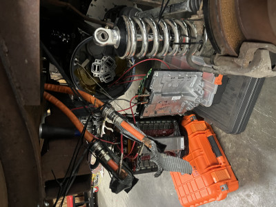

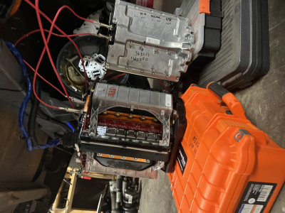

Well I'm back around to a loose connection. I think. I set up the inverter sitting on a box with jumpers to HV and the motor, and with a base phase subbed in for one of the Sport phases. The plan was to keep switching this around in place of each phase, with hope that it would work in place of one phase, and that would tell me which Sport phase had a bad gate driver.
[WARNING] Dumb hot rodder alert, do not try this at home. (go over to a friend's house) So I set that all up, powered things up, and it worked! What luck, the first phase I tested was the bad one!?!? Then I remembered its never that easy with this car. I disconnected the base phase, and using the same jumper set up, connected with all the sport phases, and it worked! Which means it wasn't a bad gate driver. The only thing I can think is that something is loose. I did let it sit for almost an hour and tried again, just to make sure, and it still worked.
I did notice a capacitor on a gate that wasn't completely solid, and some of the connections to the brain board seemed ok, but a little loose. What I decided to do was use some potting compound on the capacitors on all 3 gates, and then use some UV setting superglue to permanently attach the wiring harness to the brain board. If I ever have to swap the brain board, I have a spare wiring harness. I'm going to let that all set overnight, and try reinstalling in the car tomorrow or Tuesday.if it doesn't work again, I'm going to start throwing tools.

- Tried swapping out the current sensor, still faulting.
- Tried swapping out the dissipation board, still faulting.
- Removed the inverter from the car. Performed a diode test on each phase, all pass.
- Tried using jumpers to swap in a known good phase and test with the inverter on the ground, Fault did not occur.
- Used the jumpers to connect the Sport inverter, with nothing changed from when it was previously faulting, and the Fault did not occur.
- Glued a few things in place that might have been loose.
- Installed inverter in car.
- Tested on jack stands, and test drove, no faults.
- Parked for 24 hours.
- Went to test again, and the fault occurred.
12V supply voltage or amperage
current sensor
dissipation circuit
OI board (was not doing this with the previous base/sport hybrid inverter)
At least one of the Sport phases (as it was in the base/sport hybrid)
An actual failure of any IGBTs - all phases pass a diode test on the bench.
What I Think It Could Be
Based on the fact the phases pass a diode test, don't show an error light, and do in fact work sometimes, it seems to me there is some gate driver that isn't working 100% correct. I'm not sure why time is a factor, but it seems to be.
Next Steps
- I have already bought a "for parts" sport LDU from Ebay, but I'm not picking it up until next weekend. The idea would be to harvest a good phase or two and swap them into mine, and hopefully eliminate which phase has the bad gate driver?
- I think I will have time this weekend to test a few things. Of course, there is the chance that when I remove the case it magically starts working again. I have a couple of multimeters but I do not currently have an oscilloscope (I know, I know, it's been on the list to buy for a while. Someday I'll get one)
- What points should I test, and what should I be looking for?

I think I've narrowed it down to either the internal wiring harness or the OI board itself.
I picked up a whole "for parts" sport LDU, and it turned out that just the control board and 23 pin connector were damaged from a coolant leak. The phases tested out fine, so I swapped over the control board and wiring from the one that I've been troubleshooting. With it sitting on the ground next to the car, I got it all the way to PWM in gear, so I installed in the car. Before I put the case on, I tested, no good. I swapped out the 23 pin connector, worked! I cleaned up the wires, tested again, worked. Put the case back on, didn't work.
My suspicion is that there is a problem with the internal wiring harness on the phase connection that is directly behind the 23 pin connector.
I'll open it back up this week and see what I can figure out. Only challenge is that the phase wiring is what I glued into the OI board, so I'll have to see if I can disconnect that or if I'll have to get a new board. (I kind of knew gluing was dumb when I did it, and now I'm paying for it.)
The good news is that, if I'm right, I now have two full sets of good Sport phases!
