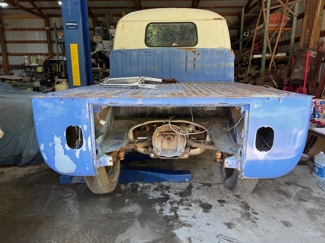

This is my new project. Finally wrapping up the '70 MGB Roadster - 2015 Leaf EM57 powered and we learned a lot!
So far just collecting parts.
● A new wire harness is on the way.
● We have the full stack Leaf EM57 motor already.
I am not sure it will fit but I am pretty sure that the Inverter and motor will.
● We just ordered a KIA EV6 / HYUNDAI Ioniq 5 EV 77KWH 800v battery.
New w/0 miles Came from cars damaged in transit.
We plan to drop the voltage in half placing half the 32 modules in parallel.
● Battery Storage
Under the bed where the gas tank is & under the rear bench seat. That is our working theory anyway.
● We plan on using the Brat VW adapter between the EM57 and the transmission.
● VW bus status.
Body panels that were rusted were replaced 5-10 years ago followed by a poor paint job.
Paint and body putty needs to be removed.
We are planning on stripping it (bead blasting) inside and out then sanding it and primed.
Followed by a new paint job before starting on the conversion.

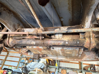

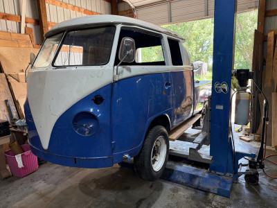

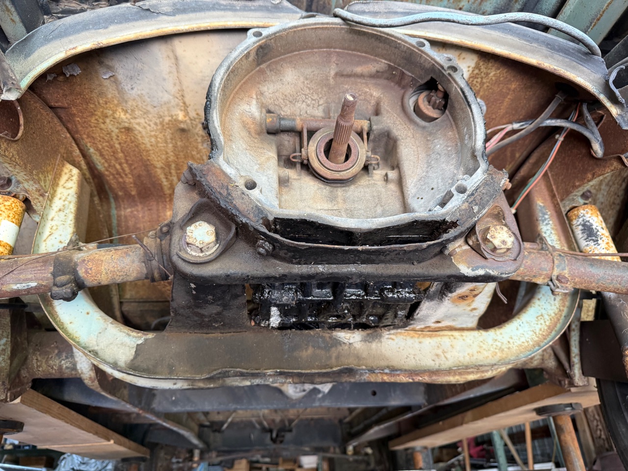

Now for some Pictures:
Rescuing the Transporter: The Battery The EM57

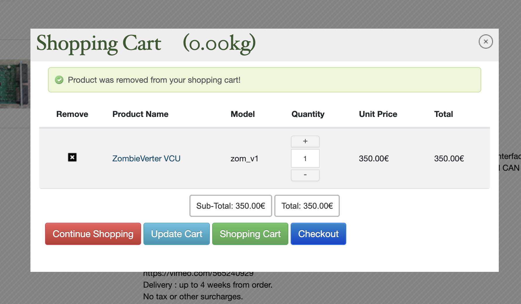

Re: '63 VW Transporter - EM57 Powered.
Well this is discouraging.
I tried to order the Zombieverter on http://www.evbmw.com/index.php/evbmw-webshop/vcu-boards
I get this message:
Shopping Cart
Your shopping cart is empty!
I get this message:
Shopping Cart

- Posts: 1845
- Has thanked: 89 times
- Been thanked: 481 times
It seems to be working for me. Pressing "Add to cart" and then "Checkout"
At which stage are you having issue? I notice you're not on the https site https://www.evbmw.com/index.php/evbmw-w ... vcu-boards this is likely your issue.
Thanks Bigpie!Bigpie wrote: ↑Wed Jun 11, 2025 1:08 pm It seems to be working for me. Pressing "Add to cart" and then "Checkout"
I used your link and it worked. Whoooo Whooooo! It's ordered!

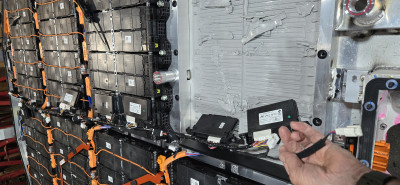

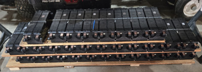

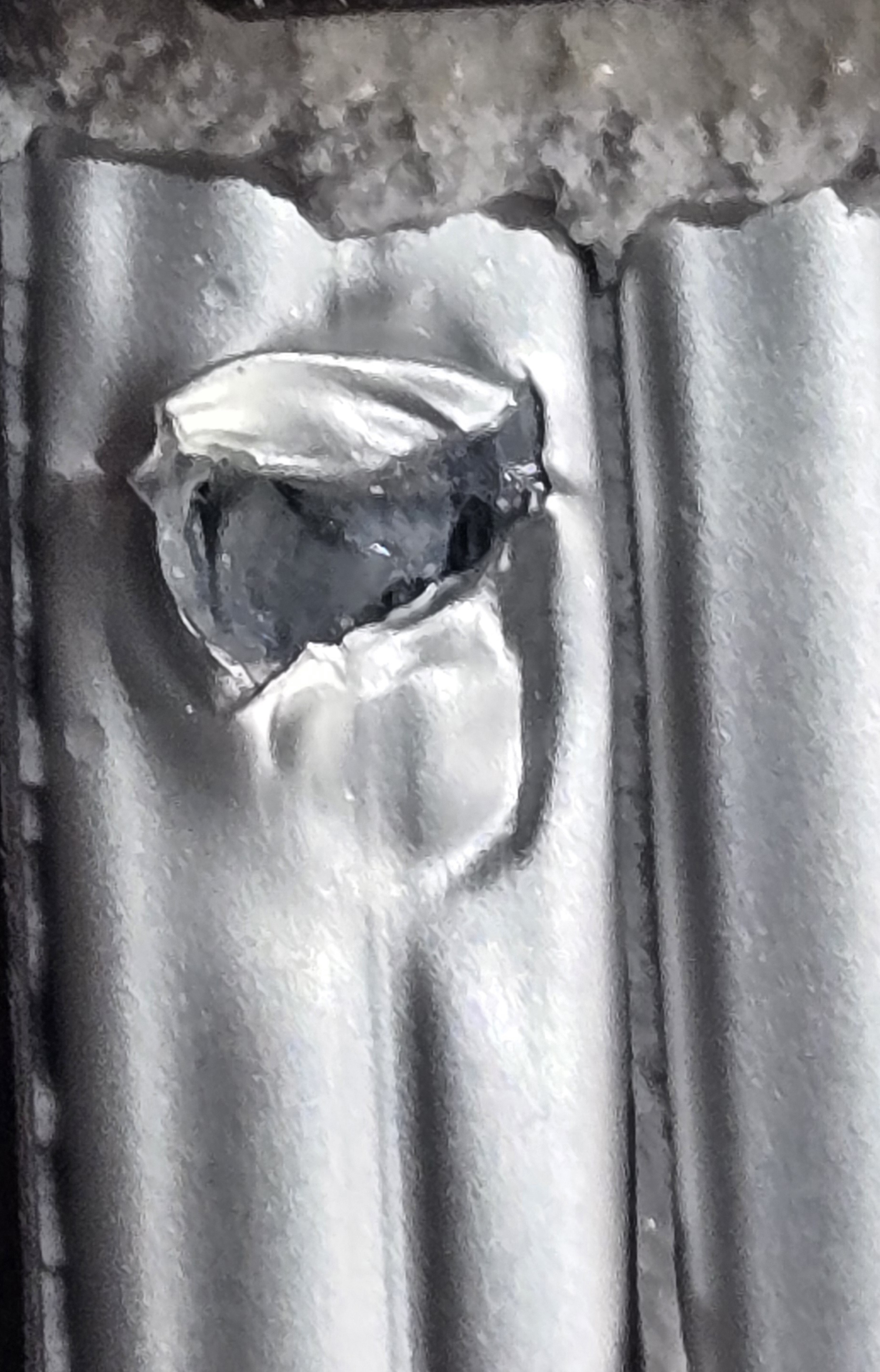

[WIP] '63 VW Transporter - EM57 Powered.
Got the Ioniq5 Battery disassembled.
It's actually a masterpiece of mechanical engineering!
My current thinking is 16 of the 32 modules (38.5KWH). But I will look at getting all 32 for 77 KWH. This would be preferred but will be substantially more difficult.

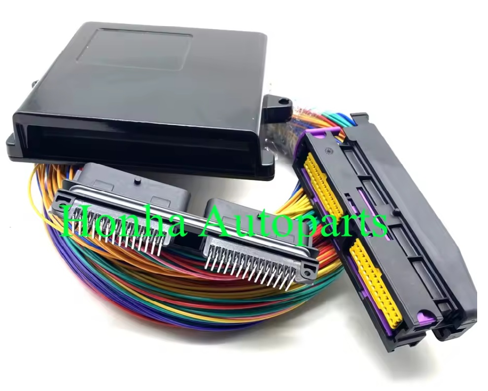

I found this on Alibaba. It has a GUI development application and has an optional STM32 processor available for the backside electronics that has a CAN bus interface.
https://www.alibaba.com/product-detail/ ... 57937.html $210 shipped from China.
I would be interested in peoples thoughts on this or other alternatives.
If I can get it working, I would be glad to share code.

Note with the battery modules, do not stack them on top of each other, the rivets will indent the pouch cells (as they are exposed on the bottom) and will damage them
i found this out the hard way... not by stacking but by scraping the thermal putty off with a pick. thought it was aluminum but turns out its very thin plastic. i might have put a tiny hole in the pouch and idk how to tell if i totalled the module by doing so.
- jerrykco
- Posts: 173
- Joined: Thu Dec 12, 2019 5:32 pm
- Location: United States, Colorado
- Has thanked: 223 times
- Been thanked: 38 times
I am restacking them with a sheet of plywood between them. Thanks for the heads-up!

- Bratitude
- Posts: 1080
- Location: Canada
- Has thanked: 222 times
- Been thanked: 413 times
Consider that module unsafe to use in a pack. If it has a tr event, the whole pack is going with itcajamatt wrote: ↑Fri Jun 27, 2025 4:32 pm i found this out the hard way... not by stacking but by scraping the thermal putty off with a pick. thought it was aluminum but turns out its very thin plastic. i might have put a tiny hole in the pouch and idk how to tell if i totalled the module by doing so.
Right, Tom.
This is only for storage on the floor of the shop and is temporary.
My build will include a custom aluminum battery box to be designed to fit under the back seat in the crew cab.
Storage in the shop and the damage to one of the modules, damn!
Progress update:
We cleaned up the shop area and made room for the VW. Got it moved into the shop after removing all the parts from the Ioniq 5 battery.
Next steps:
- Remove everything from the body of the VW.
- Strip it using a sand blaster and Green Diamond media
- Prime it with Roll-On Epoxy Primer from Eastwood
Then have it professionally painted.
In the mean time I will complete the Zombieverter (watchching Damien's Videos and reading instructions)
Build a battery box
Figure out how to mount the Leaf ( looking at how others did it).
And doing a bench test for spinning the motor.
Next steps:
Build a battery box

- Bratitude
- Posts: 1080
- Location: Canada
that sucks, you could possibly harvest the good cells from the module for other purposes. But I would just slowly drain that cell to 0, and do it in an isolated area. Just reduces the chance of anything happening
- ianlighting
- Posts: 239
- Location: Uk
- Has thanked: 212 times
- Been thanked: 153 times
You might want to take a look at your gearbox before you start getting too far into the build. I’m guessing you’ll be leaving it in 3rd gear for driving, so that makes you dependant on that gear in the transmission. Probably be fine, but if it’s high mileage it’s something to think about. Once you start bolting a motor on, you probably won’t want to go back and strip it all down again.
