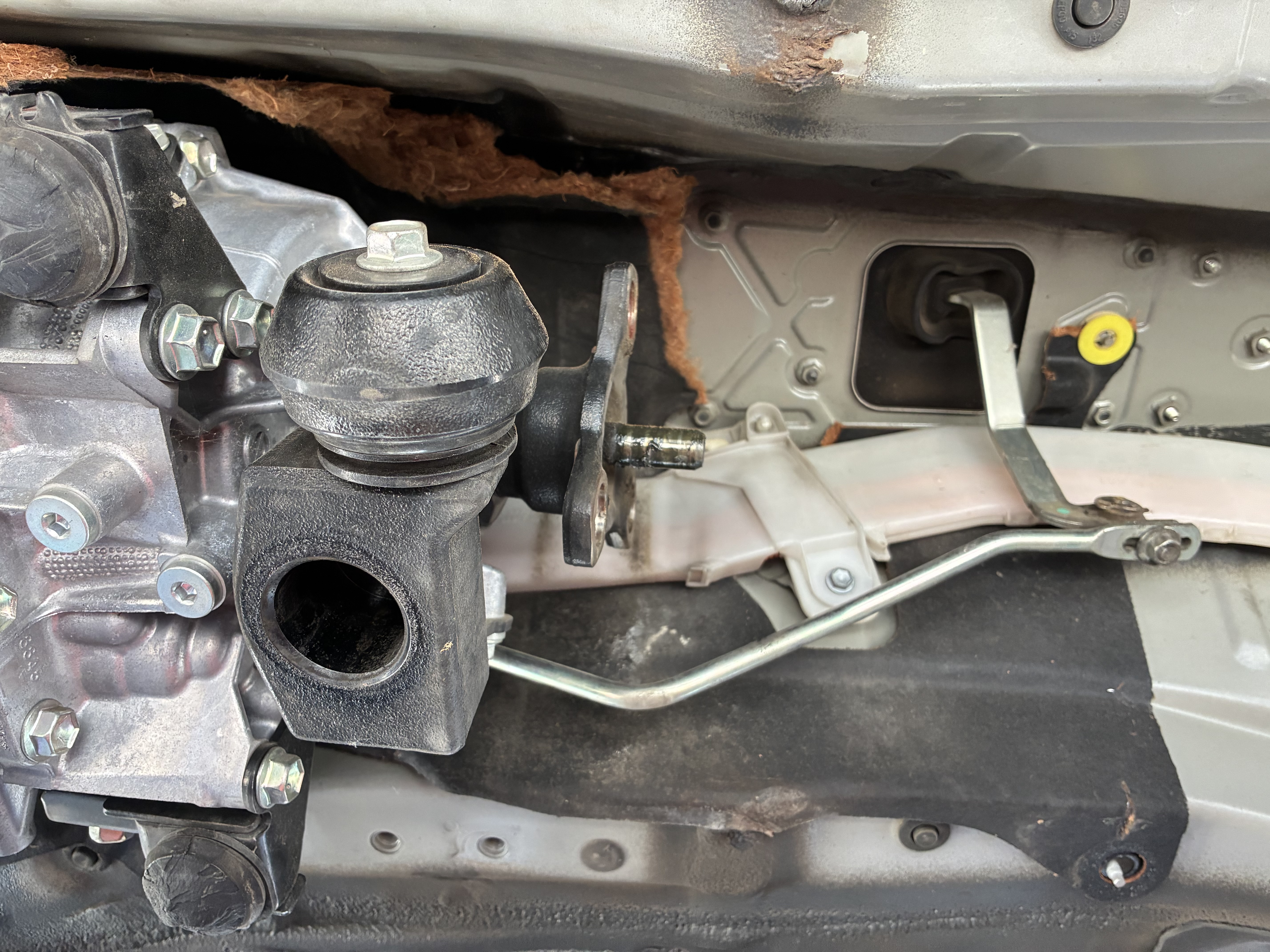

took some pics of the linkage down below
here I am trying to show how far back and above the transmission the actual shifter sits, it's almost a foot back of the tail of the transmission, I could have sworn it was right above it in the middle, but nope, glad I took these pics

and she's out for her close ups
so I believe and correct me if I am wrong, we are not really shifting actual gears with this thing, all this thing does is lock the transmission when in Park and all the other settings unlock it and just send electronic signals to the VCU telling it to either send positive torque signals when in Drive or negative torque signals when in Reverse, as there is no actual reverse gear in this transmission, it's just a gear reduction jobbie
somebody wanna 3D print us a cover for this beauty?
