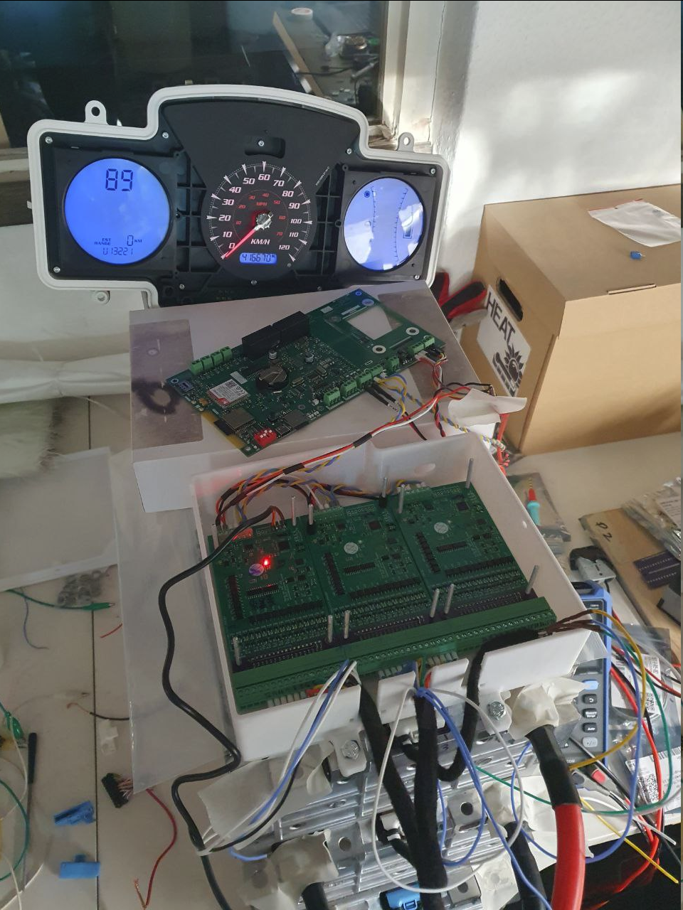

Hello openinverter community,

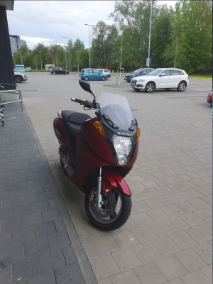

I would like to share my progress with hopefully providing another alternative for a somewhat useable Vextrix VX1 scooter BMS integration.
Vectrix VX1 is a maxi scooter which is highway capable and very suited for automotive battery integration. It was made for a few years in a few thousand unit run, most frames are almost 20 years old by now. Originally they shipped with nimh batteries, which died not long after on most units.
Do not undertake this if you have no clue (or will to learn) how to work with high voltages, how to use a multimeter and preferably ability to replace SMD components - please take one of the well established routes out there, for example:
random chinese active balancer, no BMS
2x ant bms splitting pack in 2
PLND (Matteo) BMS or Frans BMS - both of which are nicely engineered and fully integrated in the vehilce. Frans Firmwares for MC and other modules are nice, and as I've read his BMS is also very nice
I have forked Johus Flying ADC BMS firmware, ESP web tool and CAN bootloader to better suit vehicle integration. VX1 runs on 250k baud, so need forks for all of these:
https://github.com/skrubis/VX1-stm32-CANBootloader (250k baud migration)
https://github.com/skrubis/FlyingAdcBms-VX1 (added vx1 integration)
https://github.com/skrubis/VX1-esp32-web-interface (migrated fully to platformio, made friendly with 250k baud)

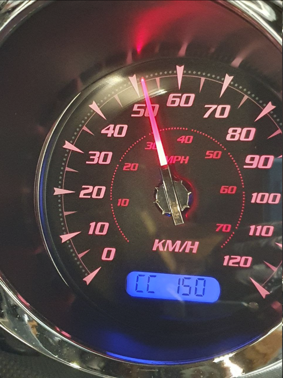

Current status: shows bootscreen stats, shows errors on odometer from any node, allows custom temperature or udelta warning on telltales and display. Shows various stats on clock display if so desired by the user.
Should be receiving motor controller speed, current and voltage PGNs for plotting/logging and most notably kWh/100km calculation as my brain breaks in Ah calculations used for the scooter throughout.

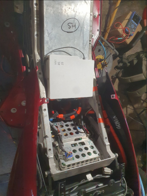

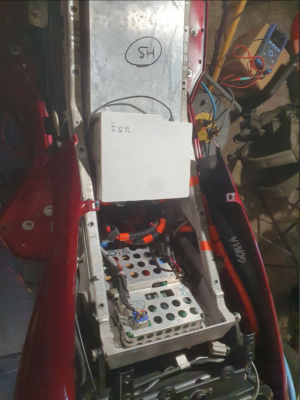

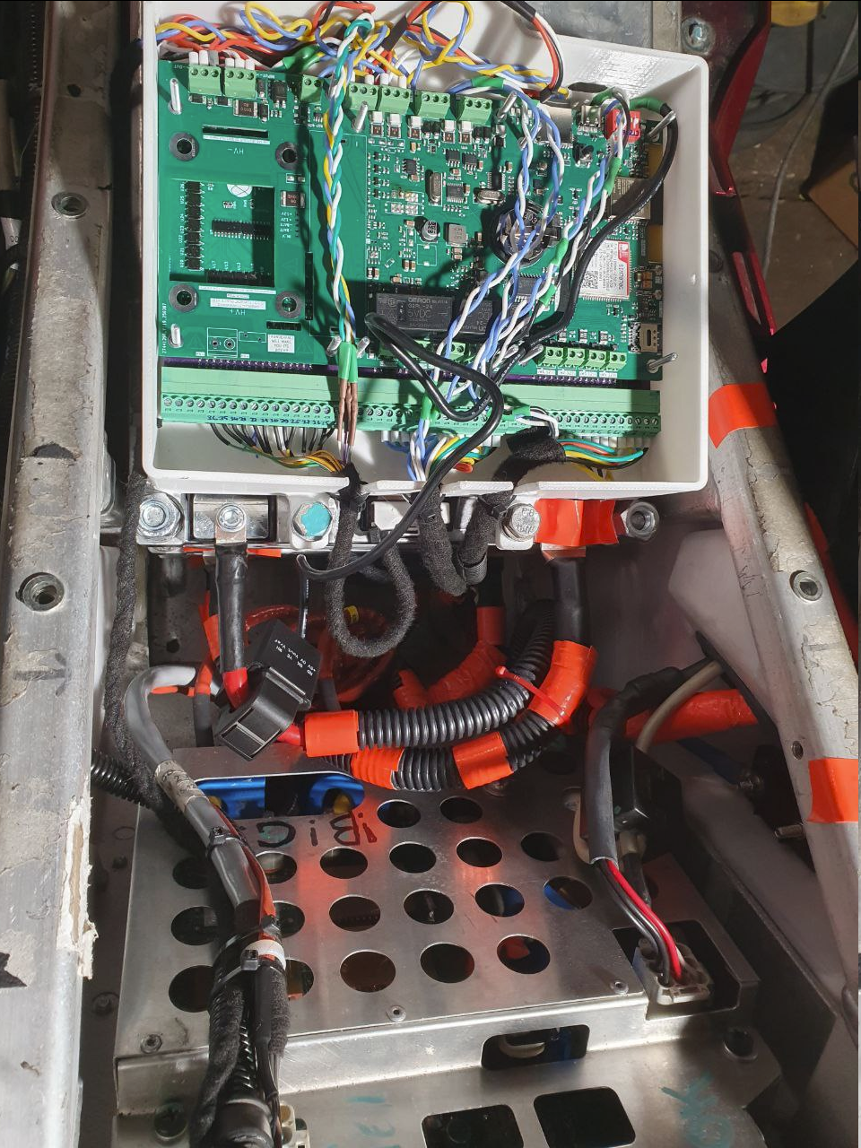

How to use:
  • you will need jlink, st link or similar programmer for the boards.
  • You may want an external current sensor, I am using HSTS016L 200A from aliexpress, as I want to monitor external eltek flatpack charger directly on battery bypassing motor controller.
  • either use command line tool (viewtopic.php?t=2907) for config or esp32 board with canbus, i.e. lilygo esp32 can
  • do a bench test for bms assembly with external power supply
  • Install in vehicle, possibly you want a small 3S li-ion battery or 4S lifepo4 battery fed through a schotky diode + about 4 ohm resistor to the battery and same 12V from vehicle through a schottky diode to the master BMS enable pin to allow for the BMS to balance cells while bike is off.

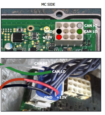

Tap vehicle can and power on the motor controller here, preferably fuse the power feed:

Added rudimentary BMS emulated messaging, now reports cell min/max, various faults, should be able to do at least a part of original "Li+" bike model comms to allow oldest original nimh bikes to have bms feedback. Not yet tested.

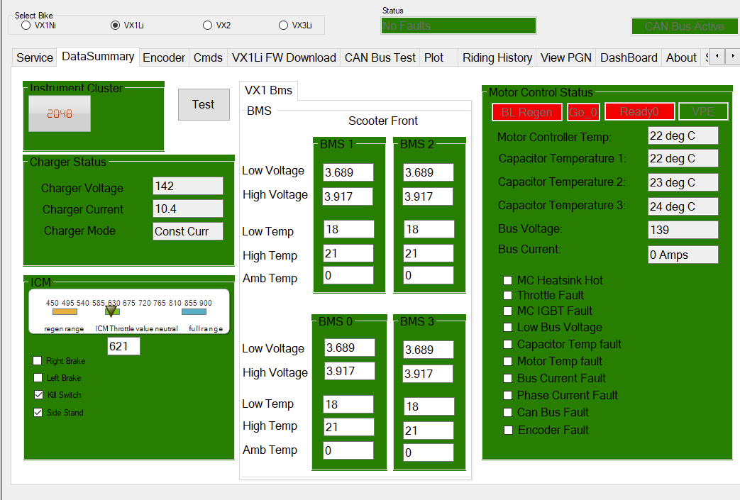

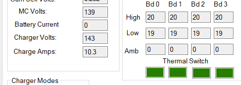

now seems to be fully working on the bike side - charger sees messages, charges depending on BMS data. A non Lithium bike has been turned to lithium and works as intended from charger point of view. Firmware still needs a lot of fixes and cleanup, but base messaging is there. Bike just passed inspection with 0 advisories, now just have to tackle a 200mV delta in the pack, not sure how many months it will take to balance it out. Imo a very valid alternative for cheapskates like me to turn ancient nimh bikes in to lithium with proper feedback from bms.

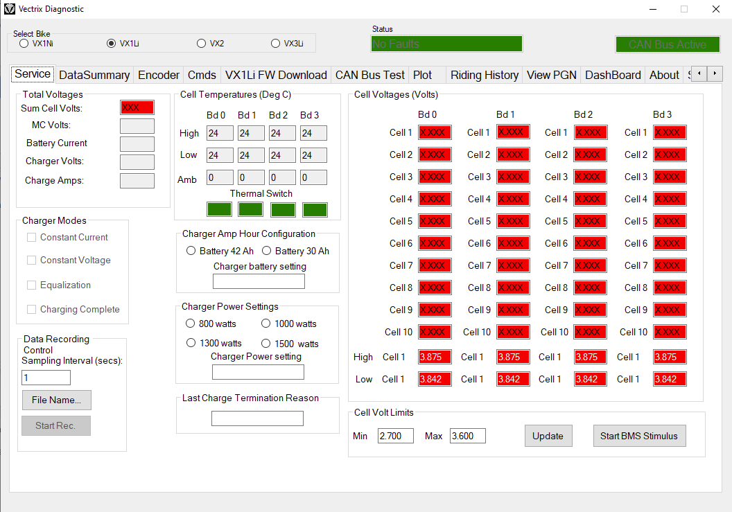

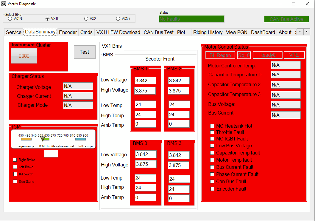

Given that there's already first replication effort from UK and to aide any future efforts to replicate I thought I should do a small writeup of current gotchas:
1) You need to use VScode + Platformio for ESP32 flashing, any CAN transceiver and redefined TWAI CAN pins will work. Make sure to get just a transceiver, not the SPI MCP2515 version. Clone or download the repo, open as folder in vscode and do "pio run target upload" and "pio run target uploadfs"
2) The current web config tool sometimes has issues fetching the json blob as it has grown in size considerably (IIRC 16kb was the last I checked).
The CANBUS speed has halved and json size increased. The web tool throws communication error on the first try to fetch the param file from BMS, I increased various timeouts and made the retry logic more robust, but the issue still persists. What worked for me was just switching the nodes (say 10->11->10) and making some coffee, it eventually gets the json, it is smooth sailing after that.
3) for charger control and MC normal operation only FEF3 messages seem to be needed. All other is just garbage I threw at the wall until I found a mistake in thermal switch nibble derating the MC.
You need the following params enabled on the master node (10 unless different): VX1MODE = 1; VX1enCanMsg = 1; VX1EmulateBMSmsg = 1;
These previously worked, but now after latest OIBMS upstream merge seem to be broken, no matter how much time I throw at it, will fix eventually: VX1BootLCDMsg, VX1enBootstats, VX1LCDClockStats, so best if you disable them if enabled for now, my dash went in to reboot constantly. To get some stats on the you can turn on the bike with Frans ICM FW while holding the left brake or alternatively for other stats you can press killswitch + hold left brake and release killswitch.
Delta, temperature and error telltales are working as of now, as much as I can tell.
VX1SendCellVoltages now sends garbage data deduced from dividing pack voltage by total cell count, only used for checking if normal operation requires this data- it doesn't. Use Web tool for cell values, not this from vectrix diag.
