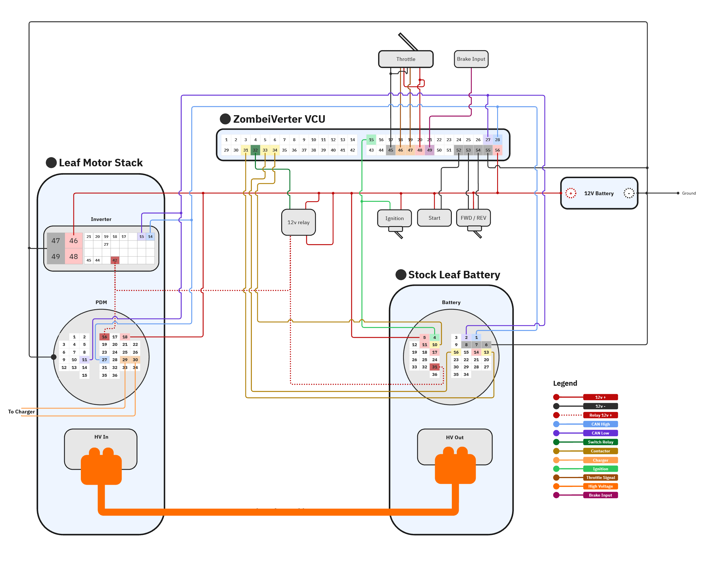

Hey Folks,
While waiting for my Zombiverter to arrive I have been working on a wiring diagram for my bench test.
It's pretty much the same as
this one although I'm using an intact stock Leaf battery pack for the bench test and wanted to get the pins correct.
Would be grateful for you all to tear it apart and let me know what I have got wrong
Thanks!
Leaf stack with zombiverter Openinverter Page
ZV + Leaf Stack wiring diagram

Nice drawing, your missing t15 “on” switch, pdm working looks right.

Thanks! makes sense, i remember the switch in one of the videos now.

I've just spotted both diagrams are missing the brake input to terminal 49 of the ZV.

Can contribute it to the wiki when it's correct. Thanks for pointing out the lack of brake input GregFordyce.

Updated diagram with Ignition switch and Brake input.
