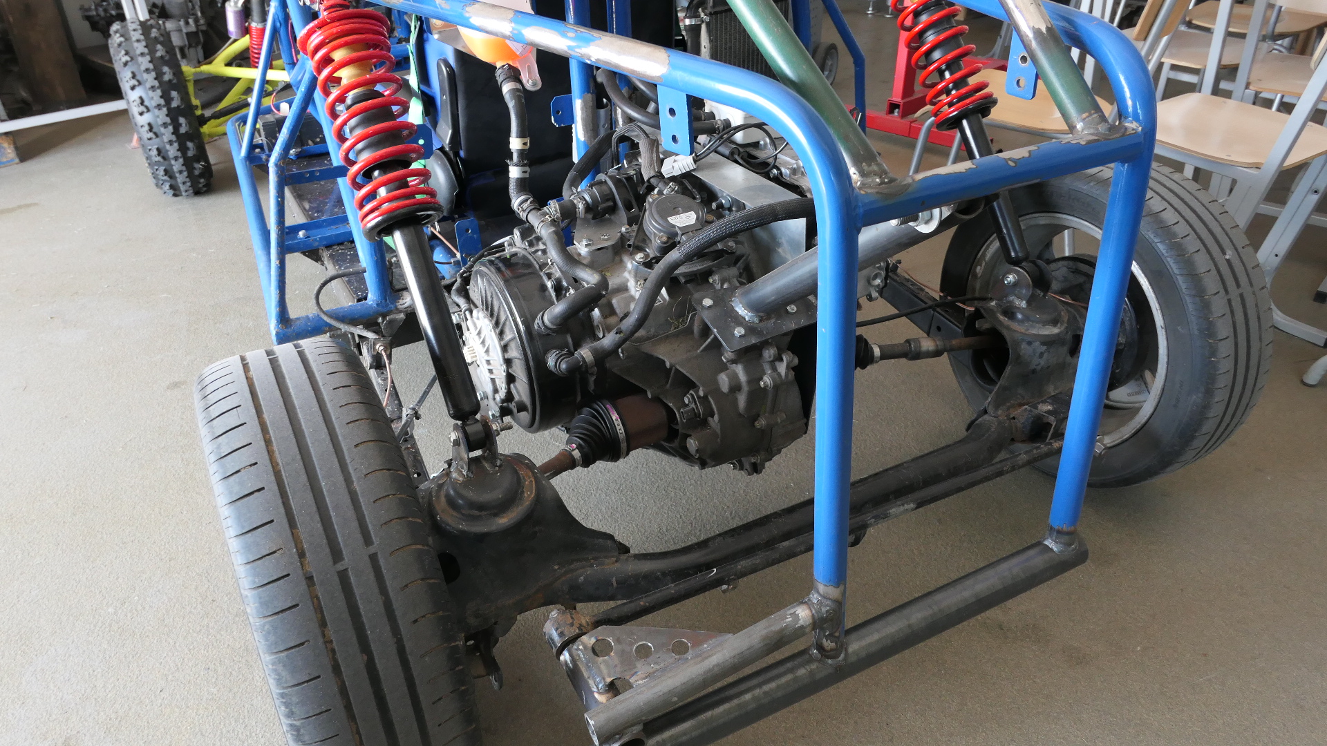

This is my voluntary or work/hobby project for our vocational school to teach EV technology simply and safely. We already had made this buggy in one Erasmus+ project. But at the time I had no experience with openinverter technology. I still haven't but I am ready to learn. At the moment Buggy is driving and equipped with Nissan Leaf 2012 battery modules 10S2P 84V 8kWh, 9kW Brushed forklift motor and 550A Curtis controller (limited to 100A), a small DC/DC and 3kW onboard charger, ANT bms with display and bluetooth. It's all nice but... It came out really heavy 490kg for such a small buggy ofcourse one reason is that we are here no automotive engineers we teach and train workers for car service workshops. The frame is stronger than necessary, it doesn't have a diff at rear axle so manouvering in garage is very hard.
2024 started for me with local Toyota Baltics training for hybrid and electric cars and last year we have been given the renault drivetrain. I also ordered Auris board from evbmw.com shop. So now convinced from training that toyota hybrid stuff is pretty clever solution I contacted my countryman jnsaff from this forum who has already given me many parts from his projects that he didn't need. But now, this year we bought an Auris inverter from him.

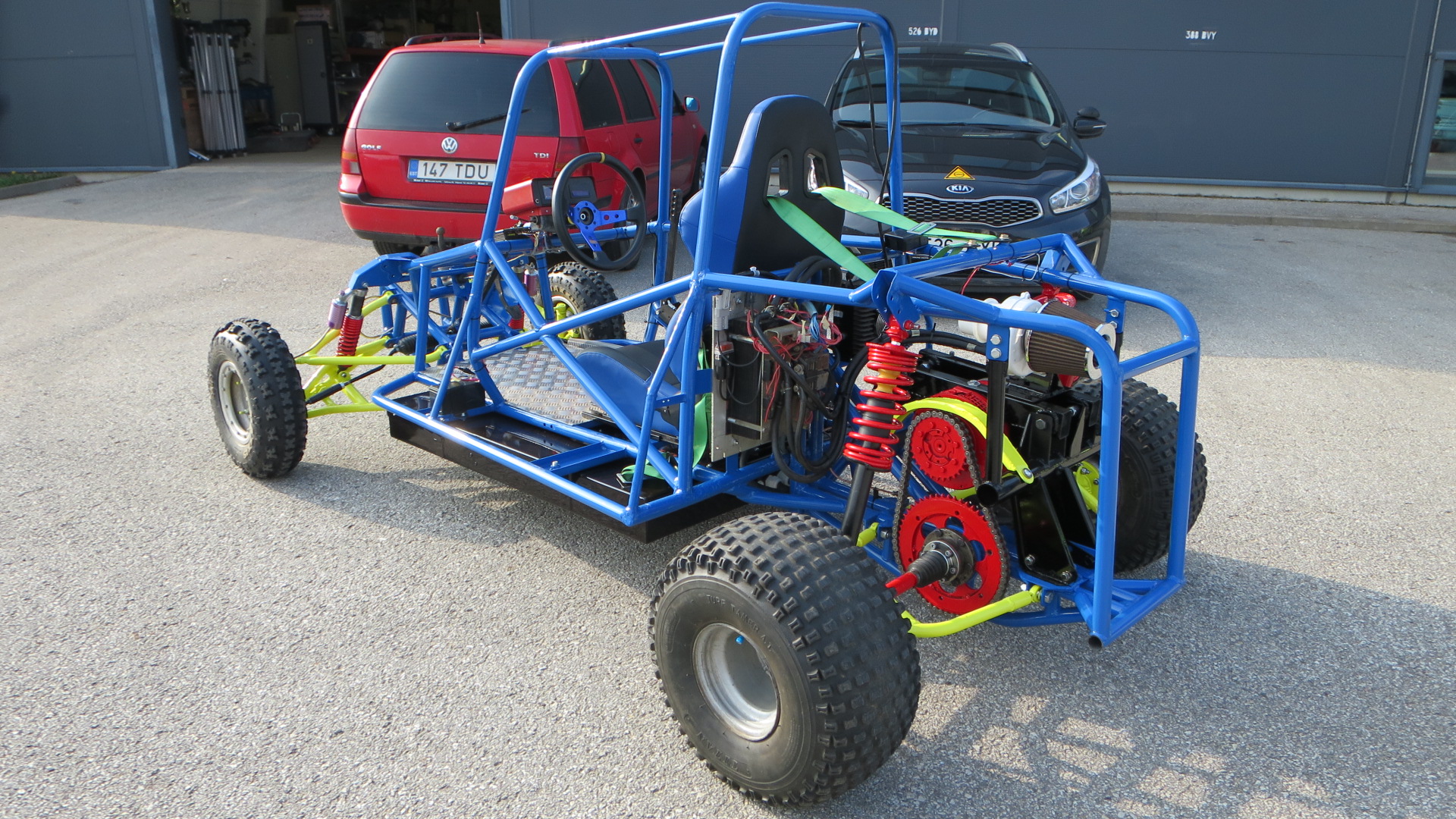

Re: [wip] DIY electric buggy for school students, Renault PHEV drive, Auris openinverter board
Here's what the electric buggy looked like when it was finished september 2021

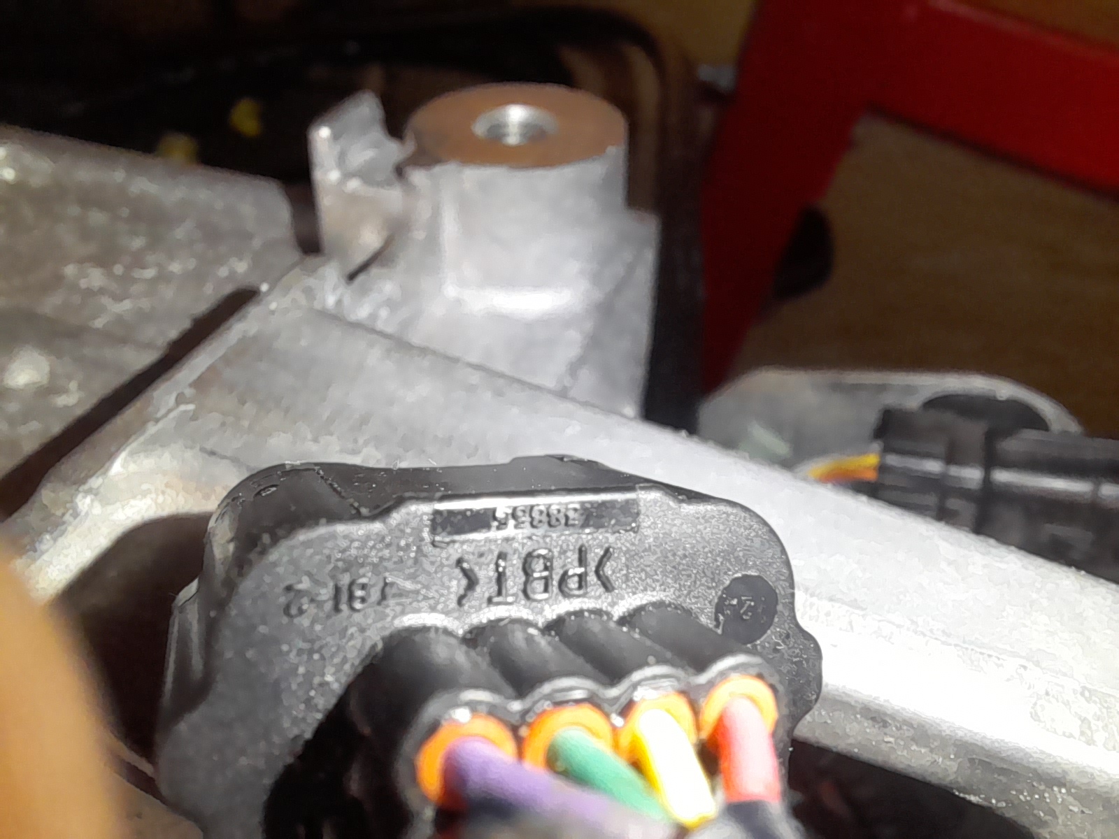

About motor connectors. I need to find out what connectors are used here for resolvers. I'll try to ask local Renault dealer because I didn't find any from online wreckyards, also I have some japanese EV wireing laying around maybe something matches?
smaller generator/motor resolver connector:
bigger motor, the one with gearbox and differential

These connectors look very much like Hirose connectors. Maybe you can spot some numbers on the connector?
They look somewhat similar to the GT18W Series from the Mitsubishi components, but not quite I think.

Yes thank you for the idea! Thanks to that I found a number on the smaller generator/motor resolver connector 12519
a little googling found a mighty interesting 451 page toyota connector document
https://www.toyota-tech.eu/wire_harness_rm/RM06H0E.pdf
Seems like aliexpress has something similiar to offer do you guys think it's ok quality?

Aparrently that's a Sumitomo connector, the Sumitomo part number is TS025-8P. But it seems that that's a Toyota-only connector as it has the Toyota part number on it's side and not the Sumitomo part number.
The Aliexpress offer is certainly worth a shot, otherwise you could try to go to your friendly local Toyota/Lexus dealership and ask if they want to sell you a connector.
If you can't find connectors for the white connectors, it might be worth trying out if the 3D printed signal glands from the Mitsubishi stuff fit here: viewtopic.php?t=3563
They look very similar in shape. If you want to, I can provide some measurements for cross checking.

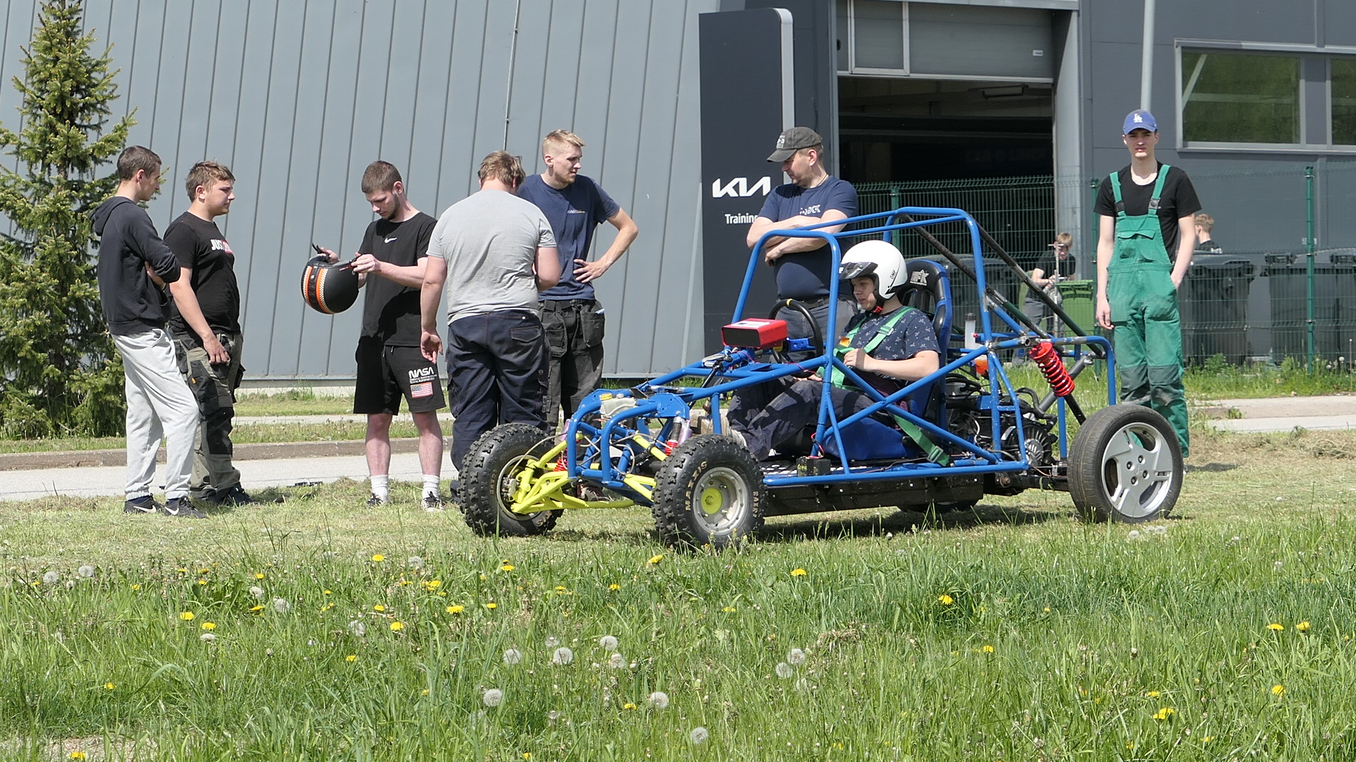

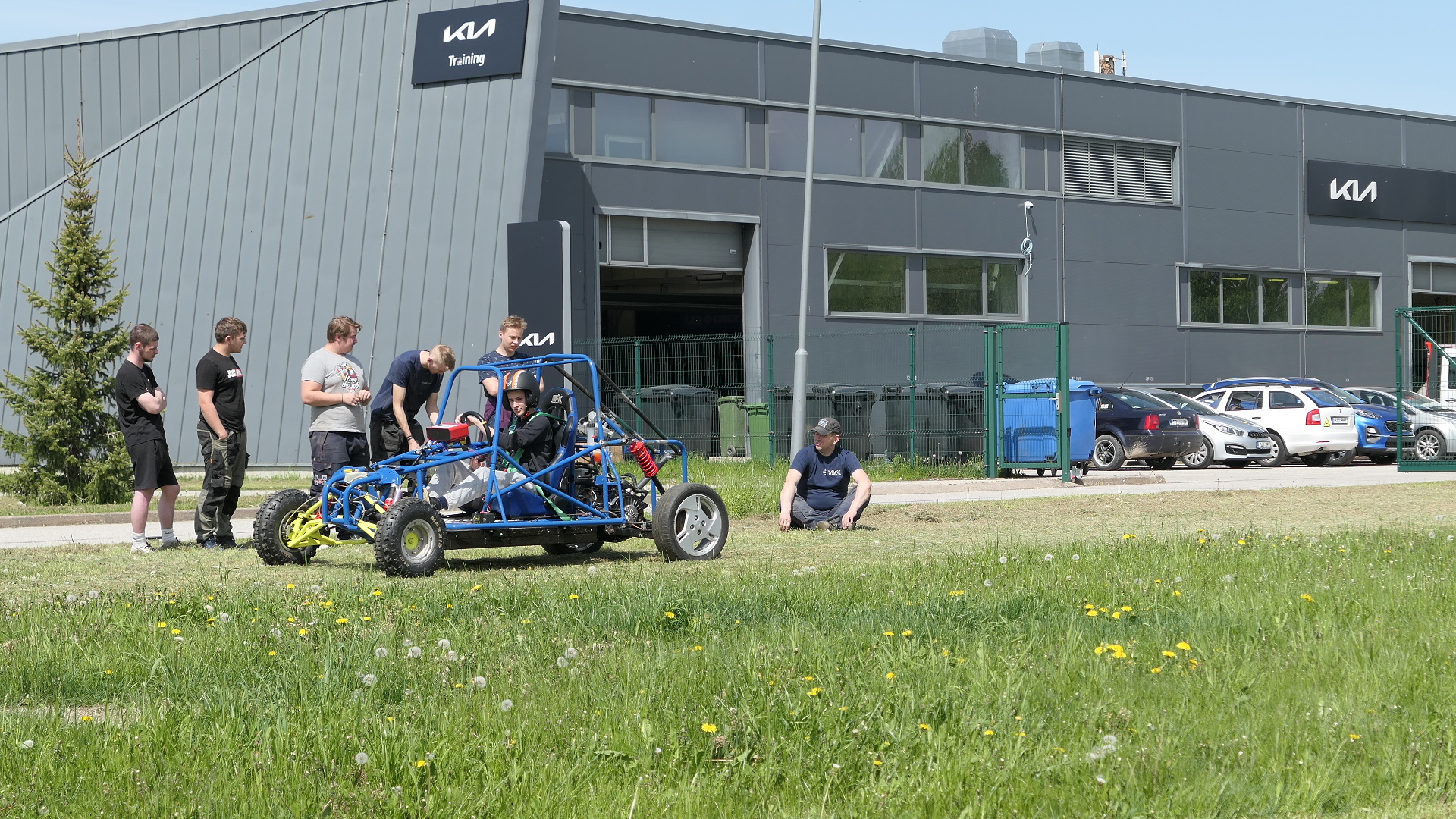

Got the buggy driving to take part of car engineering student event in rallycross track organized by TTK - University of Applied Sciences.
Only our school had running electric buggy.
Other one was ofcourse world nr.1 in 2024 Formula Student car.
Thanks to my colleague, who's driving, he did and leaded doing all the needed metal work.

https://www.aliexpress.com/item/1005002 ... ry_from%3A
I ordered it from aliexpress also, but I think it was this one.
Aliexpress connector: https://www.aliexpress.com/i/1005002925074865.html
- Posts: 3796
- Has thanked: 166 times
- Been thanked: 413 times
Apologies... i sent you the wrong pin count. I use that one with Outlander stuff.Ruudi S wrote: ↑Sun May 11, 2025 7:42 pm Thanks for the link, but your link is not the same connector I think.
However what you show in the previous post is not Sumimoto TS025 connector P/N 6189-1240 that you showed earlier. You showed 8 pin version. Terminals are the same... 8100-3455 for the female and 8100-3617 for male....
https://www.corsa-technic.com/item.php? ... lxOZ2-khUJ
https://www.corsa-technic.com/item.php?item_id=942
https://www.corsa-technic.com/item.php? ... NmSmimPsN5

Now I got this far that it's clear that 80V is enough to run this buggy faster then safe with that frame construction!
Got bigger current and better acceleration also!
Amazing this openinverter FOC software!

Buggy drives ok now. I am beginning to understand some of the openinverter parameters. We have to improve some motor mounts a little and maybe try gearbox oil pump also, at the moment it's not connected. Also I haven't connected the charging automation Auris board has some outputs but I haven't figured auto yet how to make it work.
this is how the Renault PHEV drive looks like.
