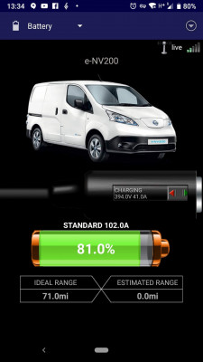

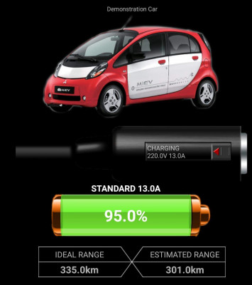

A couple of examples vehicles supported by OVMS today... the iMIEV and e-NV200 (Leaf) 8-)

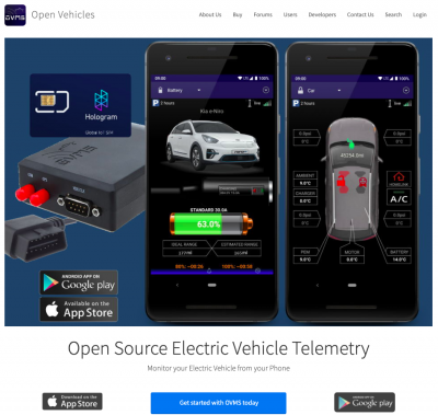

OVMS has a shiny new website (here) 8-)
