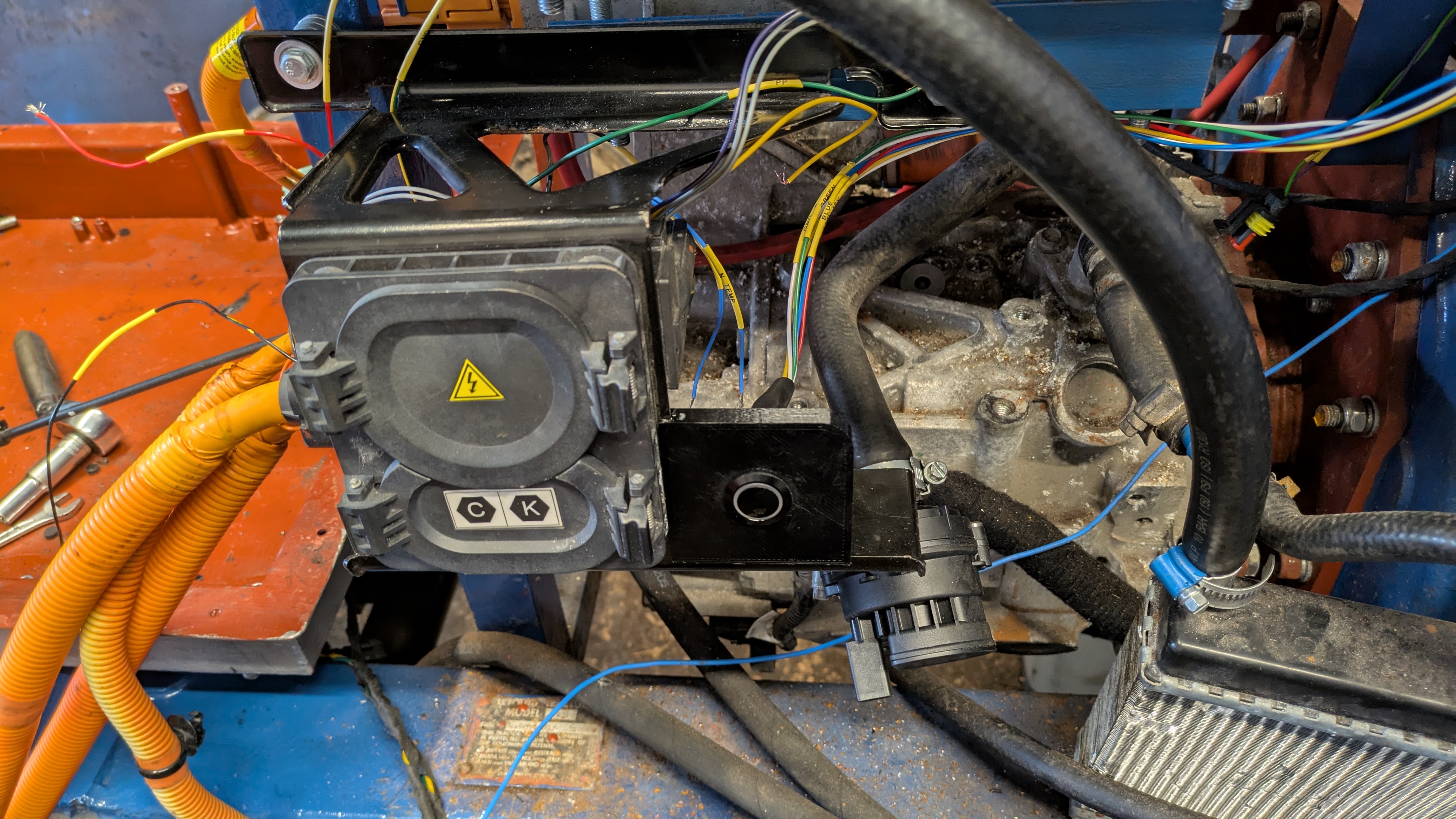

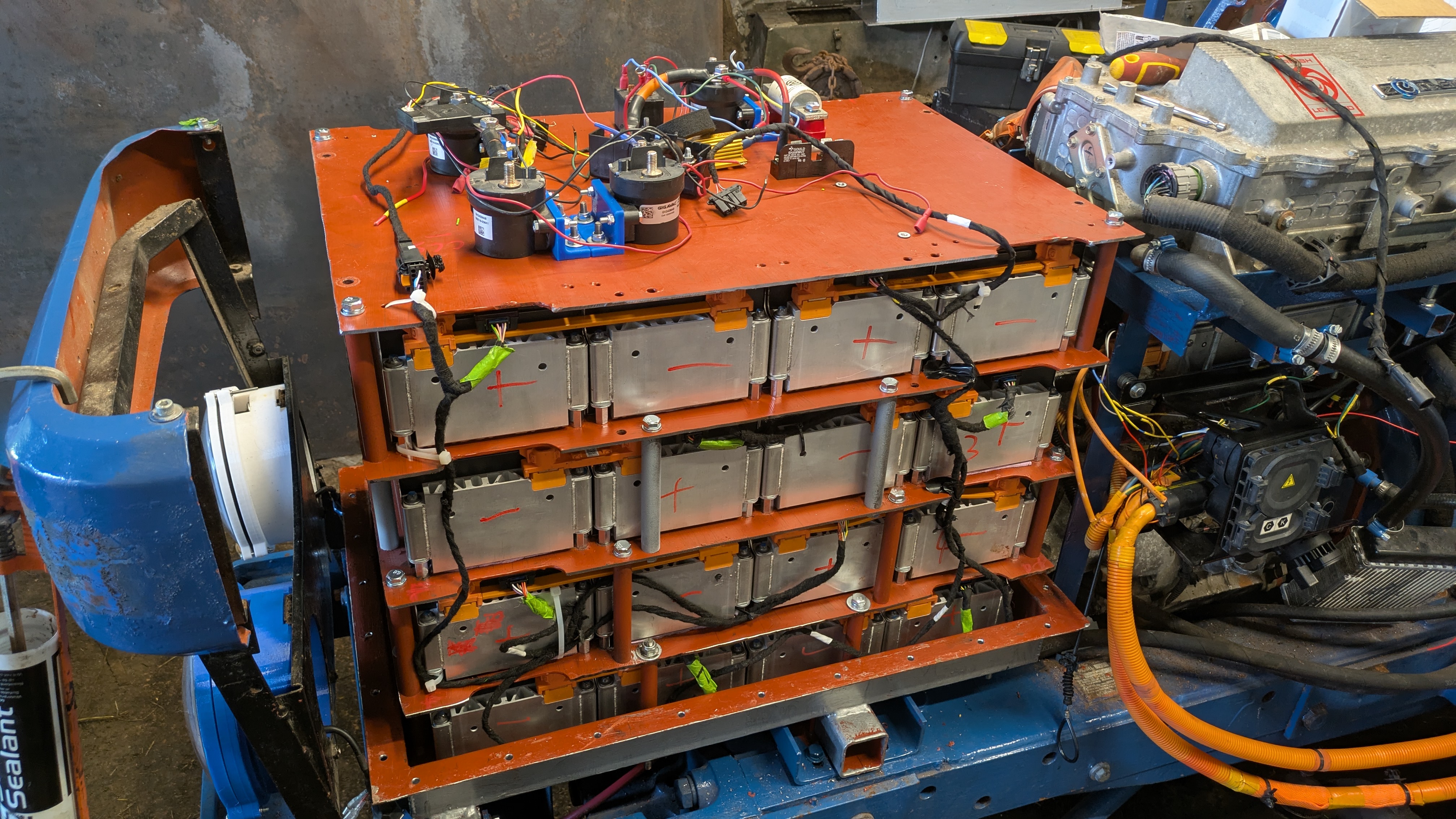

Hit a nice milestone in the battery refit this weekend. All the modules are in, with most of the HV cabling done to the point of being able to get the lid on. I still need to finish off the 12v wiring inside the box and the rest of the tractor, plus a little bit on the HV side.

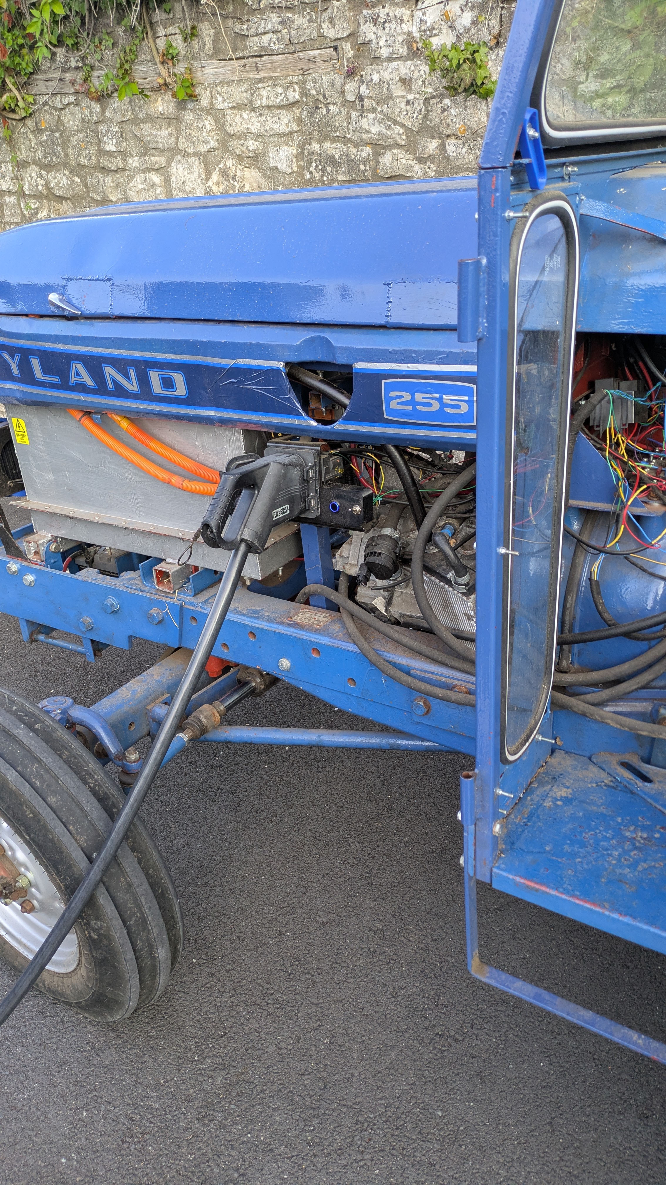

Re: [First Drive] Leyland 255 Tractor - Nissan Leaf EM61

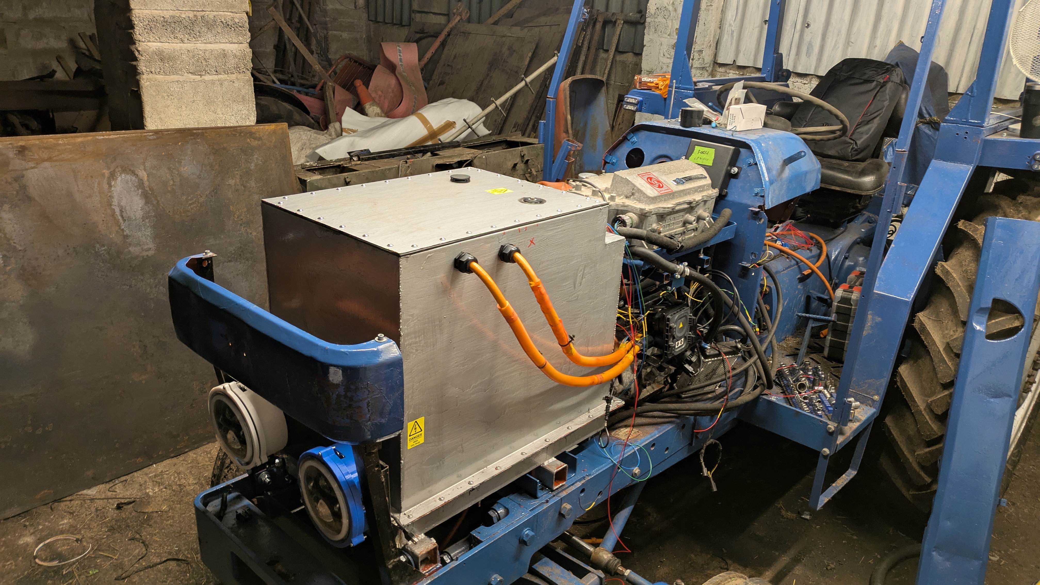

Battery is now all in along with all the 12v wiring. Next on the EV side is MG charger testing/hacking.
Also have some more restoration to do, threw a few body panels back on which all need a little bit of welding and some new window rubbers.

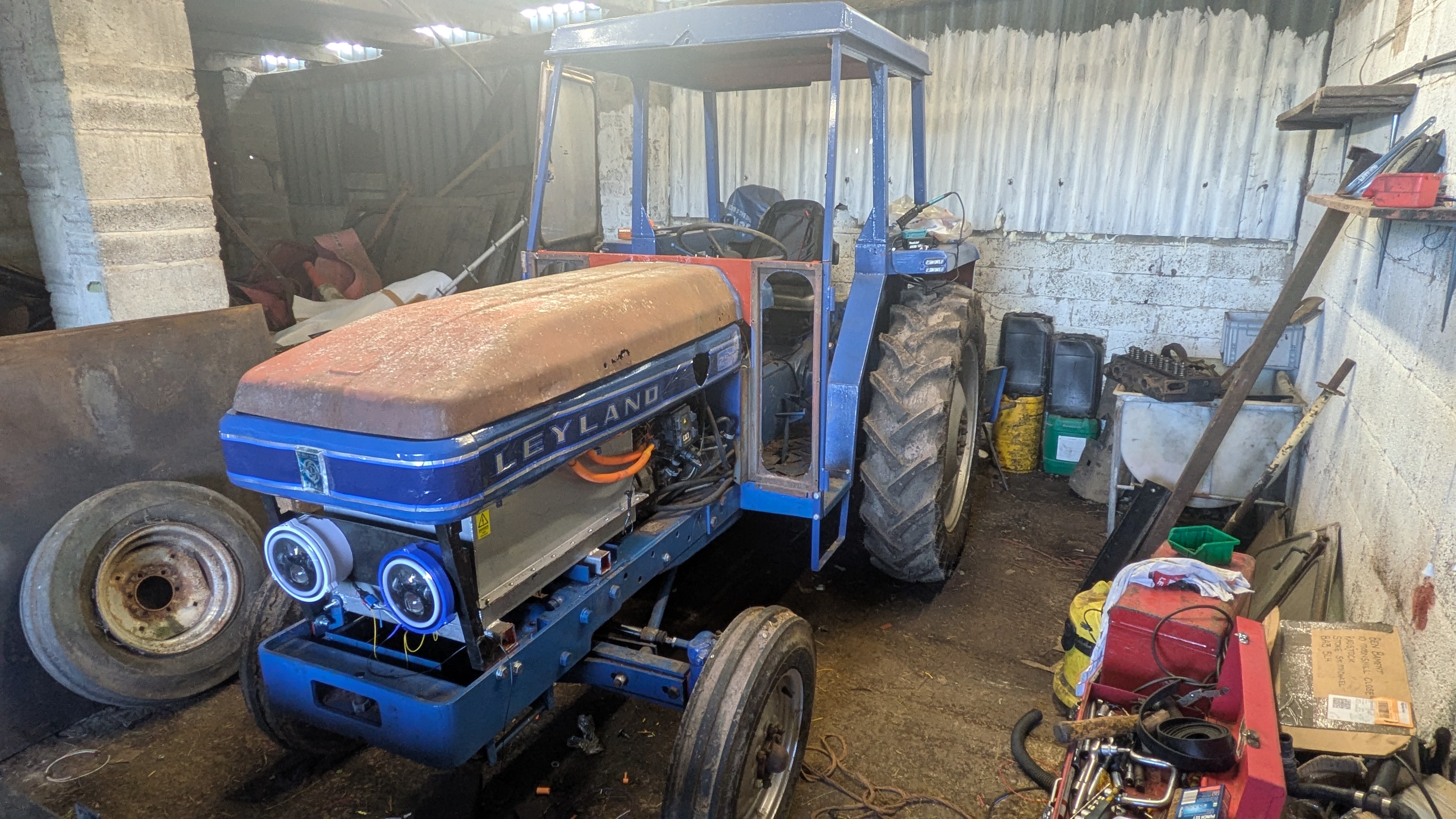

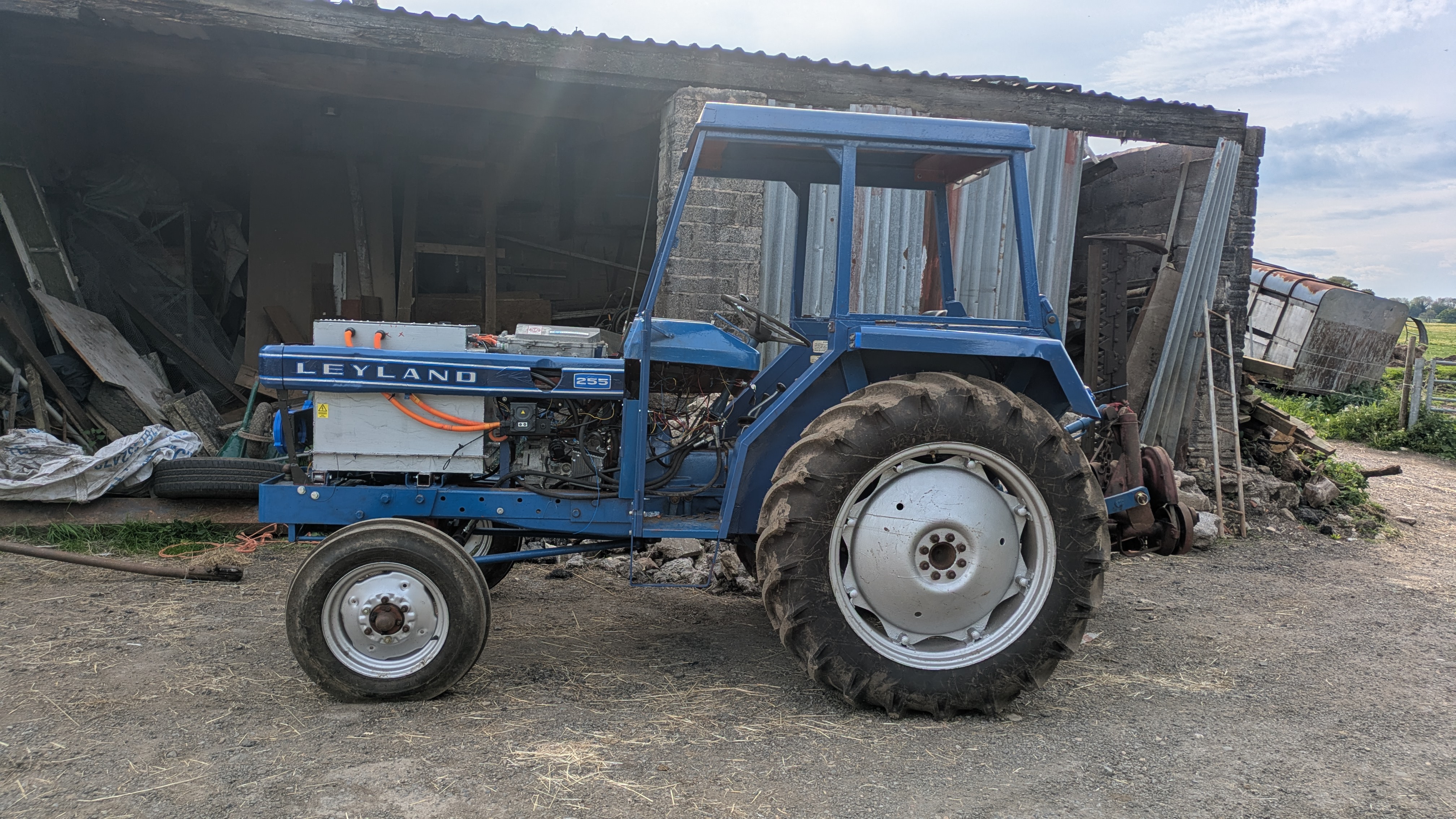

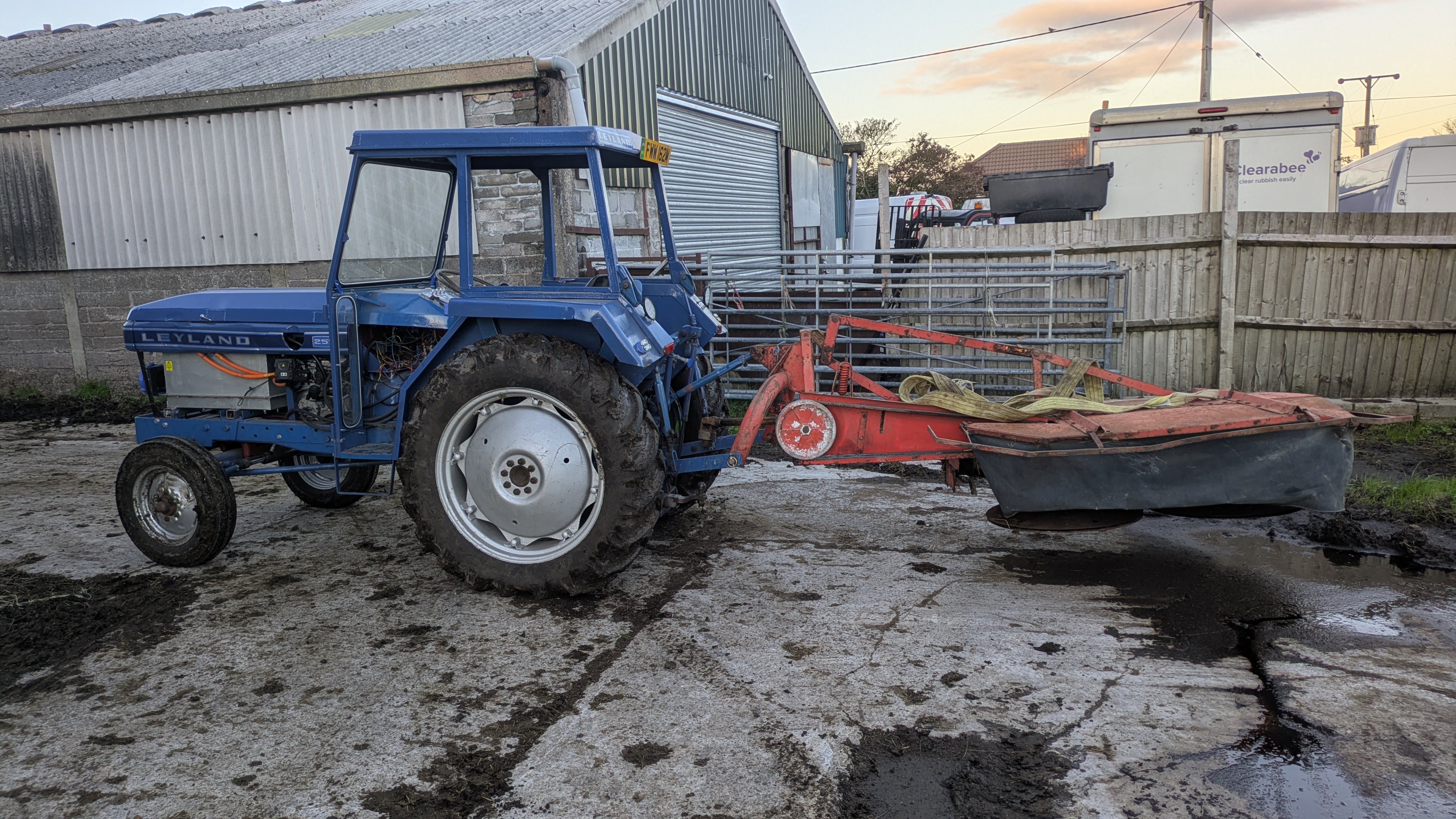

Got the toys out of the shed today to rearrange things. Tractor is now at the front of the shed ready to do some work.
I've been building on the MG charger reverse engineering by Damien and have the DC-DC running in a zombie module. I have also got it charging with some static messages, to the point where I actually need to go out and drain the battery so I can keep experimenting with the charging messages. Last things to work out on the charging is to get it to shut down quickly and also current ramping down.
On the V2L side I haven't had any luck so far, but I will keep trying.
Still a few bits of restoration to do as well but that list is getting smaller and smaller.

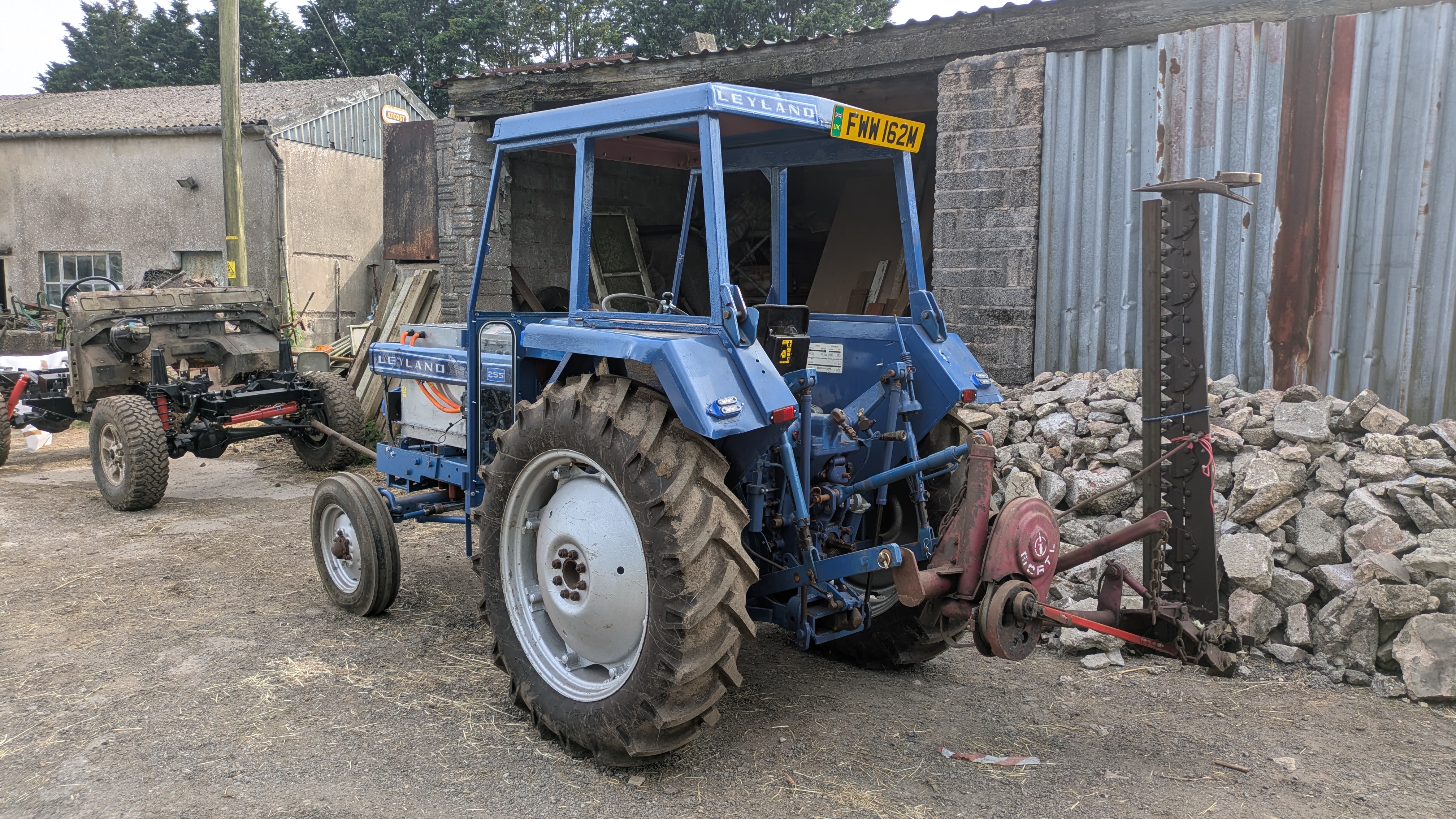

Going out tomorrow with the finger bar mower to cut down some nettles so I might try and get some drone footage of that.
On the paperwork side I sent that off to the DVLA last week and now have to book an inspection. I'm not all that worried about this one, like the quad bike it's agricultural so no worries about road tax. I want to keep building up some history with the DVLA so they hopefully play nice with the Land Rover.

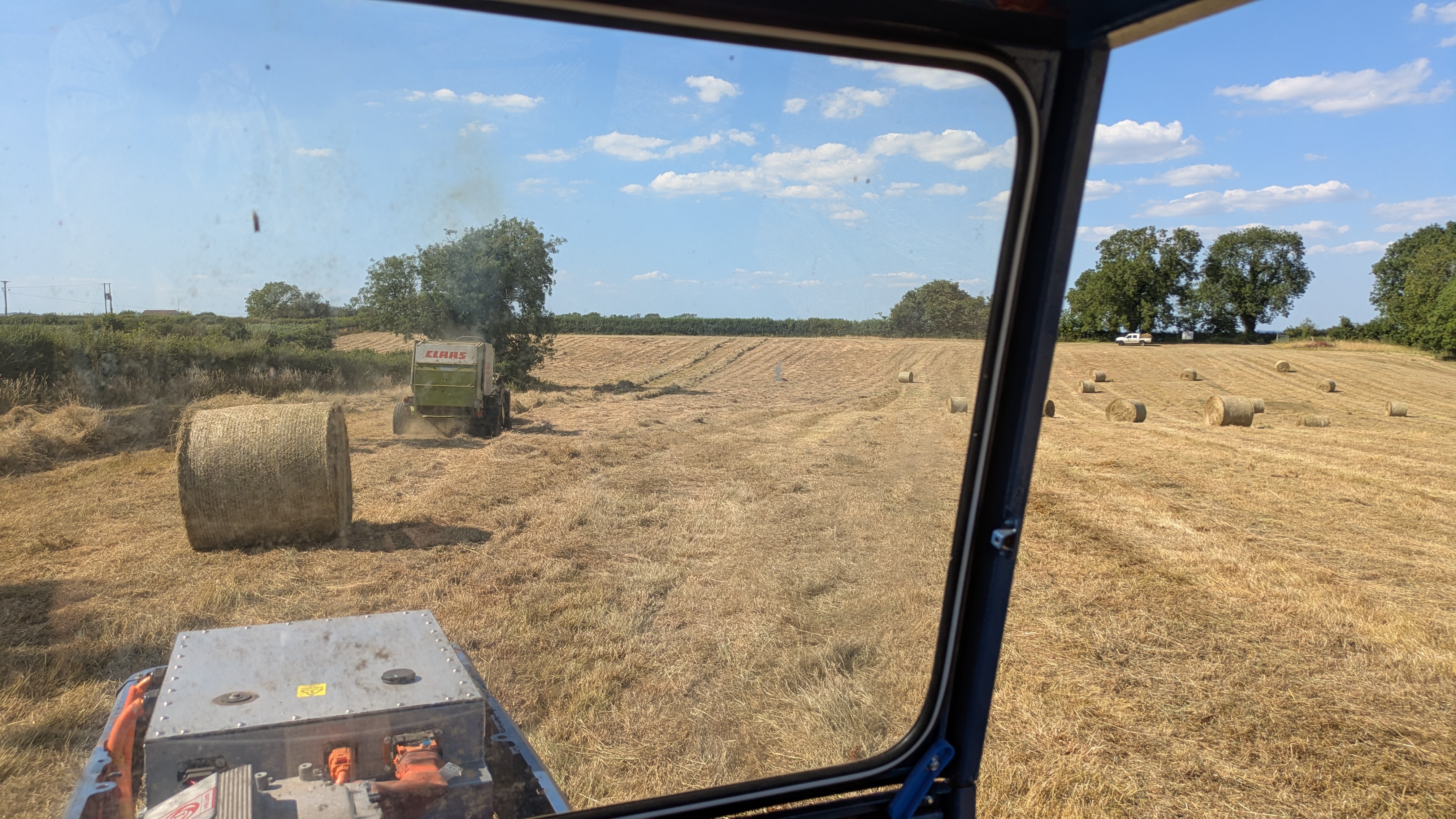

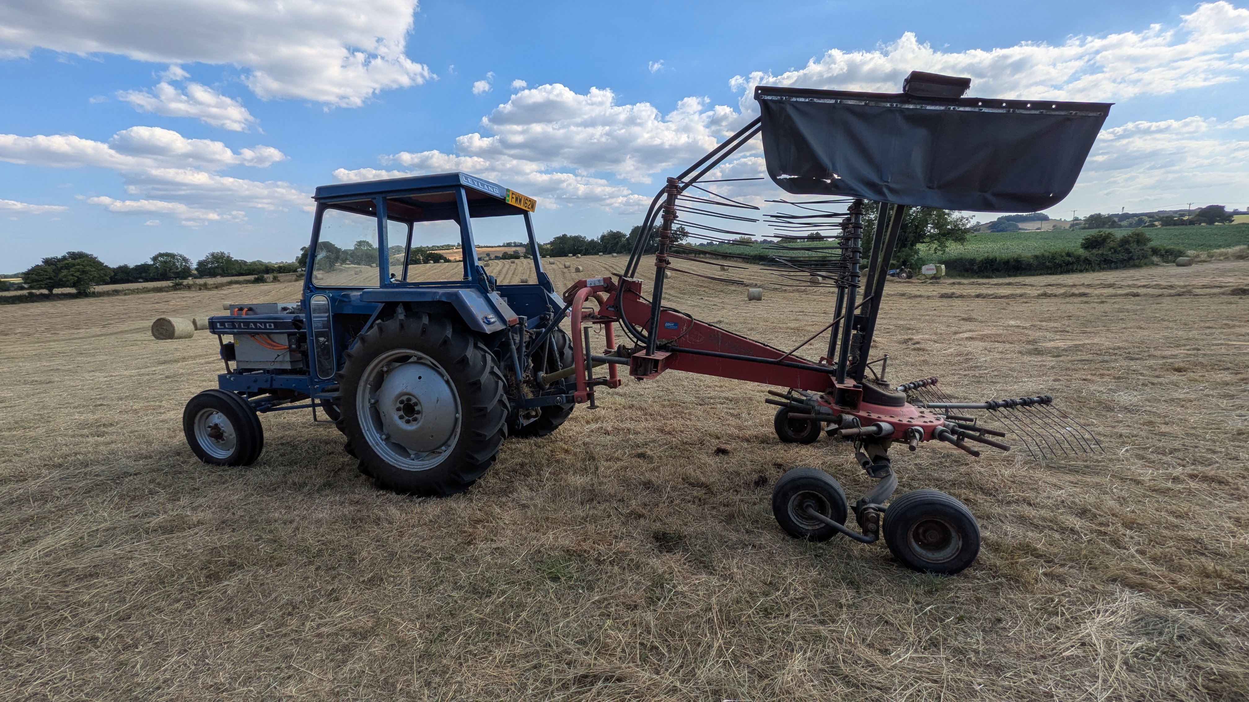

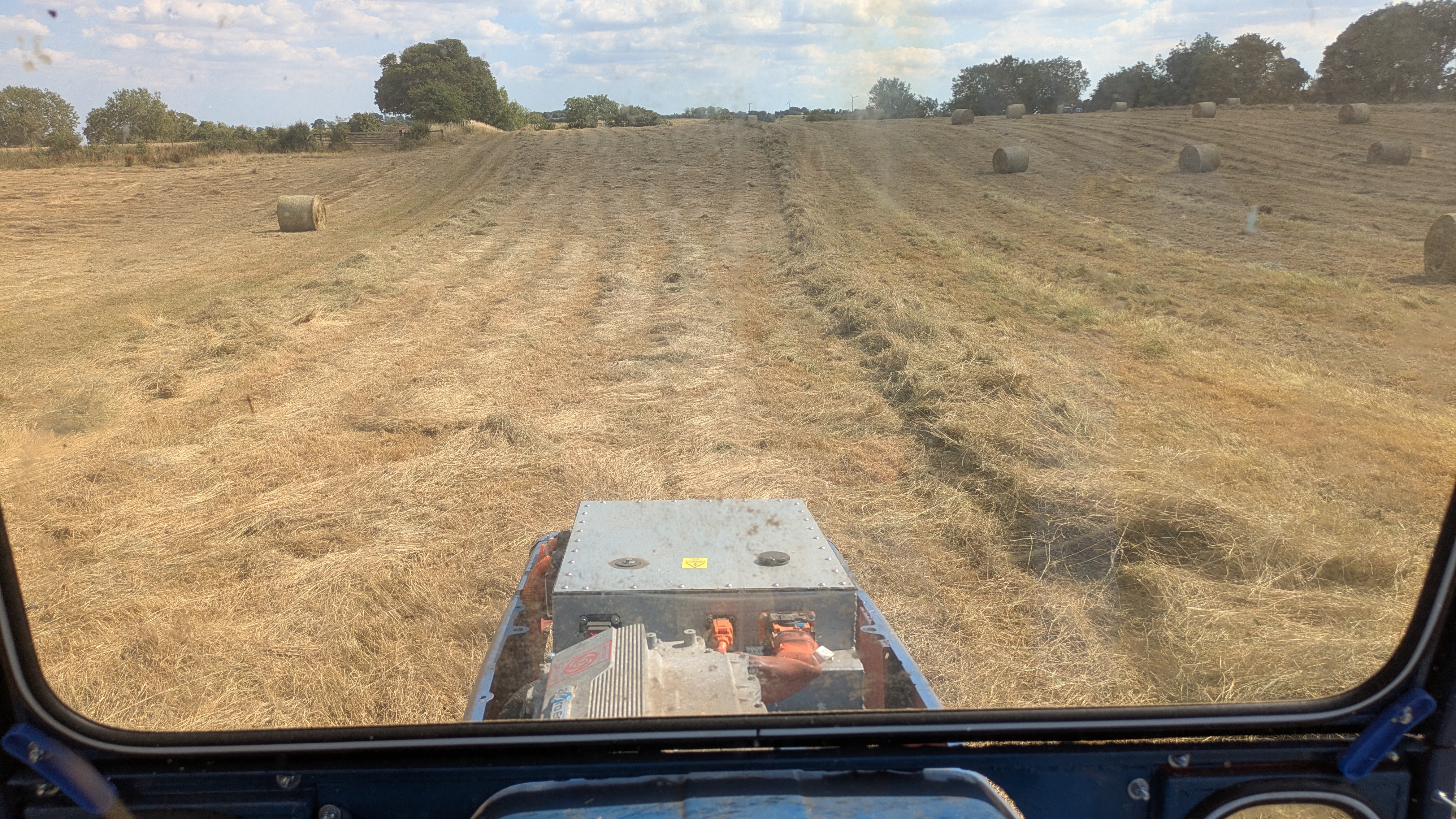

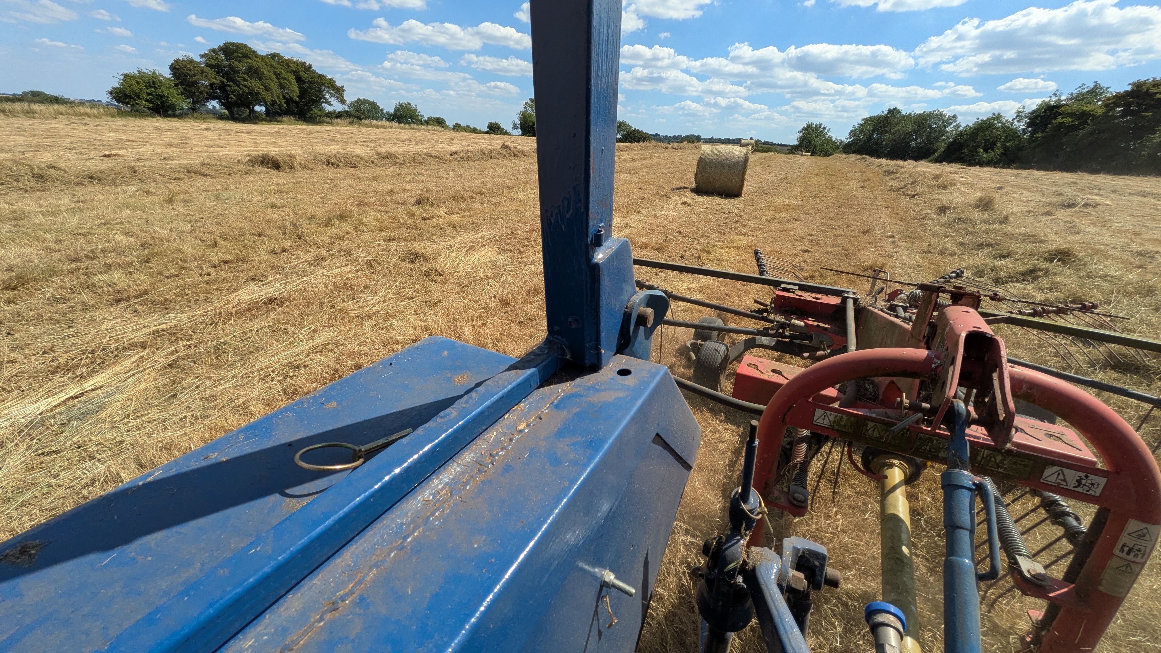

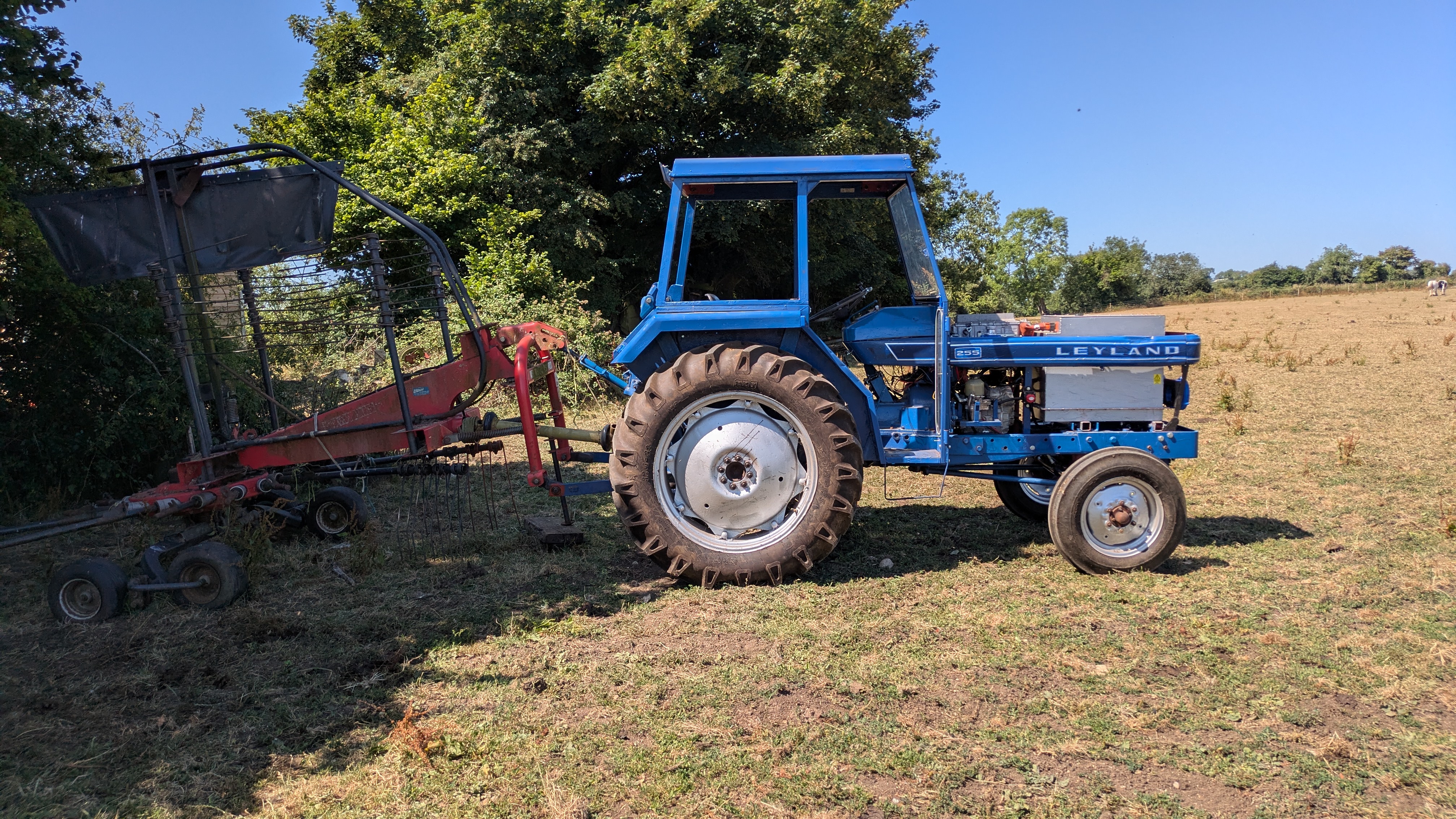

Finally done the first bit of actual hard work with the electric Leyland today. Had it on the hay rake rolling up for the baler. I was quite happy with the results. The power usage was really much lower than I was expecting. This isn't a small rake, a bit big for the tractor really given it will lift the front wheels off the ground allot when I'm trying to turn around at the end of each row. But max power draw I saw was about 11kW when I was going uphill, going down hill and hitting the rpm limit I would only pull around 4kW. The motor hardly noticed, in 31C ambient temperatures the motor maxed at 41C and inverter at around 36C.
So for being out for several hours I only used around 13kWh of power.
I didn't have it fully charged to start with, but we had to stop because of a flat tyre on the rake rather than needing to recharge. It's really very encouraging on what this tractor can usefully do. I will try and get it on a small square baler as I think the power requirements for those are also quite small. The big round baler is probably too much to ask as the PTO requirements for that are around 50kW, no question it will run it, but just not for a useful amount of time.

Would be very interesting to know how long the motor could sustain that amount of power...

Sounds like the bailer needs it's own battery and maybe it's own leaf motor. 50kw is pretty massive, what's the run time look like for your needs? 50kw continuous or peak?

I am assuming it will be fairly continuous power for a baler. To be fair that big round baler is too big for my tractor pre-conversion anyway. I'll try it with a baler more suitable to the size and original age.
A quick bit of googling suggests I'll only need 25kW to run a small square baler. That seems reasonable power wise, I'll see if I can get a go on one this season.

Is the PTO geared down 2.75:1? This could mean 18kw at the leaf motor, I think... Or are they considering that already? Or does the bailer ratio the PTO speed back up? There may be a way to gear down the motor more to bring motor speed up and power requirements down. Leaf motor can spin way faster than a diesel. But this may also be too much for your transmission.LRBen wrote: ↑Sat Jul 12, 2025 9:36 pm I am assuming it will be fairly continuous power for a baler. To be fair that big round baler is too big for my tractor pre-conversion anyway. I'll try it with a baler more suitable to the size and original age.

Power is power, gearing it up and down changes the speed and torque but doesn't change the required power. 25kW continuous should be fine for the leaf motor anyway so that's not too much of a problem.jrbe wrote: ↑Sun Jul 13, 2025 10:14 pm Is the PTO geared down 2.75:1? This could mean 18kw at the leaf motor, I think... Or are they considering that already? Or does the bailer ratio the PTO speed back up? There may be a way to gear down the motor more to bring motor speed up and power requirements down. Leaf motor can spin way faster than a diesel. But this may also be too much for your transmission.
