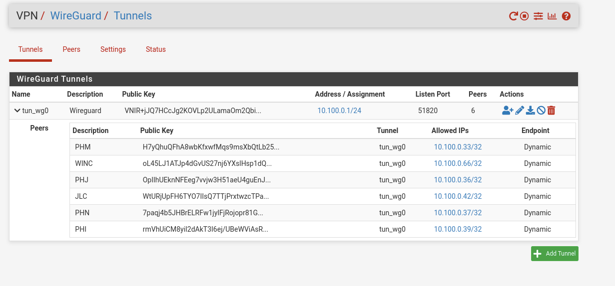

If that server is at home you can install a PFsense firewall - Free software and then you can have lists added to known bad servers or IPs.
You just need a computer with 2 NIC cards
these are some of my lists.
you can also have VPN tunnels from you phones or PC to send all traffic back home through your firewall. All phones in my family send all traffic back home tunneled . that way you can connect to any wifi hotspts and nobody can see your traffic.
I installed the pFsense software on something like this:
https://www.aliexpress.us/item/32568068 ... 00237956_2
You just have to compare the processors to see what you need.
they all use about 6W but the n150 has more power.

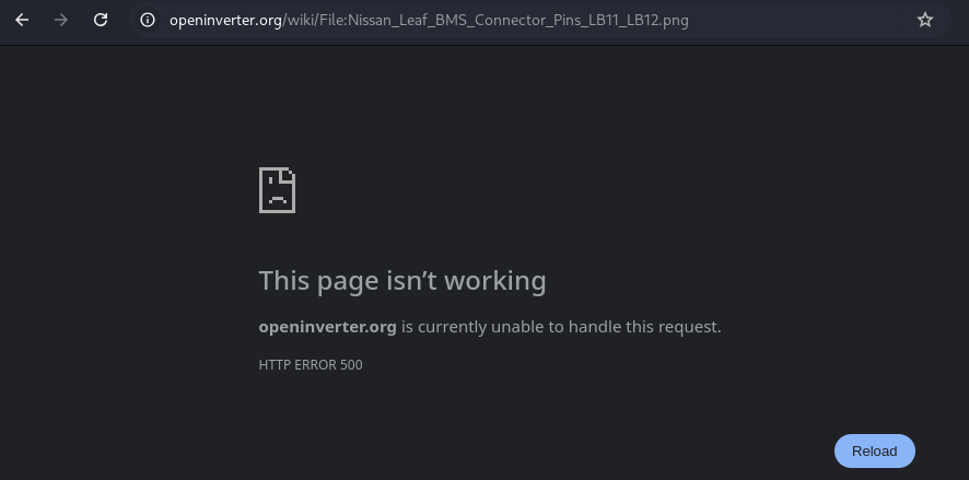

Seems like most of the pictures getts http 500 errors on the openinverter wiki when you klick on them, is that related to this in any way?
/Linda

linda.ljungdahl wrote: Sat May 17, 2025 3:54 pm Seems like most of the pictures getts http 500 errors on the openinverter wiki when you klick on them, is that related to this in any way?
Thanks for pointing that out. That must be caused by one of the recent updates though. Am looking into it.

I installed MediaWiki 1.43.1 now and disabled the newly installed SemanticBundle (viewtopic.php?p=82317#p82317). This was the last alteration 10 days ago and I'm afraid it may have broken things. The installation was very intrusive.
