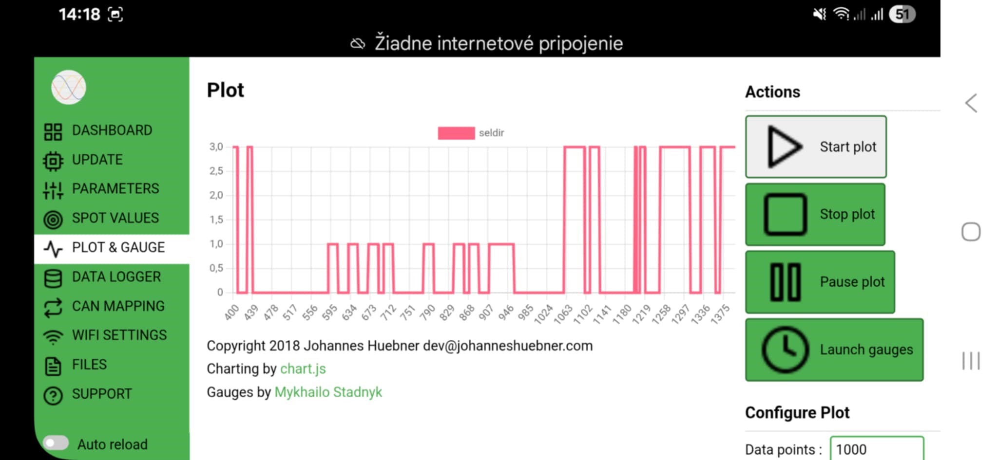

I had more mishaps(I am learning), last one was overspin (at 180V) via sine fw with audible bang (not to loud) and stop of the MGR. After that, my heatsink temperature measurement showed 0, until reflashing fw with same 5.35R-sine binary. Temperature reading is fine, now. After that i am unsucesfull with spin of MGR via MG2 with sine and foc fw. Can you give me advice, where I can find fault? I measure 180V at IGBT capacitor terminals (first place, where Damian conected baterry in cannot kill a toyota series), but I measure 1.7V at phase terminals vs 0V of the HV during sine fw working. I don't have a scope yet...
And I want to test MG1 now with MGR and i struggle with canbus between MG1 and MG2. I was 50% sucessful in sending SELDIR value, see plot. Image

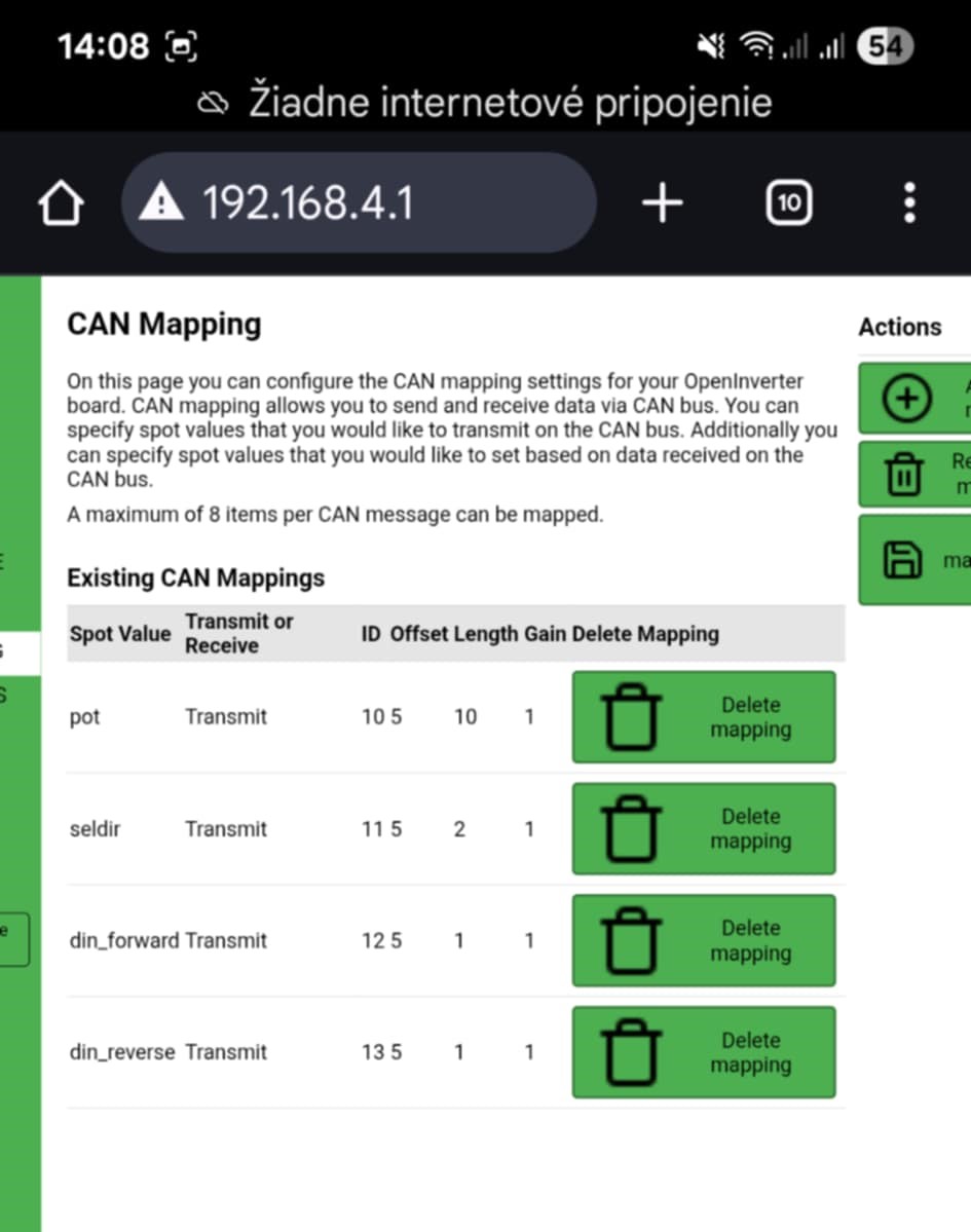

I was 0% sucessful with pot value, din_forvard and din_reverse. This is my MG2 configuration, MG1 is the same, but direction is Receive.Image
Can you help me configure canbus to corectly send, receive a use data by MG1?
So, this are my 2 biggest problems: no spin from MG2 anymore and how to spin MG1(no physical pins).

viewtopic.php?p=83442#p83442
these are my mappings that I am sending to the screen and they work. hope it helps.
