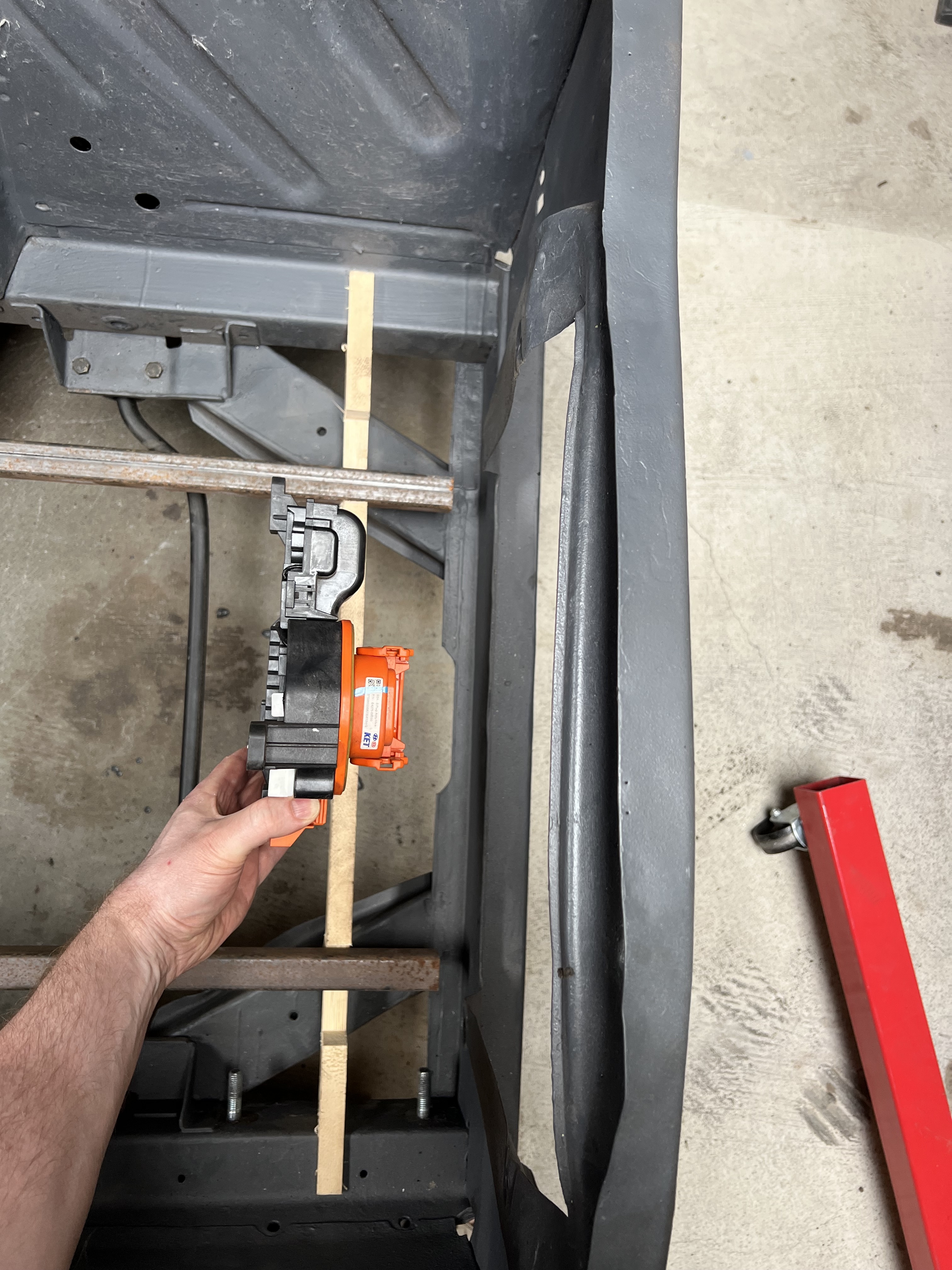

marcexec wrote: Tue Jul 22, 2025 8:53 pm Any (awkward) pictures from the bottom?
Awkward undercarriage pics coming right up :)
That rib is what the old transmission mounted to at the back. It lines up amazingly well. I'll still need to move the motor rearward about 20mm, but it's still basically spot on.
The car is a little nose up at the moment, so the rubber thingy will move a little away from the tunnel.
I'm trying to take a pic here where the bottoms of the two frame rails are lined up. If you look closely you can see a little bit of the oil pan from the motor peeking out. Like I say, I'll have to move it back slightly, which will mean moving it down slightly, but I think I'll get away with this.
marcexec wrote: Tue Jul 22, 2025 8:53 pm Also what rubber mounts are you using, the ubiquitous gearbox/engine mounts for the classic Land Rovers?
Yep, handy to get, should do the job just fine.
marcexec wrote: Tue Jul 22, 2025 8:53 pm Also for the disconnect, is there no space at the front left or right? or would that be problematic as it should be mid-pack?
The internal cabling bit will be fiddly no matter what I think. I'll probably need to get more of the internal pack cables from BMW and chop them up to make the safety disconnect work. I'm more thinking about where's the best place to put the disconnect where it's accessible but not too much in the way. And which way to arrange things inside the pack to be space efficient.
I could possibly put it at the front, but it's pretty tight and I think it would be awkward to get out. I'll still have to put a rad in that space. Actually, now that I think about it, it won't work at all. It would need to be forward of that bit of wood as that's the front of the battery modules.
The only thing I plan to put to the right of the pack (at least for now) is the header tank for the coolant loop. So there is a fair bit of room there. That would allow me to make the pack less tall. I need to do a Jamie Jones on this, climb into the engine bay, close the bonnet and measure the clearance from the inside (minus the locking myself in part :) )
There's space to the left, but that's where my 12V batt, fuses, relays and so on will go.

I also need a rubber mounting thing for the rear of the motor (orange box). I just have a block of wood in there at the moment.

Just a quick update to post a few pics of the battery box progress over the weekend.
Cutting out the lid ...
Cutting out the other panels ...
Still to do on the battery box
* Lifting eyes
* Cutouts for the plugs + mid-pack disconnect
* 'bump' for the fuse (part of the mid-pack disconnect)
* Tabs on the bottom to the hold the thing in
Another test fit in the engine bay, including the HVJB ...
Testing the hood clearance ...
Some other random pics ...

Building your battery box this way is a lot of work, I built a couple this way but the last one I just cut the sheet steel like an opened up cardboard box and folded the corners with the help of some angle grinding along the fold lines.
For the locations I was putting them they are strong enough without the angle iron.

Alibro wrote: Tue Feb 03, 2026 5:09 pm Building your battery box this way is a lot of work, I built a couple this way but the last one I just cut the sheet steel like an opened up cardboard box and folded the corners with the help of some angle grinding along the fold lines.
Yeah, that's fair. The box is fairly overbuilt. There are people here doing oragami with some thin ali and that seems to work just fine. Maybe for conversion #2 I'll buy myself a little manual sheet bender and go that way ;)
