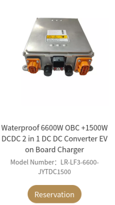

@johu I am looking at a Charger form China and the seller said that they have a CAN version. Can I control this charger with your BMS?
CAN document attached.

I used that charger type before. It is Elcon CAN protocol at <1000ms interval.
The charger expects every second to receive a CAN message from the BMS with extended CAN ID 1806E5F4 and 8 data bytes with voltage and current required. For example 98V and 16A would be 980 = 03D4 hex and 0160 = 00A0 hex so the 8 data bytes would be 03D4 00A0 0000 0000. If the charger does not receive a valid CAN message in 3 seconds, it stops charging
Here is the wiki for BMS
https://openinverter.org/wiki/16-cell_BMS
This BMS works with CAN bus at 500kbaud speed. If you would want to use this with your charger you would have to use all components on the same line at the same speed. What is your charger communication speed? I see multiple options...
I am sure it would not be difficult to program a BMS to output 0x1806E5F4 telegram when in charge mode. Also there could be a status check so that if there would be an error the 0x1806E5F4 msg would cease and charger would stop....within 3s...

This is the Chinese version of the ELCON, I guess.
Was trying to find out if I can send a custom message from the Open inverter BMS. not sure if anybody tried it.
If this works then I can reuse this charger in the future for a different voltage if needed.

Your options are...
1. connect charger to BMS CAN bus line at the same speed and reprogram BMS master to send charger command telegram and insert stop conditions
2. use a different CAN controller to observe BMS and command charger on the same line...
4. the same but with dual CAN lines to bridge different BMS and charger CAN

If I remember correctly with charger command there is one byte that has to be 01 or 00. And 00 means stop. So if you could couple that byte to BMS state you should be safe in case of any overvoltage...

imo for a proper charger handling some more logic should be added, i.e. target cell voltage (some people want to charge to 3.95, some to 4.15), chemistry type, some way to monitor abnormal temp rise, actual CC/CV curves depending on chemistry. For my flatpack charger I am handling this all inside of the charger, relying only on high/low cell values and temperature values.
For simple go at one constant setpoint and current it should work as is.
