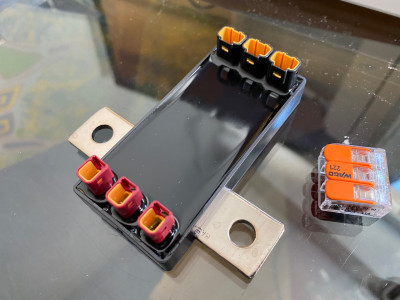

I ordered the Isabellenhütte IVT-S shunts directly from the manufacturer. Got a much better pricing and have a few of them available if there is interest. Won't post the price publicly so PM me if you are interested.
https://www.isabellenhuette.de/en/preci ... vt-series/

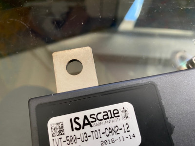

Updates on the shunts. The 1000A shunts are all gone now. There has been interest in getting more of those so should I get total interest for about 8 more of them I will put in an order (they come in lots of 12).
Meanwhile I have managed to source new and unused but an older model of the 500A continuous (730A 5min, 860A 30s, 1000A 10s, 2700A 1s, 6000A 200ms) rated shunts. Hit me in private for the pricing. Exact model IVT-500-U3-TOI-CAN2-12.

I'll PM you, put me down for 1 - IVT-500-U3-TOI-CAN2-12. Thanks.

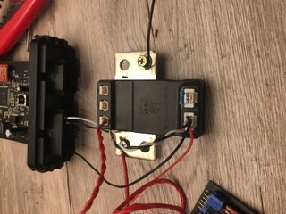

Just a quickie, My IVT-S just arrived and I’ve rigged it up to DM’s Leaf VCU board running V1.5 firmware.
http://media3.ev-tv.me/ISA.zip
I tried editing the file by replacing “ISA2.h“ with “ISA.h“ Within the code but I might be using the wrong file.
Does anyone have a correct version of ISA.h to work with the IVT-S shunt please?
The board communicates with the ISA Shunt through the ISA.h file. The only version I could find of this file is from EVTV But it had some issues with it:http://media3.ev-tv.me/ISA.zip

Some comments on the photo;james@N52E01 wrote: ↑Sat Jun 06, 2020 3:22 pm Just a quickie, My IVT-S just arrived and I’ve rigged it up
(1) you have a red twisted pair cable going to the shunt voltage measurement pins. Can you confirm these wires are shorted together not from different voltages?
(2) It looks like you have a CAN termination resister installed. Is this on the two centre or two outer pins? It's not clear from the photo.
(3) Can you confirm you have the ISA Shunt without internal CAN termination? I don't know what part was supplied to you.
** recommend you test at low voltage and with current limiting resister to begin

1) yes the voltage measurement wires are twisted just to keep them out of the way but they both go to the same point as per the wiring diagram.
2) The 120R CAN Termination resistor is across pins b & c (the middle 2) which I believe are CANLo and CANHi according to the manual.
3) Yes this is a non-terminated CAN shunt. The model number on the shunt is IVT-S-1K-U3-CAN2-12/24.
The CAN2 means non-terminated according to the manual. Good call on the current limiting resistor, I’ve gone for a 12v bulb.
I believe they are internally shorted so I’ve just used 2 for redundancy.2) The 120R CAN Termination resistor is across pins b & c (the middle 2) which I believe are CANLo and CANHi according to the manual.
