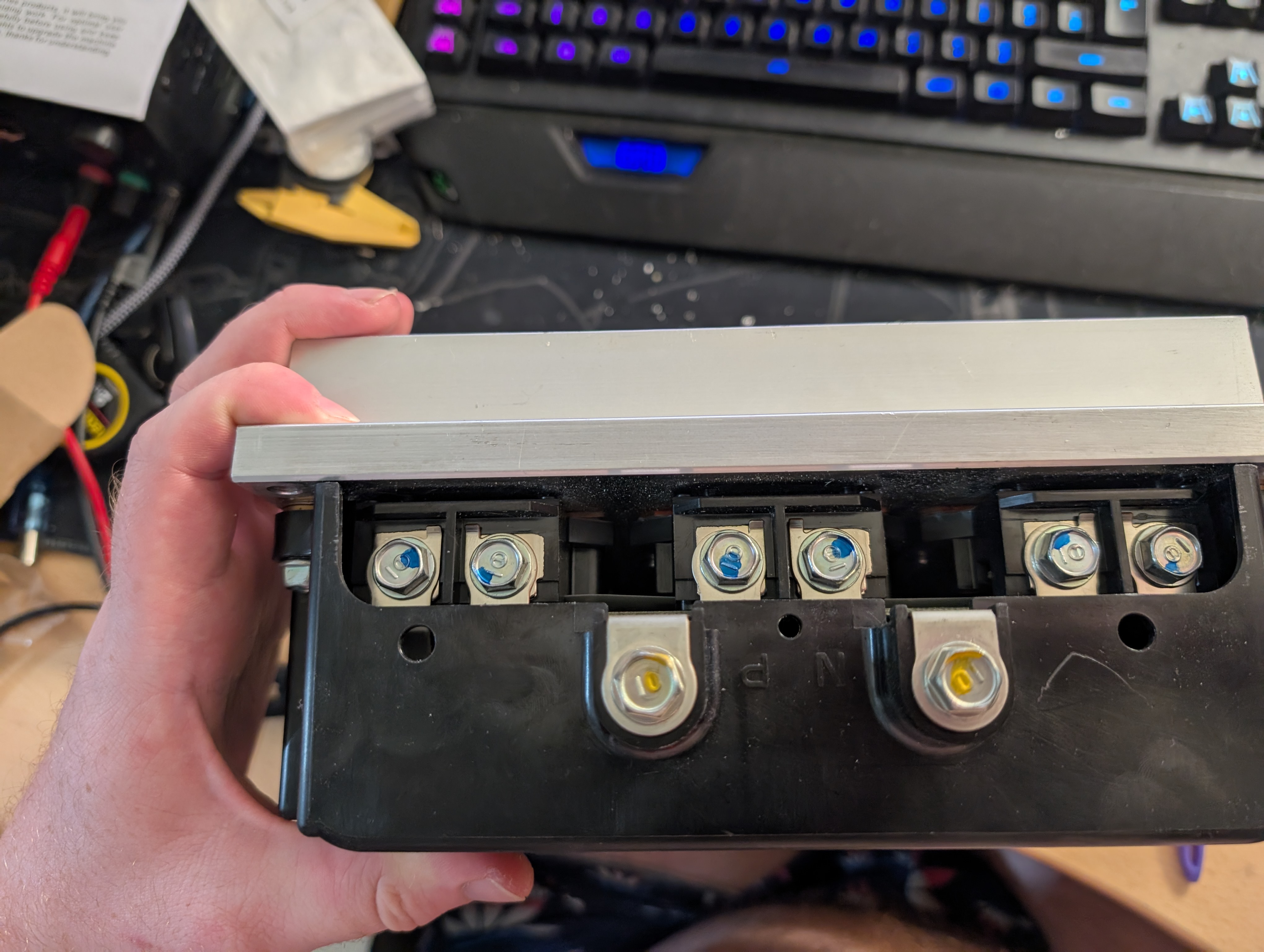

As the subject suggests I am doing a drop in board for the HCH2 IMA inverter. Goal is 300v at 300A to drive the nuts off of a Hyundai HSG on a kart / bike.
My rough goals were:
Resolver input
Sufficiently isolated DC bus measurement.
Be safe enough to allow random oiks to operate it.
Be a standalone unit, I don't want a separate VCU if I can help it.
Plan is for it to be a direct drop in board. The likes of lebowski and Romale has been excellent inspiration, but I dislike using jumper wires from one board to the next. So direct mount PCB is what I am going for.
The lobotomised HCH2 inverter. Gate Drive circuitry still operates with 15v going to all the gate drive pins. Documentation suggests 16.5v but even before I modified the board mine was only ever 15v. (@12v in or 14v in still perfect 15v gate drive. I guess different revisions?
Haveing a 3d printer is instrumental to rapid prototyping. I can export the PCB in 3d and then rattle off copy of it in half an hour. Really helped line up mounting holes ect.
Mini mainboard fits but only with super low profile pin headers. I am using some from mil max that are nearly £1 per pin. It would be nice if the mini mainboards holes were enlarged to accept the much cheaper stacking headers but that's a different matter.

So I couldn't really wait to do things. So like a kid at Christmas I stayed up till 2am playing with things.
Really nice alignment over the existing gate driver connections.
Showing the enlarged holes for the stacking headers I am quite partial to using.
I think this picture was me showing how the mini mainboards through holes could be enlarged to accommodate the stacking headers, would make diagnostic activities far easier. I suppose with Johannes looking to hand over HW activities will be for a future person to decide.
Soldered in nicely.
It's alive. No motor spinny things yet but hopefully soon when the order arrives with the SMD components.
It fits back in the standard box, (which is good, the lid has all the DC bus film caps so it's pretty essential)

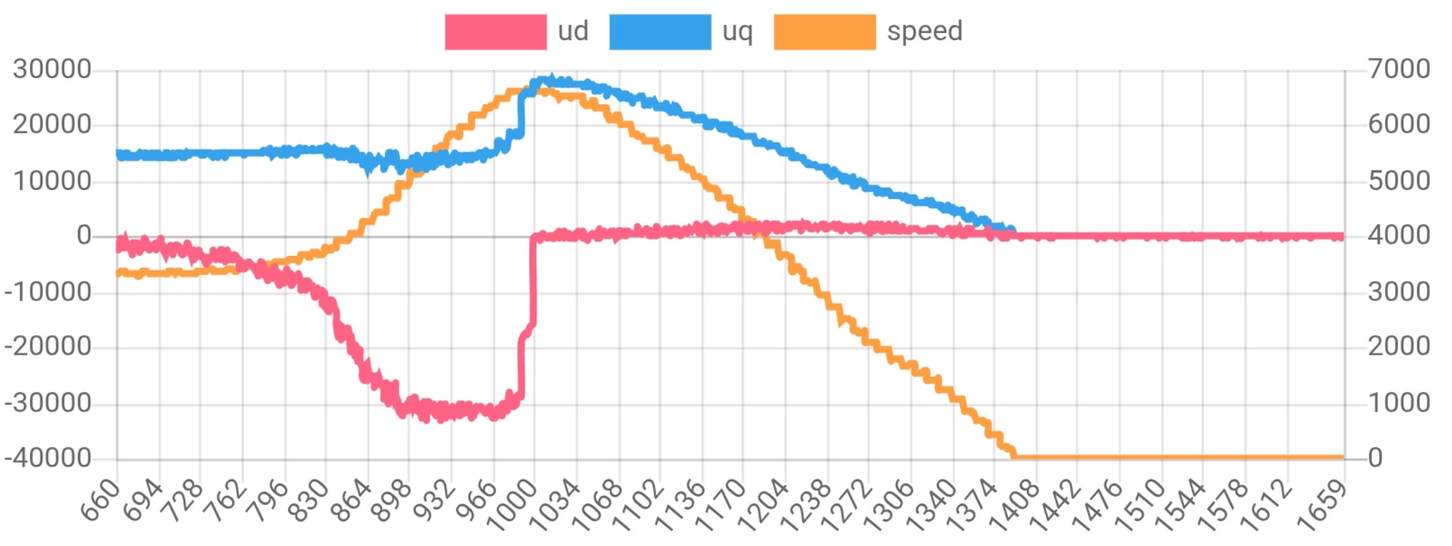

Very rough syncoff tune didn't have any inverter cooling so didn't push it past 60A
Runs on the throttle pedal but jolts into self acceleration over a certain rpm so is probably the sync offset not being 100%
Alarmingly the estop doesn't seem to do anything. I have wires it up and tested it. In the spot values it changes from OK to ERROR when push but it doesn't stop the pwm output.
Any help / insight on that would be great. Really don't want to put it on anything till the estop works.
Other then that going nicely.

Oh shiet. Estop triggers hardware PWM stop. But... During the chip crisis the 3-channel nand became unavailable so I disconnected estop and used a 2 channel one. Then never reverted the change...
So first SW task for new maintainers: software stop when estop goes low.

I have noticed a few other oddities, motor feels like mechanical grinding in reverse when inverter is enabled, both moving it by hand or with throttle command. but with inverter in standby mode it feels flawless. possibly sync offset thing.
However I did see a development firmware that applied sync advance twice in reverse to solve some issues, don't know if that applies here?
The sync offset tuner does nothing, but putting manual id in from parameters still works

Yeah deffo sync offset needs better tuning. swapped 2 resolver wires. then had to swap 2 motor phase wires, strange notchy mechanical feeling now in opposite direction. motor turns the other way in forward and sync offset re-tuned to be approximately 32000 more, so reversed as expected.
not sure how to do better sync offset tuning as motor has really strong cogging. 62000 gave me very slow counter clockwise at 50A and 56000 gave me very slow clockwise at 50A . going up to 100A didn't get much movement after that.
Currently only testing at 50V will put another VW module on charge to test again at 100v see if that helps.

Have not seen you settings.
But the motor speeding up, is probably a result of not having sync offset right and having field weakening on.
If you set fwcurmax to zero. I should stop the motor from taking off.
This is not a permanent solution but for testing it might be helpful.

So, time to continue fighting the tuning, I have been coming up with what I think might be a bad way to validate Syncoff.
In one of Pete9008s post he says :
So I was thinking is there a way for me to easily see Vd? I can set regen to 0 spin the motor up with a drill and theoretically give myself a much better indication of how correct my sync is.If you are coasting (no throttle or regen, torque request of zero) then iq and id will be zero. If syncofs and syncadv are correct then vd will also be zero and only vq will be non zero (oops, sorry looks like I mistyped in the text quoted above).
So if you are coasting and vd is zero you can use the value of vq to calculate flux linkage.
If vd isn't zero then syncadv or syncofs are out, vq is coupling into vd and so any measurement/calculation based on vq would be wrong. Vd being zero is mostly a sanity check on the sync setup.

Think this is problematic because two variables need to be correct to get 0 Vd.
You can plot Vd on the web interface.
I tried this, and this is what I got:
When changing syncofs: note that at the point I stopped accelerating Vd goes to 0 but during the deceleration it rises a bit.
When changing syncadv:
