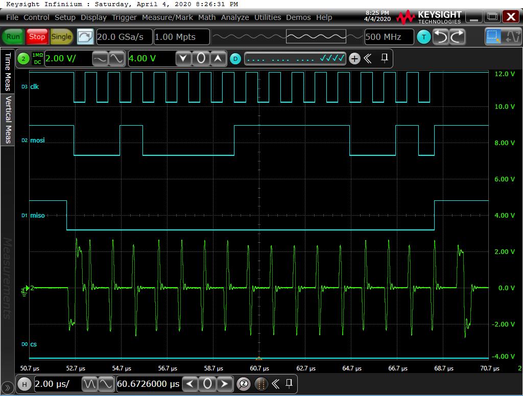

Re: Tesla Model 3 Battery Hacking
Here we see a full frame of data sent from the master (hv controller). From what I can see at a first glance this looks identical to the format described in the LTC6820 data sheet pages 11 to 15.
LTC6820.pdf
(1.85 MiB) Downloaded 391 times
Posts: 3831
Has thanked: 75 times
Been thanked: 696 times
So far the only anomaly I have detected is a pulse on mosi that is not encoded on the isospi bus ...
