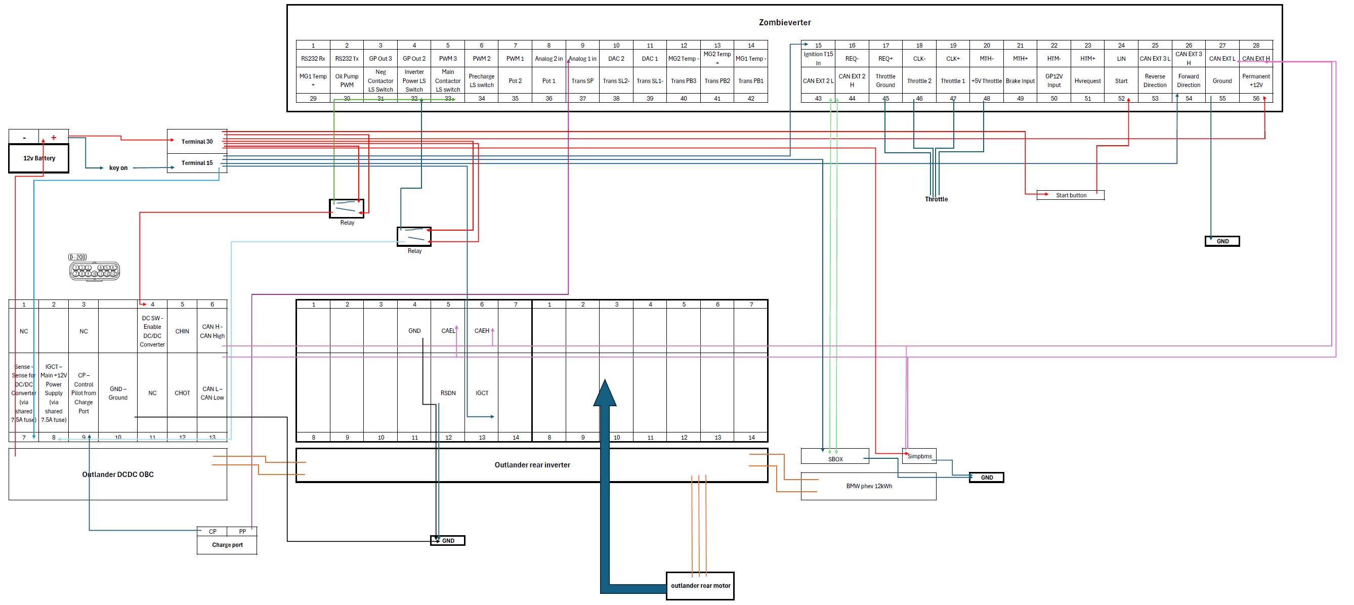

Hello
I have drawn a draft wiring of zombieverter witn outlander componants, I would appreciate if anyone can confirm specifically the below and maybe overall, any mistakes in my understanding? Some questions maybe dumb to some so please forgive me.
Outlander DCDC OBC:
1- the DC sense is connected to temrinal 15 (key is on)
2- DC enable is connected to Zombieverter (via a relay) main contactor (I'm using SBOX for HV switching)
3- IGCT is connected to Zombieverter (via a relay) inverter power LS switch (pin 32)
4- CP is connected to charge port cp (j1772)
5- DCDC output to battery (do I need a fuse or fusible link here?)
6- configuration for charegr on Zombieverter is (out_lander), i read before there was an issue with this but can't confirm if its now fixed.
Outlander rear inverter:
1- IGCT to termimal 15 (key is on)
2- coms to motor is OEM
3- RSDN to gnd
Charge port:
1- CP to OBC as above
2- PP to Zombieverter pin 9 analog 1 read (and configure the threshold in Zombieverter gui for charge on)
Simpbms:
1- 12 volt direct from battery (via a fuse of course)
I didn't add fuses to the drawing and I'm sure the drawing could be clearer
Any suggestions on this overall is much appreciated. Thank you!

Re: Zombieverter with Outlander
Looks alright, wire up the brake input too :)
Why is your forward directly selected by the ignition feed?

tom91 wrote: Tue Aug 26, 2025 9:09 am Looks alright, wire up the brake input too :)
I'm connecting the motor to a manual gearbox, so I would only need forward direction.
Would connect the brake, was missed on the drawing.
Thanks a lot Tom, really appreciate your contribution (not only to this topic)

Mhs wrote: Tue Aug 26, 2025 9:21 am I'm connecting the motor to a manual gearbox, so I would only need forward direction.
The only issue is that you also have full power in reverse gear 😬 very easy to break or smash into something. unless you plan to take the signal from the reverse lights and derate accordingly :)

Bratitude wrote: Wed Aug 27, 2025 4:13 am The only issue is that you also have full power in reverse gear 😬 very easy to break or smash into something. unless you plan to take the signal from the reverse lights and derate accordingly :)
Well that scared me a bit
How can the derate in reverse can be done? Any suggestions?

Perhaps a switched pull down resistor on the throttle?
Also the pp for the charge port needs a few resistors and you will need to set the ppval threshold. https://openinverter.org/wiki/File:ZombiePP.png

Bratitude wrote: Wed Aug 27, 2025 4:31 am Perhaps a switched pull down resistor on the throttle?
That's a good starting point for more research
Thank you, I totally forgot about the resistors although I have read it before, I should start taking notes for these things!

Alternatively, you could simply wire up a FWD/REVERSE button, only use the forward gears of the gearbox, and reverse by pressing the button.
Hi Tom
Is the brake input switched high (12v from the brake when pressed)?
I can't seem to find this information in the Zombieverter wiki
Zombieverter
Posts: 2962
Has thanked: 328 times
Been thanked: 847 times
You are right, it is not mentioned. It needs 12V like the start and direction inputs.
