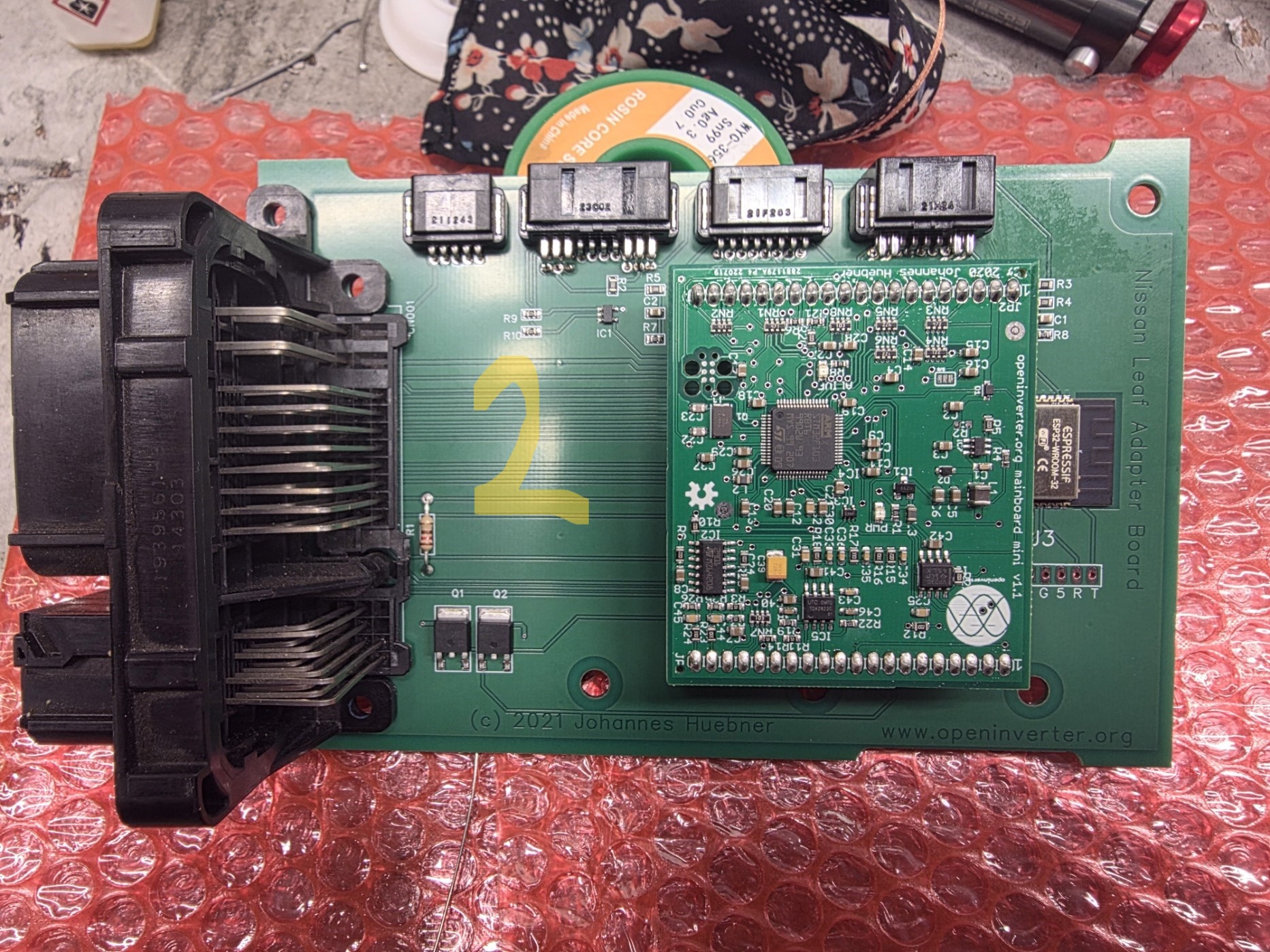

Had some time and decided to start soldering the Gen2 OI board.
Please bear with me as not totally tech savvy but will have a go. I have searched on the forum and will first before posting question.
Stupid Q1.

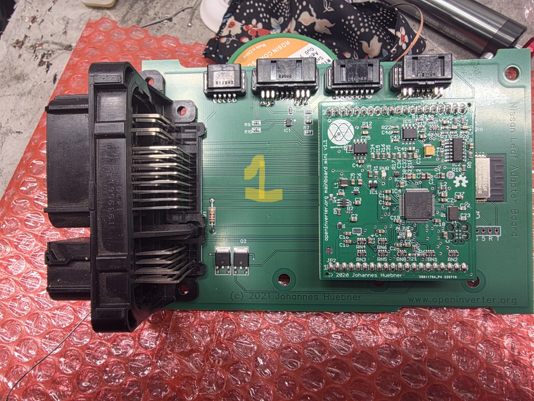

OI all soldered up, Which way round does the mini mainboard board fit onto the main board ?
Johu original pic has his original version , not the newer one.
Is Pic1 or Pic2 correct orientation ?

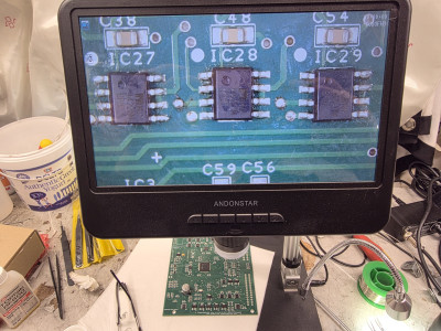

While I had the soldering stuff out decided to fit the Smd parts to the Zombie that I have putting off for so long, quite a achievement for me as have only ever fitted through hole parts.
Did take a few attempts before getting it right.

zippy500 wrote: Sat Aug 30, 2025 10:22 am Which way round does the mini mainboard board fit onto the main board ?
1
Is the outdated pic in wiki?

johu wrote: Sat Aug 30, 2025 1:12 pm Is the outdated pic in wiki?
Yes - I can try and add picture to wiki
