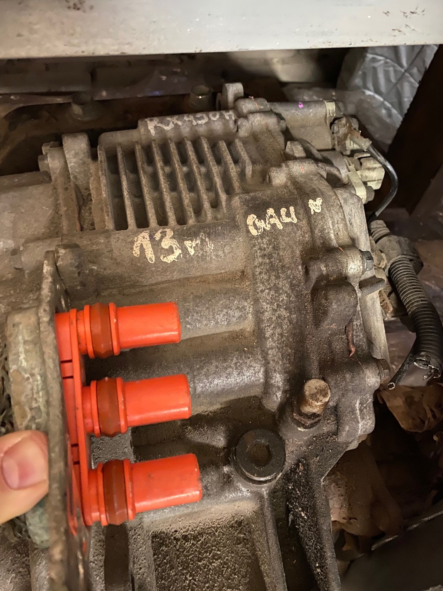

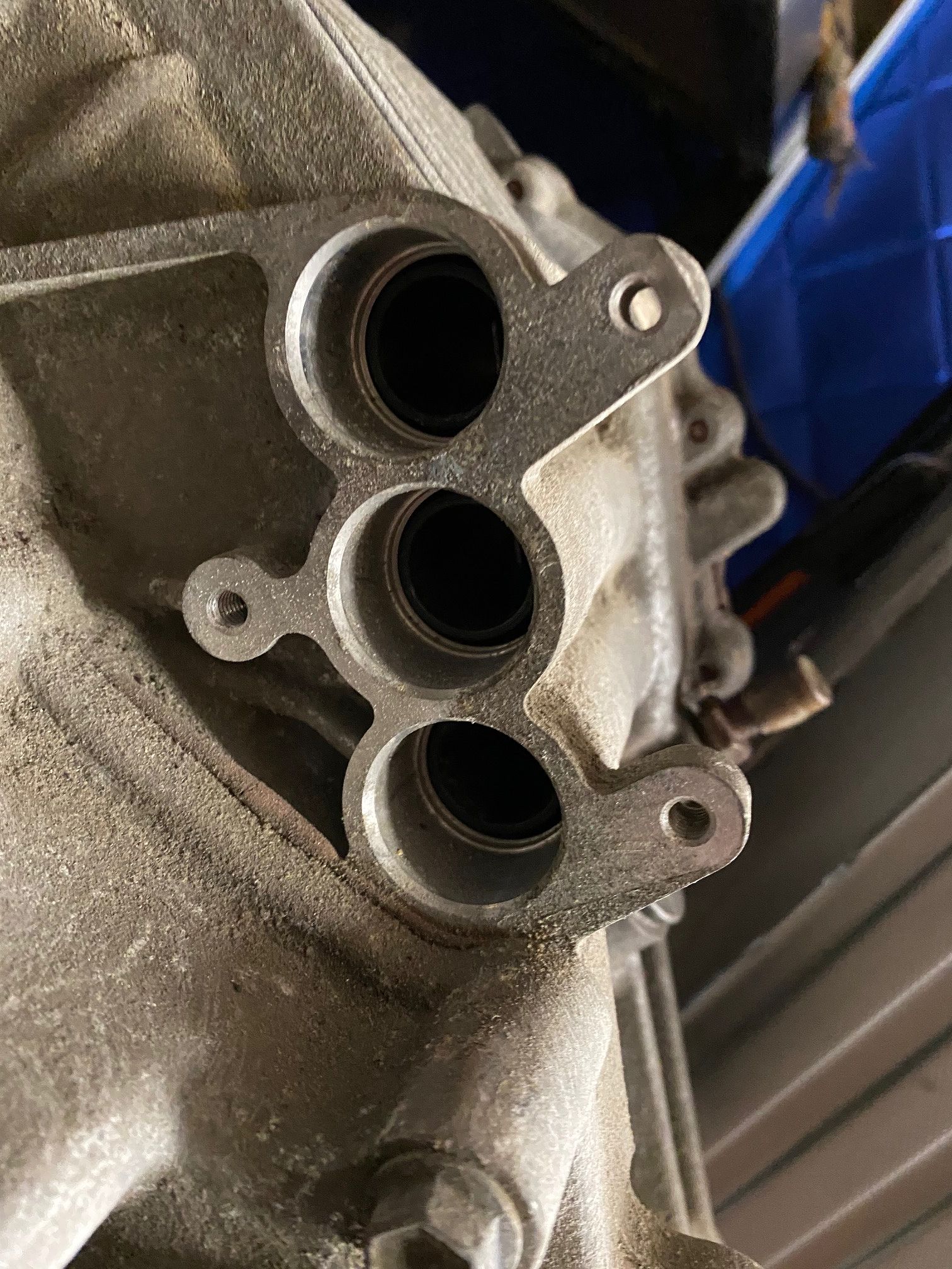

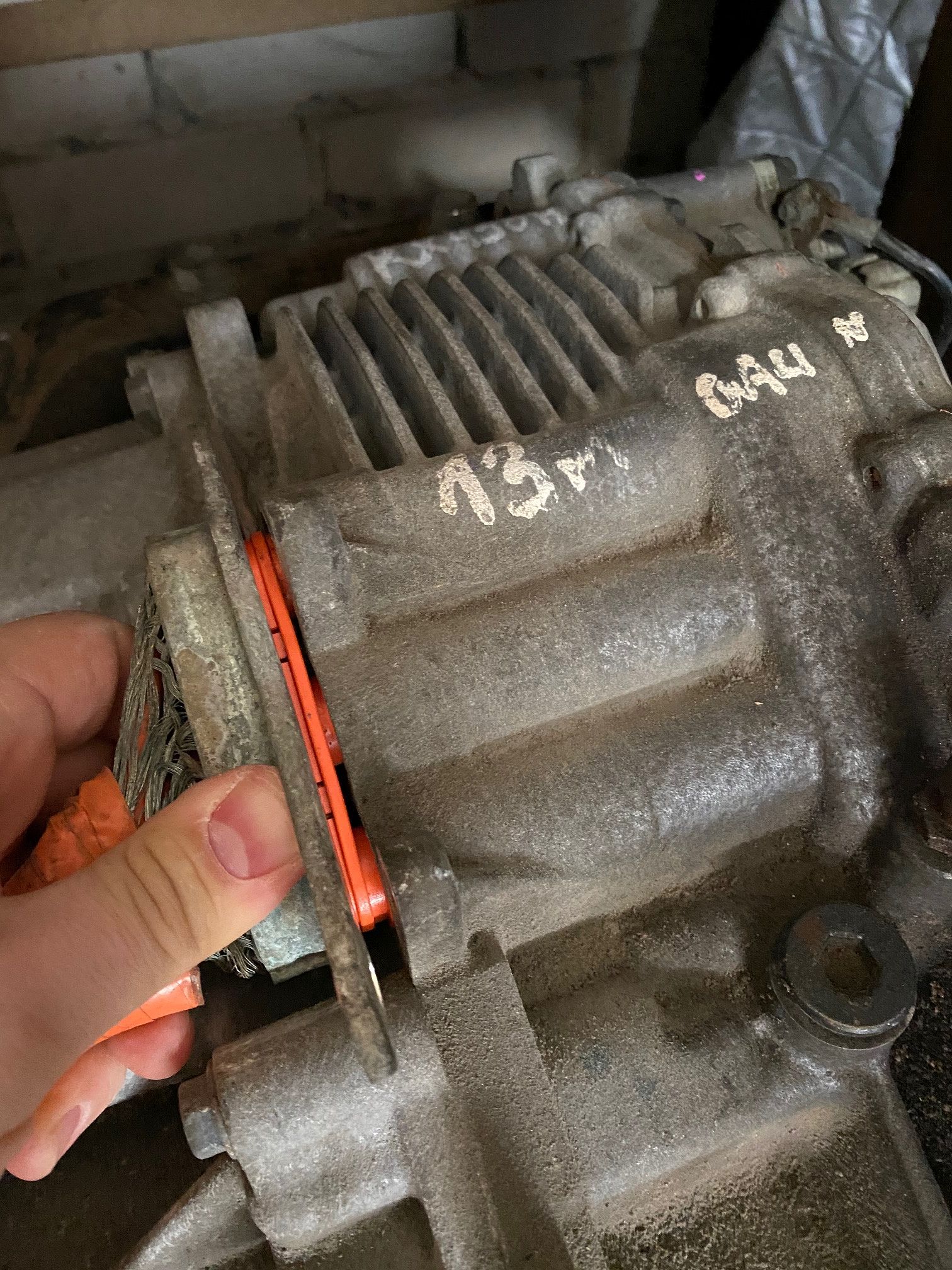

Has anyone encountered this problem with the MGR connectors. I have the 2FM from an RX450h and the cable harness from also RX450h (both are allegedly obv.).
But the motor connector does not fit. On the motor side there seems to be an extra 2cm or so of housing which blocks the contacts from being made. I assume there must be different connectors or different years had differences but if anyone has some additional info I'd be greatful. I'm considering butchering the connector on the cable side to three independent ones so it would connect but appreciate any experience before I go down that route.

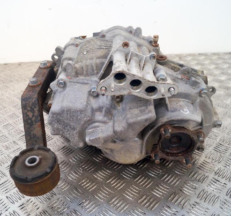

To answer my own question, it looks like mine is missing an intermediate housing connector. Like on this photo.
As things stand, it may be cheaper to get a new MGR for about 100EUR.

jnsaff wrote: Tue Mar 31, 2020 10:23 am To answer my own question, it looks like mine is missing an intermediate housing connector.
I've almost bought myself MGR without that connector as well, good thing, I've noticed it missing and there were some more MGRs to choose from.
I bet parts dealer will sell you that connector separately for 5-10 euros :D
