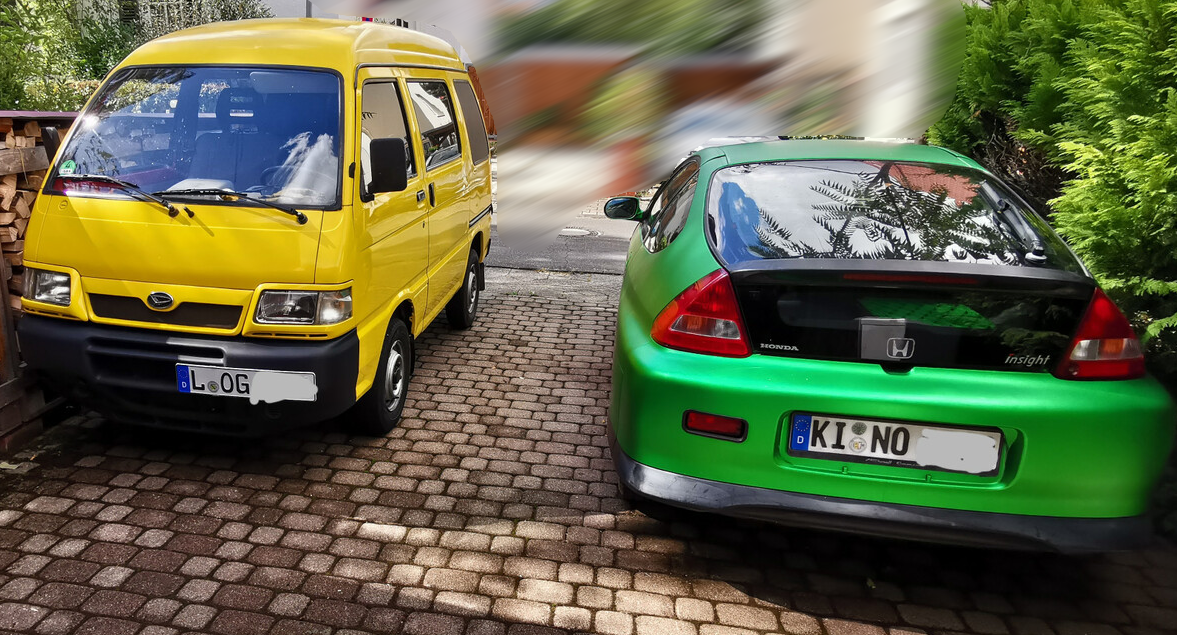

So, I am dreaming of converting my little runabout. It's a 2001 Daihatsu Hijet S85 Bus called Bruno. The guy I bought him from named him thus and it stuck, because it suites the little guy!😍
I will post some pictures, but I guess I cannot do that in my first post.
In Europe they were built under Licence by Piaggio and were also sold as "Piaggio Porter".
He has a 1.3l 4-cylinder petrol stinker, that I would like to deICE. 48kW is much more than the original japanese Kei trucks have. And with 1000 to 1550kg (empty to max) he is quite nippy.
I use him mainly to get my firewood from the nearby forest. So the stinker hardly warms up and as I am using electric chainsaws now, the exhaust annoys me.
I hope this can be an easy starter project, because I don't need much range or power. Apart from the fuel injection, which I plan to ditch, there are no electronics. No ABS, no power steering, no A/C.
