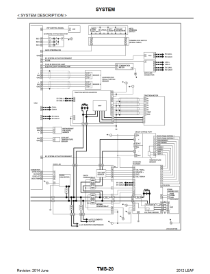

For reference, at least you can use this to check that the resolver is OK, if you haven't already.

J0hannes wrote: Sun Sep 07, 2025 8:45 am For reference, at least you can use this to check that the resolver is OK, if you haven't already.
Thanks, yeah I have that, the problem is numbering is not consistent. The connector itself has numbers that don't match up with the documentation, hence why I want to see the internal wiring. I've been trying to copy Damien's from his videos, but they're too hard to make them out.
I have tried using the numbers on the document, I've tried the numbers on the connector, I've tried reversing the pairs in as many permutations as I can .
I'm fairly certain I've found the pairs for s1-s4 and r-1/2, but I just can't get it to spin. My coils measure 38-40 ohms for s1-4, 15 ohms for exciter, and 15k for the temp sensor. No shorts to ground on the coils.

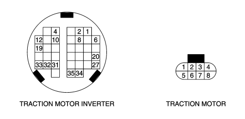

See the numbers here on the connector:

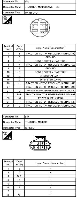

Post by J0hannes »
Oh no, you don't use the numbers on the connector 🤠
From FSM, use only the order explicitly expressed to be the connector you are looking at.
The Nissan connectors pinmapping seems to be typically harness side view.
To me, it seems that there are several connectors where the numbers embossed on the connector don't match the Nissan nomenclature.
With this approach, I've had zero problems with wiring work regarding Leaf connectors on my GEN2 Leaf based conversion.
For example the resolver wire colors seem to match the connector. This is found in the Power supply, ground and circuit elements annex.
