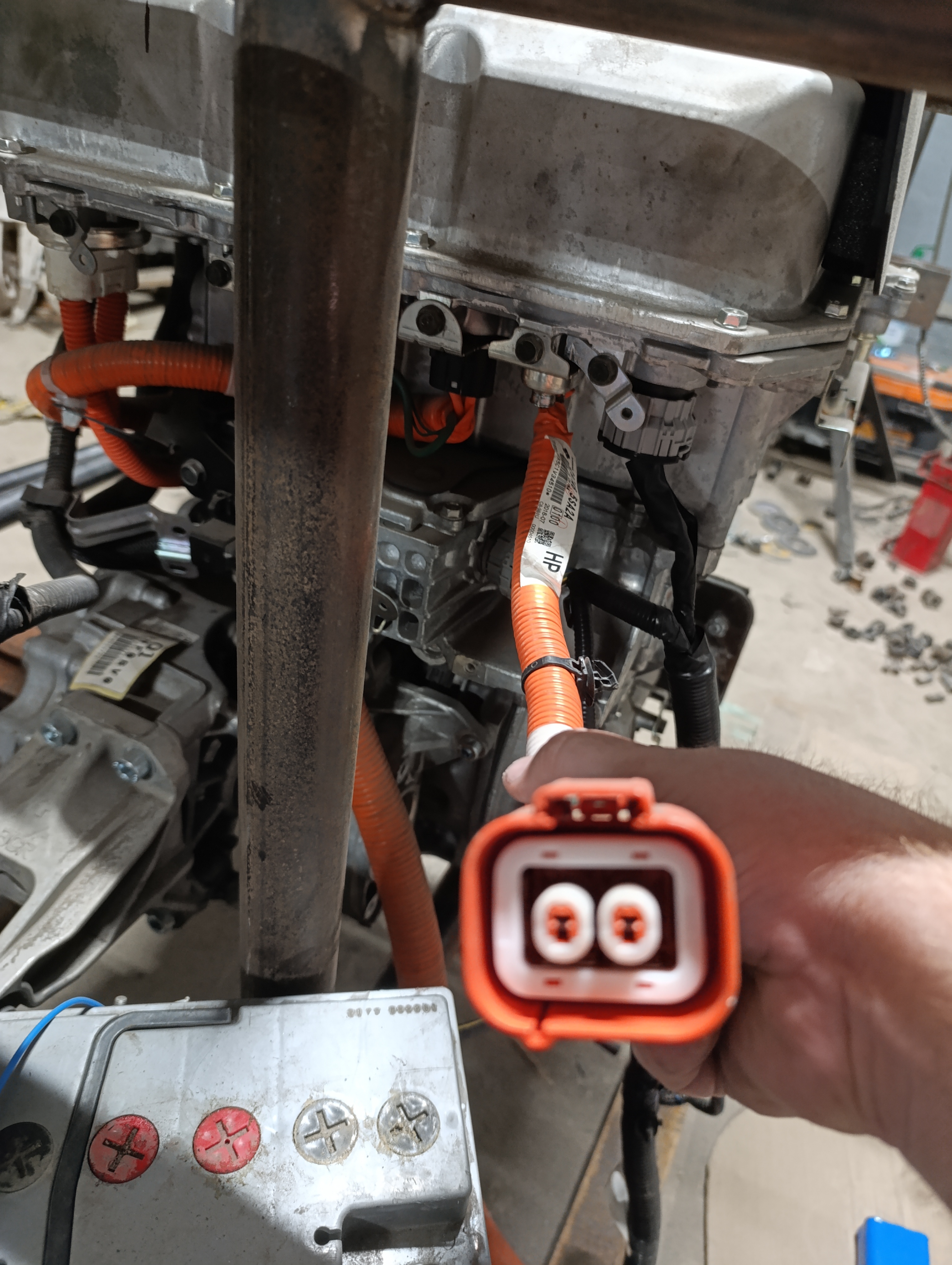

If the cooling system is not connected, how quickly does the engine heat up? Are there any coolant flow sensors in the inverter or engine? If the motor is hot, will the inverter shut it down or will it run until damaged? Also look at the web interface, which shows the engine speed as 16383 rpm. And I also wanted to ask about these connectors, what are they for? Thank you

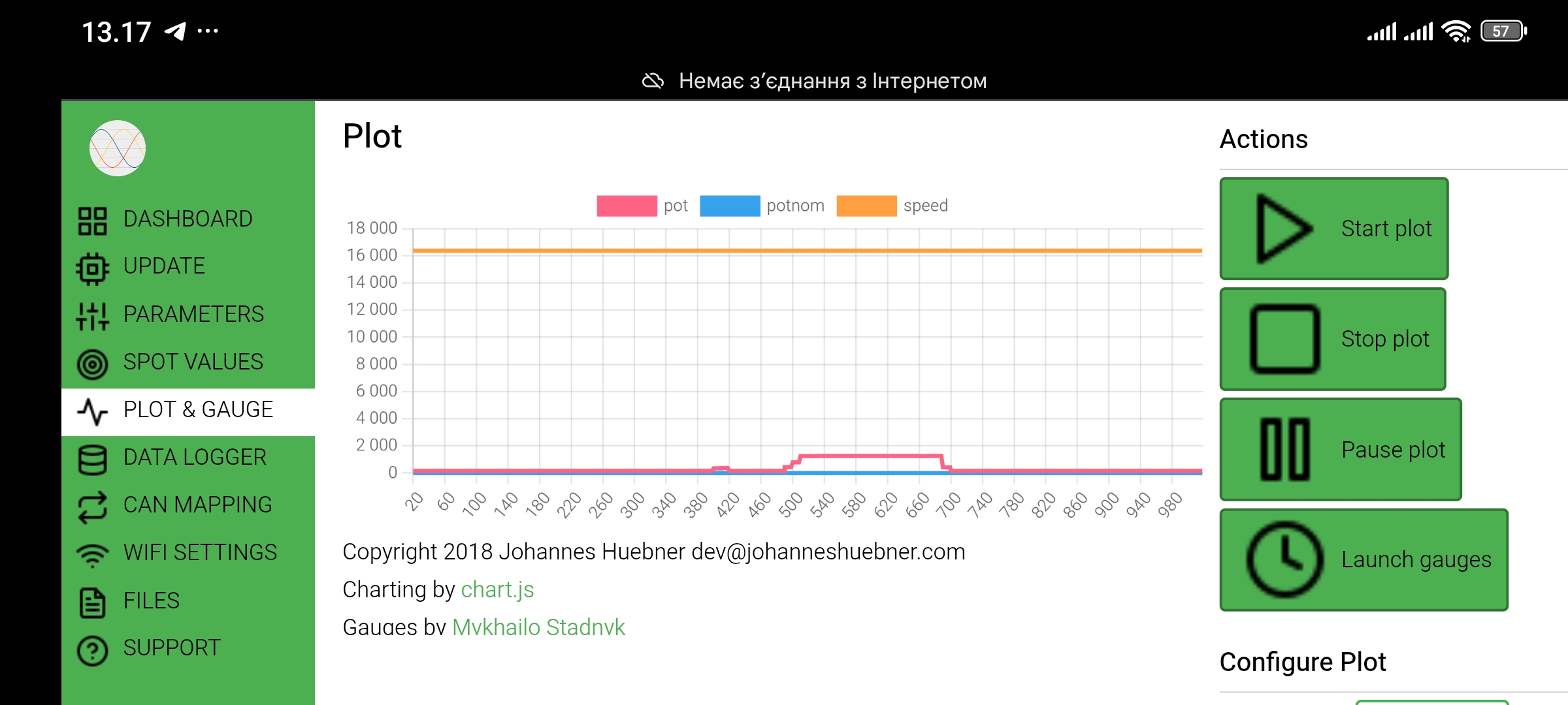

I make plot for Potnom, Pot, Speed. Potnom not changing, Speed 16383 rpm. System at start try -204 torque to stop engine. In parameters 1500 rpm start recuperate 100 rpm end recuperate. Maybe error from wrong speed parameters?

The plot does not show potnom changing, please make plot with torque. Does it go positive?

tom91 wrote: Sat Sep 06, 2025 11:55 am Yes but that is fine, once it is properly running it reports the correct rpm.
No, torque not go to positive.

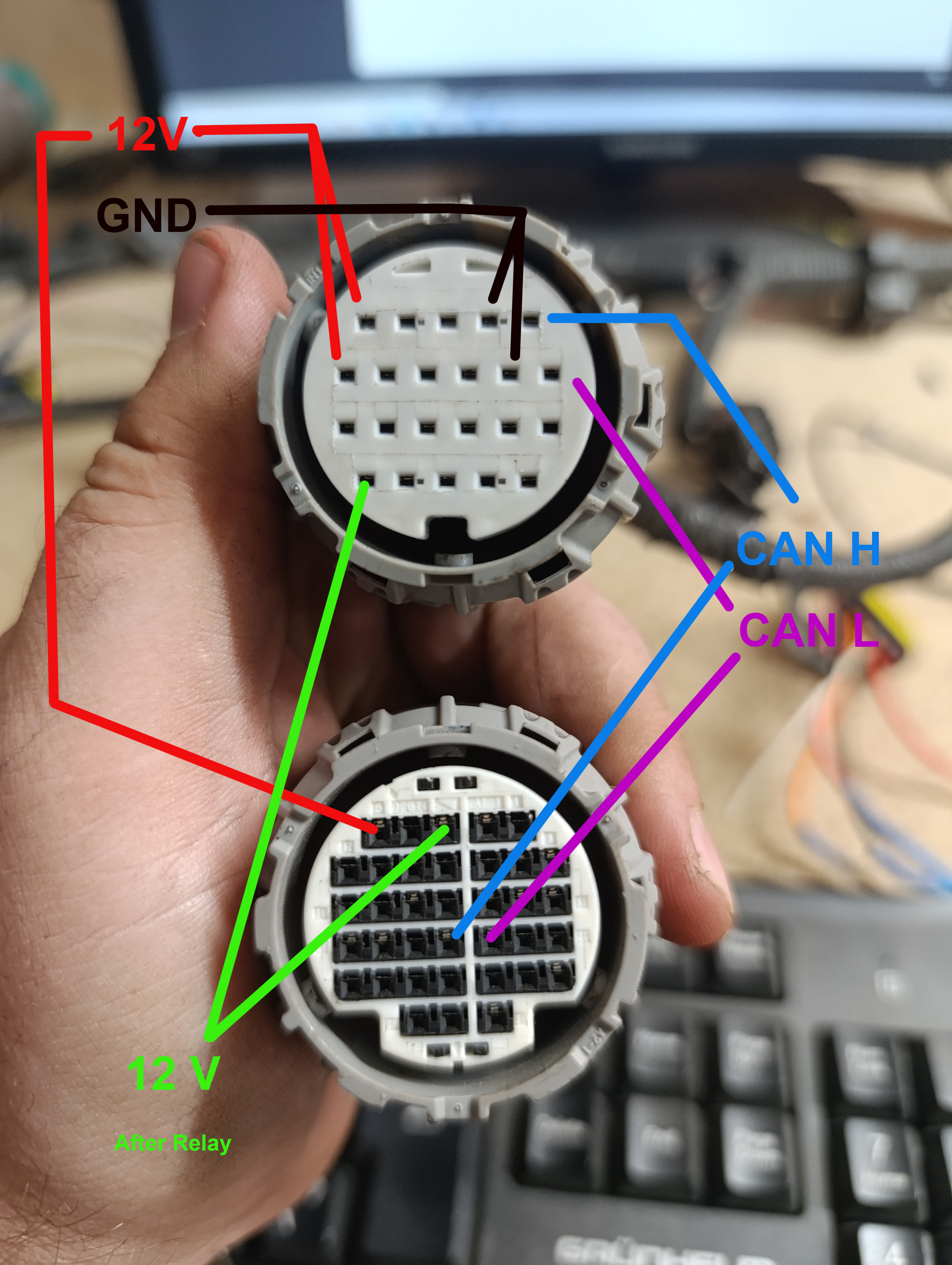

At this point you should provide an accurate depiction of your wiring set up/ and or photos.

I was just trying different settings, no BMS at this stage but it will be. I'll take a picture of all the wiring on Monday. Thanks for helping.

Hello. I took a lot of photos of the wiring. Honestly, it's hard to understand anything from the photos, so I tried to describe all the photos as much as possible.
