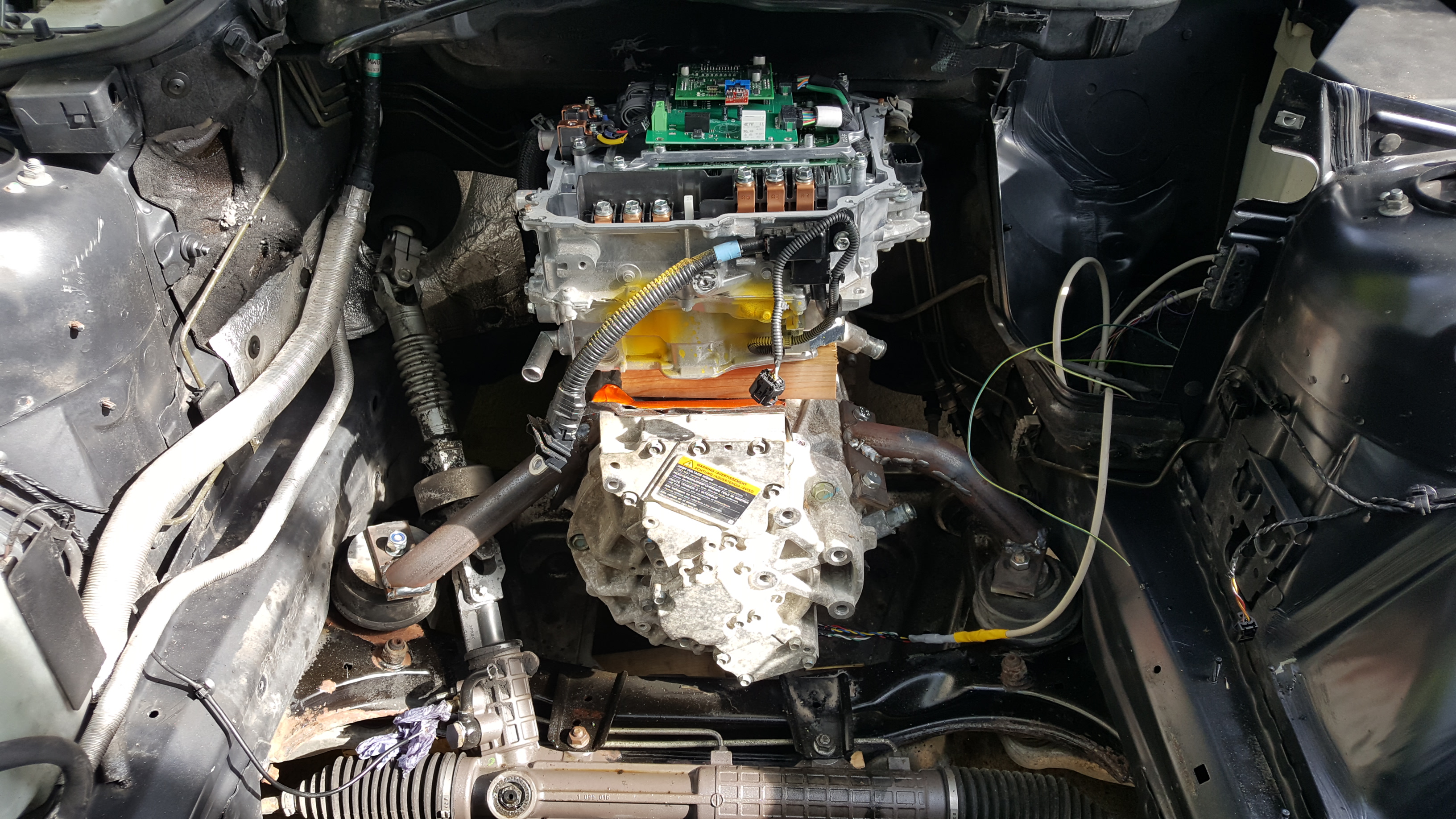

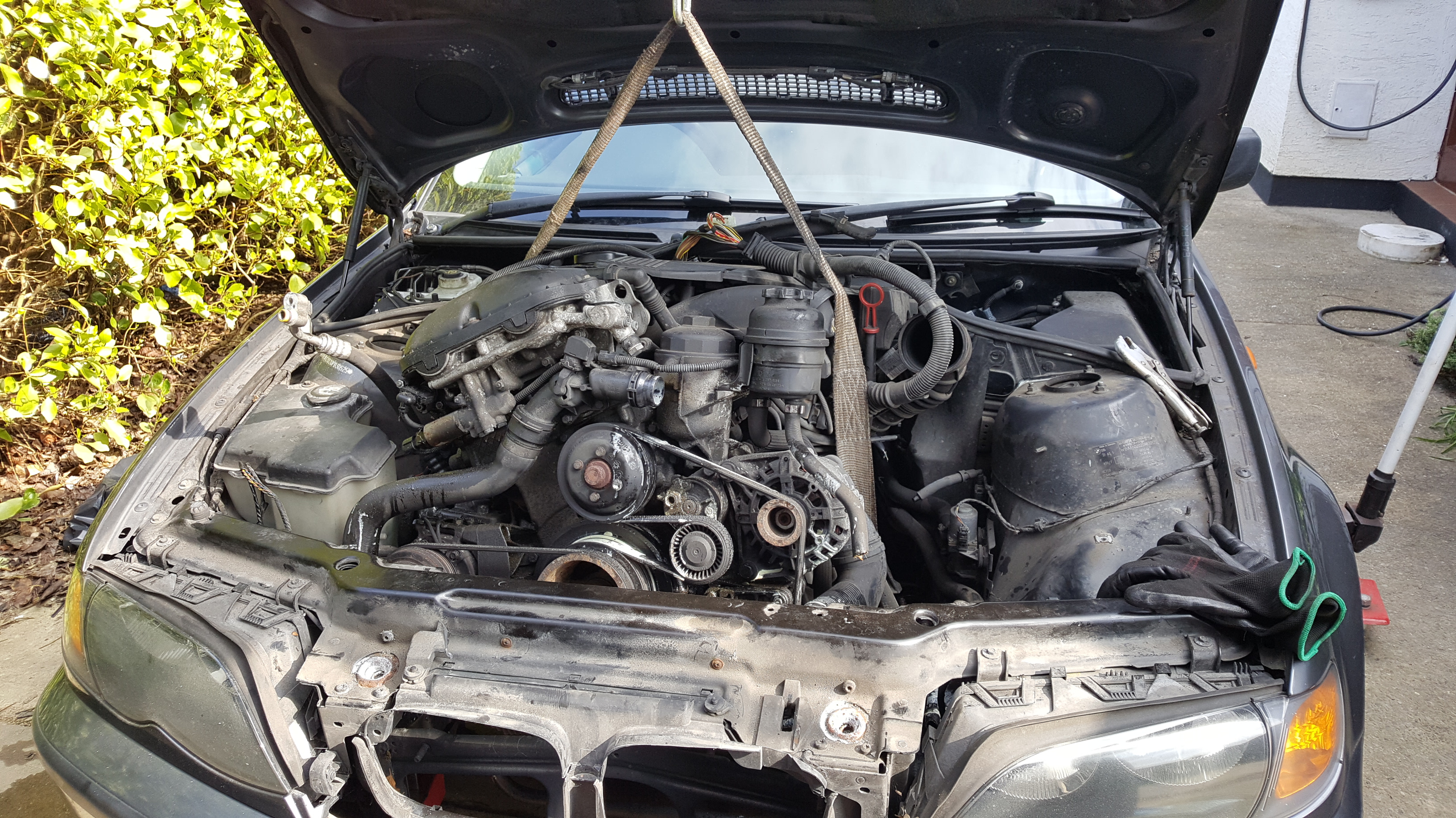

Another day, another EV project. This time we have a 2003 E46 touring formally powered by a mayonaise filled 2.2 petrol engine.
The plan :
Gen 1 Leaf motor
Lexus IS300h inverter
400v of LTO cells

Re: Nissan Leaf Powered E46 Touring

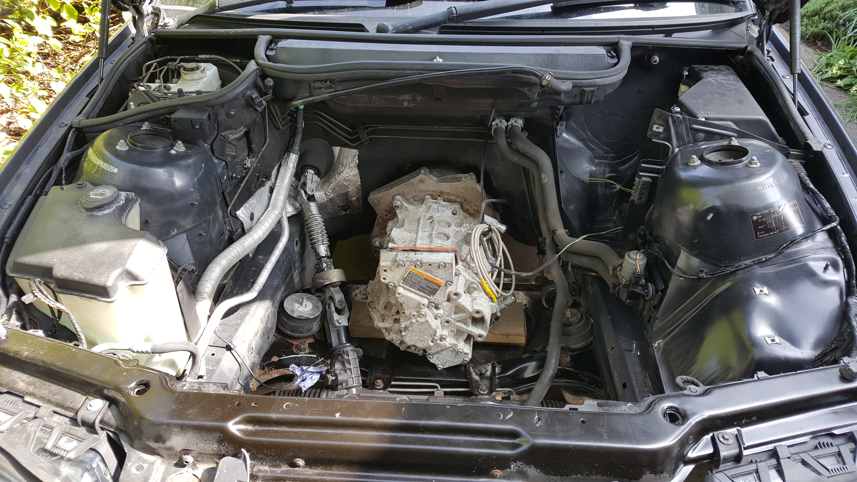

Motor and gearbox mocking up.

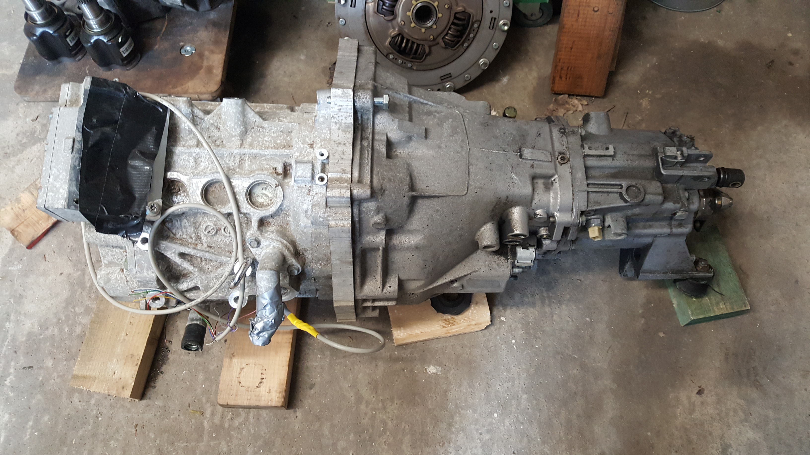

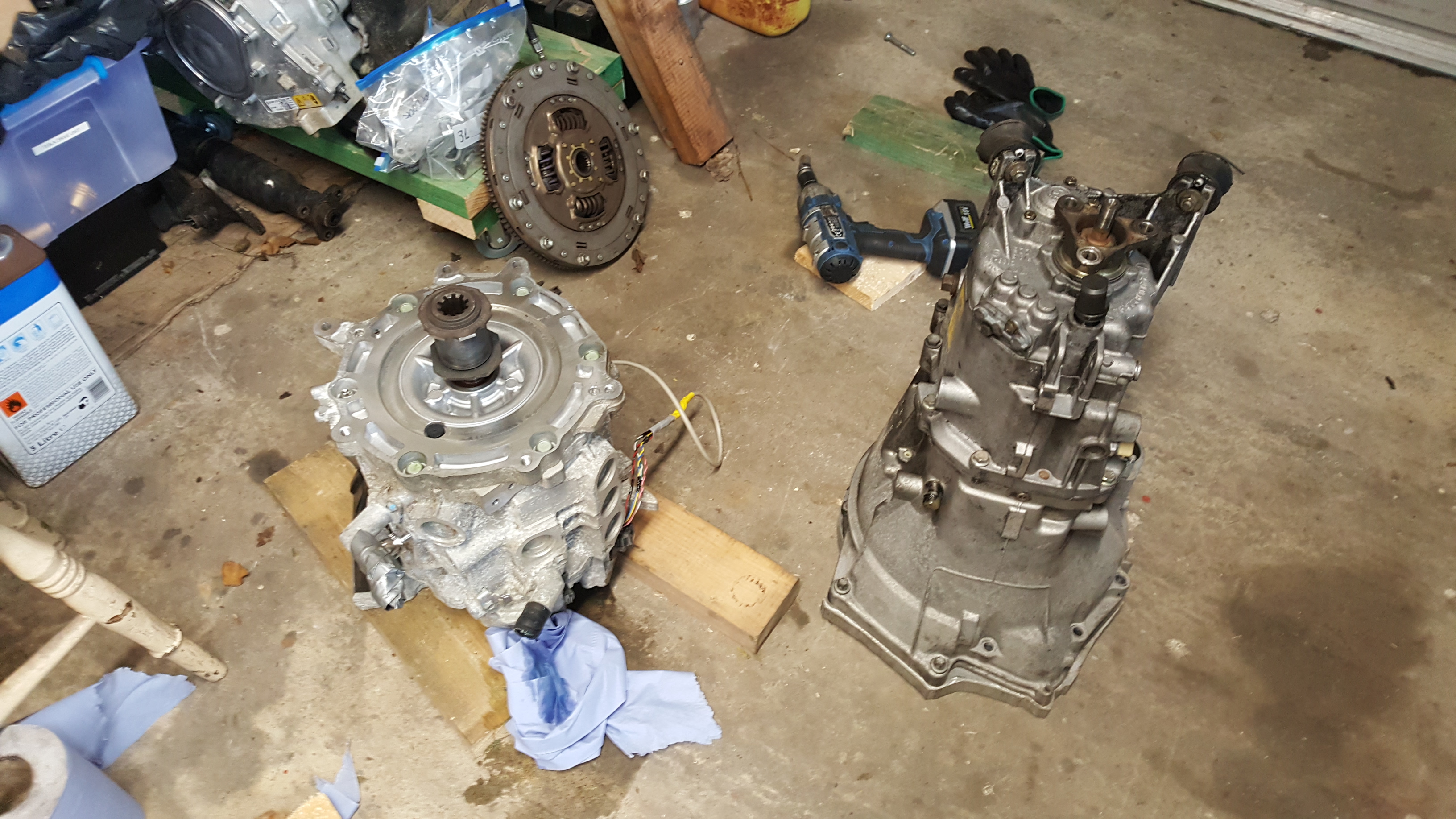

Forget $1400. I just did this in an afternoon because my brain was melted from learning fpga programming. Total cost about 100 Euros.
The lineup is easy. Sit the motor and gearbox vertically but only bolt one side. Motor or gearbox to the adapter plate. Then spin the motor slowly. any misalignment pushes the gearbox to the required position. The old guys did this with dc conversions back in the day. Only difference now is you need an inverter:)

Excellent work,
What coupler did you use on leaf spline shaft ?
Going to have a measure up later I think :D
Fiat multipla 1.6 petrol clutch friction plate. I did a shrink fit of the coupler tube onto it to help tighten the splines on the leaf motor shaft.

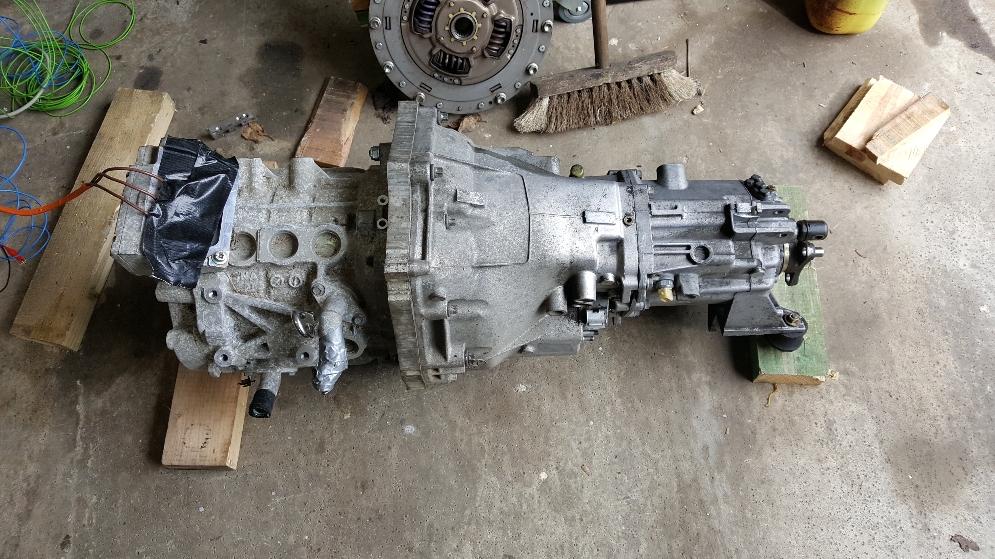

Motor and gearbox mated up and tested. Time to get it back in the car.

Thanks for the video , very helpful , was adapter plate tapped for the bolts ?
That's a nice simple solution to just put some weld on the shaft to stop the coupler moving

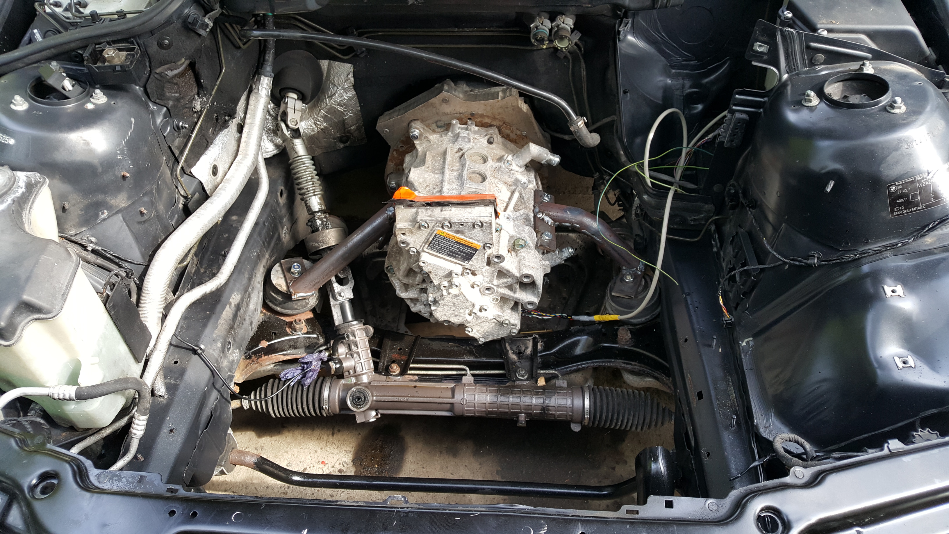

Back in the car and driveshaft hooked up.

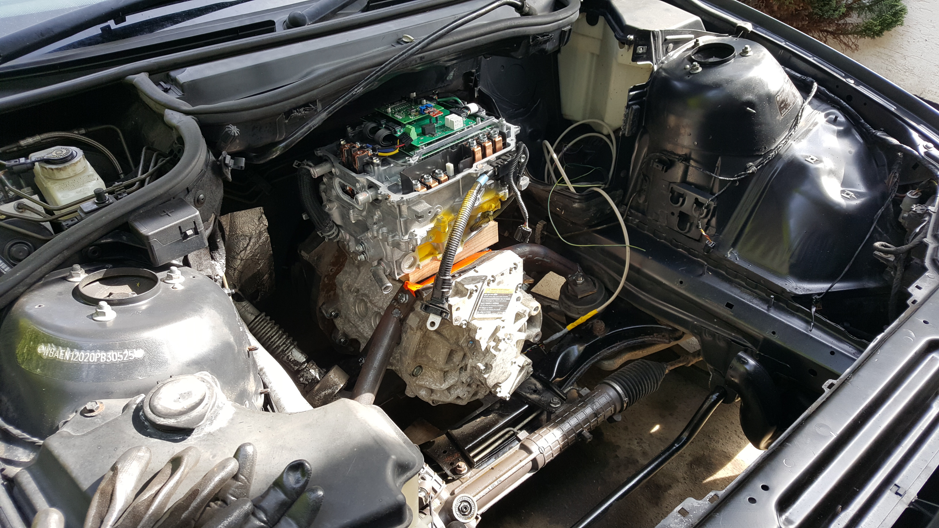

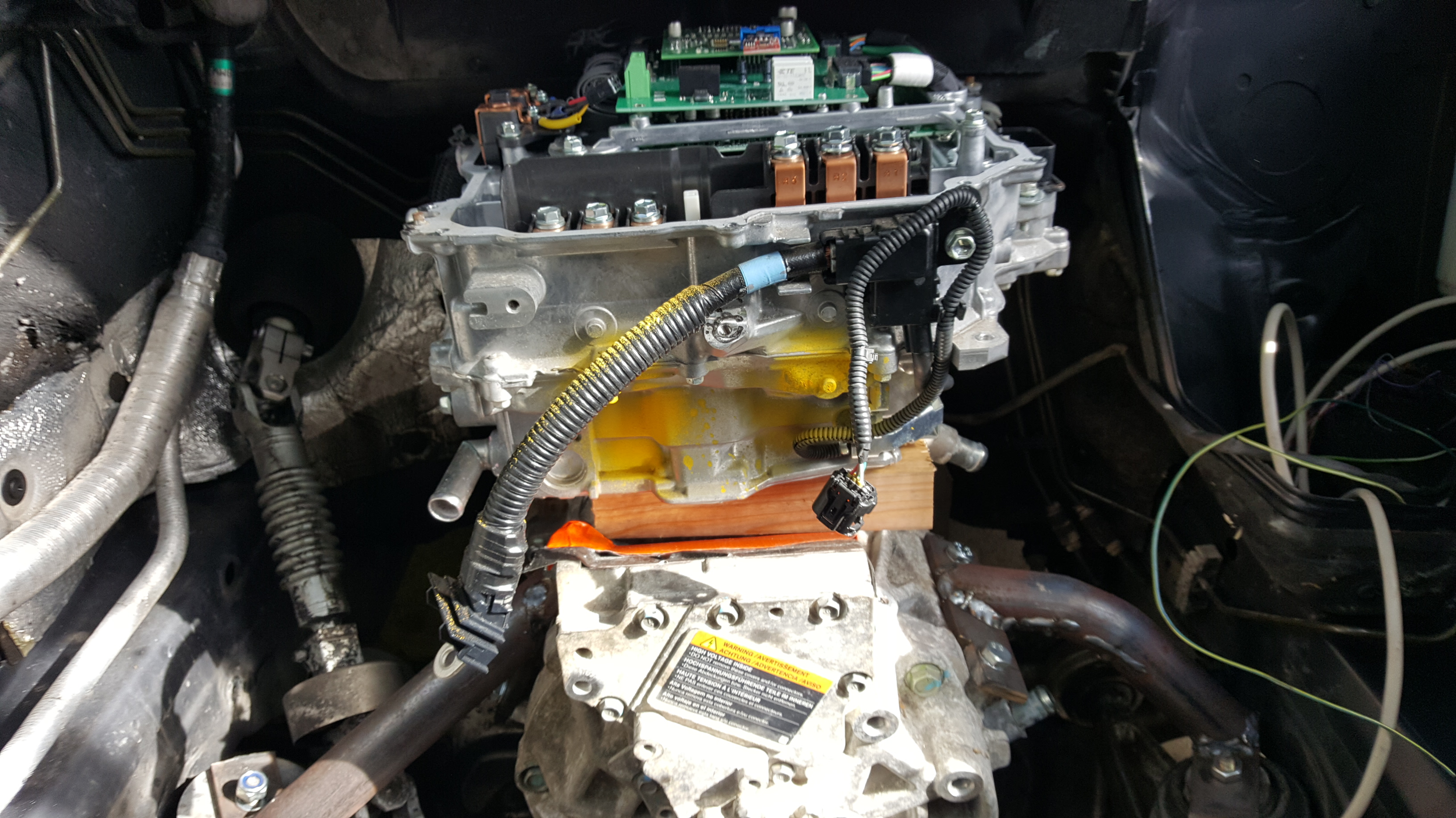

Some more progress. Motor now mounted and have started mocking up the positioning of the Lexus inverter.
Very nice diy motor mounts.
what are you going to fill the empty space with?
