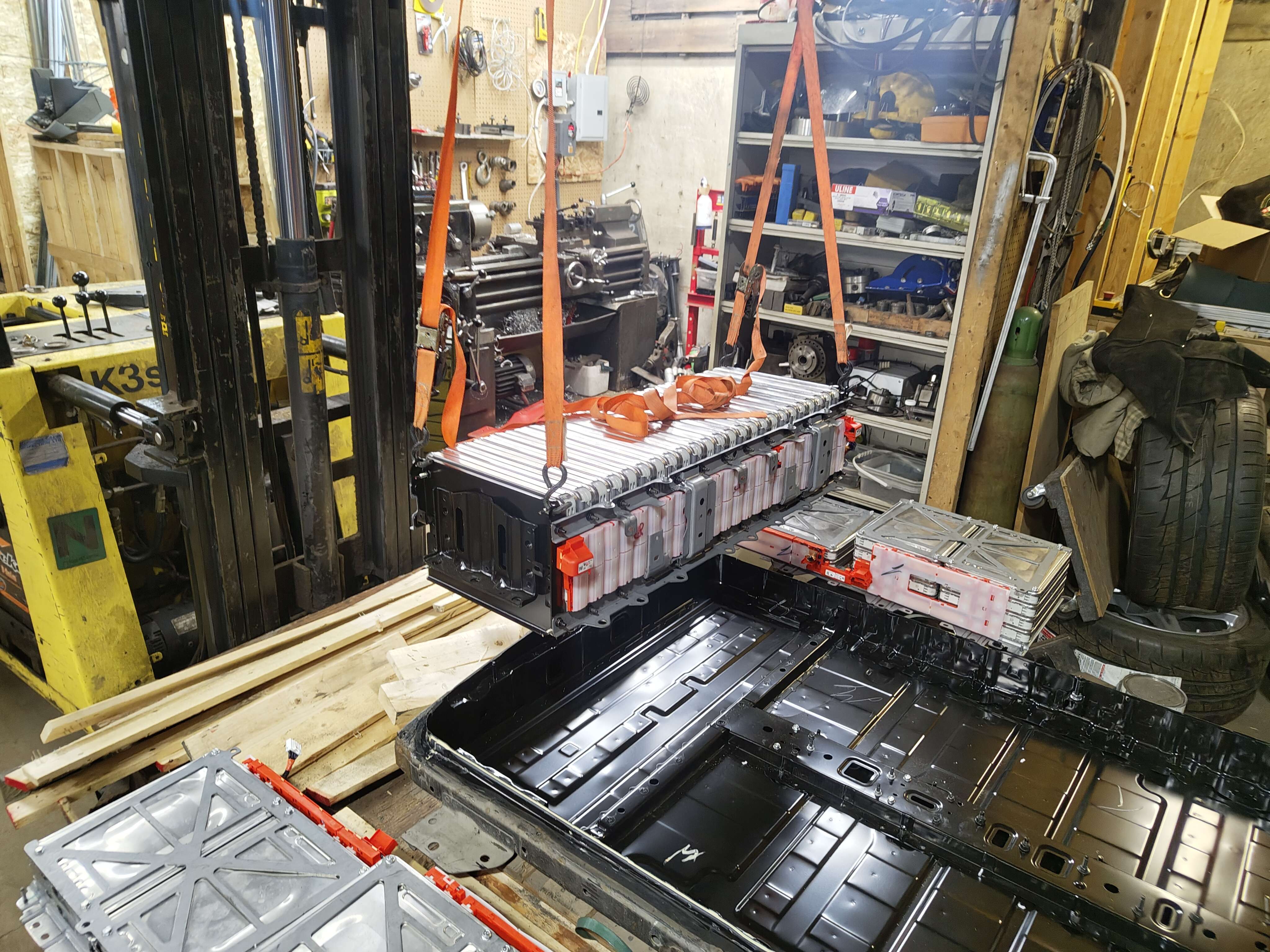

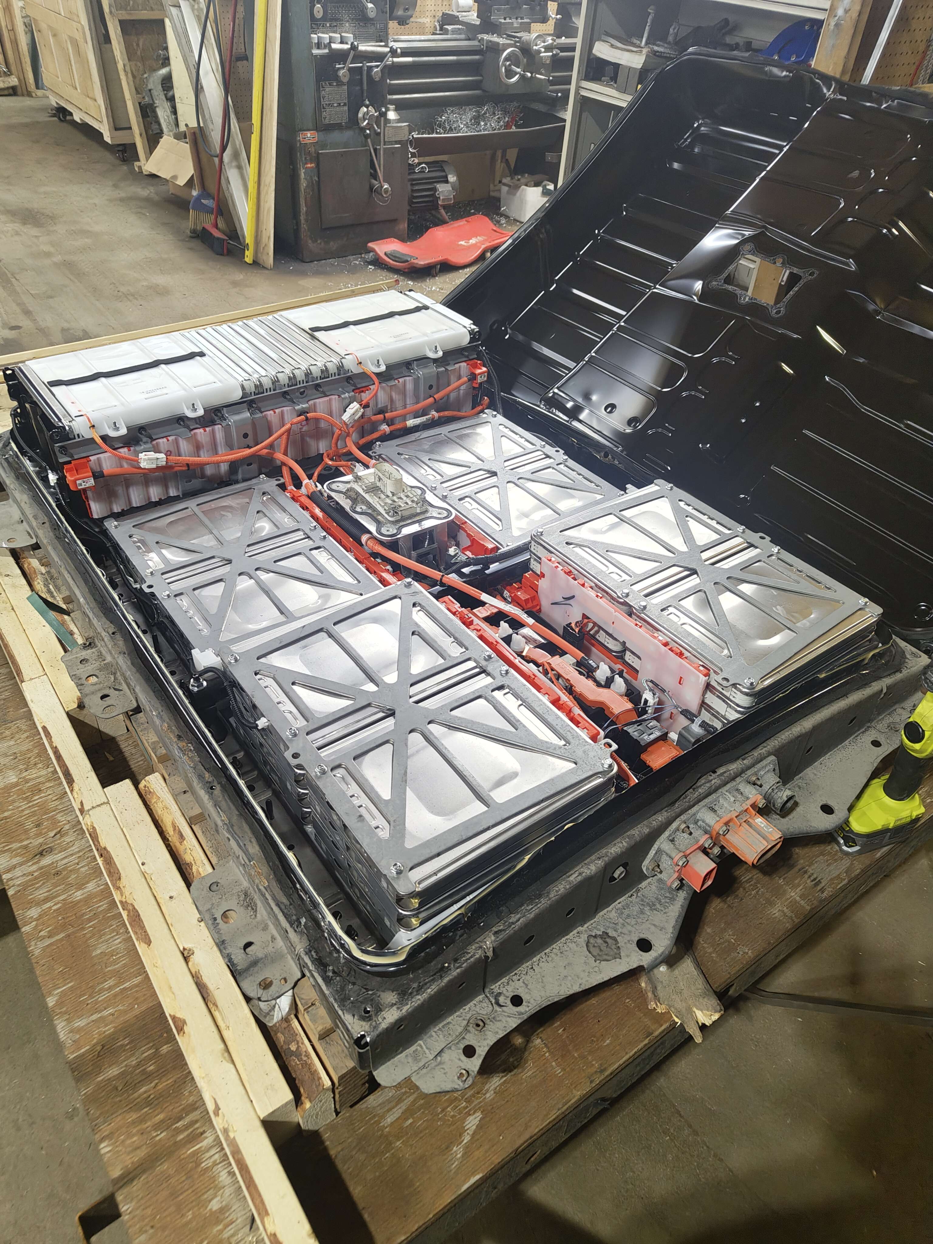

Got the battery today and stripped it down after work. I was told this was a 40kwh battery but the cells don't look like it. What's the best way to tell for sure?

firebat45 wrote: Fri Jul 25, 2025 3:22 am Got the battery today and stripped it down after work. I was told this was a 40kwh battery but the cells don't look like it. What's the best way to tell for sure?
Was there not a Nissan label on the lid?

ianlighting wrote: Fri Jul 25, 2025 11:00 am Was there not a Nissan label on the lid?
I didn't see any markings on the shell, but I haven't looked at the bottom of the shell. The top is very dusty so I might have missed something. The cells are marked 500w/h though, so that confirms that it's a 24kw/h pack.
On the plus side, I've got all the busbars off and every cell measures between 3.89 and 3.91, with the majority at 3.90.

Top shell always has a sticker with the kWh marking.
Shame you were told it was bigger than 24! Hopefully it’s in good shape:)

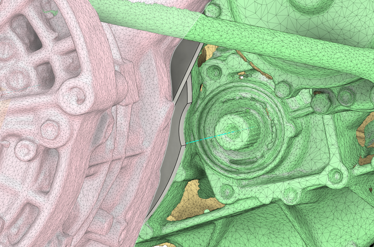

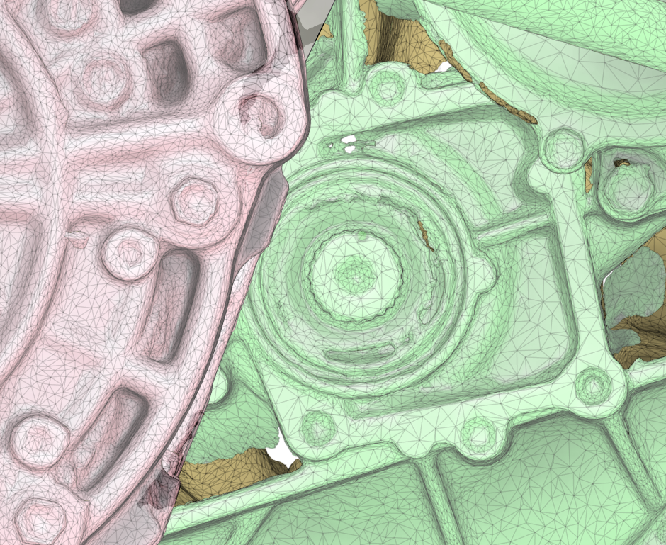

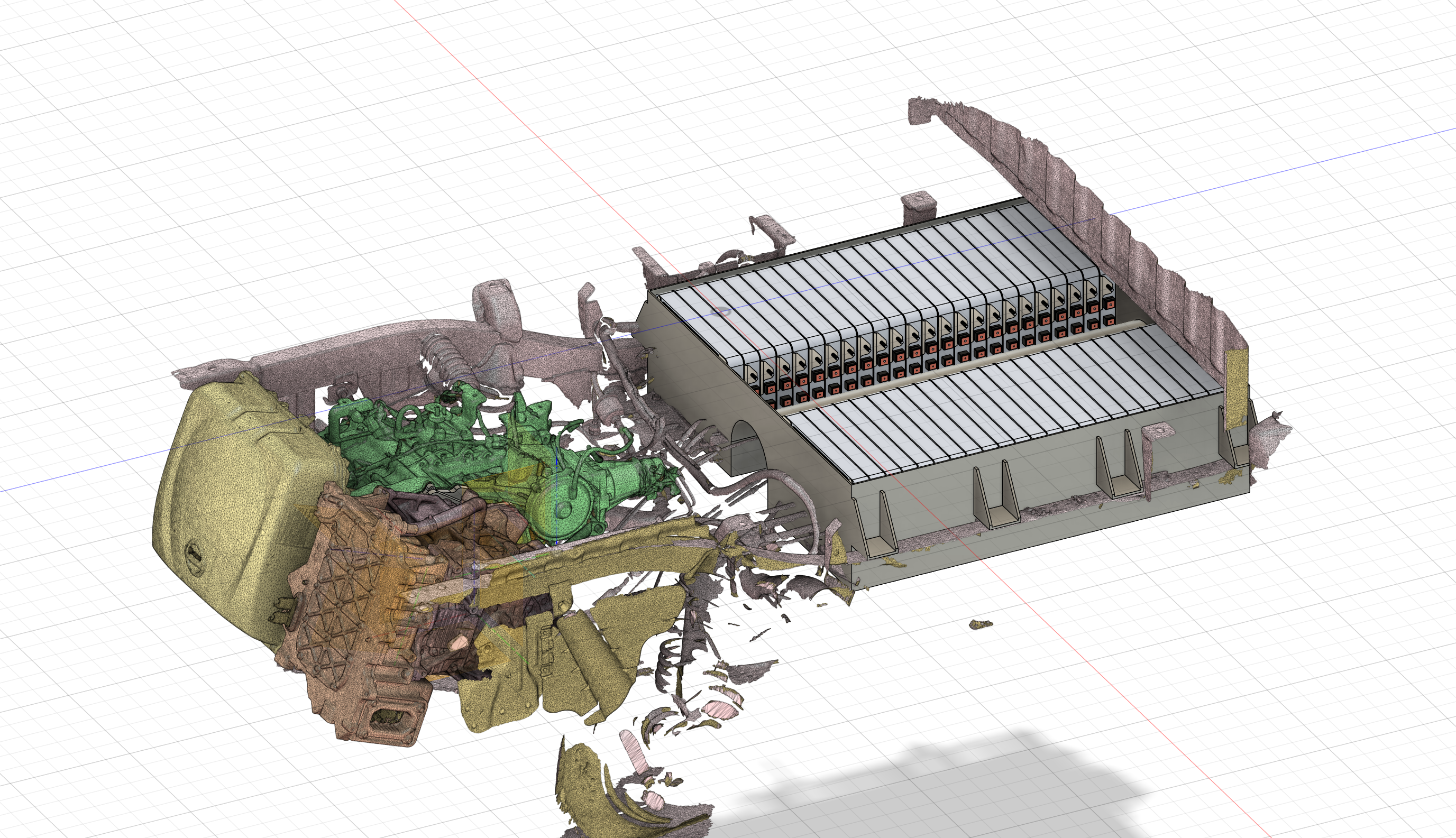

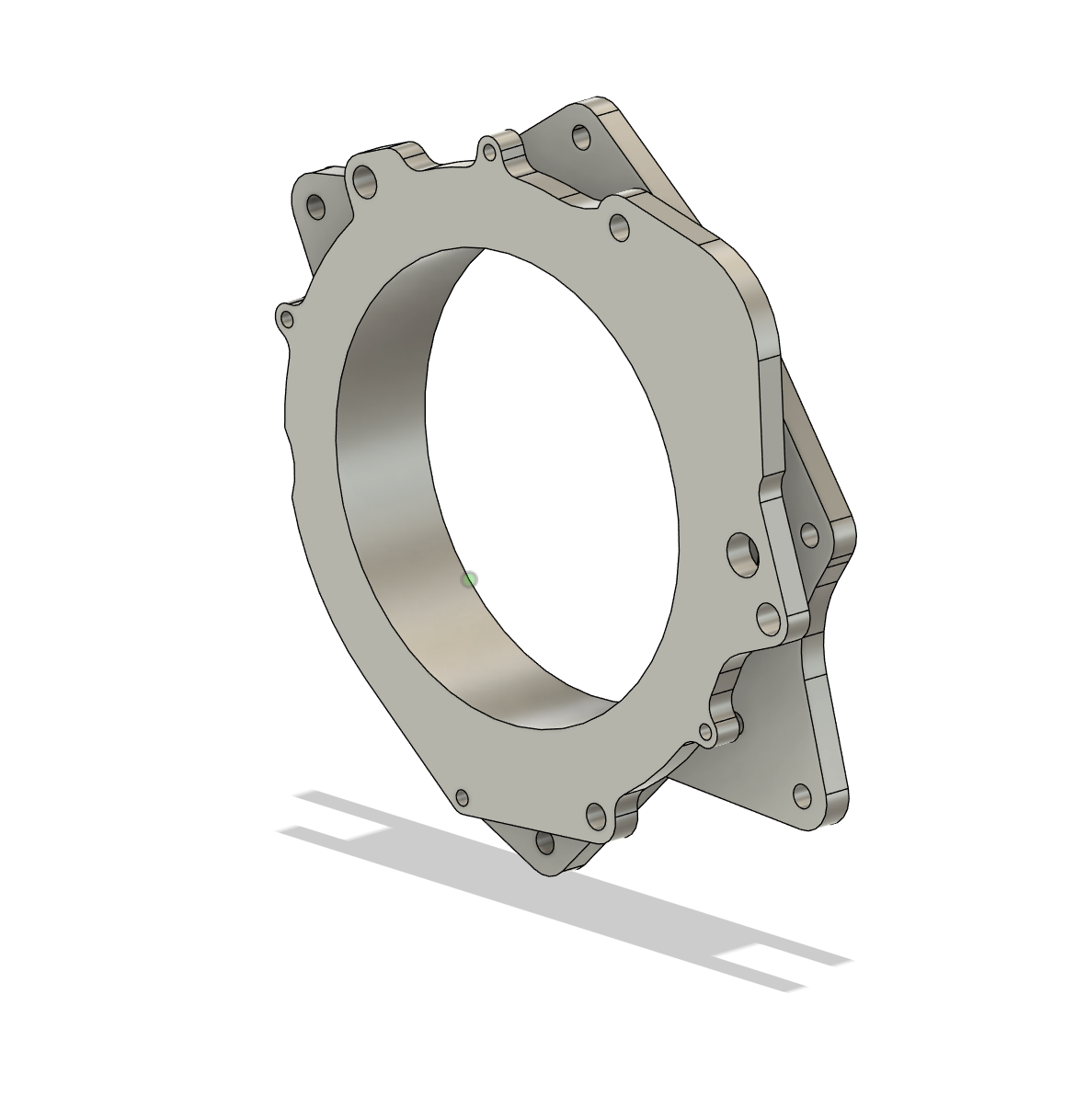

Progress has been slow. I've been collecting parts on JLC to make some Zombie boards. I've also been working hard on getting the CAD perfect for the adapter from Leaf motor to Sambar transmission. I might have to slightly clearance the Leaf motor to give room to the CV axle, it's very close. I think it's finally ready to send off for laser cutting. There was a lot of back-and-forth figuring out the best angle to clock it at for clearances, and access for bolts during assembly.
The adapter will be 2x 1/2" plates with 1" of SCH40 8" aluminum pipe between them. I might go a bit longer with the pipe so that I can lathe a pocket into each plate for self-centering, and maybe another bit extra so I can face off the two plates parallel to each other after welding.

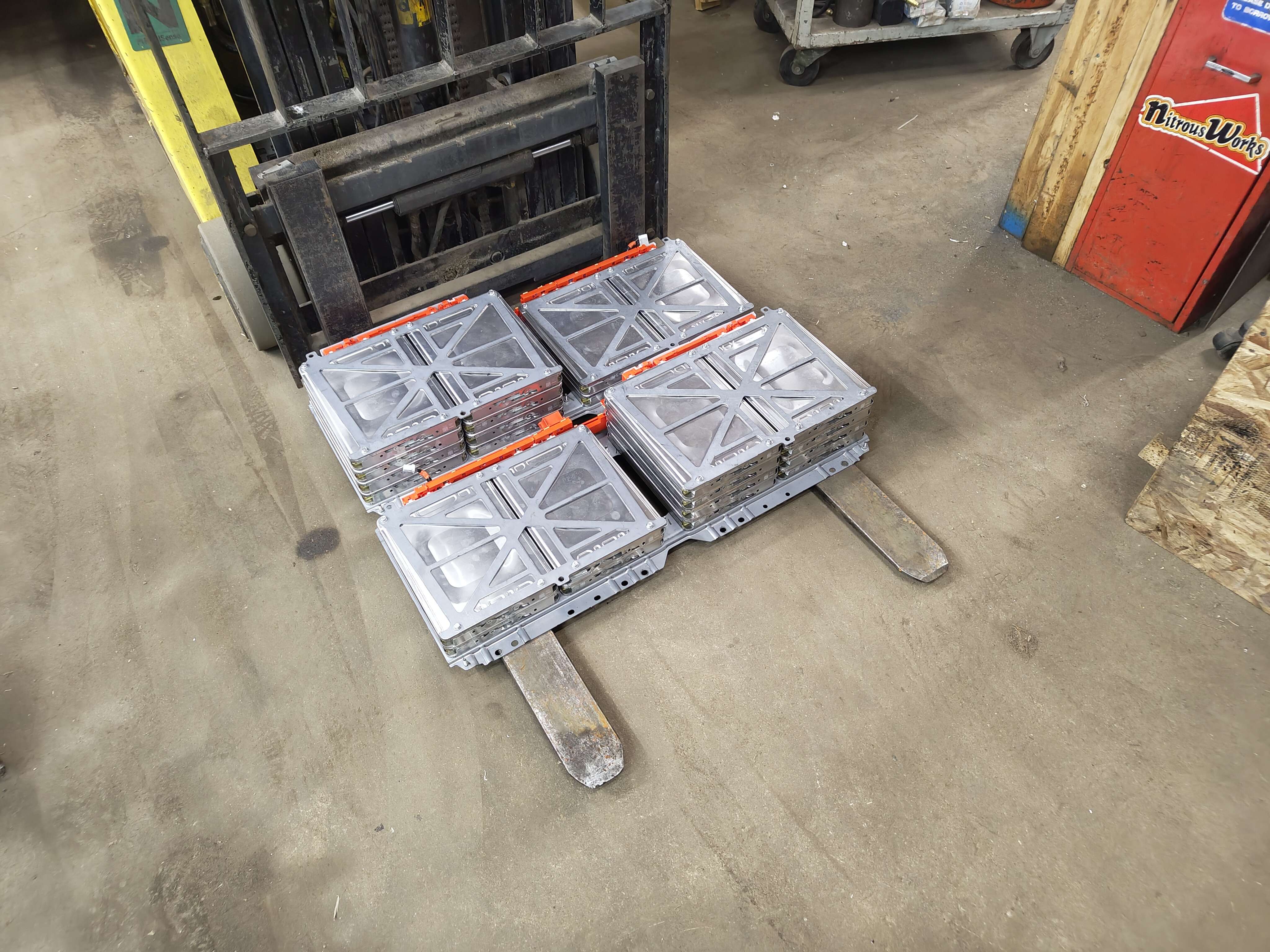

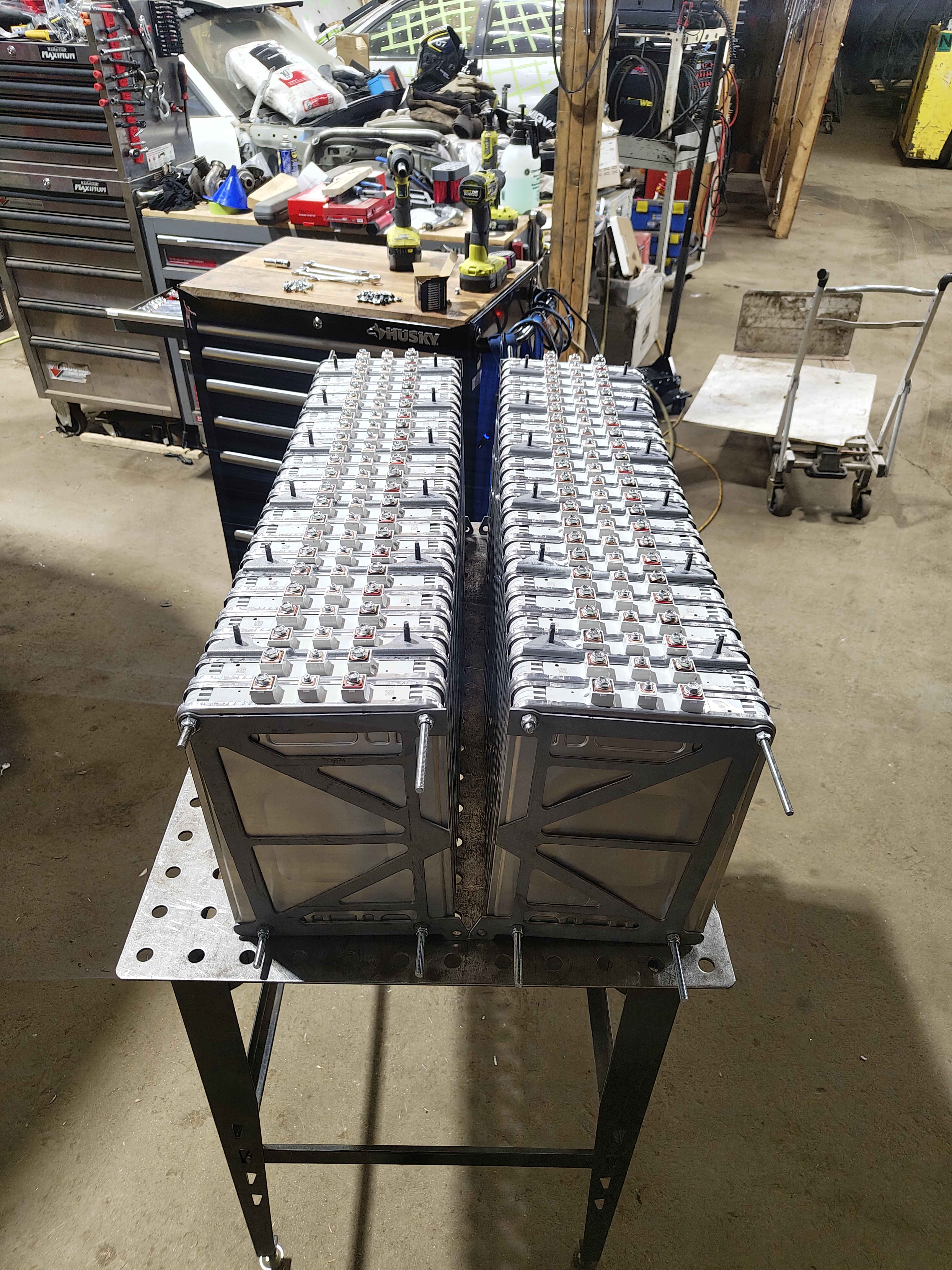

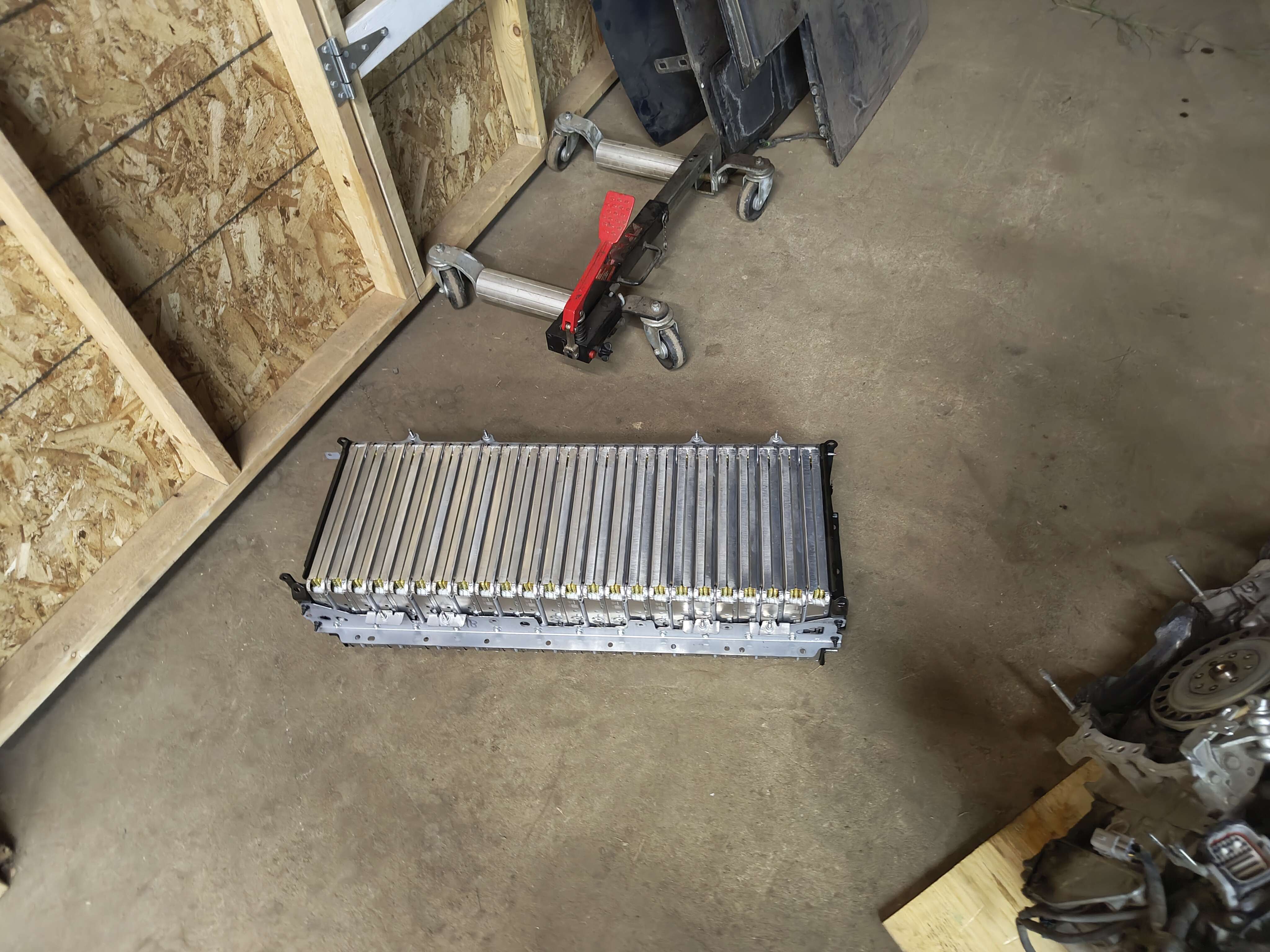

I also got the battery completely disassembled and rebuilt into 2x 24 module packs.
There should be enough room above the driveshaft in the battery case to mount the original leaf contactors and BMS unit. Wiring up the BMS is going to be a massive pain in the ass, but that's life. I might even be able to reuse the output connectors/flange from the Leaf battery on the rear of the battery case, with a nice short run to the PDM.
