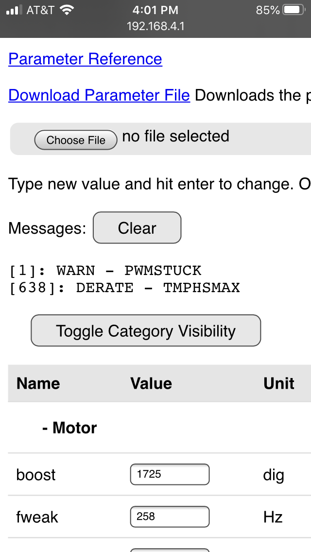

I’ve completed the testing and here are my results-
Ignition on (no hv, no start signal)-
Test point #45 = 1.76vdc
Test point #58 = .202vdc
error codes-
Pwmstuck
Hicurofs1
Tmphmax

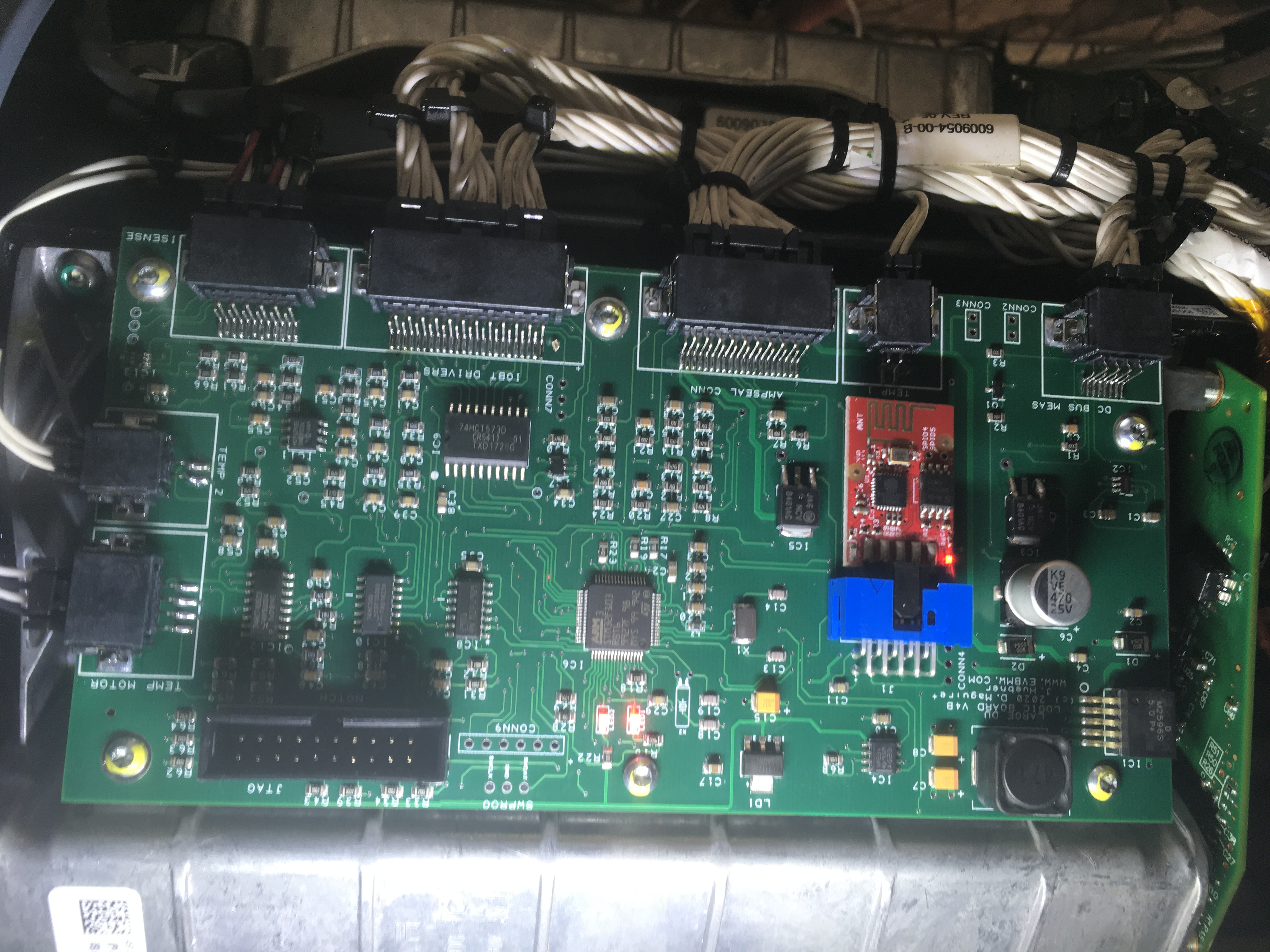

A high resolution photo of the inverter board might help us spot a problem.

Attached is a hdr photo of the board. Tested pin again and now it has .037v and it’s back to overcurrent stop as soon as the start signal is sent.

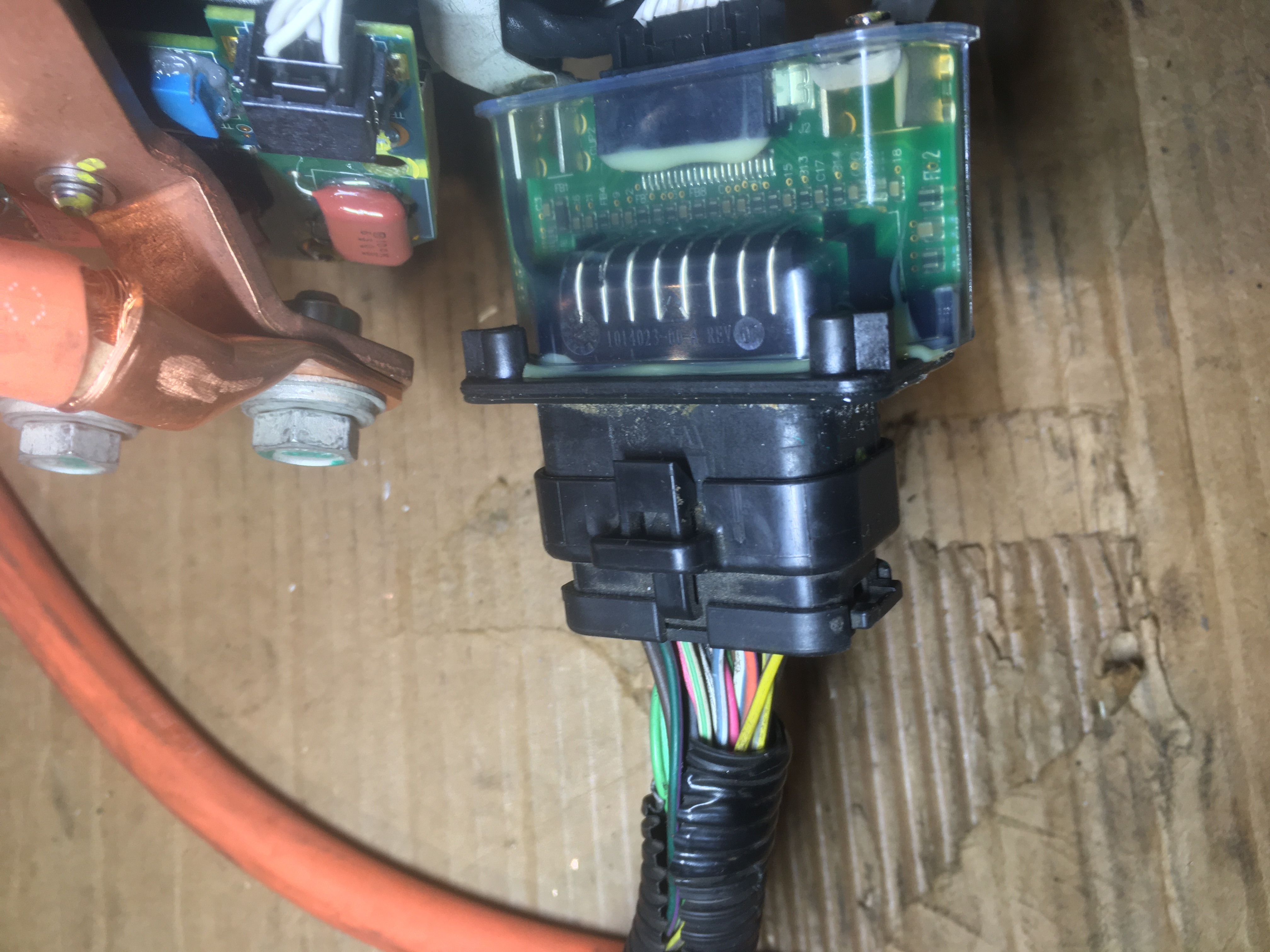

First comment... I see you're using EXRAD shielded cables and the shield is not stripped clear of the core conductor (most obvious on the first contactor visible in the video). Are you sure the shield isn't shorting to ground somewhere or even providing an intermittent contact for power?
Other than that, I can't see anything and hopefully someone with LDU experience will step in now

Third comment... in the video the 23 pin connector appears to be floating in space (not screwed down)... are the two metal tabs on the 23 pin connector PCB ground connections?
1. The “shielded” cable is not shielded. I ran out of 2 OT wire terminals and Autozone only had a 2 gauge terminal so that’s positive wire that wouldnt fit in the terminal. I thought it would be fine for testing since the amp draw is much lower.
2. I used the wiring diagrams in the beginning of this thread and corresponded the numbers on the harness not wire colors with the components. I’m pretty sure every thing is connected fine because every other function (d,n,r, ac pedal, ground contactor, ignition switch, main contactor, precharge relay, the board power) works correctly. I didn’t change the stock encoder wires but I double checked to make sure the numbers lined up with the diagram and the one time the motor spun the accelerator worked as it should in D and R.

Looking at the schematic and pcb layout here are my thoughts-
The signal from each current sensor comes in connector 13 to IC13
Then the signals are sent to the current filter section to IC11
Both IC13 and IC11 are mirror devices, as in they have a common 5v and gnd and they run an A circuit on one side for current A and a B circuit on the other side for current B using the same exact circuit configuration.
In my case current B isn't giving the voltage reading on the test point but current A is.
I would assume the 5V and gnd is working fine because circuit A has correct readings.
That would leave four possibilities-
1. One of the two IC devices are bad on the B current side
2. The signal incoming signal from current B is not there or whatever generates that signal is broken
3. One of the resistors or capacitors in the filter circuit on the B side are bad
4. the ground connected to R57 is bad
There are test points above and below IC13 that would tell me values for each circuit. If anyone knows what those values should be that would help in my diagnosis.

I figured out the issue.
After testing the current sensor A circuit I discovered pin 2 on harness 13 does not have 5V.
For proof of concept, I jumpered pin 10 on harness 15 that provides 5V for current sensor B to pin 2 and all the values on the test points for the current sensors were equal and the motor would start and spin without throwing an overcurrent code.

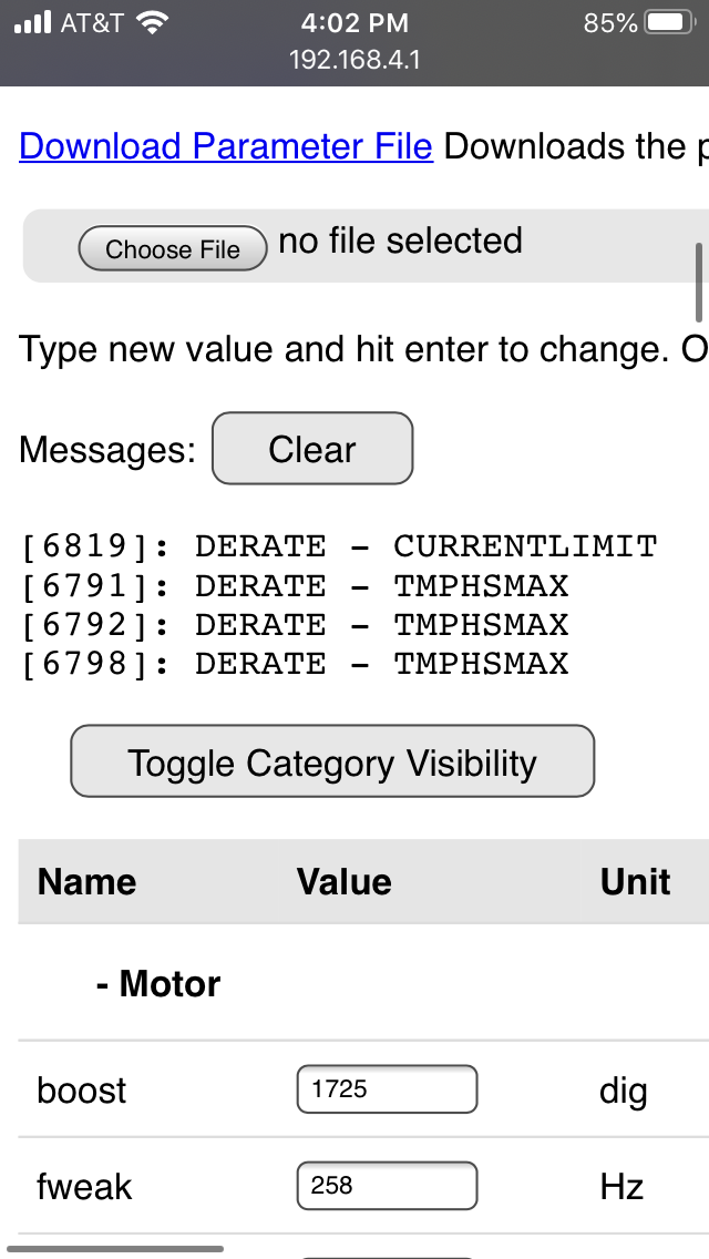

I still get tmphmax derate and current limit derate codes
After I took the board off I was able to see why there was no 5V on the pin. The connection between the harness socket and the board was not connected as is displayed in the video below. Hopefully I can get a new board that will solve all of these issues.

Excellent work fault finding. This is the sort of thing I'm trying to encourage because although painful it ensures a level of knowledge about the circuit that will be invaluable for future support. It's kinda hard to see for sure in the video but is the pad lifted from the board or is the solder joint between the pad and pin broken?
Regards the derate errors are they warnings or errors? Warnings would be normal as not all motor temp sensors are implemented in the code.

I believe the pad is still connected and the solder joint is broken, but I will take a close look today and confirm. Here are photos of the exact errors I’m getting even when jumpering the bad connection.

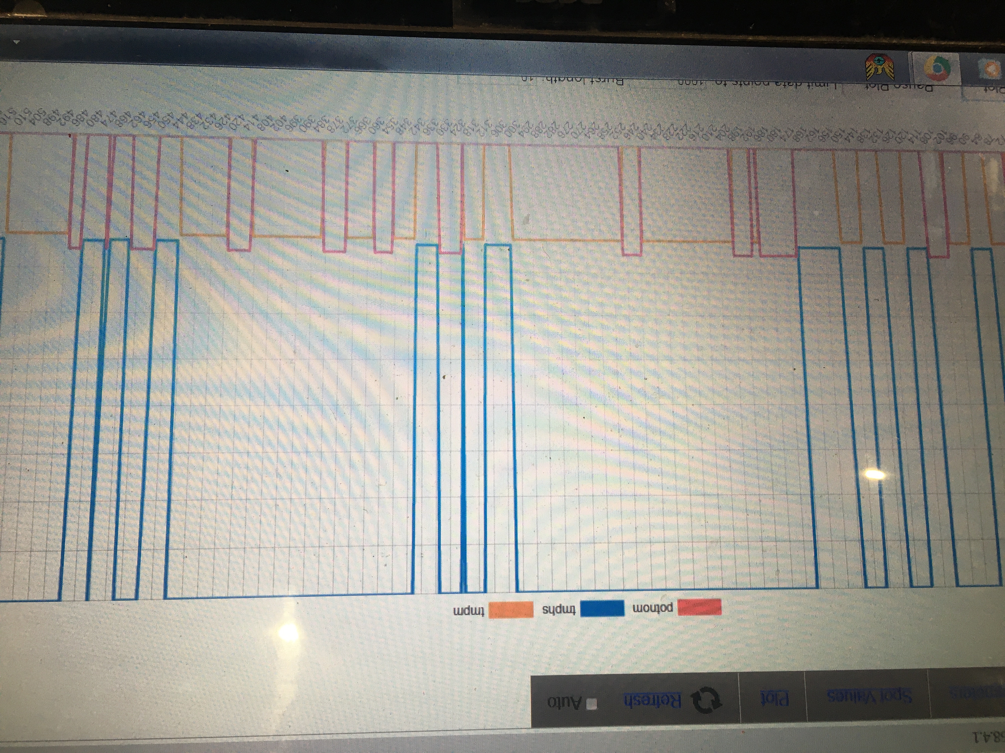

For the temp, I can see it toggle between 100C (maxed out) and 23C (actual temp) so I’m assuming the overtemp code is because of the toggling to max temp every couple seconds.

Hmmm...sounds like you may have another open solder joint on one of the heatsink temp sensor pins. It would be worth checking on the igbt driver plug on the logic board.
Also check the mux select pins are both toggling if you have a scope. This looks like issue I had, the randomness was from the temp values changing rapidly as the wrong inputs were read in - then being sampled for the graph at a lower rate.
