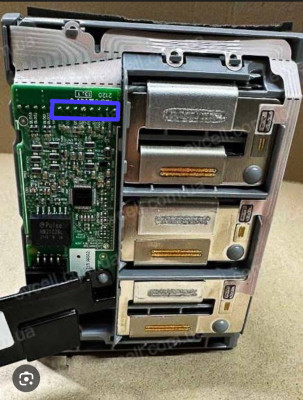

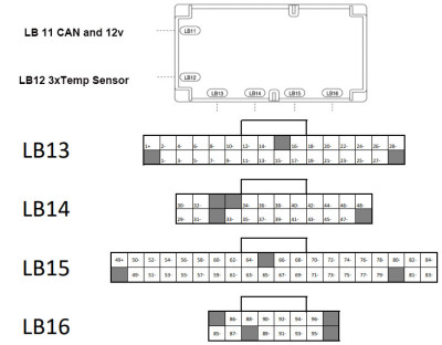

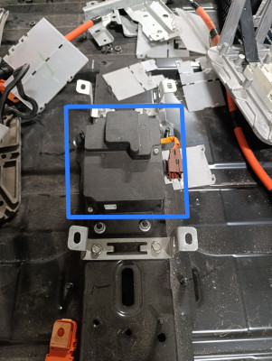

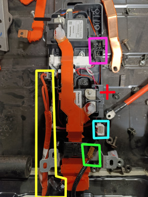

Hello all. I bought 16 x LG Chem 6s2p modules. Now i need to repack battery correctly.
As always have some questions:
UnderFuse.jpg in attachments. What is this black box with orange wire marked in blue?
Contactors.jpg: For what wires marked in yellow?
Its interlock marked in green?
For what connectors marked in pink?
To BMS and contactors or just to BMS marked in blue?
Positive and Negative contantactors marked correct?

Bit off topic for this thread.
Regarding leaf model upgrades, this is covered in other forums. I would do some research before asking.
But from my understanding that block box with the hv connector is the heat controller. But I might be wrong
The lite blue off the contactor tray goes to the lv plug on the outside of the pack

Taichi wrote: Thu Sep 18, 2025 1:27 pm Hello all. I bought 16 x LG Chem 6s2p modules. Now i need to repack battery correctly.
Black box in blue square is probably control relay for battery heating elements
Yellow marked wire PTC heater HV supply (comes to smaller orange connector outside battery box)
Green marked interlock, signal goes to BMS, which reports interlock condition in CAN message
Pink I have not checked, perhaps supply for battery heating relay supply? Do you have the battery hv harness, so you could measure it?

There were indeed two heaters in the kit. Now that it is clear what is responsible for what, the main question becomes. Do I really need to restore the battery heating system? Where is the best place to place the temperature sensors? Thanks for the help.

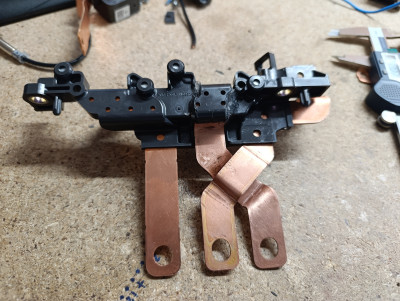

Good evening. Charging started. OBD2 scanner showed temperatures on BMS temperature sensors 10, 10, and 16 degrees, maximum difference across cells 3.59v and 3.53v. Contactors turned on, everything is fine.
There was a problem with the ignition, start, forward and reverse buttons. Previously, to start the contactors, you only had to turn on the ignition T15. The contactors clicked and precharge too. Now, for the contactors to turn on, you also need to turn on the direction. It happens that nothing reacts at all. The web interface shows that everything is fine - there is voltage, there is potnom, but the buggy does not move. Has anyone encountered this problem? I can not fully understand the logic of the ignition->contactors->start.
Also, tell me how to change the wiring cos + to cos - and sin + to sin -? Or cos +- to sin +-? To move in the other direction? To swap 2 phases you will have to disassemble the engine =(

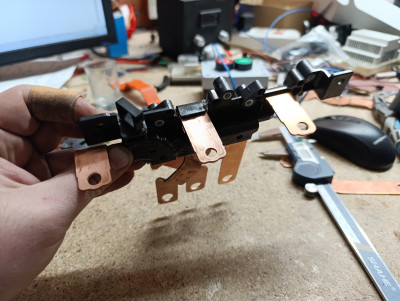

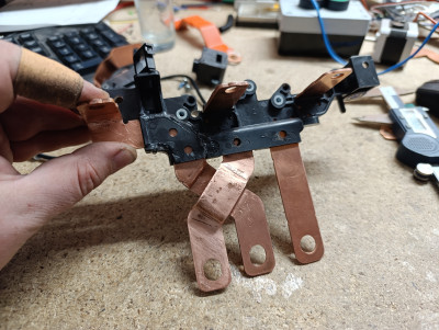

Today changed 2 phase.
Maybe someone need cad file to cut it for himself? Can't post there dxf or cdr file.

To make it easier to form bends, you need to heat the copper until it is red hot and immerse it in water. Just like hardening steel. The copper will become very soft. Over time, it will harden again. Thickness 1.5mm
Phase_1_5mm.zip
(12.07 KiB) Downloaded 7 times
