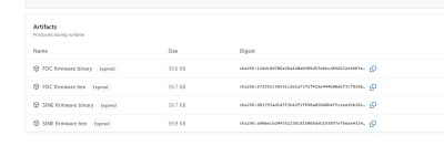

If you want the latest software. You can download it from github. You need to be logged in to github. got to https://github.com/jsphuebner/stm32-sine/actions
And select the the latest commit of the branche you want. Scroll down to Artifacts and select the FOC or SINE file.

manny wrote: Sat Oct 25, 2025 1:42 pm Scroll down to Artifacts and select the FOC or SINE file
Now I see that. Where is the bin file?

Sorry did not see that they are expired. Maybe johu can redo the copile or change the expire settings?

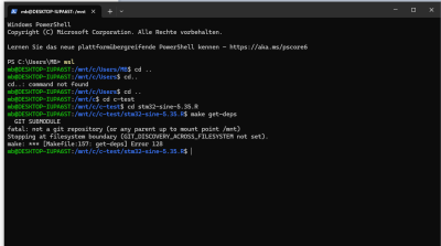

Ubuntu is installed, make and git are running. “make get-deps” produces an error message.

make get-deps will not work on the unzipped source. You need to "git clone https://github.com/jsphuebner/stm32-sine.git"

The "git clone" will have created a special ".git" folder which is not present in the zip file. You should be able to run "make get-deps" now which will fetch and build libopencm3 and libopeninv which the project needs.

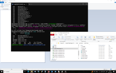

davefiddes wrote: Tue Oct 28, 2025 4:38 pm created a special ".git" folder
You're absolutely right, I didn't see that. “make get-deps” worked, and so did “make.” So the newly created hex and bin files should be the ones I can load onto my board? I've only changed the version number for now and will test whether it's correct after loading.
What does the warning mean?

Yep. You can take the bin file and upload it via the web interface or CAN as you would with an official release. The stm32_sin file (without an extension) is what you need for debugging.
The warning can be safely ignored. It's a compiler bug(ish) cause by some slightly convoluted code in libopeninv. Newer compilers like gcc 15.1 don't complain.
