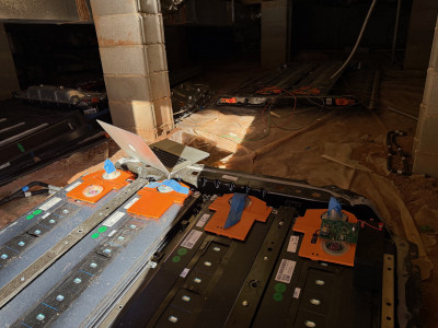

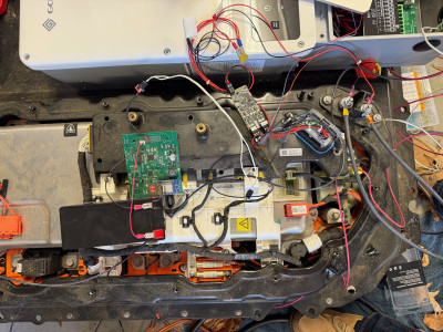

Here's my setup. This is with a Tesla RWD Model Y Long Range pack. Both ends of the ISO-SPI ring are disconnected from the HV Controller in the pack. The PCB being tested is connected to one end of that loop.
I'm only seeing cell voltages from one of the 23 cell block packs in the spot values. But I do see the correct overall pack voltage and the right voltage summaries from each of the BMBs down towards the bottom of the spot values.
I'm going to try it with a couple of additional packs shortly that have a different arrangement of cell blocks per modules.

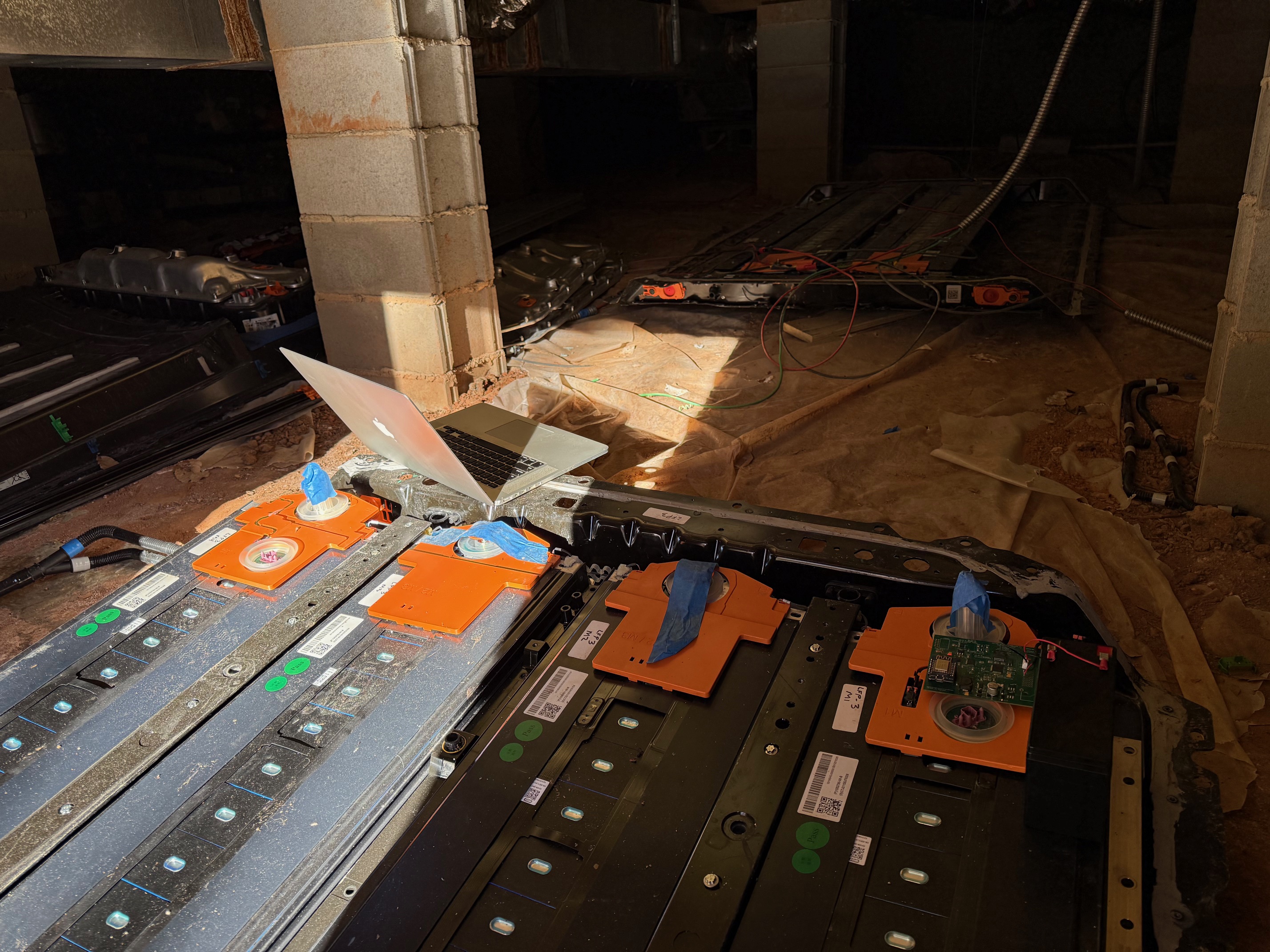

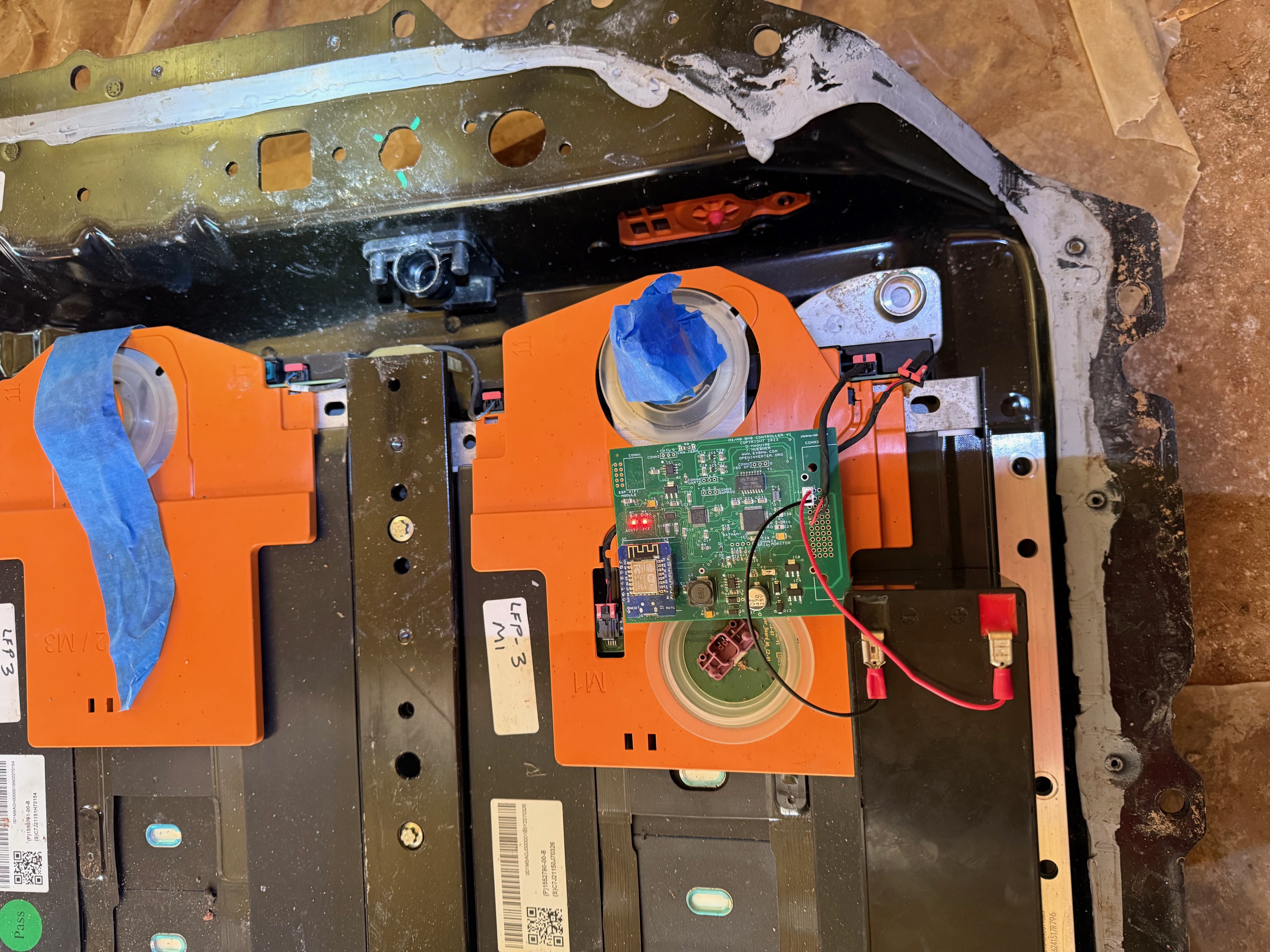

Did another test, this time with a Model 3 standard range LFP pack with just the bare modules. These modules have 26-28-28-26 cell blocks.
You can barely see in this picture that the module to module ISO-SPI interconnection jumpers are in place
It did show 26 cell voltages, which would be the right number for the first module, but the last value was truncated by 1/10.

One last test on the LFP modules. I moved the board to connect to the second module with the first module emitted from the loop.
Strangely showed 27 cell blocks instead of 28 for the first module.

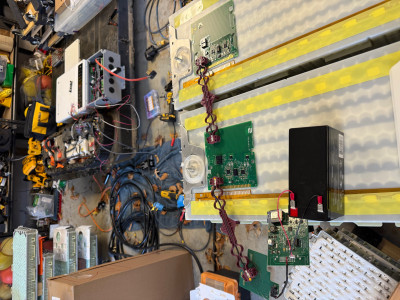

Tried 2 Tesla Standard Range Li-Ion 24 cell group modules.
Sort of the same pattern as all the other tests. Looks like I'm just getting cell voltages for 1 module. But on these modules I had recently checked all the voltages recently. Every cell group is around 3.6 volts. The voltage reported by the board for U13 - U24, which are all around 4V, are not correct. I reverified with a meter. There are no cell groups in either of these modules with those voltages.

Here are the results from the Standard Range Li-ion and LFP packs.
For the Li-ion pack, I tested with just two modules. I can do all 4 modules as soon as I have someone to help me move the other 2 modules close enough to connect ISO-SPI jumpers. For this one, Chip-1,2,3 cell counts look correct. But the Chip 4 cell count it Zero. Also, the U13-U24 voltage values are incorrect.
For the LFP pack, the cell block configuration is 26-28-28-26. Chip1,2 cell counts look correct. Chip 3 is 13 and I would think it should be 14. Chip 5,6 cell counts look correct, Chip 7 is 13 and I would have expected 12 or 14, Chip 8 cell count is zero. The cell voltages that are present look correct.
