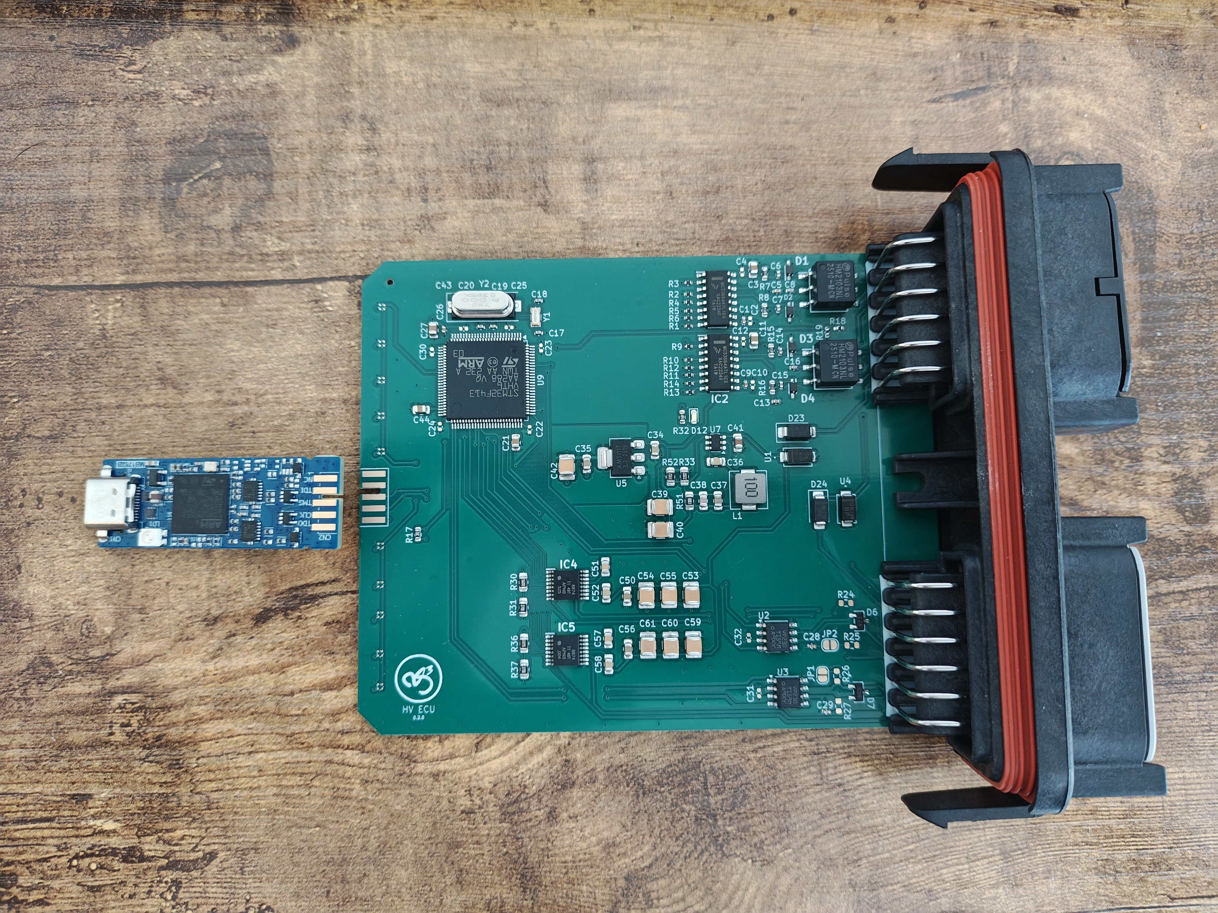

After a pausing for most of the year, I finally revisited a project I started back in February. I made an ECU that can communicate with Taycan BMS modules.
In my conversion, this board also manages the HV system in my car. Here's the current iteration:

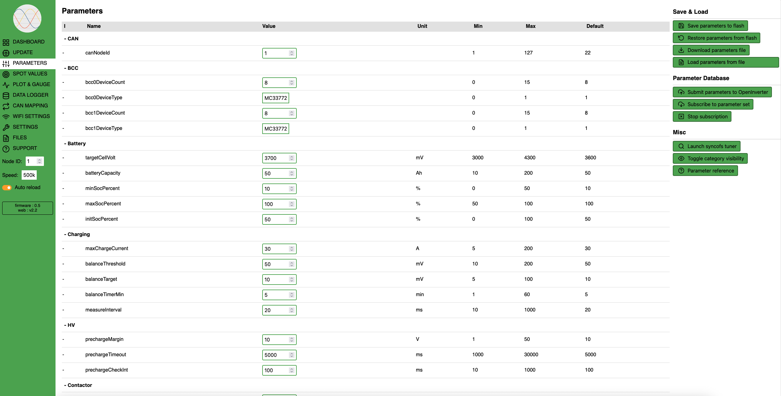

It has two MC33664 transceivers to speak to up to 30 Taycan modules in total. I use 8 on each chain in my car. It can all be configured using the OpenInverter web interface:

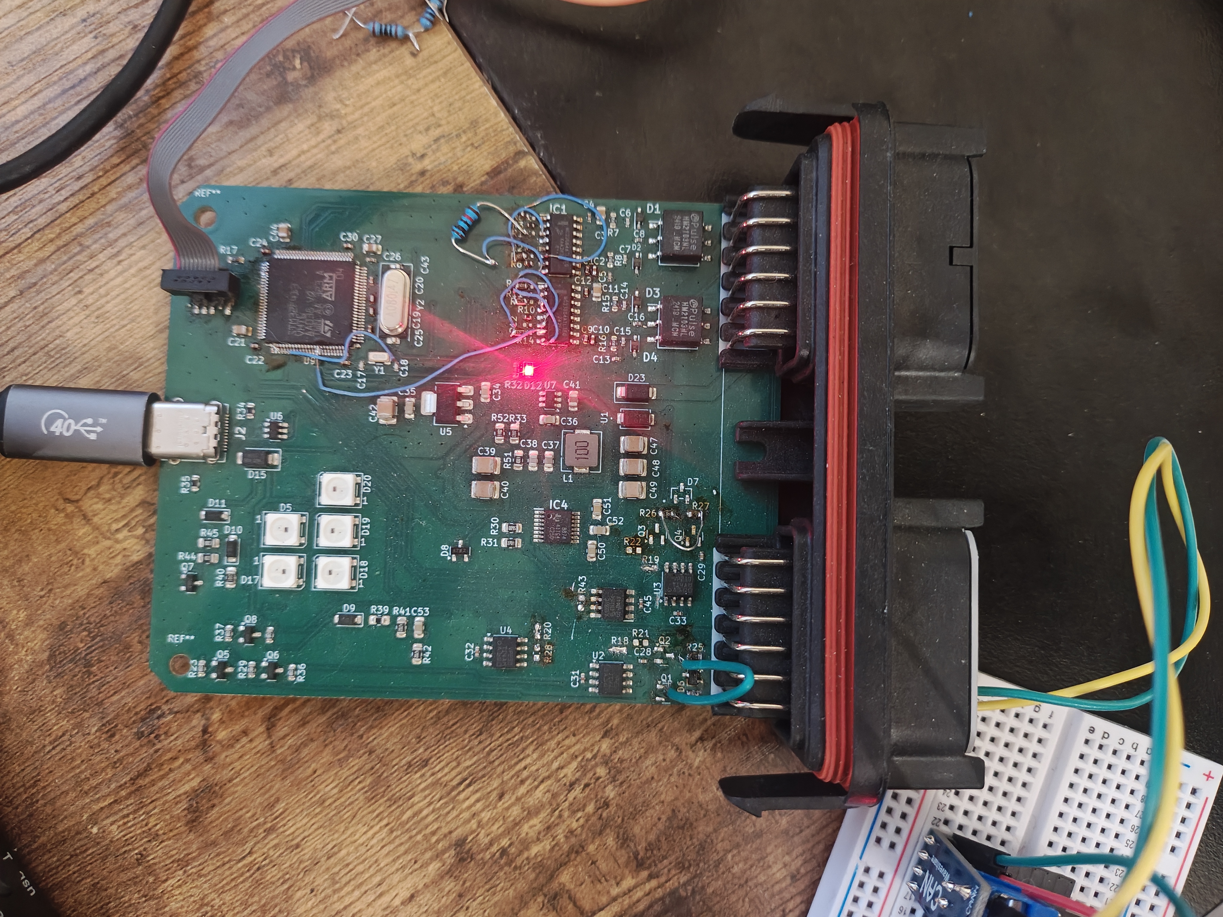

I finally received the version 2 of my hardware and predictably lost my board to board programming connector for an ST-Link Mini V3. Waiting for a new one to finally get it all validated for release.
The hardware schematics are available here. I'd love for any review of it since I'm most definitely not a PCB designer: https://github.com/outlandnish/subaru-b ... n/hardware
