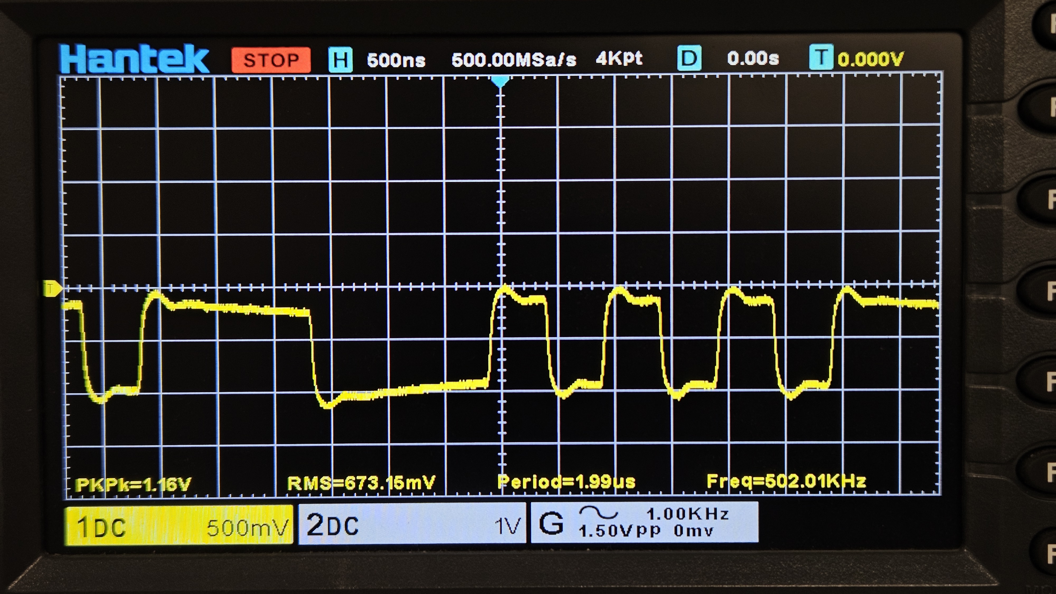

So these are the signals coming from my TX pins.
When connected with cables with one module and the loopback at the end of the cables, I get the scope from the first image. It is in that image under the 0 line, but keeps alternating under and above the 0 line.
The second scope is from the pins before the transformer and the third scope is the pins after the transformers. Cables not connected.
Connected the GND clip of the probe to GND on the board and put the probe on the TX pins. I don't think this is the right signal. Still no data from the module.
How do I get the right signal? Woleg signals looks completely different than mine.

Post by bexander »
When connected with cables with one module and the loopback at the end of the cables.
How does your signal on the RX-pins look?

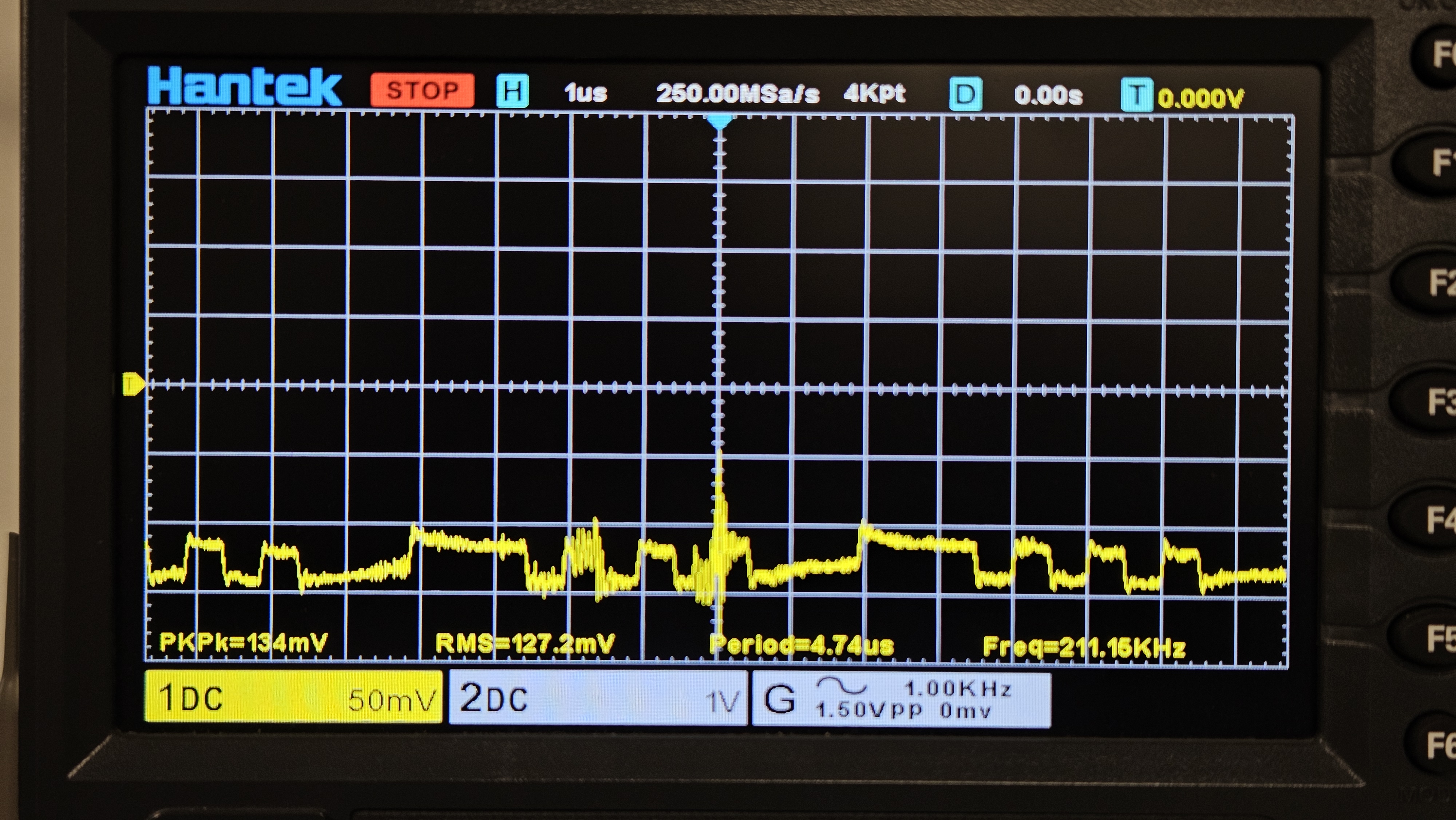

These are my scopes on RX.
The first image is the scope I have from the RX line. This was also jumping up and down, so I checked what was going on and found that the signal was in a sinewave with mains frequency.

And still same result in SW?
So the output signal is about 1Vp-p and the returning signal is about 50mVp-p so not much of a signal returning.
To measure this correctly one should use a differential probe but they are expensive.
The best one can do with a single ended probe is:
Connect only a probe to one channel on the scope.
Remove any connection on the scope between PE and gnd, if possible?
Connect probe to TXP. Connect ground clip to TXN. Check signal amplitude.
Move probe and clip to RXLP/RXLN of first slave and check amplitude.
Then move to TXUP/TXUN of first slave and check amplitude.
RXUP/RXUN, amplitude?
TXLP/TXLN, amplitude?
RXP/RXN, amplitude?
With TXP/TXN/RXP/RXN I mean on the slave side of the transformer.

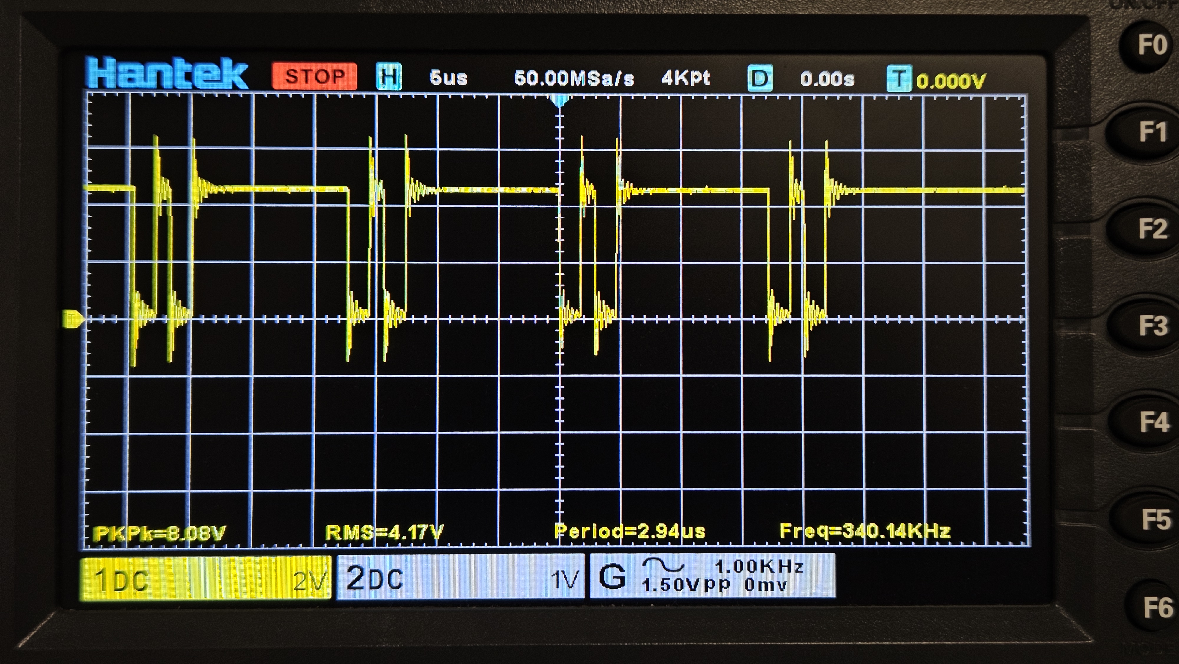

Can't remove connection on the scope between PE and GND.
Here are my scopes:
Image 1 (BMS): Connected GND clip of probe to TXN and probe on TXP after transformers on my BMS. Max ampl. +4V and -3.5V
Image 2 (slave side): Couldn't connect GND clip of probe to the wire. I used math function and did CH1 (RXP) - CH2 (RXN). That is the purple line you see on the scope with scale on 2V. Max ampl. 4V
Image 3 (slave side): Same problem of image 2. I used math function and did CH1 (TXP) - CH2 (TXN). This time purple line (math function) with scale on 200mV. Max ampl. 0V
These scopes are with the whole setup connected and same result in SW with errorByte 6.

Post by bexander »
Whats your conclusion from those measurements?
To me it seem like there is a wiring or HW problem. The signal should return (RXP/RXN) to the MAX17841 with close to equal amplitude as it was sent (TXP/TXN).

Refering to picture above. If I understand correctly your measurements are taken at 1, 2 and 4?
Signal is good at 1 and 2 but not good at 4.
What does the signal look like at 3?
Another test idea.
What if you disconnect the slave module and loop the connector i.e connecting RXLN to TXUN, RXLP to TXUP, RXUN to TXLN and RXUP to TXLP. Totally bypassing the slave and then measure signal quality at RXN and RXP at BMS on slave side of transformer. This way you also should have continuity from TXP to RXP and also TXN to RXN at BMS on slave side of transformer.
This way you can verify the total wiring chain.
