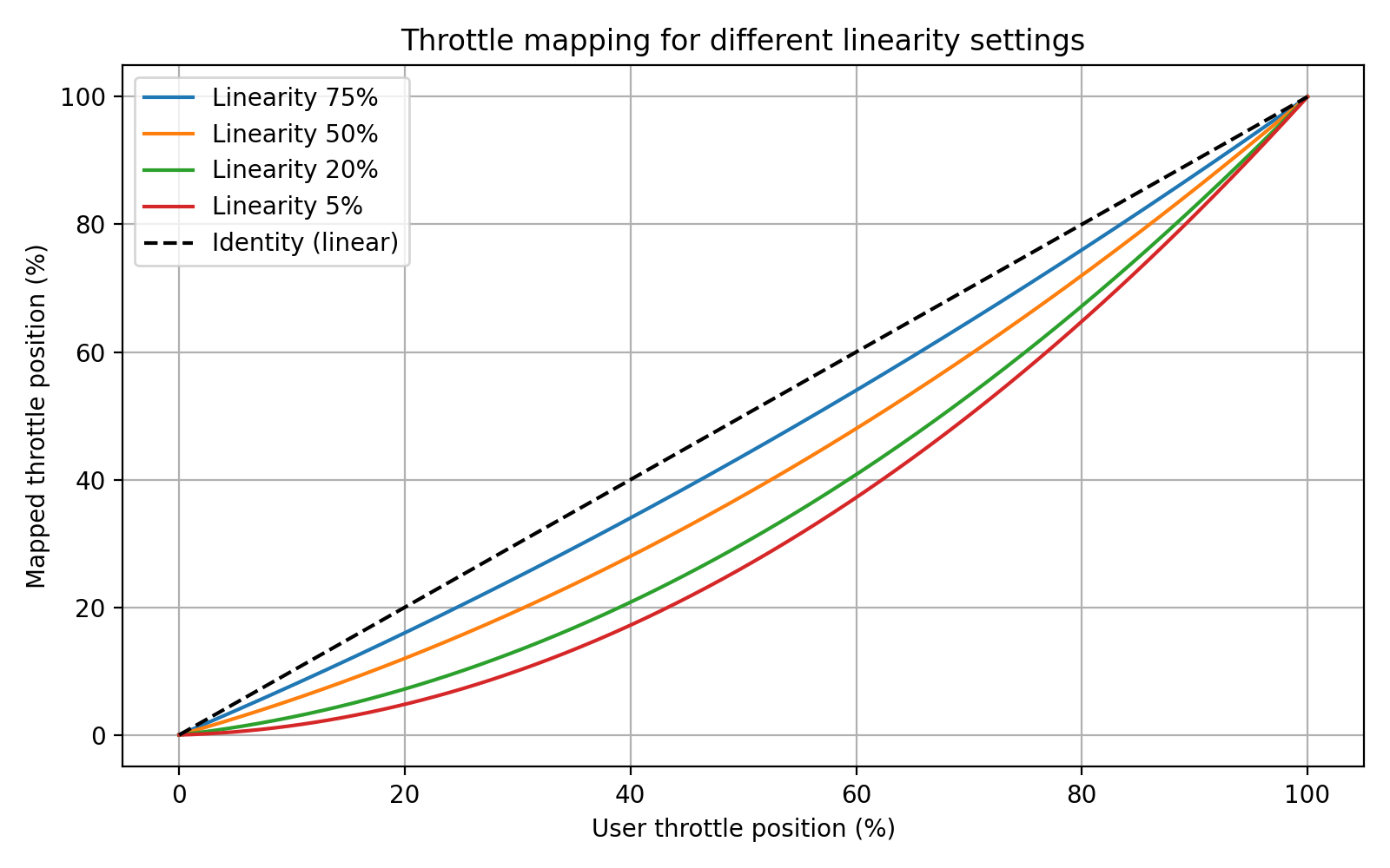

I was always bugged by the harsh clonk even when carefully stepping onto the pedal. I tried adding a second, slower ramp from 0-20% but that doesn't help. Then I lowered throtcur to 1 and the clonk was gone. So pedal control just isn't fine grained enough at standstill.
Therefor I added what many have been asking for: added a quadratic pedal map. So first it comes in slowly and then most torque is towards the end of the pedal travel.
I made it x²+x with a factor called "potlinearity". It maxes out and defaults to 99.9% to achieve the former linear throttle map (100% would result in div by 0). By lowering the value you can make it increasingly more quadratic and at 0% it is purely quadratic.
I ended up setting it to 20%.
The regen part is still purely linear.
With potnom normalized 0-1 the formula is
x = potnom²/(1-potlinearity) + potnom * potlinearity

I wondered what this would look like as the linearity changed so I got a computer to draw me a picture:

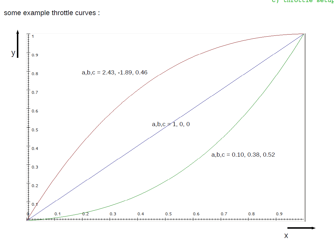

May i offer Lebowski polynomal throttle function i was fascinated by it from the start...
There are three coefficients you can set in code that determine the curve. a, b, and c are floats because they can be less then 1.
x is the throttle value and y is the result.
y = a*x + b*x^2 + c*x^3
a, b and c are preset coefficients. Using them you can shape your throttle curve to your liking.
See here the excerpt from the manual...

Been thanked: 1913 times
Re: Quadratic throttle pedal map
Not bad!
Go, new maintainers ;)
