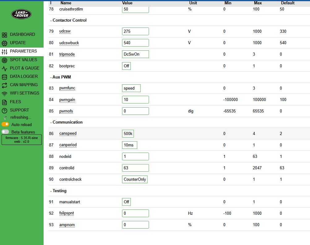

Here are my CAN parameters

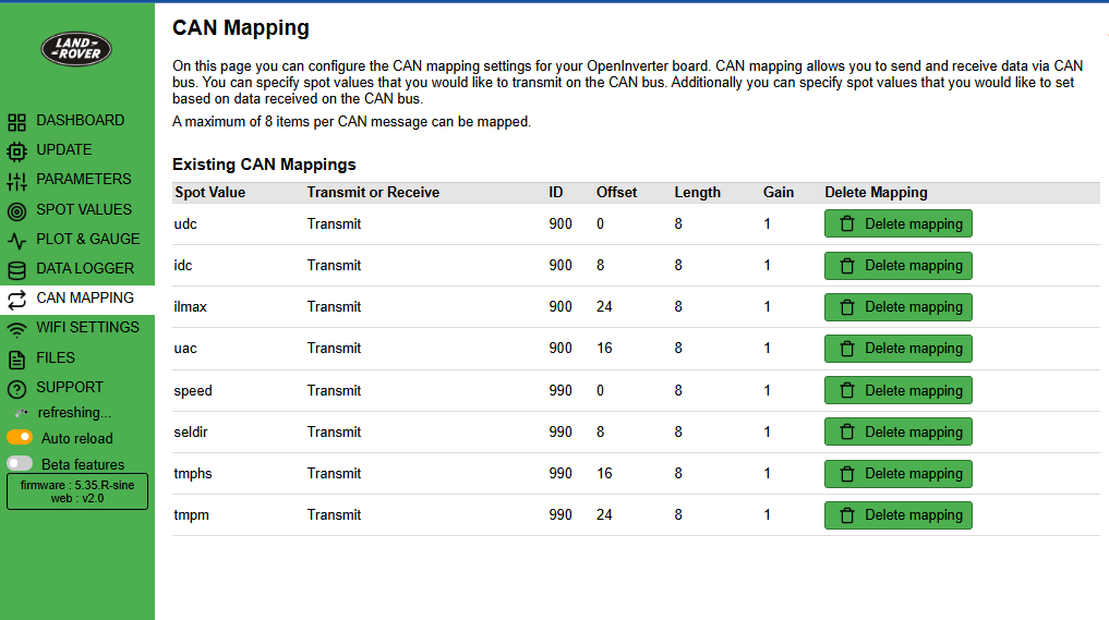

These are the CAN messages I have mapped for transmission:
For testing, I only have the Landrover Freelander CANBus running at 500K, which includes just the Instrument cluster, SRS and ABS modules. I also have an Arduino imitating the gearbox selector, which is adding gear selected position CAN messages needed by the ABS and instrument cluster.
I am using an ESP32 with SN65HVD230 CAN transceiver running SavvyCAN. This setup can read messages from the landrover module but can't receive any messages from the Drive unit.
I have added my current parameters file as well for your review.
