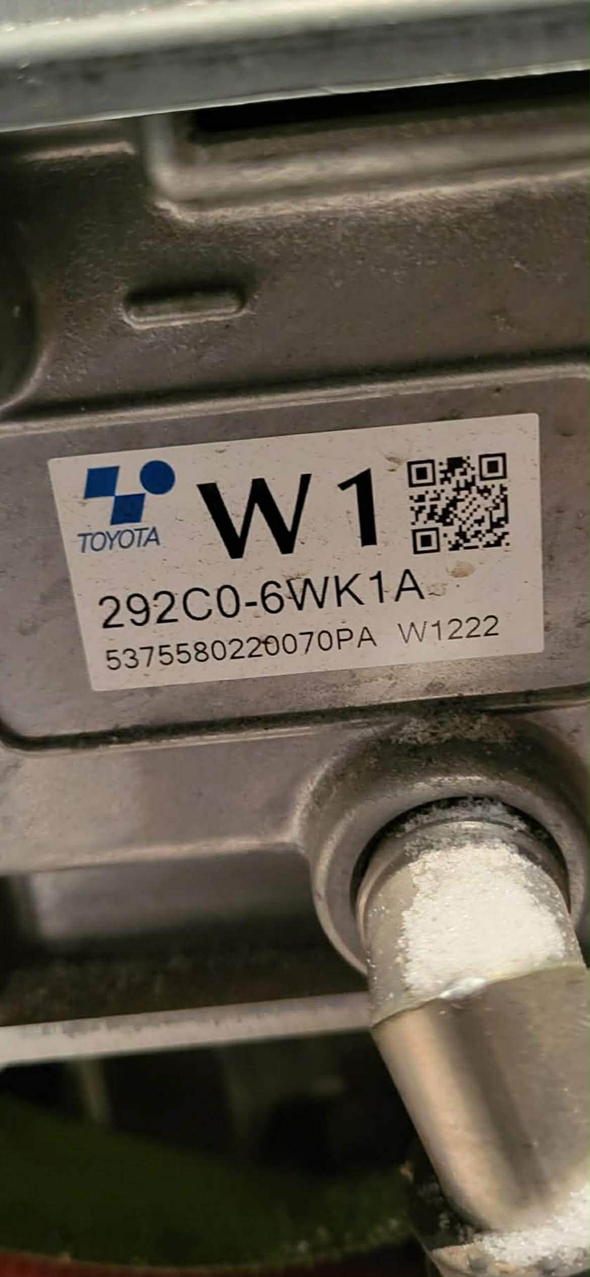

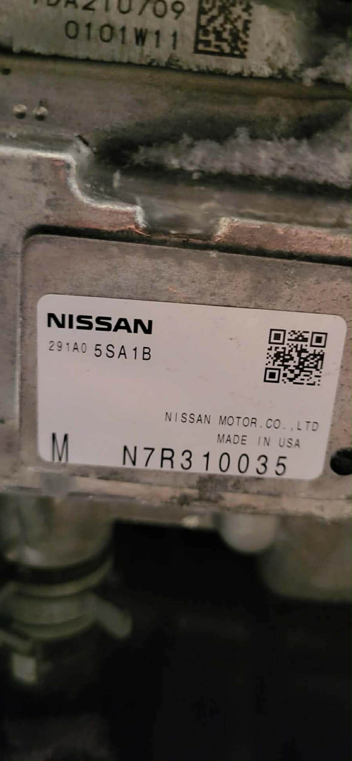

I have a complete 2017 base Leaf.
That is totaled. 40 kwh pack

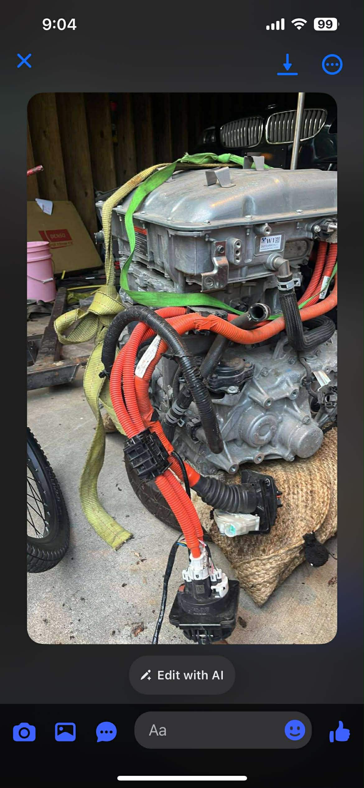

I have an opportunity to purchase the motor and inverter and ?(charger) from a wreck leaf built 8/2022 . The complete motor stack. It was also a base model with a 40kwh pack that has already been sold.
What is the difference in motors and inverters between these two options?
And do i need to have a higher voltage pack to take advantage of the increase?

Timf1981 wrote: Tue Dec 30, 2025 3:31 am What is the difference in motors and inverters between these two options?
The newer stack with Toyota PDM has not been hacked yet so it won't work for now. CAN messages are different between those stacks. Otherwise there should be no significant differences exept that Toyota PDM is a slimmer profile and should be easier to fit. Also no higher voltage requirement but you can run a 108s battery so up to ~435v with Leaf stack if you want to.
