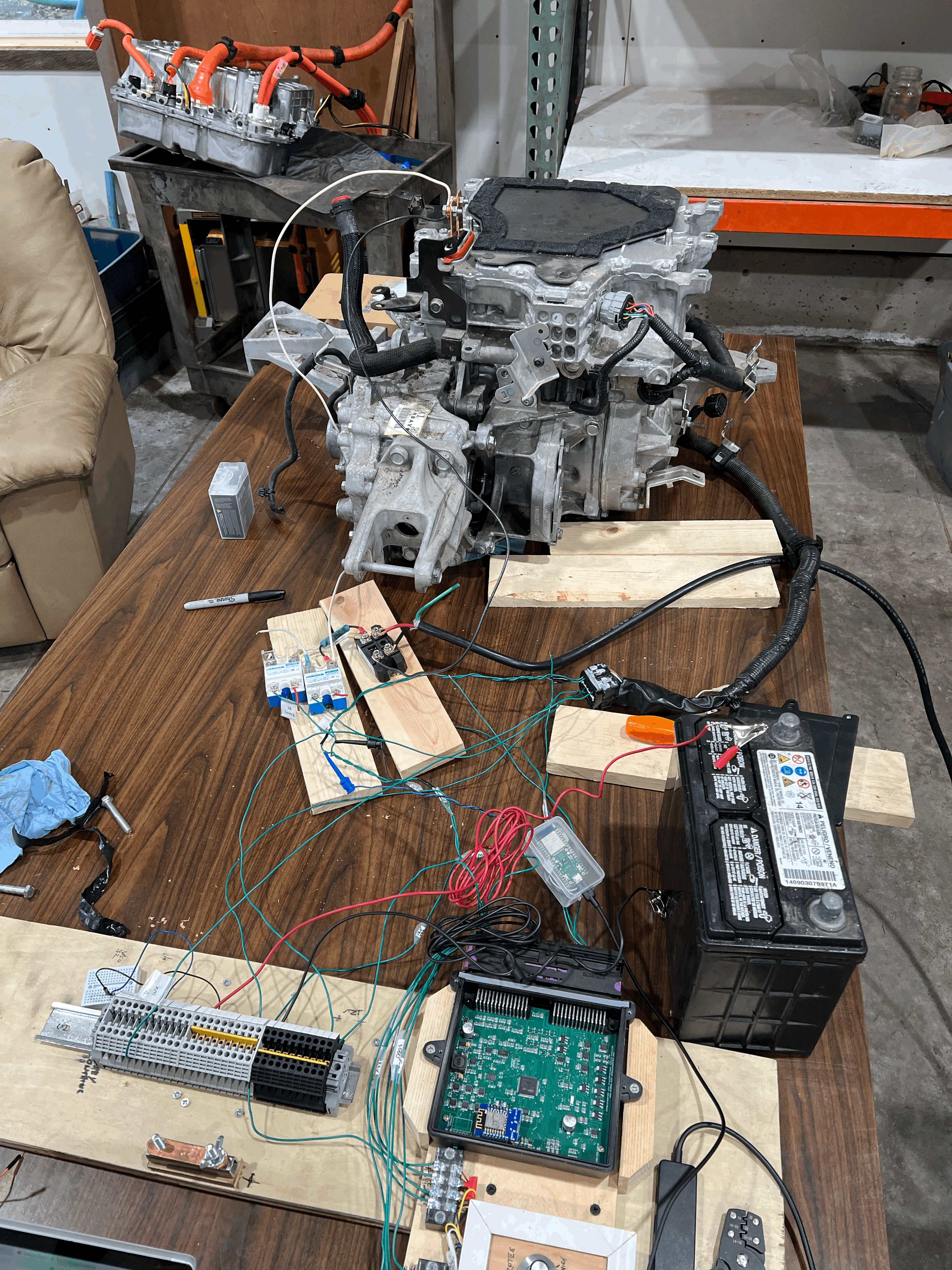

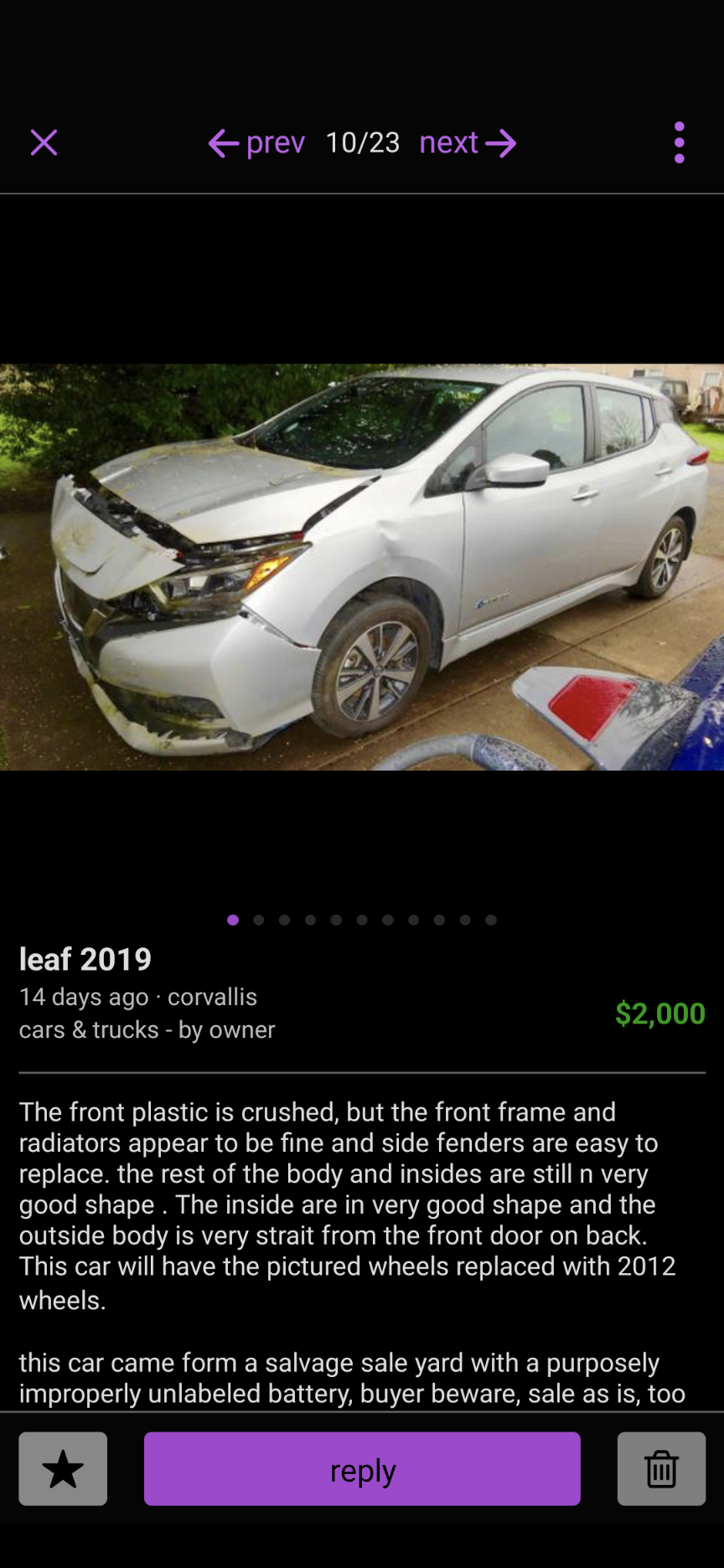

So far we bought a leaf with front end damage. We've pulled the motor out and did our first spin using the battery it came with (not the original), and the zombieverter. It was just a short spin on the bench as proof of concept, to convince ourselves we could wire and configure it correctly.

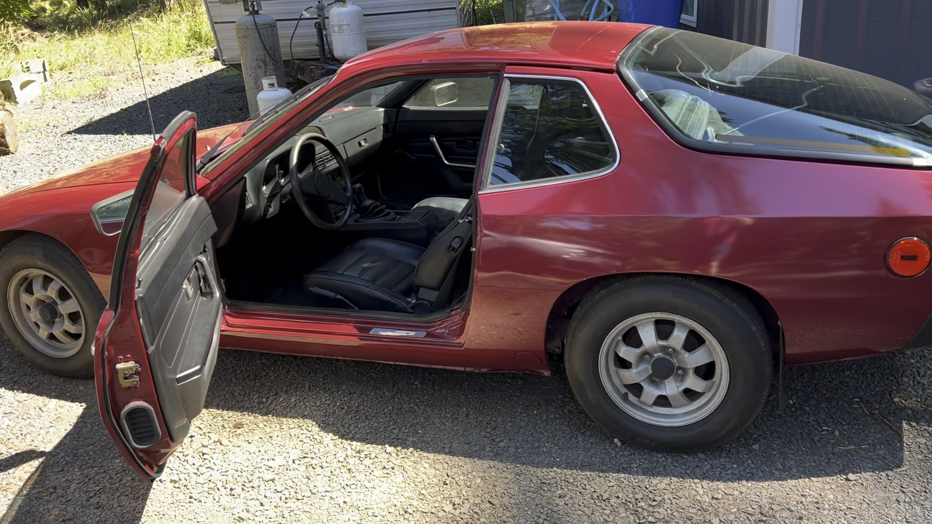

We bought a 924 and removed all the ICE components. Now we're looking at options to mount the motor in the back. The plan is to use the leaf diff, and to cut and weld the half shafts together (pretty common, I think). Then test the fit up and then have real ones made in a shop. I'd love to get a limited slip diff, and I know they're out there. But will wait to see how this does first.
I think we're going to take the stack apart, and mount the inverter and PDM separately. If anyone has strong opinions on whether or not that is creating a headache for us, I'd love to hear your thoughts. We might also remove the backseats to make more room and give us more options. The backseats aren't really usable anyways.

Splitting the stack has been done many times, so it’s an option if you need it. Benjamin Nelson did a good Leaf stack tear down on YT if you need pointers. On my build I ran the coolant backwards through the PDM due to how it was arranged and has worked fine (1000+ miles). I used Johannes’ PDM tear down vid to help me decide that was likely to work. There’s also some useful 3D printable covers around depending what HV you expose in your new arrangement.

Alternativly sell the pdm, and get an outlander obc off ebay for cheap.
Much smaller, easier to mount and a lot less weight.
Yes only 3.3kw but if you set up CHAdeMO you’ll be fine for “road trips”
Pdm’s are worth a lot being the fast charge contactors and other parts fail in them, makingthing wortg $$$ for repairs.
