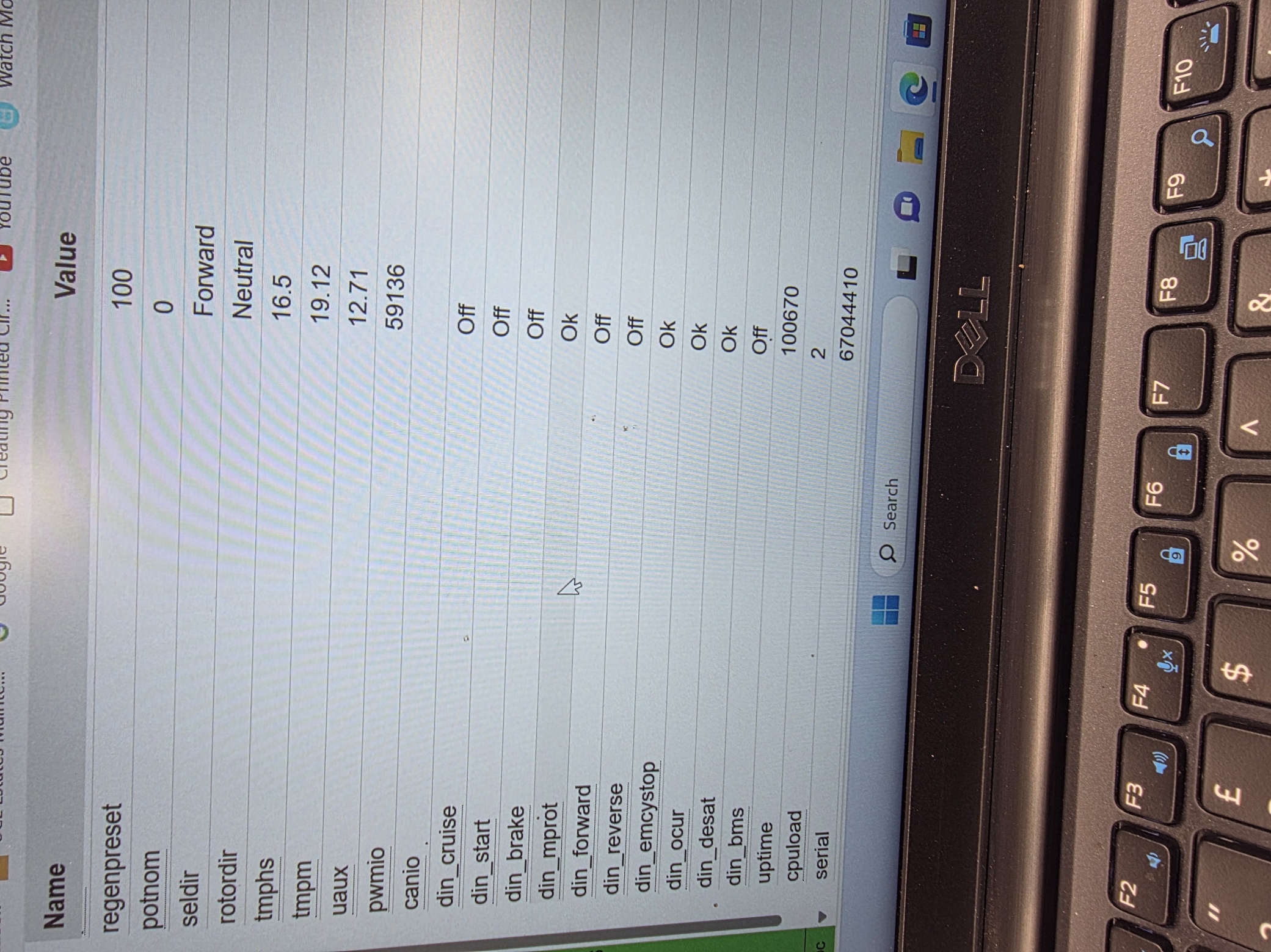

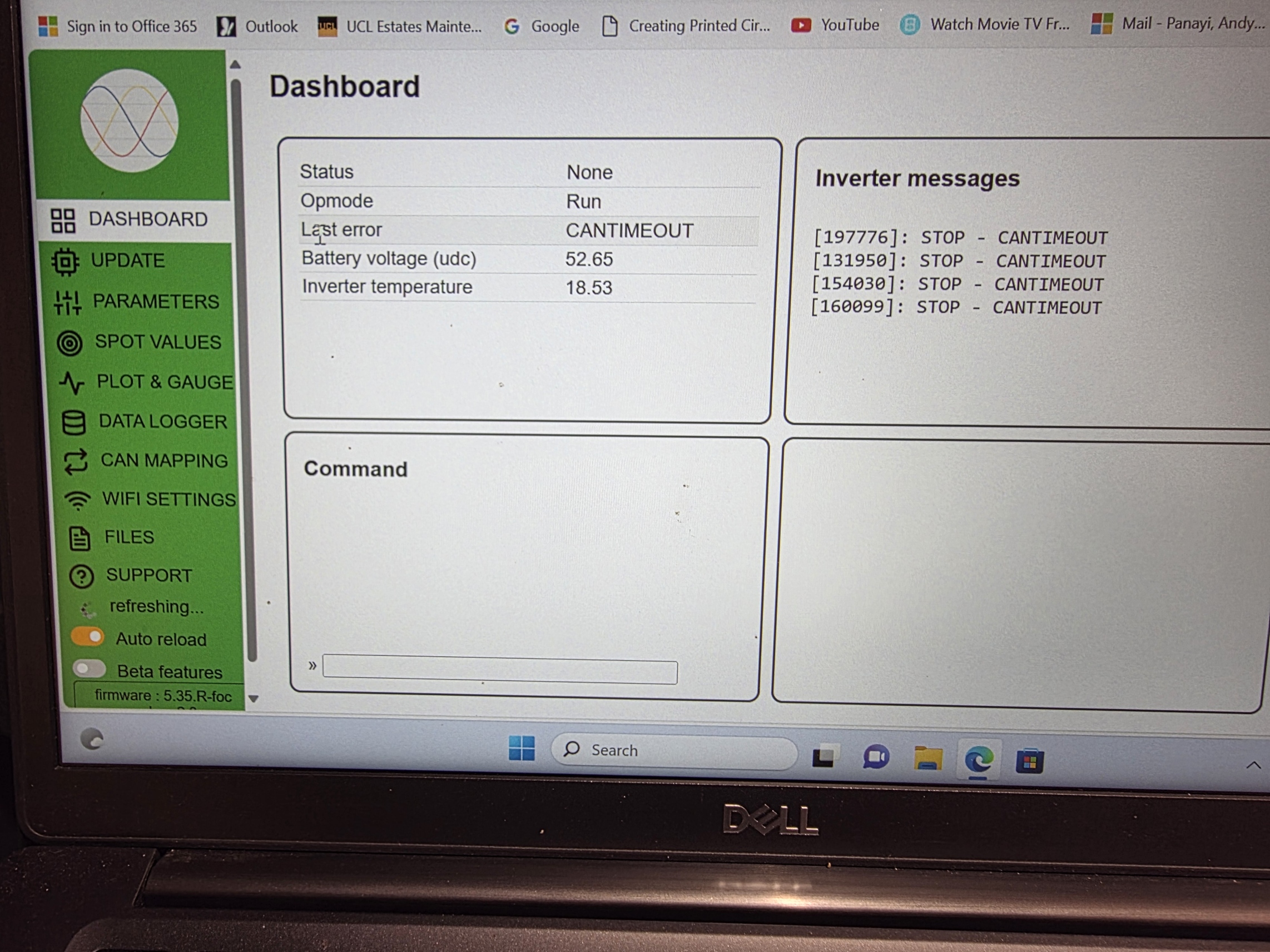

Help needed please.
I have installed the OI board to a Leaf Gen 2 Oi board.
Inverter will not go into manual start
I just want go ahead and setup the syncoff for the motor.

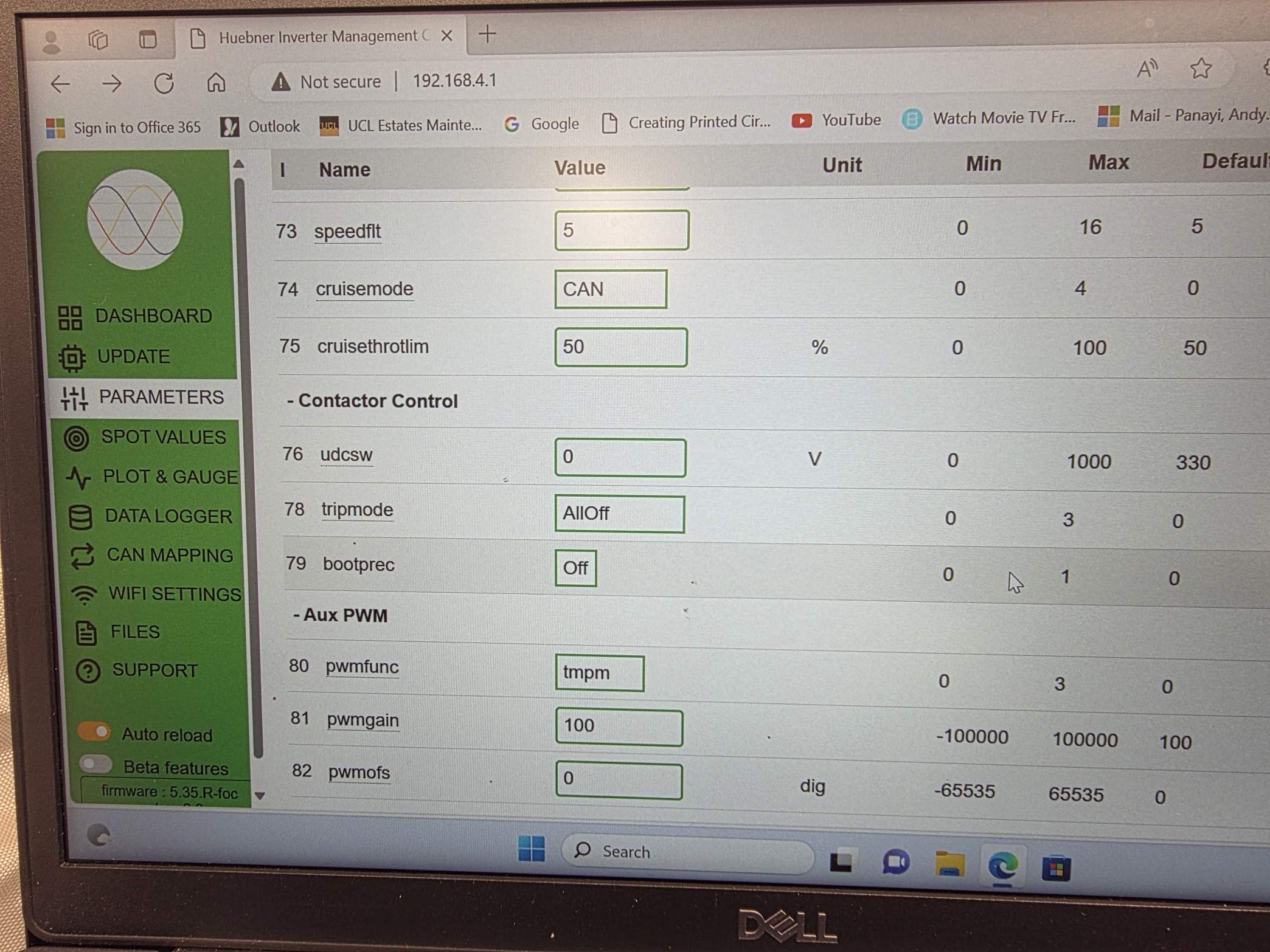

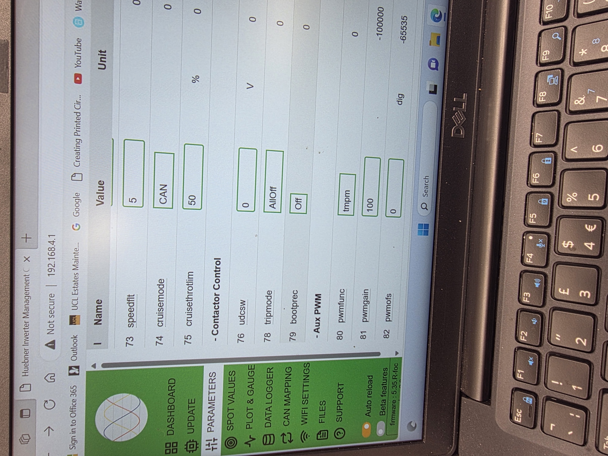

I have done some research have set udcsw=0 and potmin=500
All I have connected to the OI board is 12v power to the board , no other wiring, hoping to connect to ZM later on once inverter is setup

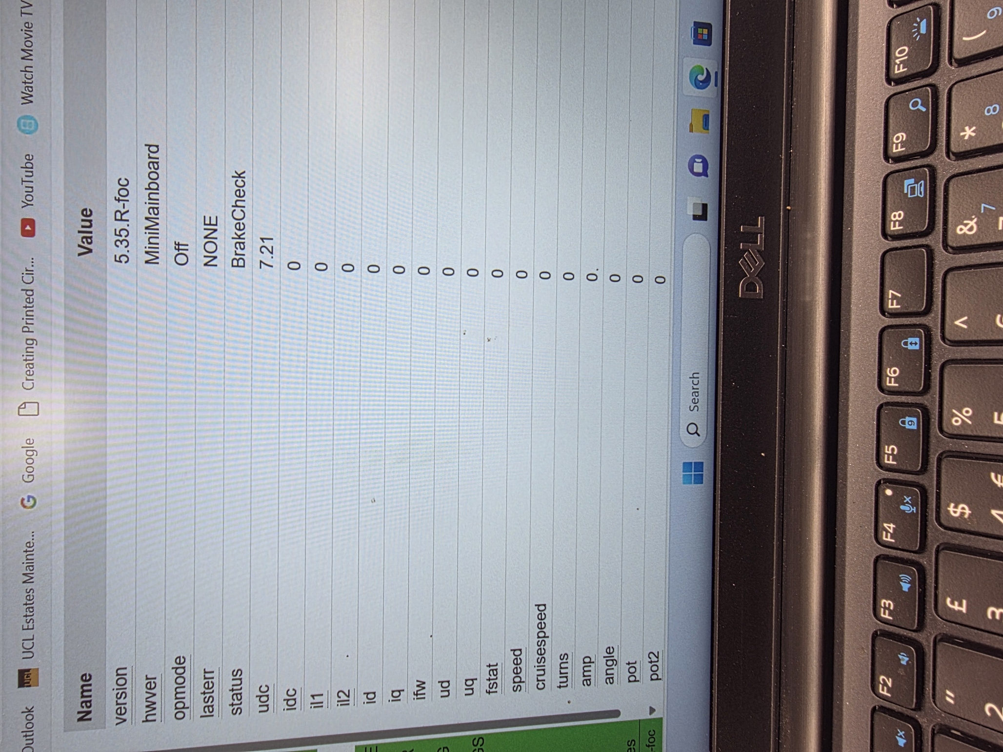

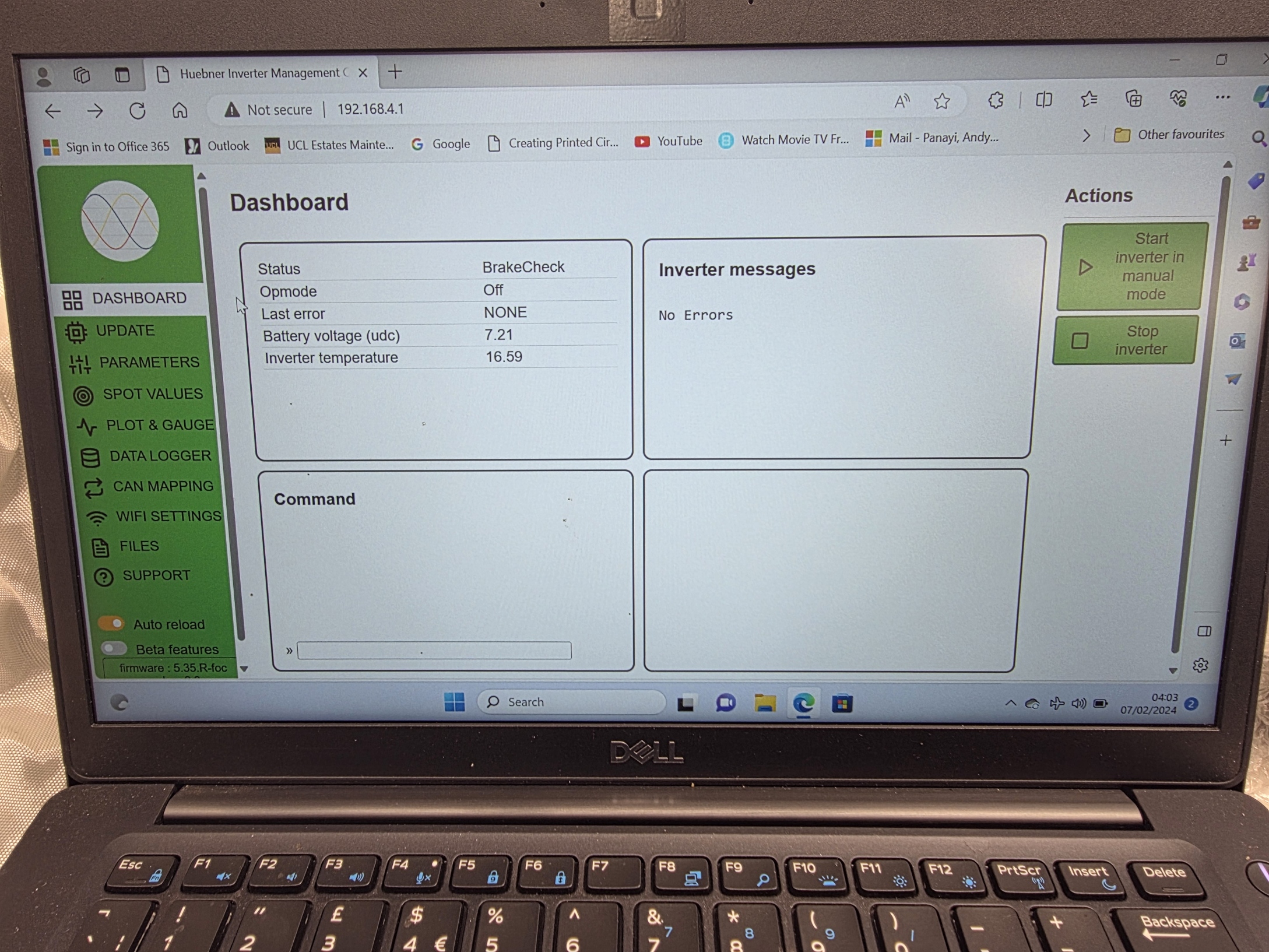

Status is saying "brakeCheck" will this have any effect, I don't really want to add any extra wires to the OI board, want to wire Zombie eventually .
Why is battery udc showing 7.21v I don't have anything connected to the HV side
here are some pics.
Anyone help?

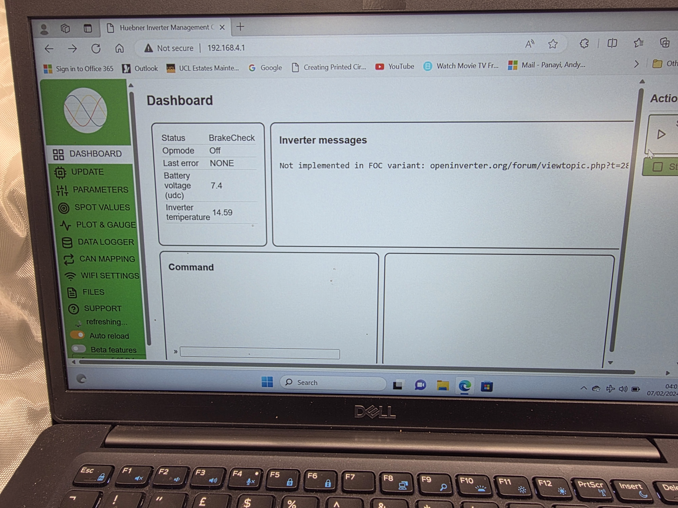

I tried the "manualstart" button which only bring up the thread mentioned.
still wont go into run mode
Been thanked: 1918 times
Re: Leaf OI drop in board- wont go in manual start
It does the same checks as pushing the physical start button. Disable cruise control to get past "BrakeCheck". status must me WaitStart

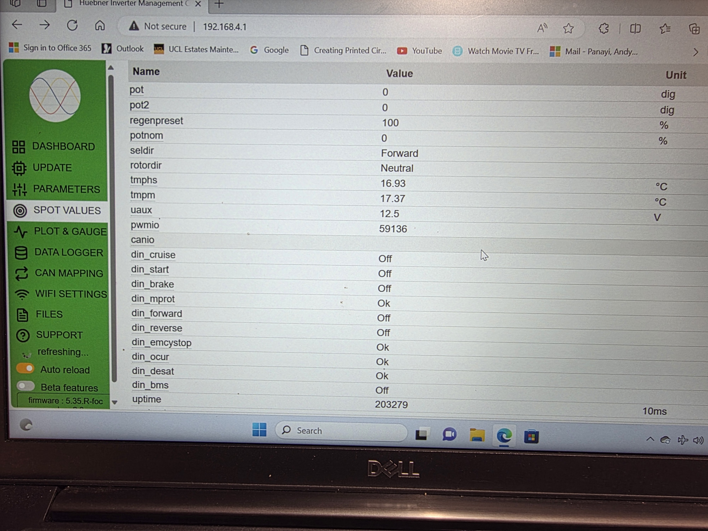

...ok disabled cruisecontrol..
inverter is in waitstart.
I have added 60v to HV... i am adding value to the syncoff setting, I get the PWM hum but no movement on the motor.
have tried different setting and even went upto 25amps on the manuid, still no motor movement
only errors i see is CANTIMEOUT
when I go to the plot setting SELDIR is in FORWARD, and ROTDIR Is in NETURAL is this correct
Can anyone point me in the right direction.

Okay, depending on the hardware revision you may need to do that. There's a thread about it on here somewhere. I had to do pinswap = 6 on my revision.
The one with Mini mainboard needs the extra resolver pinswap
https://openinverter.org/forum/viewtopic.php?t=2760
Also moving this thread to Nissan as it's not VCU related
