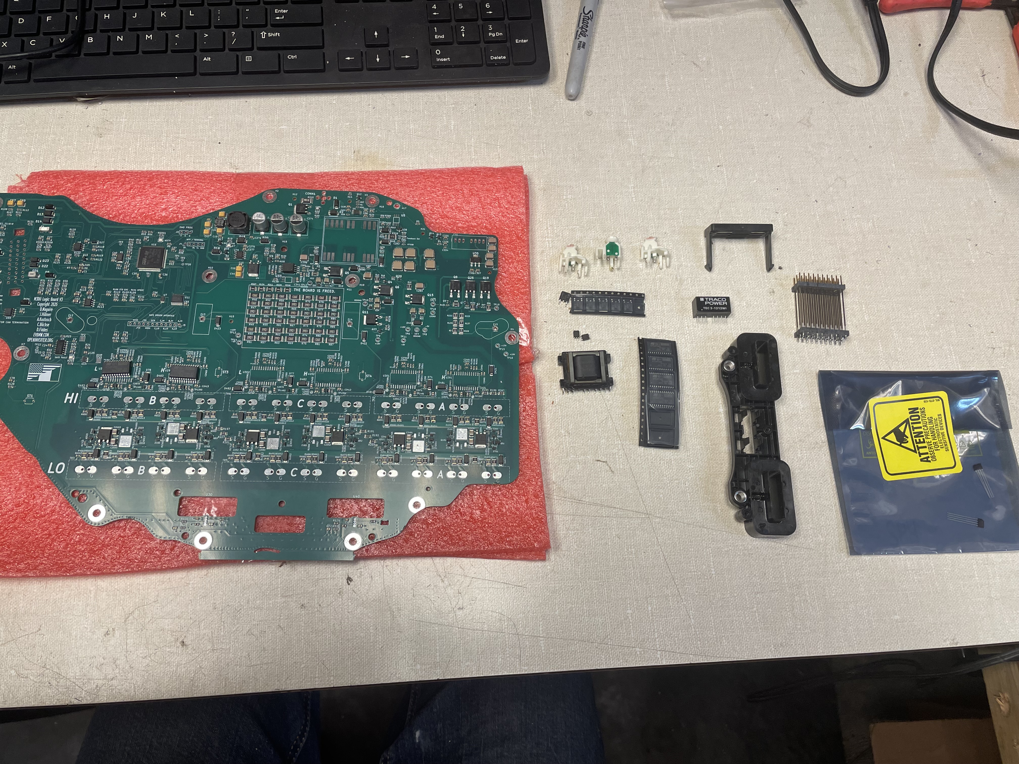

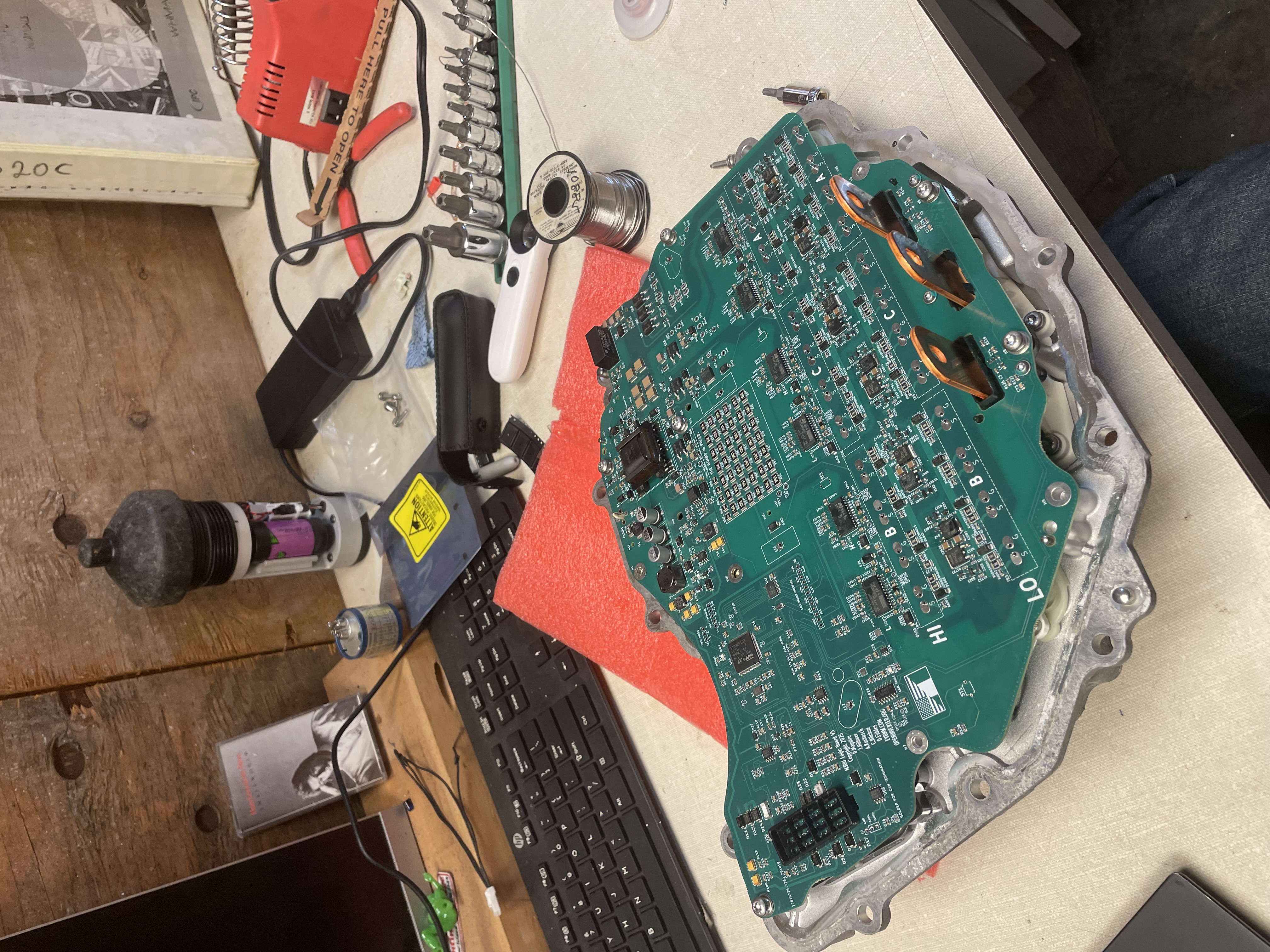

I hum and hawd about re using the oem gate drives off the orginal board, the confromal coating remover did not work as well as i hoped. Ended up hist buying new drivers for around 10$ each.(cad)
Went ahead and assembled my dev board, and relised I didn’t get temp sensors as I thought I could harvest them from the orginal board! Oops.
Everything is looking good so far, once temps sensors are in should be up and running.

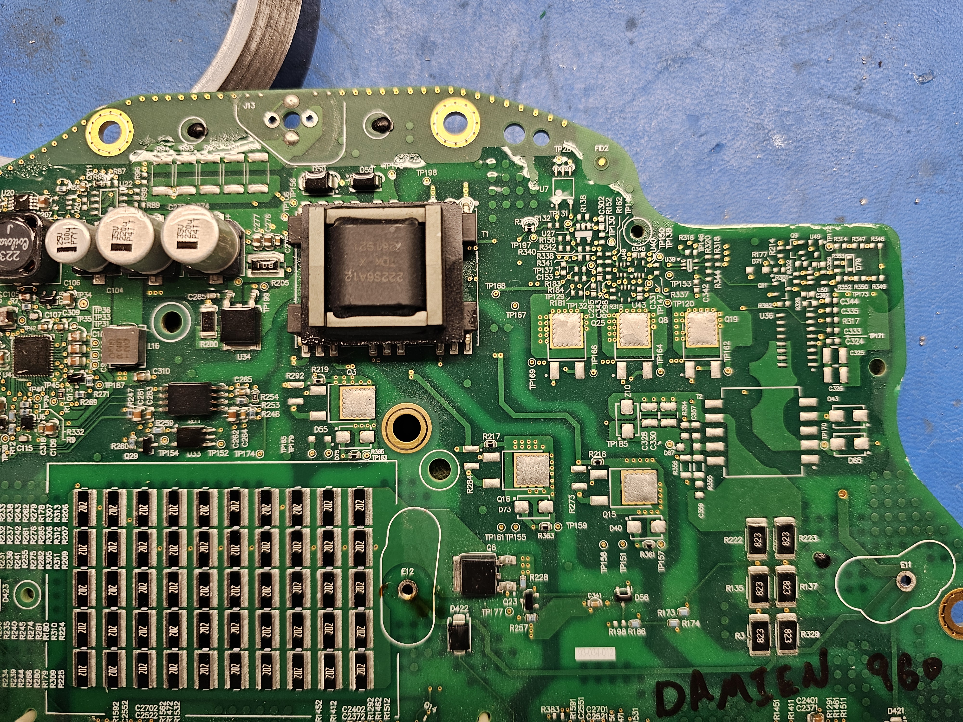

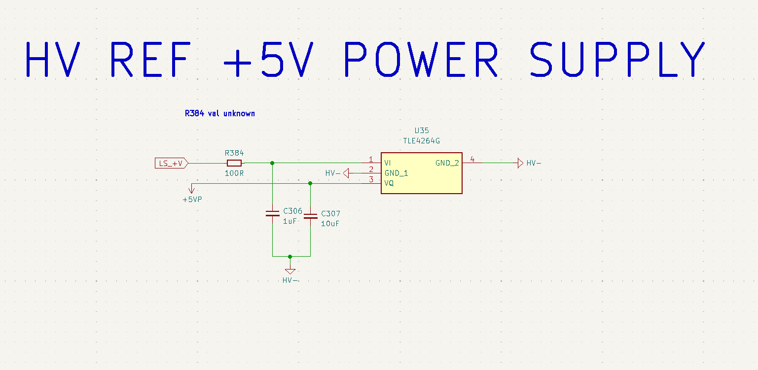

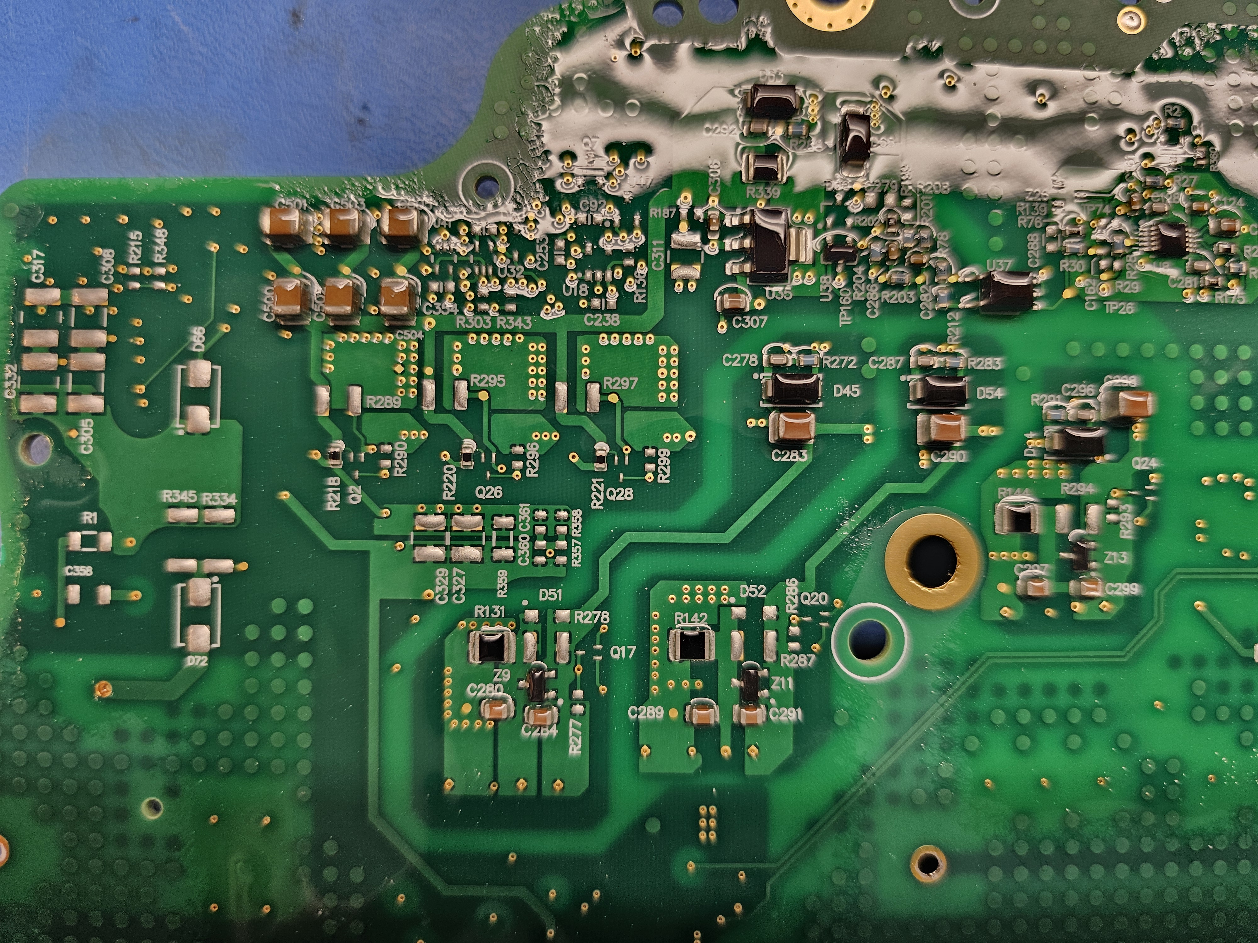

So been pouring over some high res pictures of the 960 board this morning and my best guess on the supply to the HV side 5v reg is......they replaced the whole hv derived psu with a single 0805 resistor and called it done!
There are a few other changes I've spotted in the gate drive section such as different resistors vals for the front vs rear etc but more on that when I get my hands on the boards.

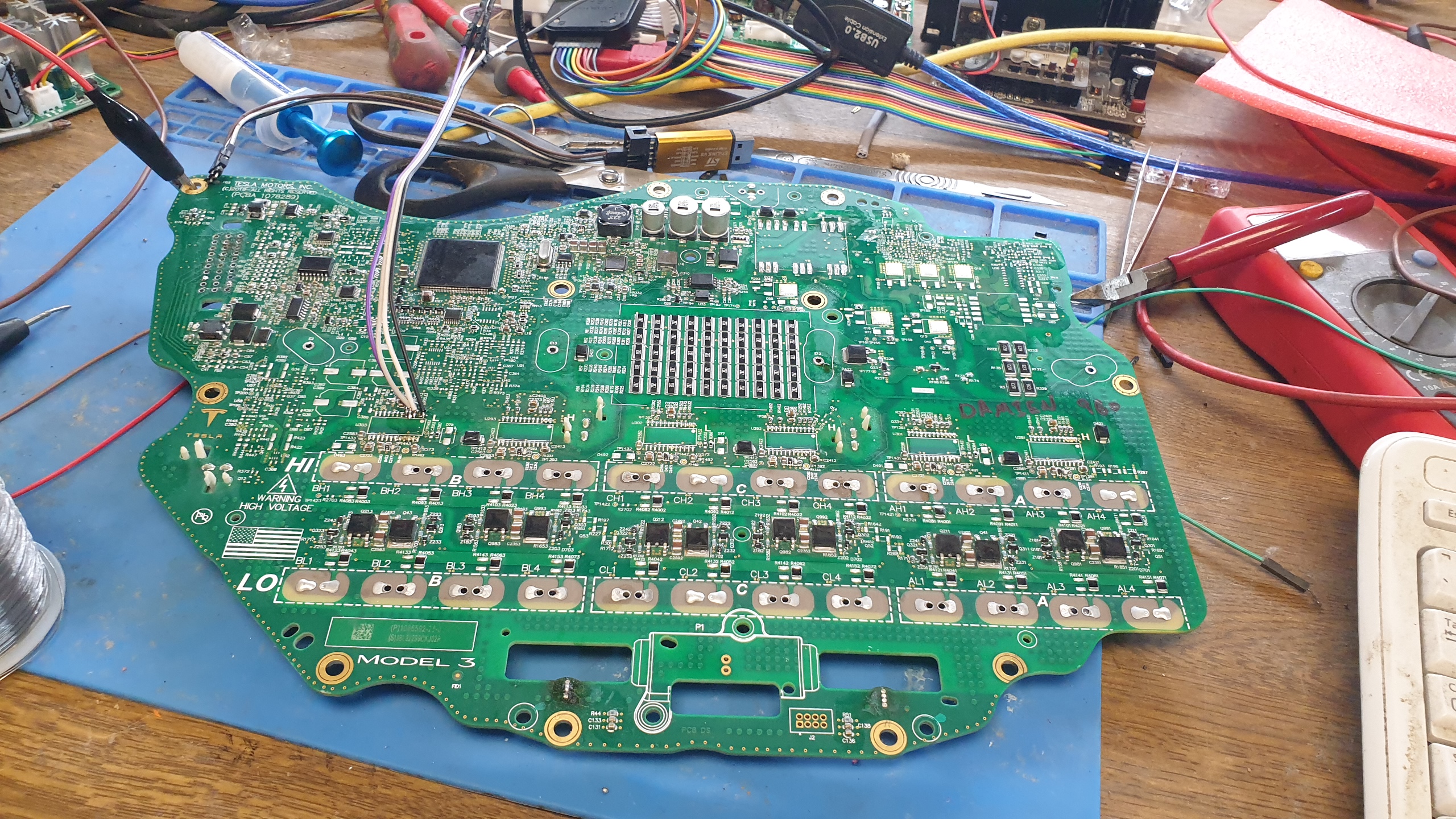

temp sensors arrived! im on the final stages of assembly.
just doing a test point voltage check.
everything but the temp sensors are installed
il1 and il2 are reading 1.57v
tp6 is reading 12.86v (along with the rest of the 15v test points) with the oem transformer ----this seems sufficient ----
tp8 is reading -5.15v
no gate driver faults detected. (led has faint glow)

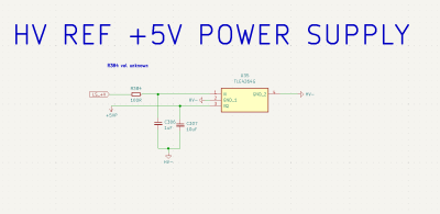

Back in the saddle. Boards arrived from the US. Confirmed how they do the 5V HV side supply now on the "960" is indeed derived from the low side driver supply. Bad news is I can't get a capture of the spi as this board came minus the gate drivers , transformer and current sensor block so am guessing the Elon brain is upset and not bothering to send config. Will see what I can sort out.
So basically it looks like I can send the V3.2 to JLC for production...

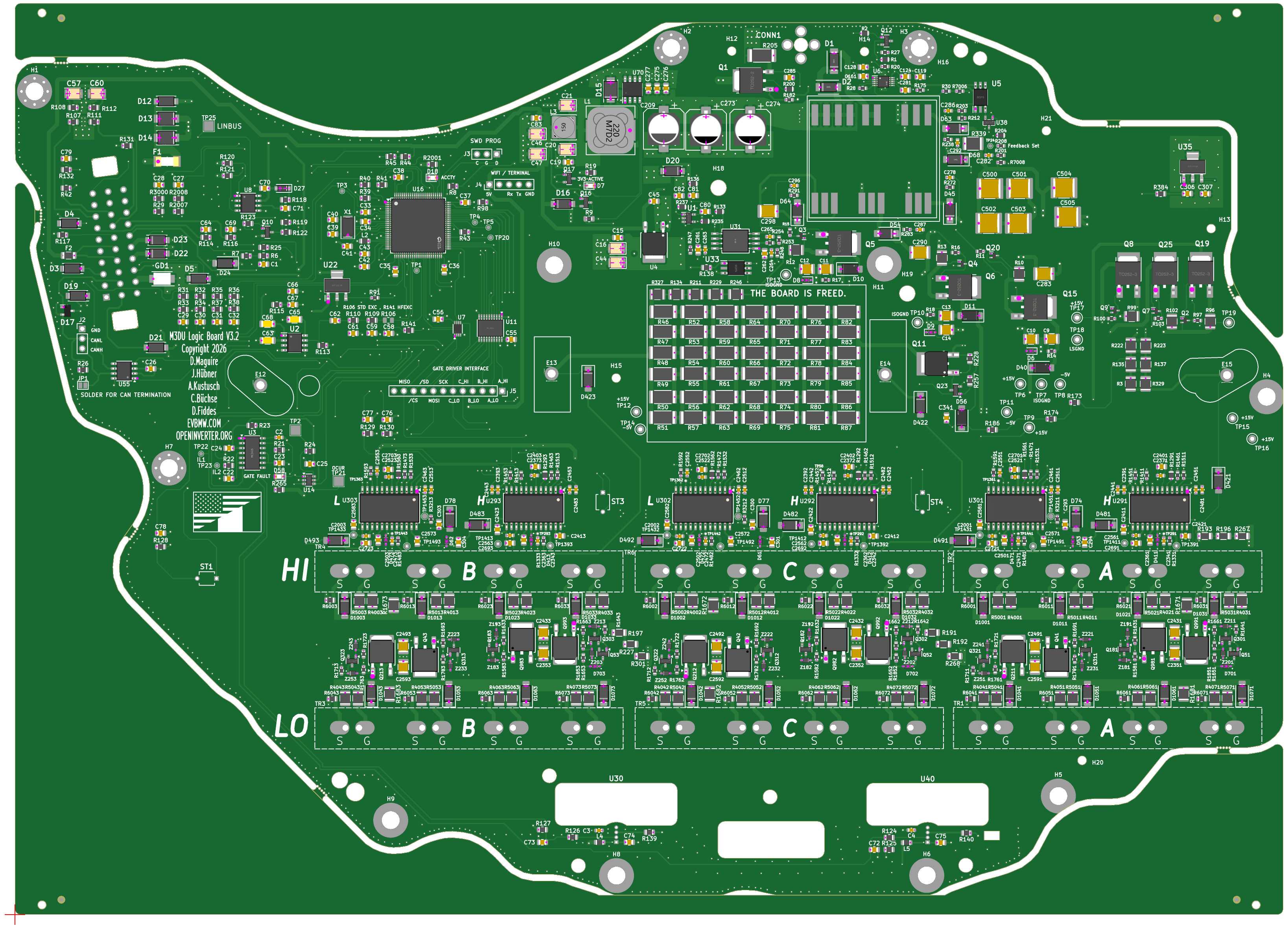

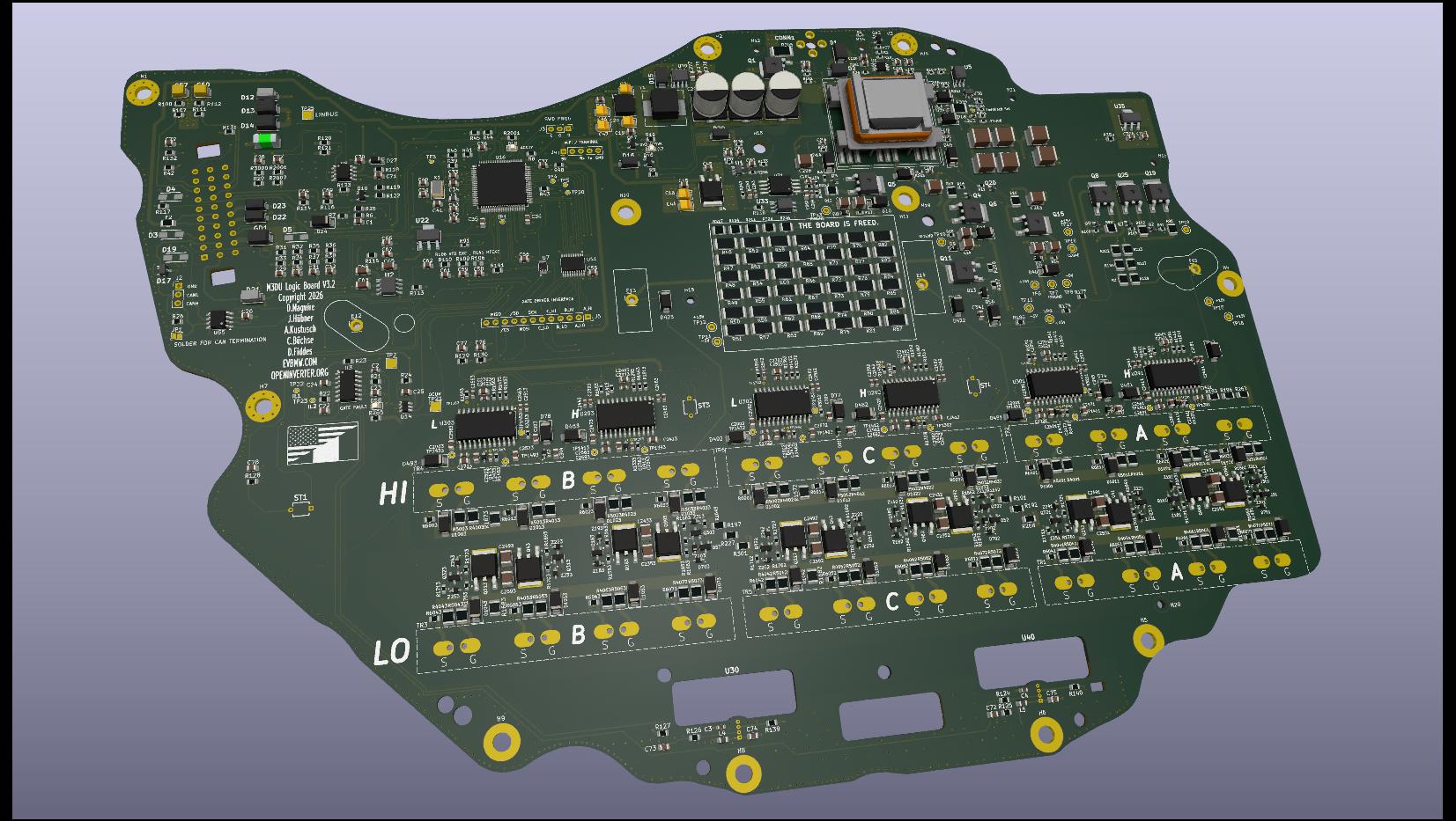

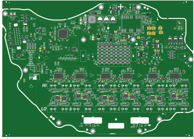

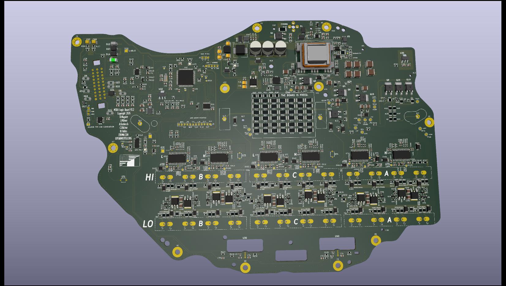

Attached 3d view and pdf schematic. Going to push the button on ordering these tomorrow all going well.
M3DU_BoardV3_2.pdf- (2.69 MiB) Downloaded 12 times
davefiddes
- Posts: 416
- Has thanked: 206 times
- Been thanked: 256 times
Looks like there's something up with the schematic. Lots of components aren't connected around the DC bus discharge. Has anything changed with the system behaviour that would affect the firmware?
- Posts: 4000
- Been thanked: 1116 times
Sorry don't know what happened there. Should be fixed now. No code changes.

I've screwed up a bit and have only just checked the latest schematic in detail. Unfortunately it's missing fixes for two problems identified early in the beta.
The biggie is the lack of a pull down on the base of Q16 which causes the board to power on but never power off (if the MCU fails to initialise properly, boot loops, etc). I fitted a 10K from MAIN_PSU_EN to ground here.
The other problem is lack of a pull up on GATE_DIAG causing the LED to glow and risks tripping the inverter. I fitted a 10K pull up to 3.3V here (across R265 and D58). I've tested this in normal operation and when shorting out phase MOSFETs to cause fault conditions. The LED lights correctly and the extra current is minimal and well within the spec of the STGAP1AS.
- Posts: 4000
Don't sweat it Dave. Whole host of people could have spotted that and chipped in. I can do those mods on the current ordered board before shipping.
