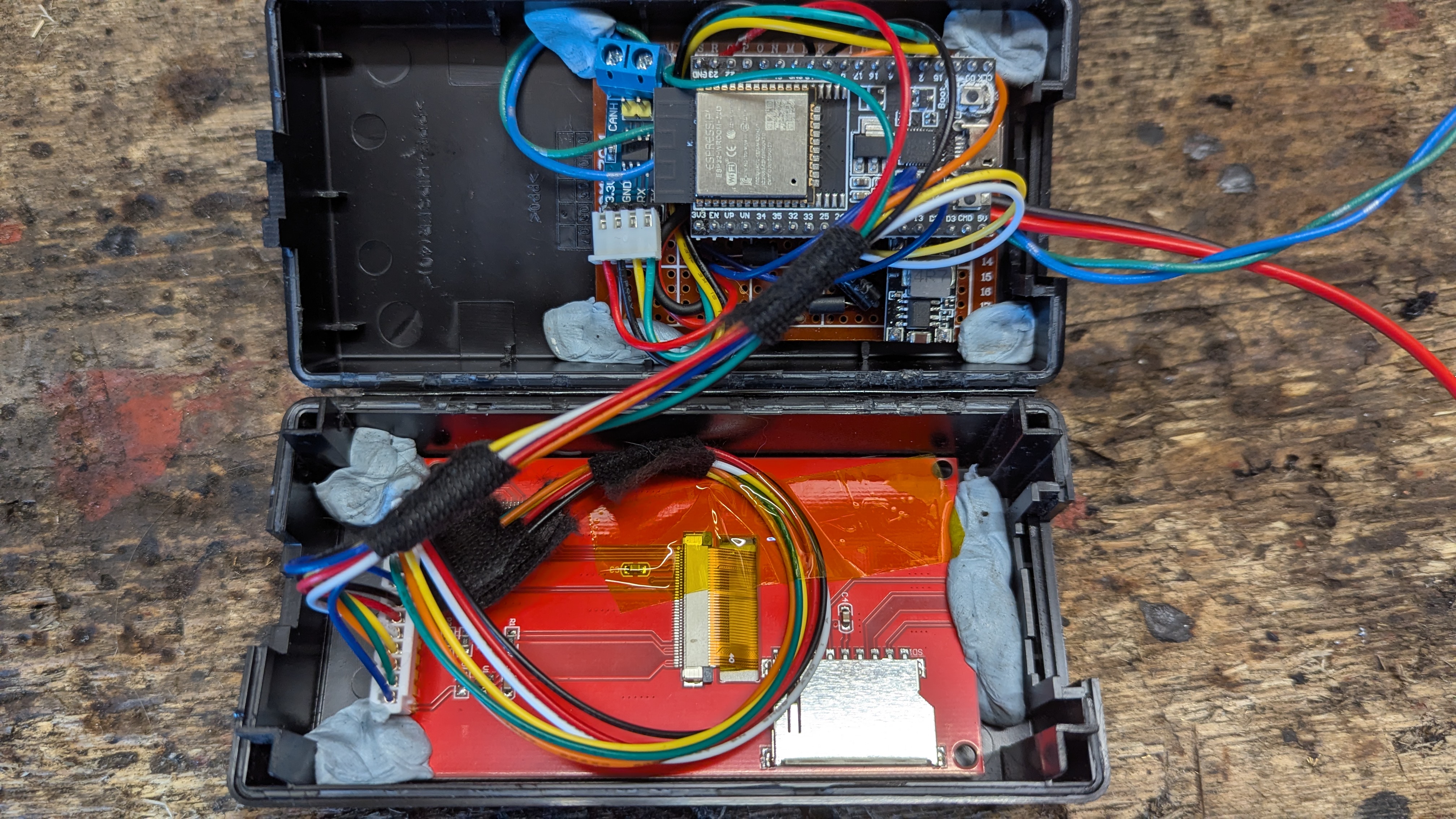

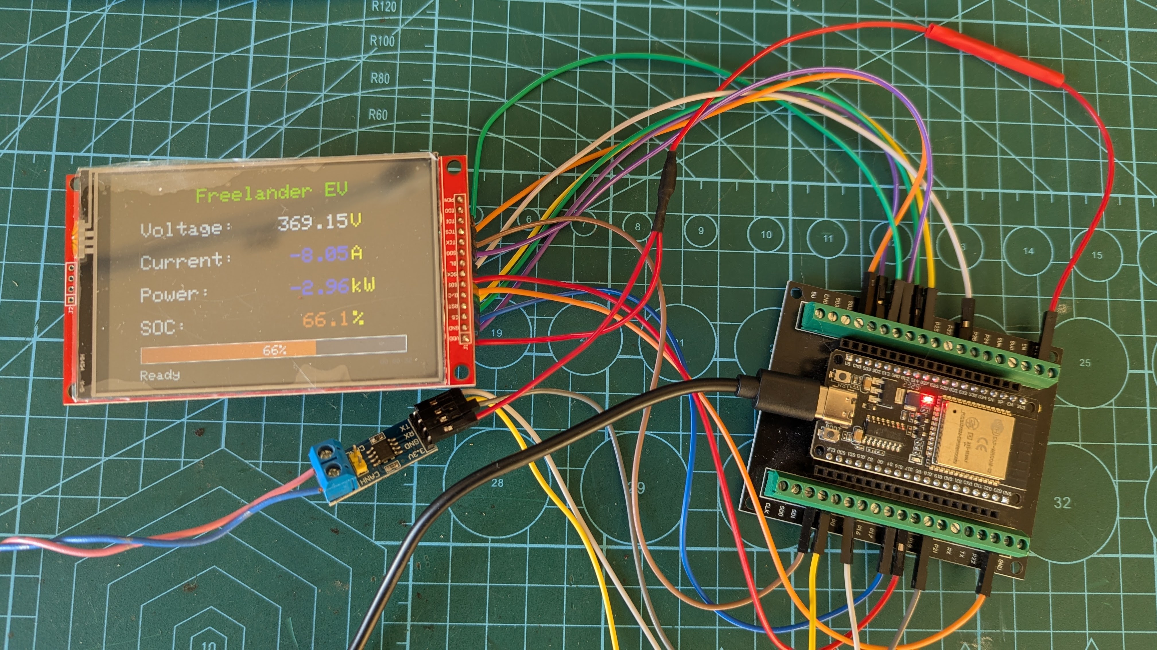

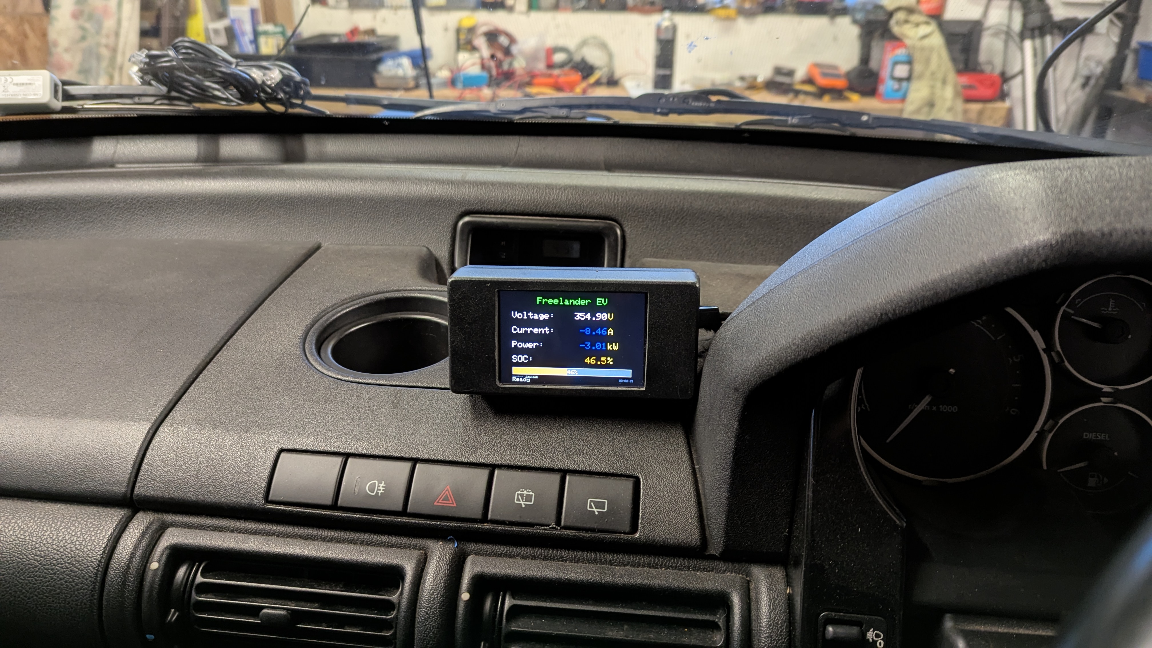

For anyone out there using the Isabellenhuette shunt this might be helpful.
I wanted to have real time display of voltage, current and power along with SOC so after many hours fighting to make Deep Seek do all the hard work I have something working.
It might not be (it really isn't) perfect or even particularly good but from the small amount of testing I've done it seems to work. Maybe you can use it as the basis of a decent display.
Requirements are:-
1 x 38 pin ESP32 Wroom https://s.click.aliexpress.com/e/_c45H9pLV
1 x SN65HVD230 CAN transciever https://s.click.aliexpress.com/e/_c3gFRCKr
1 x TFT display, I used a 3.5" https://s.click.aliexpress.com/e/_c3O36uVd
I also used a small 5V buck converter connected directly to the 5V pin of the ESP32 but added filters and diodes https://s.click.aliexpress.com/e/_c3rjjZ11
So here is what you need to do.
1. Install ESP32 support in the Arduino IDE and select it.
2. Install the TFT_eSPI library.
3. Change the User_Setup.h in the TFT_eSPI library to match your TFT display. I have included one here that worked with my setup
4. Connect the display as described in the Readme file.

Here is the ESP32 code I used
Working_ESP32_and_TFT_Display_Ver1_3_1.ino
(22.83 KiB) Downloaded 4 times
These are the connections to the ESP32
3.5 inch TFT display connections.txt
(1.11 KiB) Downloaded 7 times
This is the Usersetup.h file with the changes from default. This needs to go in the TFT_eSPI library
User_Setup.h
(18.93 KiB) Downloaded 1 time
So the TFT_eSPI is the only library you need for this to work.
