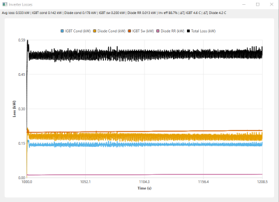

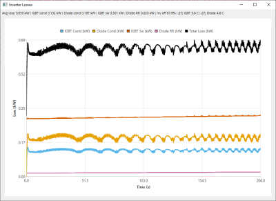

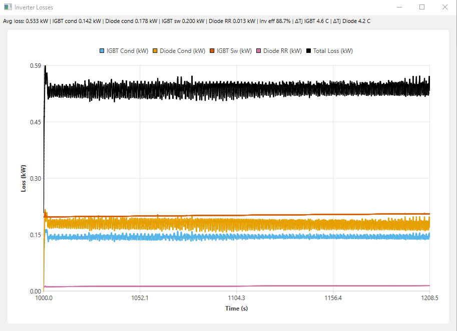

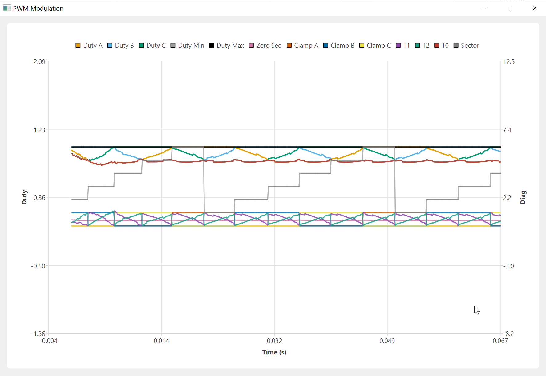

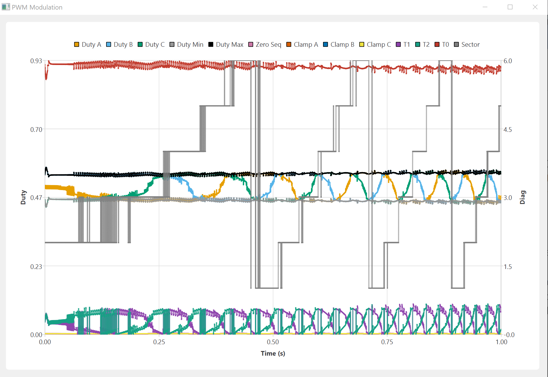

So spent most of the night with a few gifted agents vibecoding this fork:
https://github.com/skrubis/IPMMotorSim-PWM
It is an effort to refactor and extend the IPMMotorSim to a into a PWM-edge, deadtime-aware inverter + motor simulation that can:
  • generate *actual switching waveforms per PWM cycle*,
  • simulate phase current ripple and current paths (MOSFET/IGBT + diode conduction),
  • estimate inverter efficiency (conduction + switching loss),
  • sweep modulation strategies (SVPWM, DPWM variants, hybrid/blended),
  • export results for building a real-time mode scheduler (when to switch which PWM mode).
Non-goals (for now):
  • full EMI modeling, parasitic inductances, snubbers, detailed gate-drive transient waveforms
  • thermal coupling beyond simple temperature parameterization

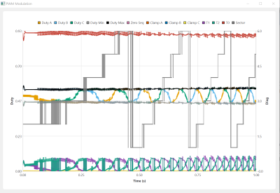

Implemented Functionality (this fork)
  • SVPWM + DPWM variants (DPWM0/1, DPWMMIN/MAX) with blend control.
  • PWM modulation graph with zero-sequence/clamp/timing/sector visibility toggles.
  • Power stage loss estimation (conduction + switching + diode recovery) with PM300CLA060 placeholder curves.
  • Power stage parameter editor (deadtime, thermal, Vce/Eon/Eoff/Irr/trr curves, etc.).
  • Inverter losses window with per-device loss breakdown and averaged summary strip.
  • CSV logging includes modulation diagnostics, losses, and basic thermal estimates.
PWM/Loss Model Shortfalls (current limitations)
  • PWM is still averaged per control timestep; there is no event-based switching timeline yet.
  • Deadtime and conduction paths are modeled per-period, not per-edge; no minimum pulse clamp.
  • Switching loss uses curve interpolation without gate-drive dynamics, Miller effects, or parasitics.
  • Diode recovery is approximated from Irr/trr; no detailed charge waveform or reverse recovery shape.
  • Thermal model is first-order with fixed Rth values; no coupling or Cth from datasheet.
  • Motor plant remains the legacy average model, so phase current ripple is not yet resolved.

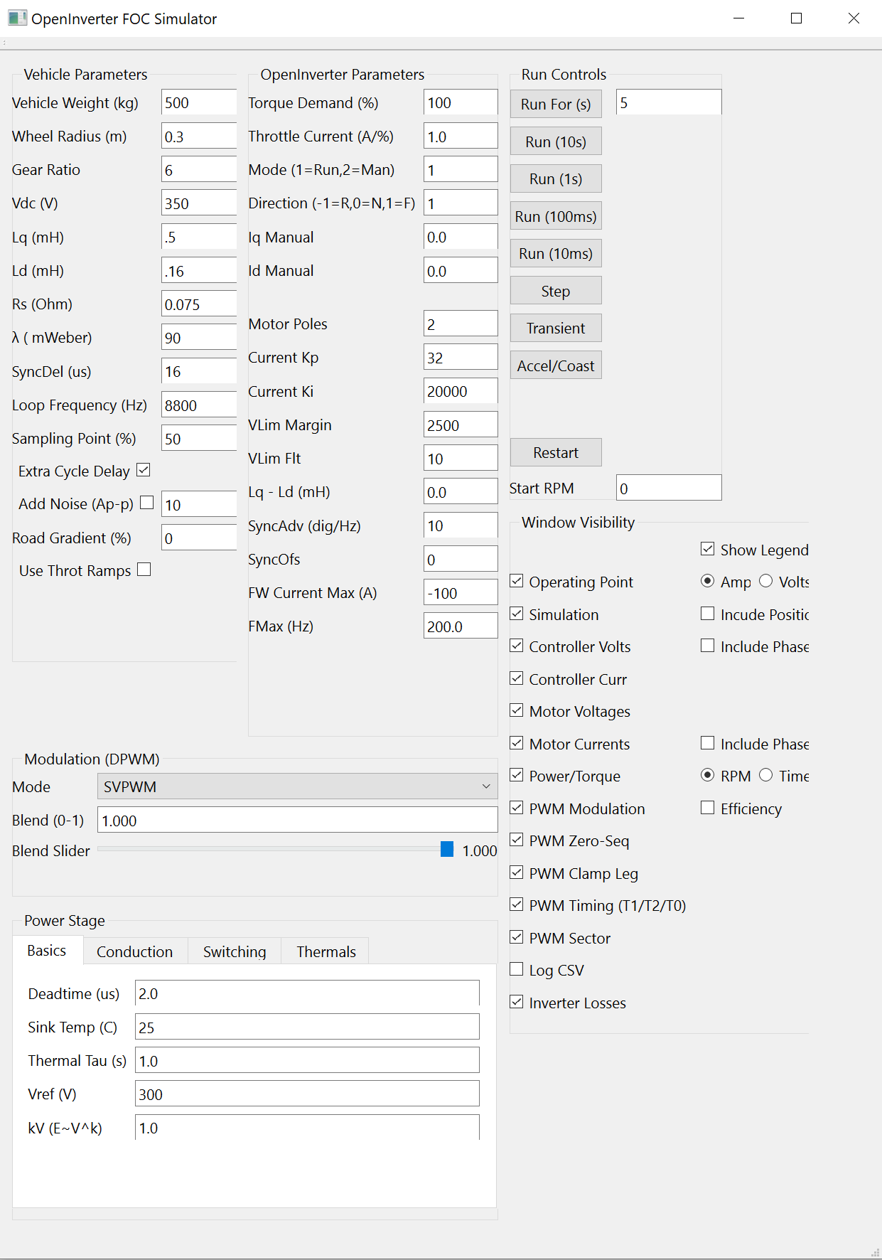

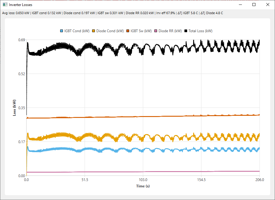

My motor-fu is inadequate to even have a grasp on what I am even looking at, given that this is my first time interacting with this software, for most of the knobs I have added helper text, but I still have a lot of theory to learn.
I have no test motor to try and measure constants for, so whatever was there by default I used. For power stage constants Mitsubishi PM300CLA060 is used, it's an ancient IGBT brick my electric motorcycle uses from the factory.
SVPWM, start at 1000RPM:
DPWMMAX, start at 1000RPM:
I would be very happy if anyone with knob turning skills could give some feedback.

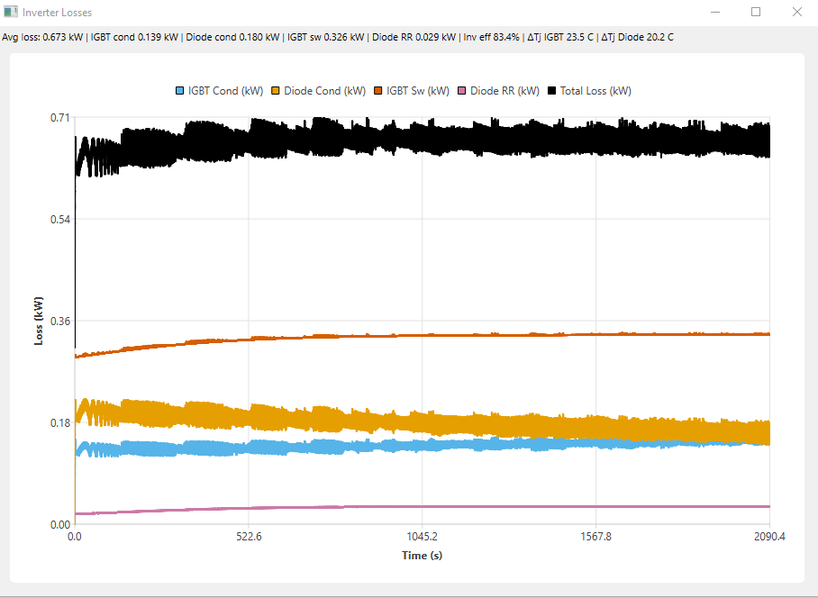

So the latest commits on github now do per edge loss estimations, which should be much more closer to reality.
There are now a few more power stage presets, namely LDU, SDU, Leaf gen2,bmw I3ish one along with the vectrix vx-1 powerstage. I tried to add as much as I could about each of these powerstages, including DC link caps, and parallel devices, but needs to be double checked for acuracy.
There now is an option to use some of jsons I fetched from /parameters db using foc builds, as well as browse for a json file. This doesn't address the motor constants not in jsons.
Which lead me to wondering, that a centralized place for motor parameters (fw and sim) would be of great benefit to anyone who sails this path in the future as now I am using random motor values found in the sim thread.
Github now has kind of working release CI building binaries for people who don't want to build from source, although mac OS builds are still borked. This still needs a lot of improvement, as, say, win bins still have some packed stuff missing from the archive, but should be a much faster way to run sims without signing up for a QT account.
My plan going forward is to make a headless sweeper to somewhat replicate the chalmers dpwm paper criteria and methodology, create a dpwm strategy supervisor and have some conclusions, with deliverables being a condensed pdf report (loss, THD, strategy) and possibly a LUT for inverter FW to use per motor to operate in an optimal loss area at all times. Maybe it's an overkill and simple "if modulation > 0.x do DPWM x" and leaving SVPWM for most low speed operation is more than adequate.
In a perfect world a real motor and its params could be simulated in various sweeps against given desired constraints to produce a tiny lut for inverter fw to use with little variance between individual motors of the same part number as long as in doesn't infringe with claims of any published and in-force IP in most jurisdictions.
