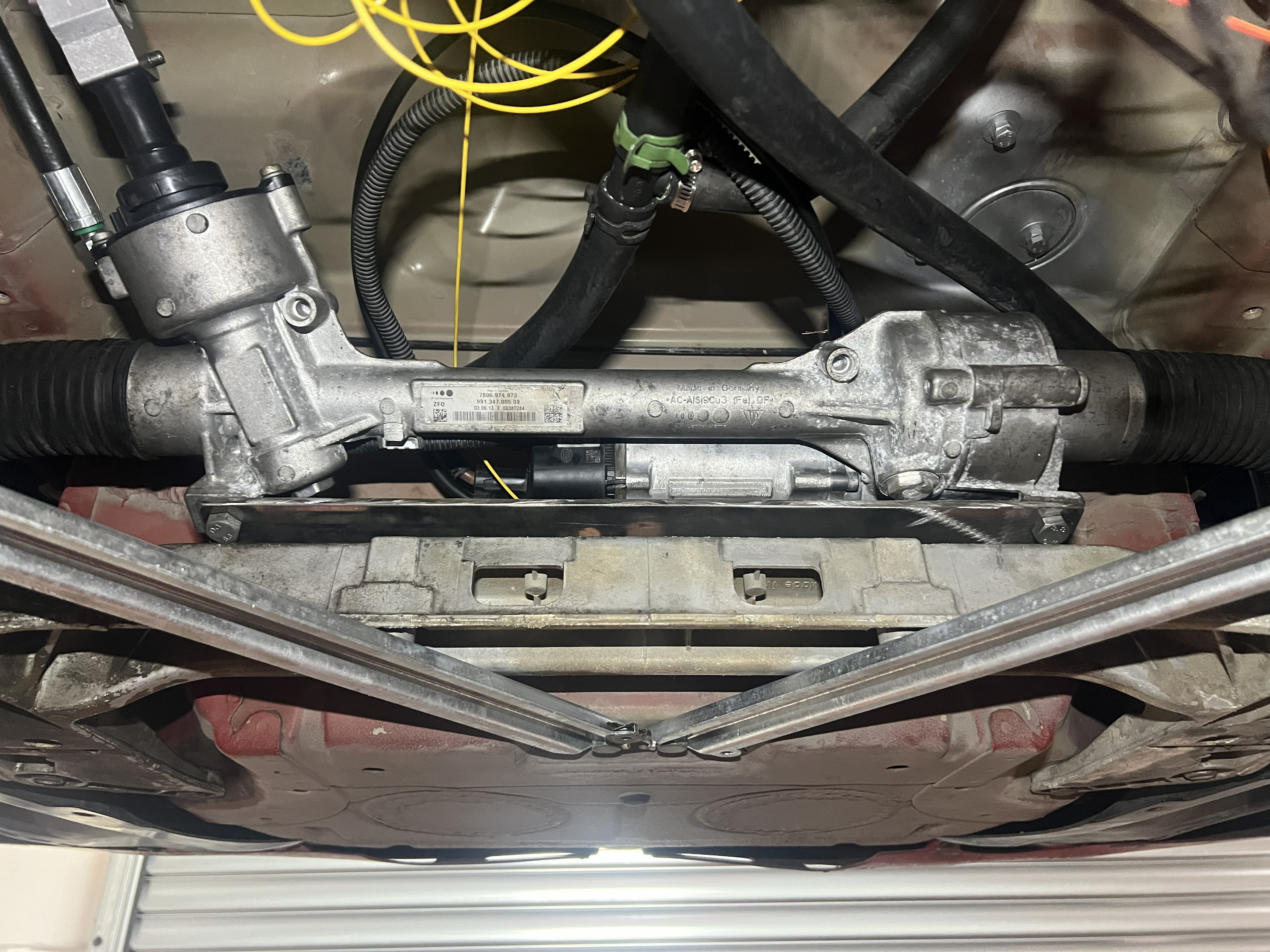

Hi all, first post here.
I have installed the steering rack from a 981/991 in my 987 EV conversion. However i couldn't get the power assist to work.
What is the bare minimum of messages i need to send just to get power assist. I probably do not need speed sensitive assist.
@Marc986 i can give you the measurements for my adapter plate. very simple steel part.
If it fits in the 987, there's a good chance it also fits in the 986.

Post by SHQAssel »
Here is the file for the adapter plate, if anyone is interested.
Adapter_steering_981-987.zip
(40.95 KiB) Downloaded 10 times

Post by Marc986 »
Thanks SHQAssel. Do you happen to have a thread on your conversion or on the mechanical aspects of this steering rack replacement? From your adapter plate it seems the rack has moved, was this to align the steering arms or correct the geometry? Or just a convenient way to overcome the difference in mounting locations? In that case, how did you fix the geometry?

No, i don't really have a thread for my conversion.
And yes, the rack has to move 3cm backwards.
This is because otherwise, the steering motor would interfere with the metal structure of the frunk.
This movement of the rack is only possible, when the fuel tank is removed.
between the steering rack and the steering column sits a telescopic shaft. You need to use the upper half of the 987 shaft and the lower half of the 981 shaft. The 2 halfs fit together perfectly.
The impact of moving the rack 3cm on the steering geometry should be minimal. Luckily the guy who will perform the technical inspection of my conversion thinks so, too.
Here you can see how the steering motor sits in front of the steering rack, which is why the whole rack has to move backwards or i would have to cut a hole into the frunk

SHQAssel wrote: Sun Mar 08, 2026 7:06 pm The impact of moving the rack 3cm on the steering geometry should be minimal. Luckily the guy who will perform the technical inspection of my conversion thinks so, too.
3cm will very likely cause a bunch of bumpsteer and some Ackermann change if the lower inner pivots are not parallel. If they are parallel it will at least effect the Ackermann.

SHQAssel wrote: Sun Mar 08, 2026 7:06 pm No, i don't really have a thread for my conversion.
Yes, from the images I had seen I figured it wouldn't clear the frunk. However, a slight reshape of the frunk wouldn't hurt too much. :D
SHQAssel wrote: Sun Mar 08, 2026 7:06 pm between the steering rack and the steering column sits a telescopic shaft. You need to use the upper half of the 987 shaft and the lower half of the 981 shaft. The 2 halfs fit together perfectly.
Isn't that just perfect! Things that fit together allowing us to upgrade to newer parts (with more or less work haha). Thanks for the valuable info

Marc986 wrote: Mon Mar 16, 2026 7:46 pm However, a slight reshape of the frunk wouldn't hurt too much.
I don't know about the 986 but in the 987 that part of the frunk structure is incredibly strong, not just one sheet of metal as you would expect if it was just somewhere to put stuff.
