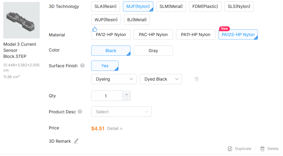

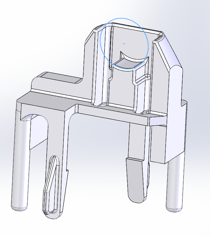

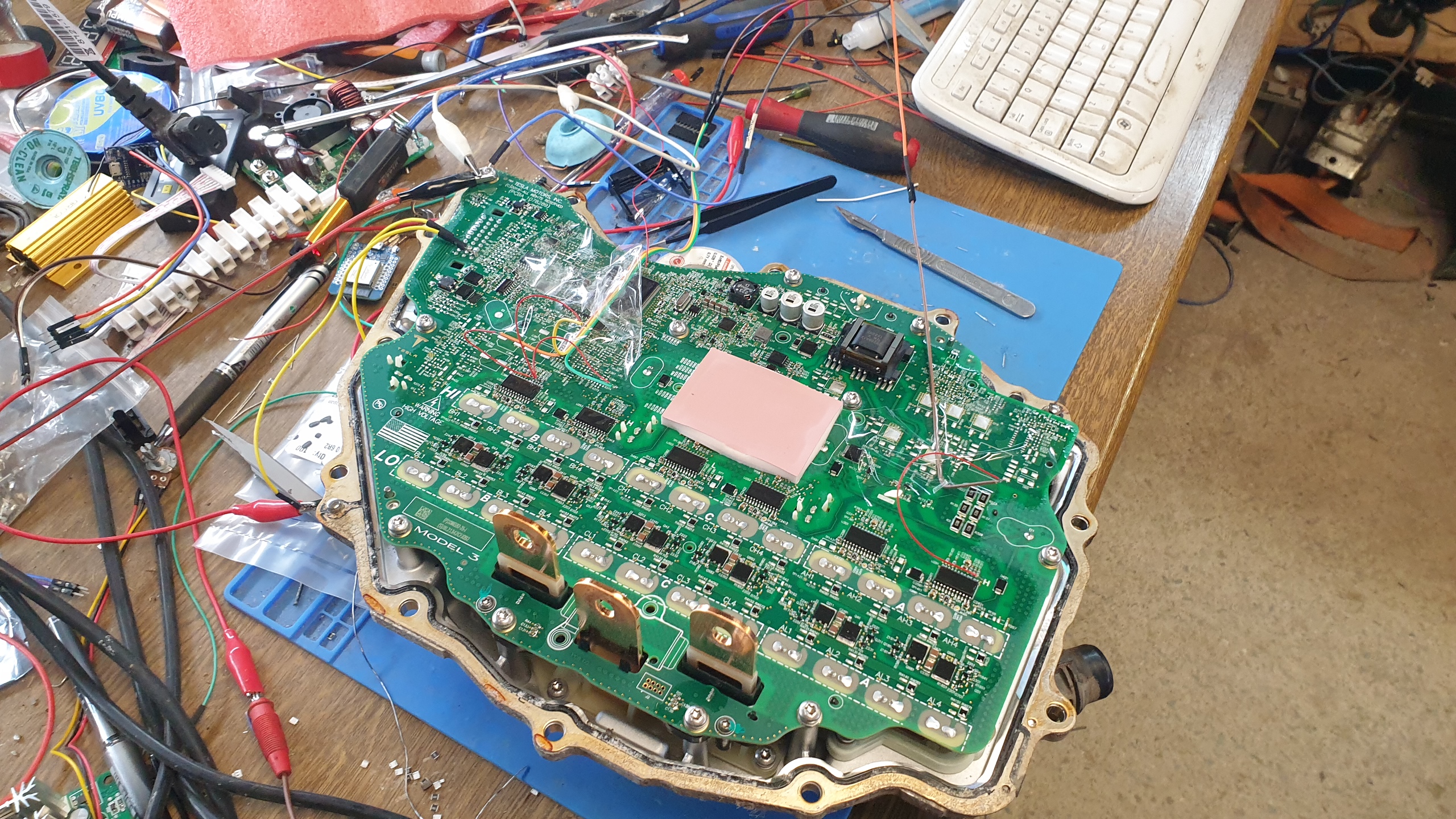

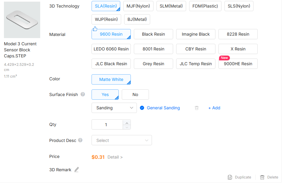

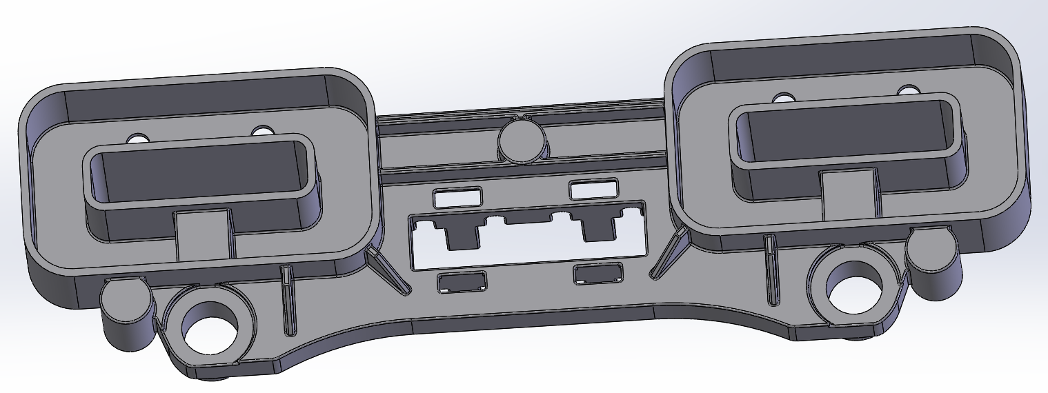

I drew up the current sensor.
https://github.com/jrbe/Tesla-Model-3-C ... nsor-Block
But I do not have the toroids in hand, they are inside the housing. So assumptions, hesitations, and changes I made:
- min wall thickness is 1mm to be able to get these printed by say JLC3DP.
- shortened the pins to 3mm tall, 5.25mm tall 2mm dia. pin is begging to be be broken easily, 3mm is more than enough
- spacers are drawn up to what Tesla used, may need to adjust slightly for what you can get
- no toroid in hand so made assumptions of the toroid area, if someone has one and can share accurate dimensions it would be appreciated
- stock is PBT glass reinforced I believe, gluing the lid on may be tricky if printing these in nylon
- stock design has nothing to hold the toroid lid on if the glue fails, may make sense to add some mechanical features to help hold the glue / snap the lid in place
- note this is a high voltage source that can inject hv to the board if something goes wrong with cracking or failing, do not print this in cheap or conductive plastic

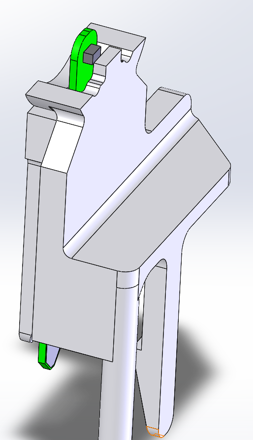

The temp sensors are next. I'm thinking of making the little towers then holding the sensor itself at the right height.

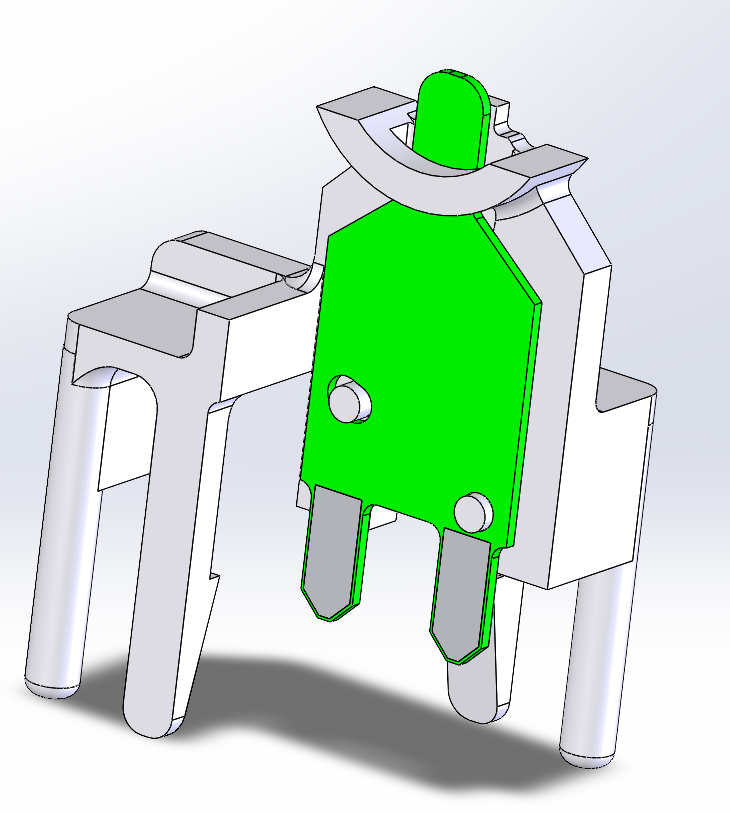

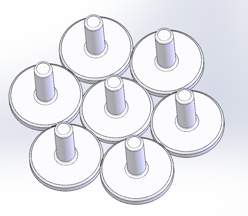

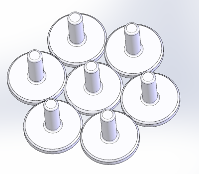

I drew up the temp sensor towers and the melt rivets.
Same spot, https://github.com/jrbe/Tesla-Model-3-C ... nsor-Block

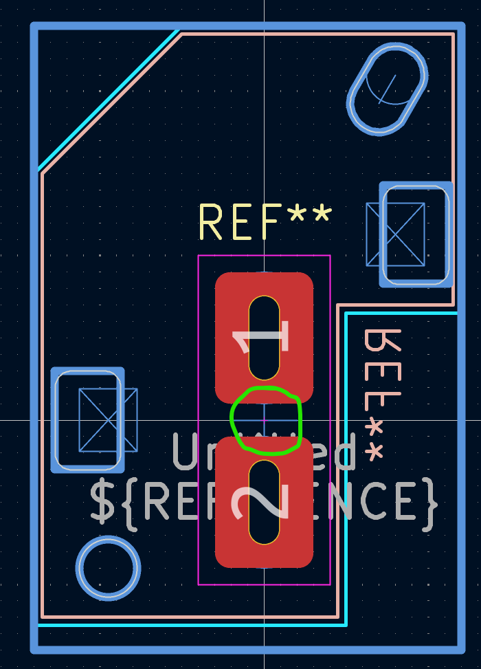

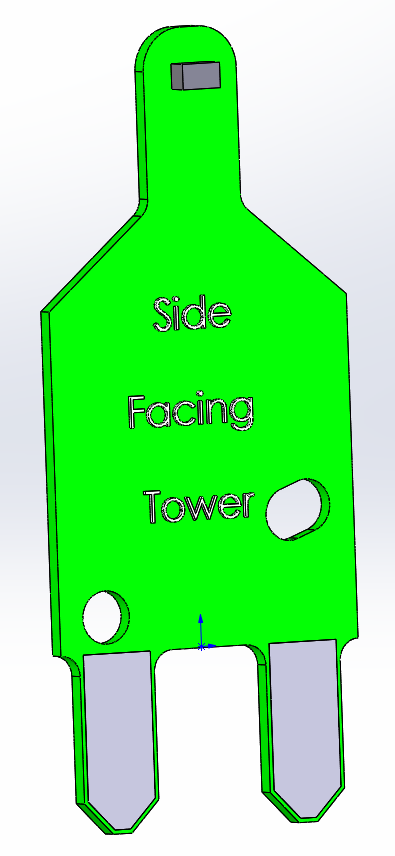

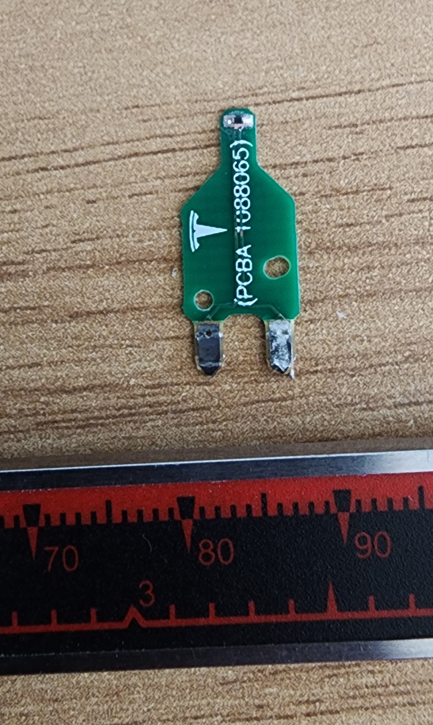

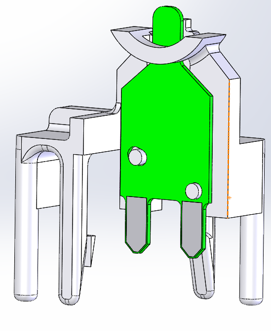

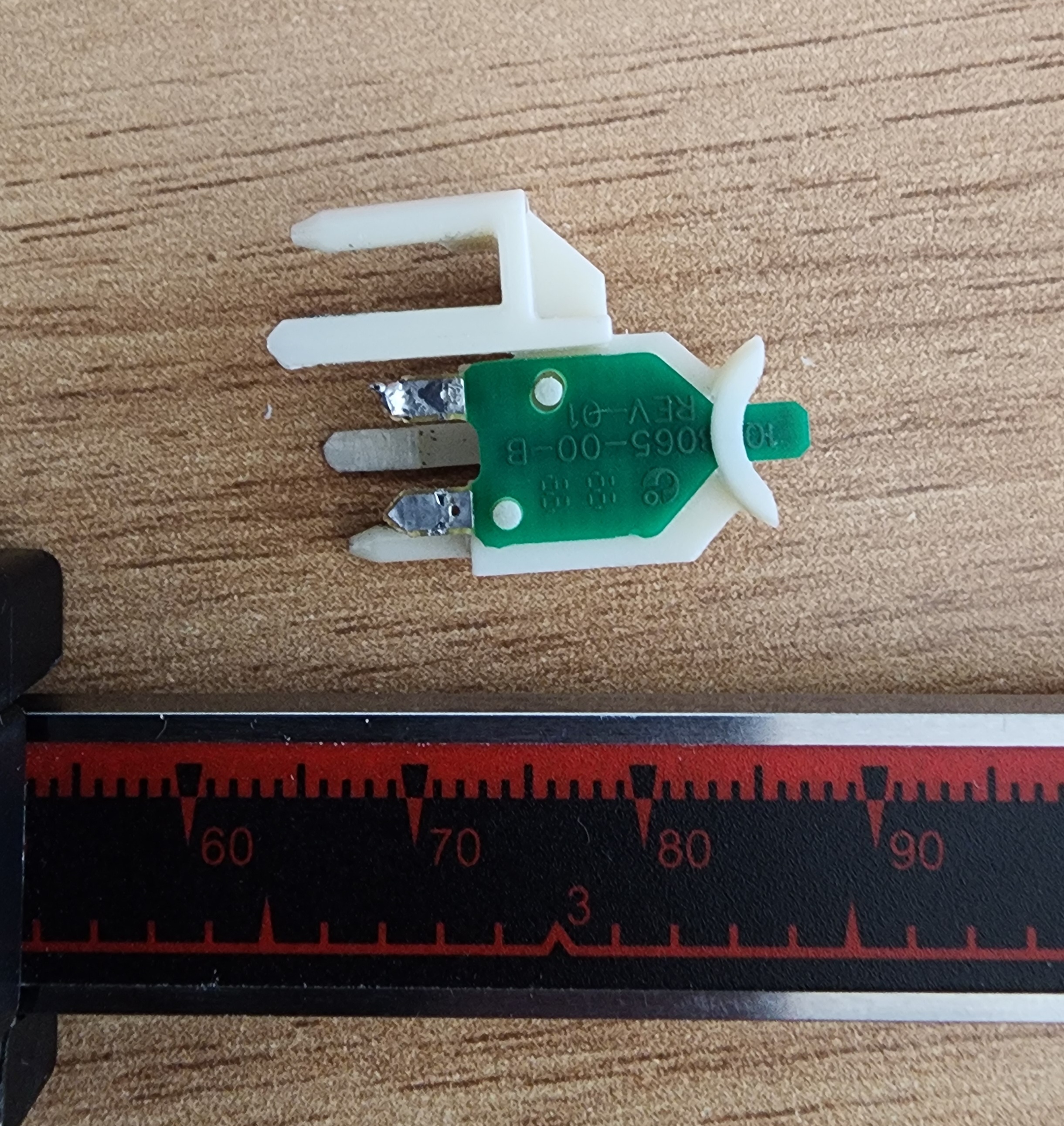

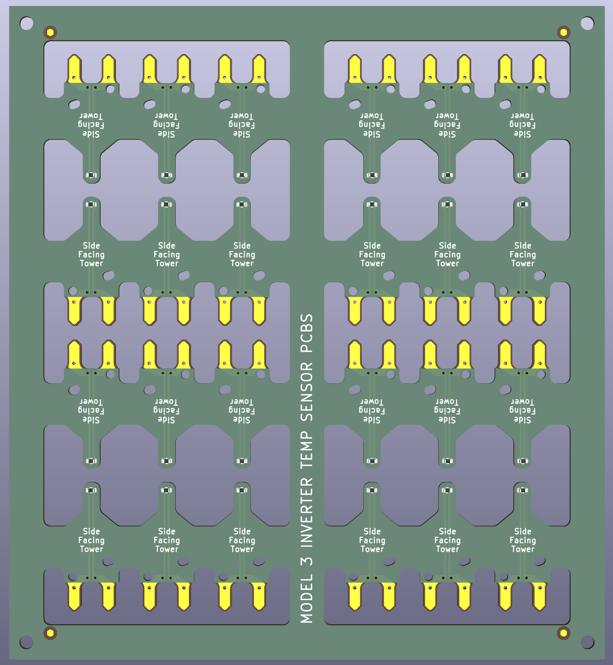

Temp sensor tower for pcb style is now drawn up along with a dxf of the pcb style temp sensor.
Note the temp sensor faces the tower face.
Both sides of the legs have copper plating on the pcb.
PCB is about .4mm wide.
All on GitHub here, https://github.com/jrbe/Tesla-Model-3-C ... nsor-Block

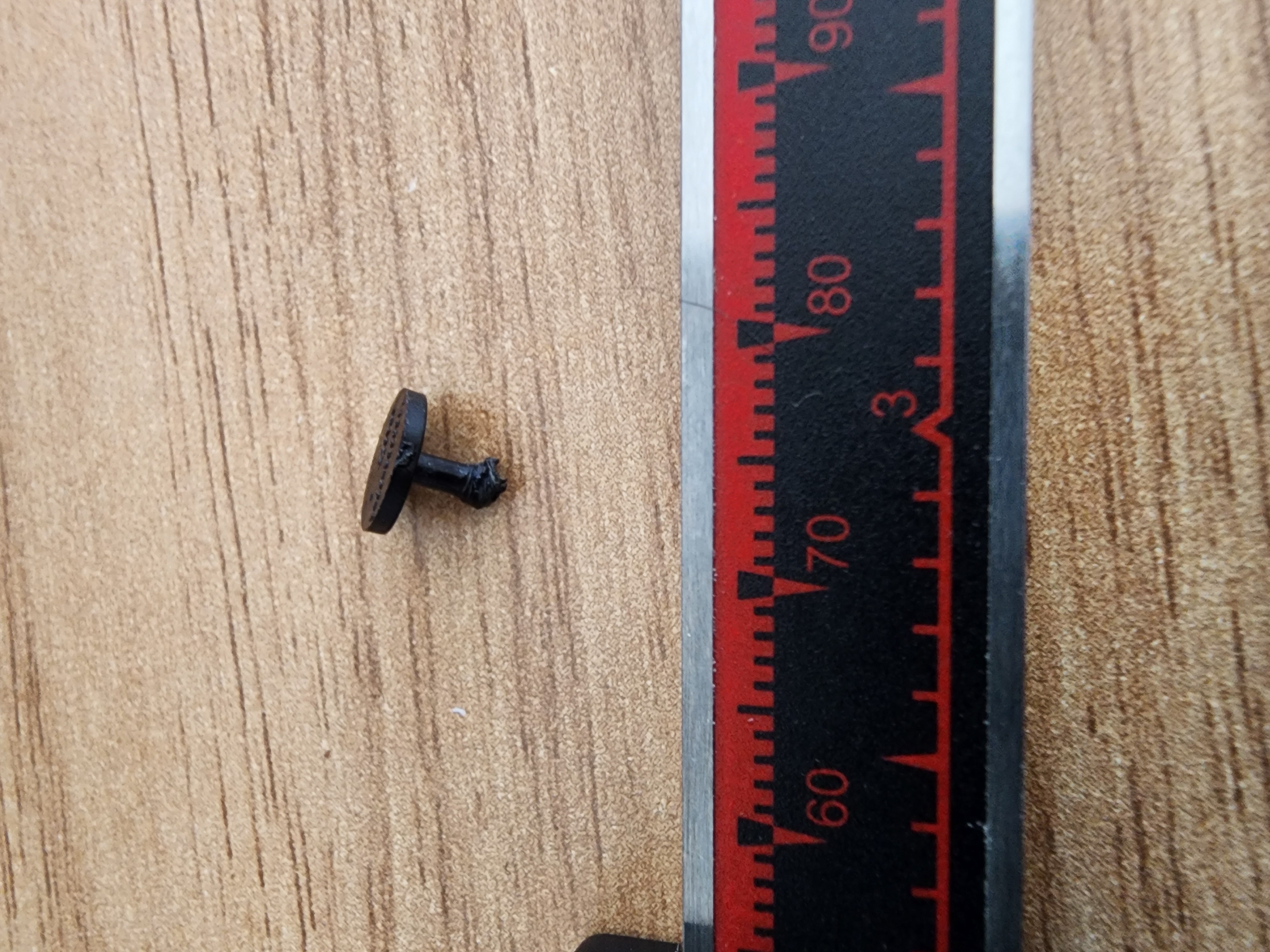

This is the melt rivet and some reference temp sensor images.

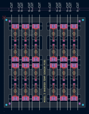

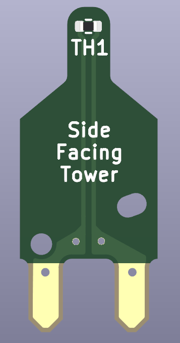

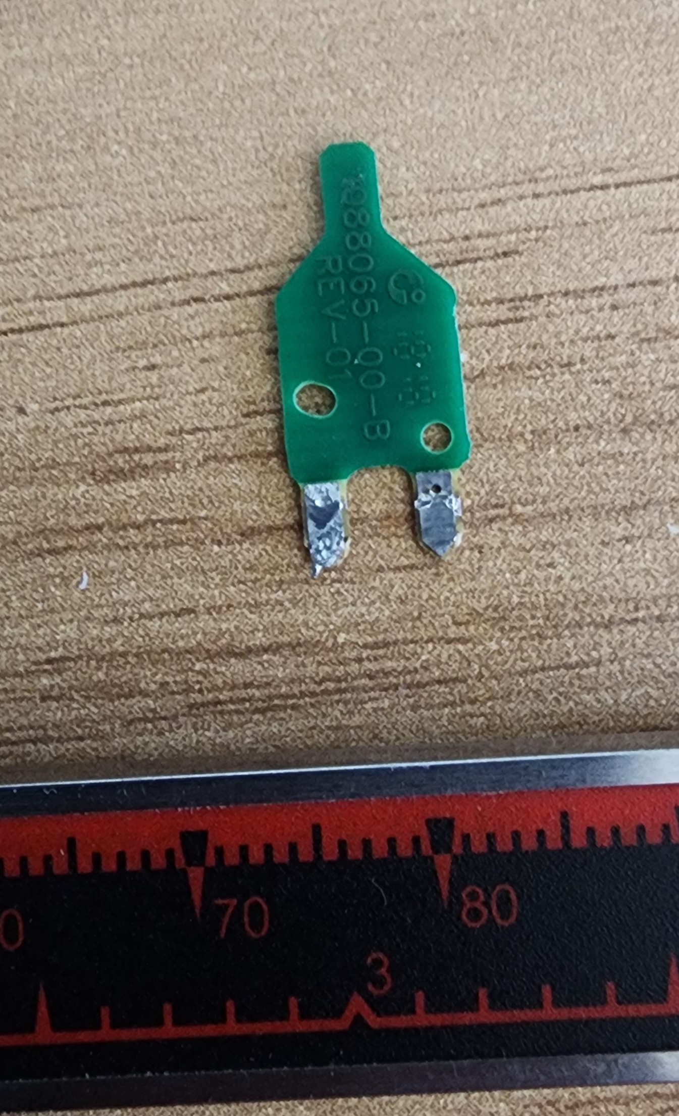

I dont mean to make more work for this, finding a NTC is proving to be problematic for the pc board version temp sensor. It looks to be a 0402 on the tesla temp sensor board but all I'm finding on Digikey are 0805s with the specs of NTC, 47KOHM, 4450K B25/100 from the B57164K0473J000 reference.
JLC seems to have nothing in stock in this range, can pre-order some in 0805 but not sure 0805 will fit the tower yet.. https://jlcpcb.com/parts/2nd/Sensors/NT ... spm=search
The thermistor pcb I pulled out seems to have cut a trace on removal. From that failure, I changed how tesla did this slightly on the copy I made, added a bit more copper at the connector tabs and an extra via for each.
I have the board drawn up, just stuck on sourcing the thermistor for it.
My plan was to panelize 3 with vcuts between them.
I did some admittedly poor testing as I have the meter probes touching the thermistor and had a temp sensor in the same area. I gave it about 2 minutes for the probe tips to normalize to the hot air for each and got the following temps / resistances:
53.7k @ 19.78°C
13K @ 61.11°C
11.7k @ 69.44°C
I'll work on fixing the trace with some solder and try to get better reads. Looking for info on what you guys got for values to compare and look at alternatives / options.

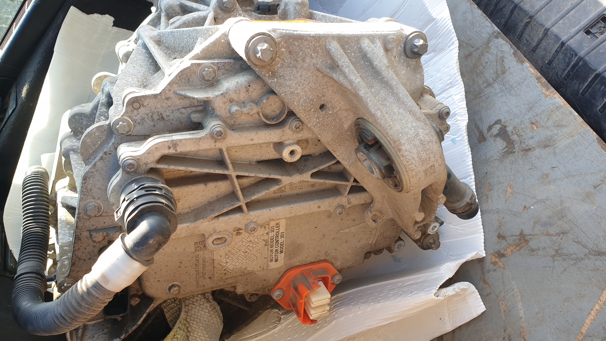

So seems I got lucky with the highland M3 front inverter from evbreakers. Looks to be the "newer" rev pcb so with luck will have gate spi and lin info for us :)
Posts: 4000
Been thanked: 1115 times

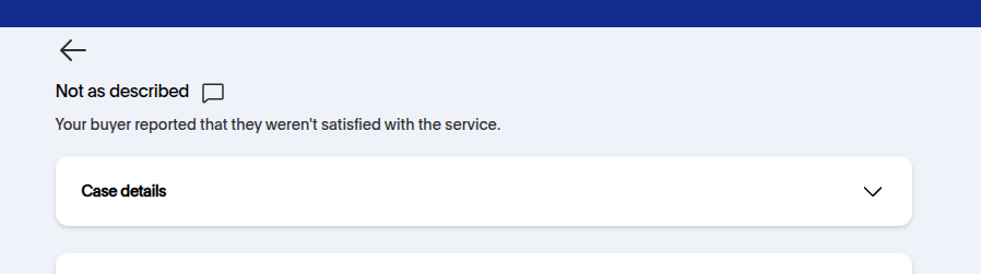

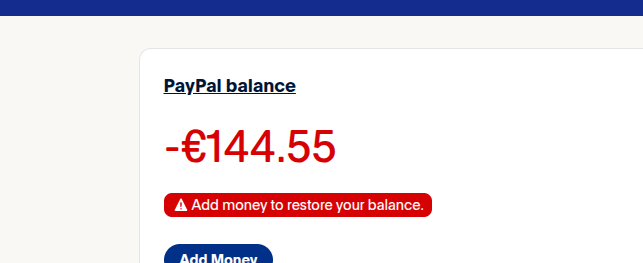

Sitting here wiring up to the gate driver spi of the M3 FDU that I dont need but bought at evbreakers to help the project and boom. I knew it wouldn't take long. Thankfully I neither sold many nor at a higher price. Have asked paypal to issue a refund. Of course the person never tried to contact me or work anything out.
Edit : all refunded.

That's disgusting behaviour. The levels of toxic entitlement and outright harassment around FOSS/HW seem to be going off the scale at the moment.

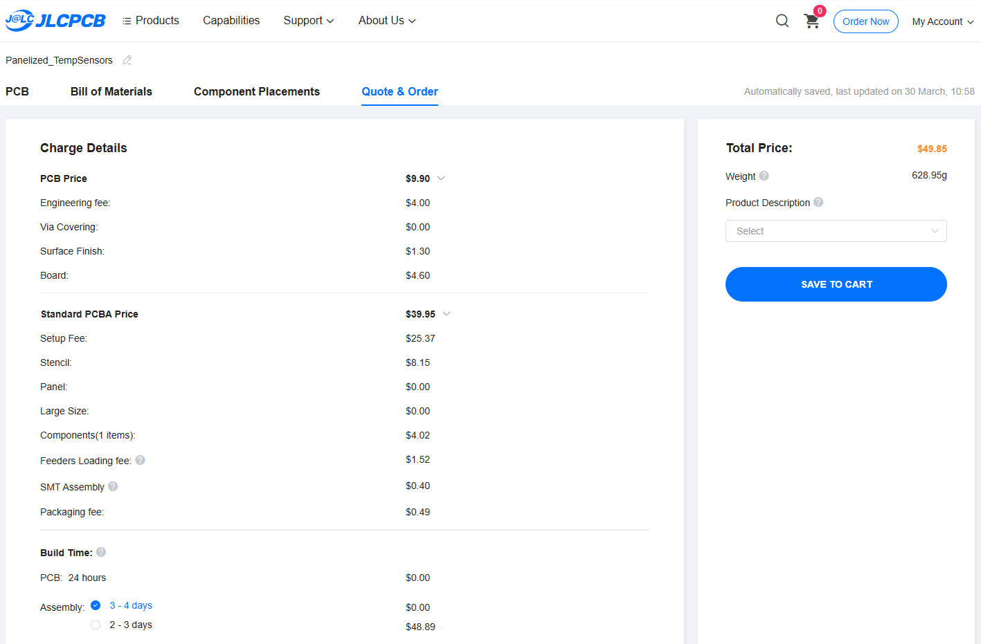

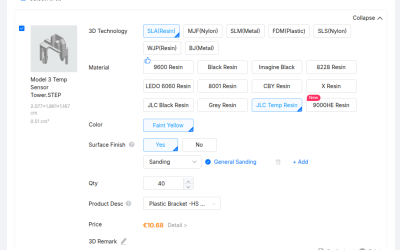

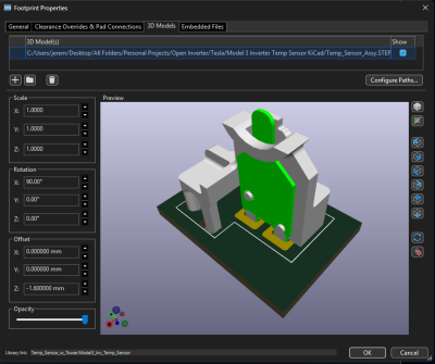

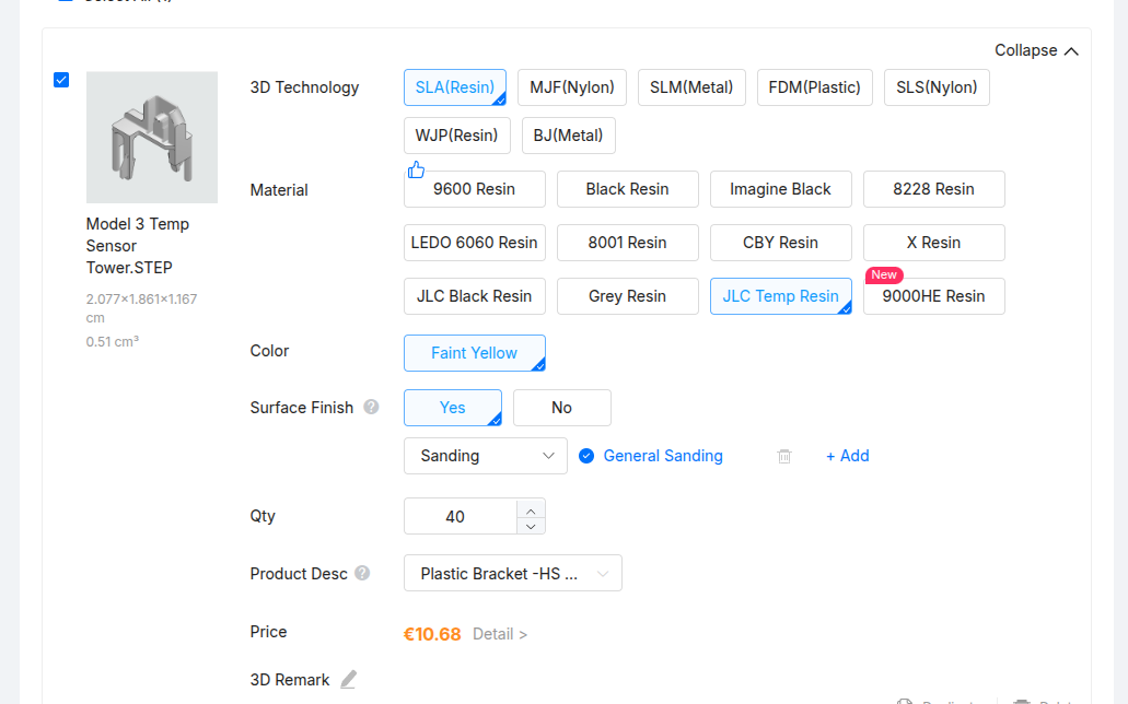

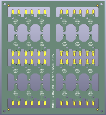

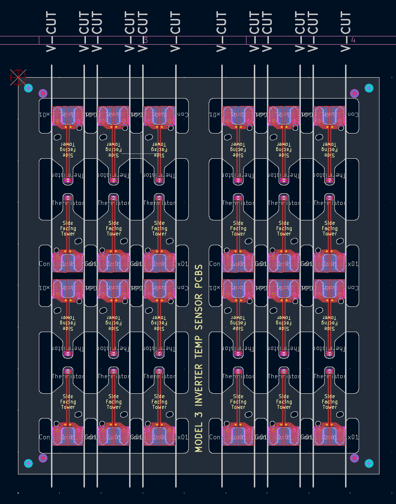

I panelized the temp sensors,
12 v-cuts to pop them apart
5 panelized pcbs at .6mm thick is under $10 USD and under $50 assembled, this is for 40 inverters worth (120 individual) temp sensor pcbs.
for some reason JLC jumps the price up 6x if you drop to .4mm. Will have to look at modding Damien's boards to fit these as a .6mm pcb.
Same place, https://github.com/jrbe/Tesla-Model-3-C ... nsor-Block
Should be everything to do this as Tesla did besides verifying the temp sensor I dropped in these works.

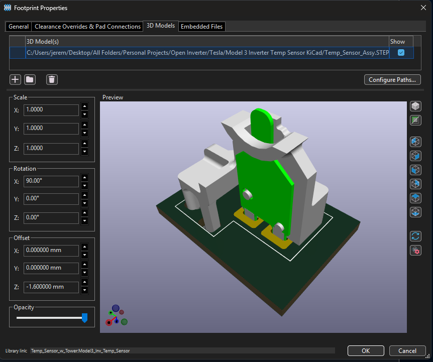

I'm going to 3D scan the Model 3 inverter board and make KiCAD temp sensor footprints for the towers / pcb style temp senosrs.
Posts: 4000
That is a crazy amount of work. Thank you. Very much in the spirit of an opensource project :)

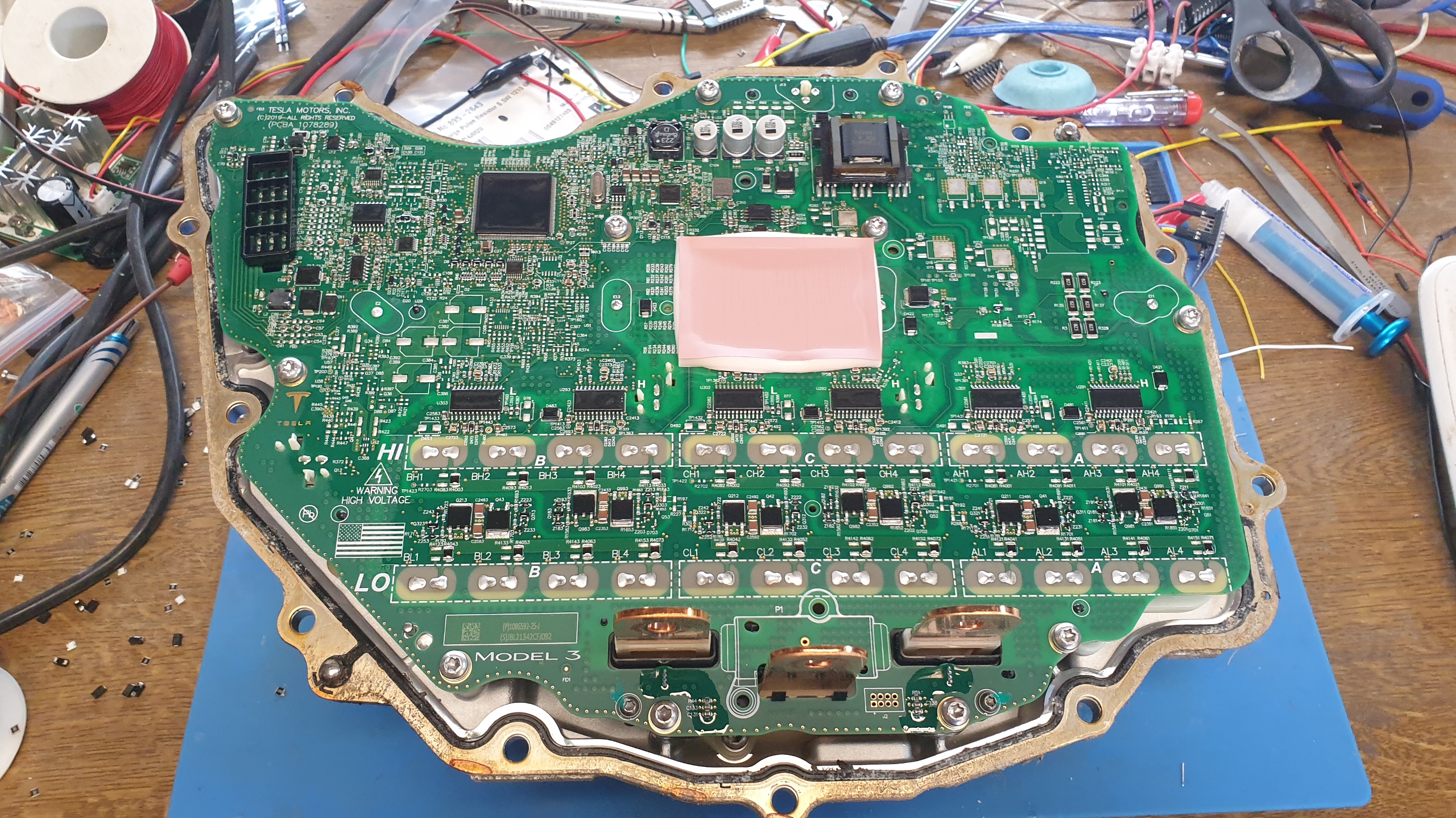

Board scan here : https://grabcad.com/library/tesla-model ... rter-pcb-1
jrbe
Posts: 766
Has thanked: 360 times
Been thanked: 249 times
Post by jrbe »
Jack Bauer wrote: Mon Mar 30, 2026 7:44 pm That is a crazy amount of work. Thank you. Very much in the spirit of an opensource project :)
Happy to help, thanks for all of your efforts in this Damien. The one piece for you to think about is the thermistor, what I have is close-ish and is a placeholder for now.
Thanks for the scan!
Panelization was with KiKit, https://github.com/yaqwsx/KiKit It takes some time learning to use it but then it panelizes the boards very quickly.

I made a symbol, footprint, and a step file of the pcb tower assembly for KiCAD 10
https://github.com/jrbe/Tesla-Model-3-C ... ibrary.zip
Damien, Dave, and anyone else helping with the PCB side of things, this should be able to swap the place of the through hole thermistor and should also work with the other version of the 3D printed towers for the through hole temp sensor.
The center point of the assembly is the center of the 2 slotted through holes to make it easy to use / reference.
Besides finding the right 0402 thermistor / one you guys are happy with, both this temp sensor PCB and the 3D printed tower are ready to order a test batch.
Melt rivets and the through hole temp sensor towers are good to test too. Melt rivets are 7 all stuck together in the 6 around the outside, one in the middle. They're small and easy to lose, should easily separate with cutters.
If / when someone gets toroid dimensions or wants to mail me one (PM me) to reverse engineer, I'll update the current sensor block to hold them properly, mod the caps and housing with snaps to help hold it in place.
Posts: 4000
I've ordered the temp sensor boards and holders from JLC. thanks again to jrbe. I'll uprev to V3.3 and see how we go.
davefiddes
Posts: 416
Has thanked: 206 times
Been thanked: 256 times
Post by davefiddes »
Have you been able to identify an SMD NTC with the same curve as the EPCOS B57164K0473J000?
Posts: 4000
Not yet. Will investigate.
