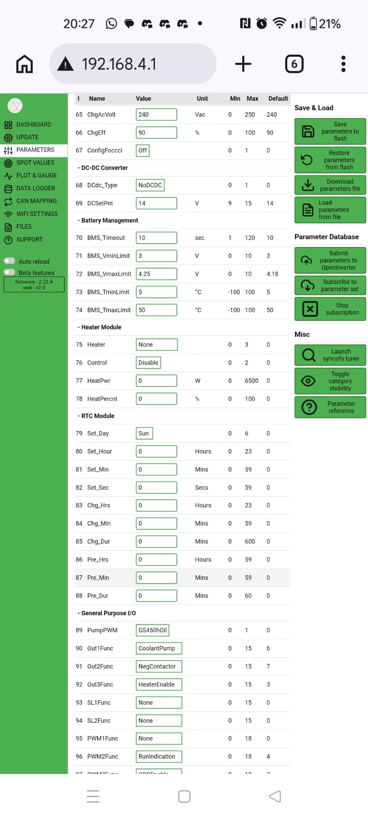

Hi all, I did try and find my specific issue using the search function. I got similar results but not quite what I am experiencing.

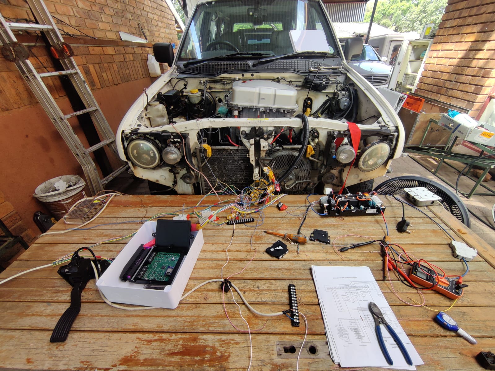

Ive got the openinverter board wired up to my gen 1 leaf stack. Throttle calibrated correctly, able to get it into RUN and DRIVE states easily. No matter what I do I cannot seem to get the motor to spin, no noise from motor or inverter. Torque value goes up but current draw stays 0. Ive got 320vdc on the HV side, doing precharge and contactors manually. Ive set the udcsw voltages etc so that it will accept the 320vdc but no luck and no errors.

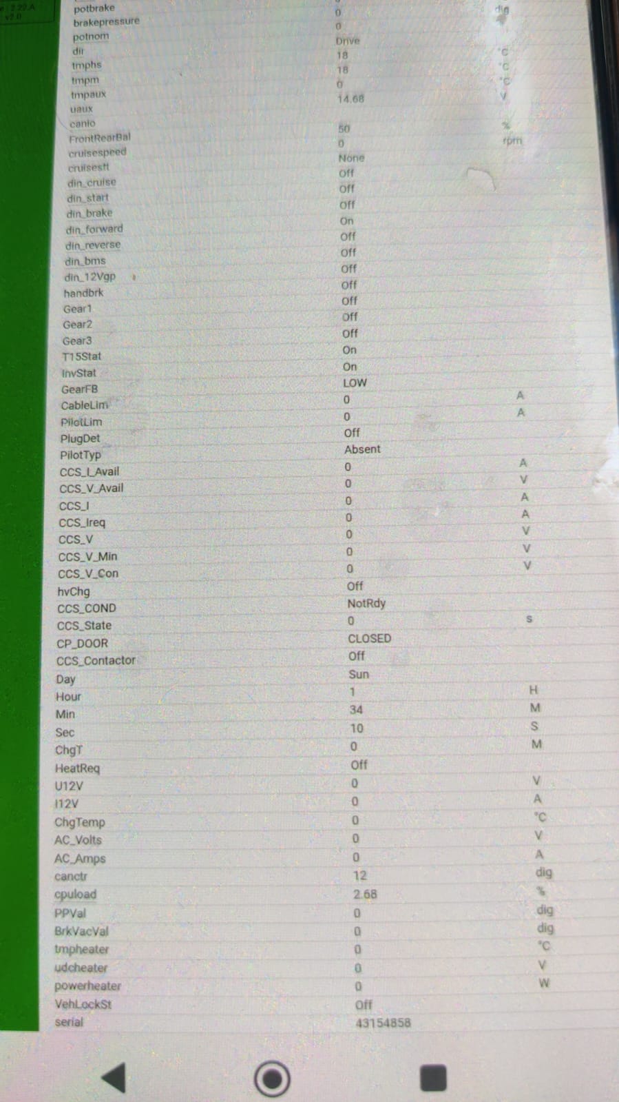

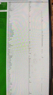

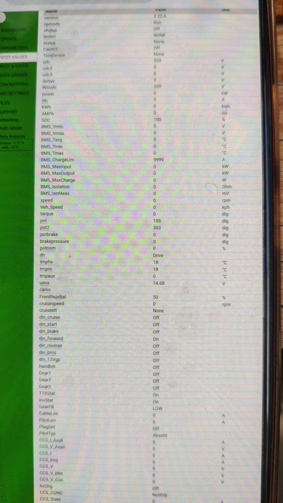

post your params and spotvalues

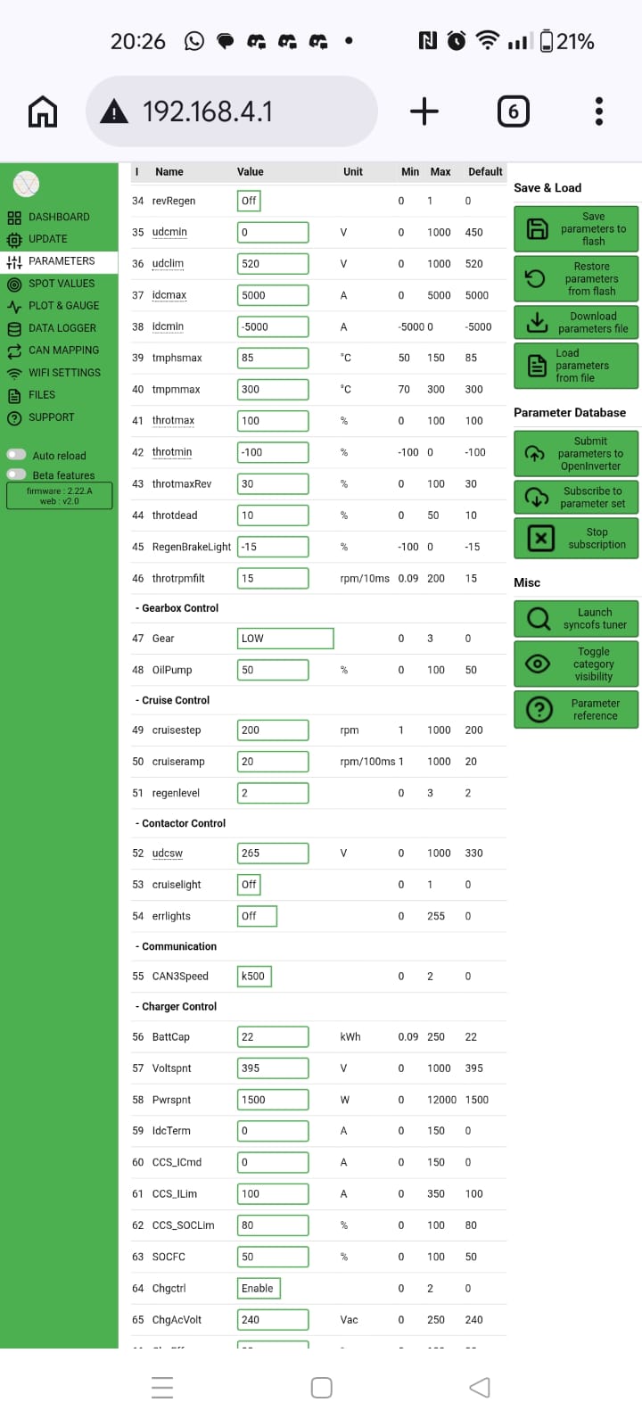

Post by Rcoetzee »
here they are:
Posts: 2962
Has thanked: 328 times
Been thanked: 847 times
Re: EM57 test run with bridge rectifier
Okay you are running a zombieverter?

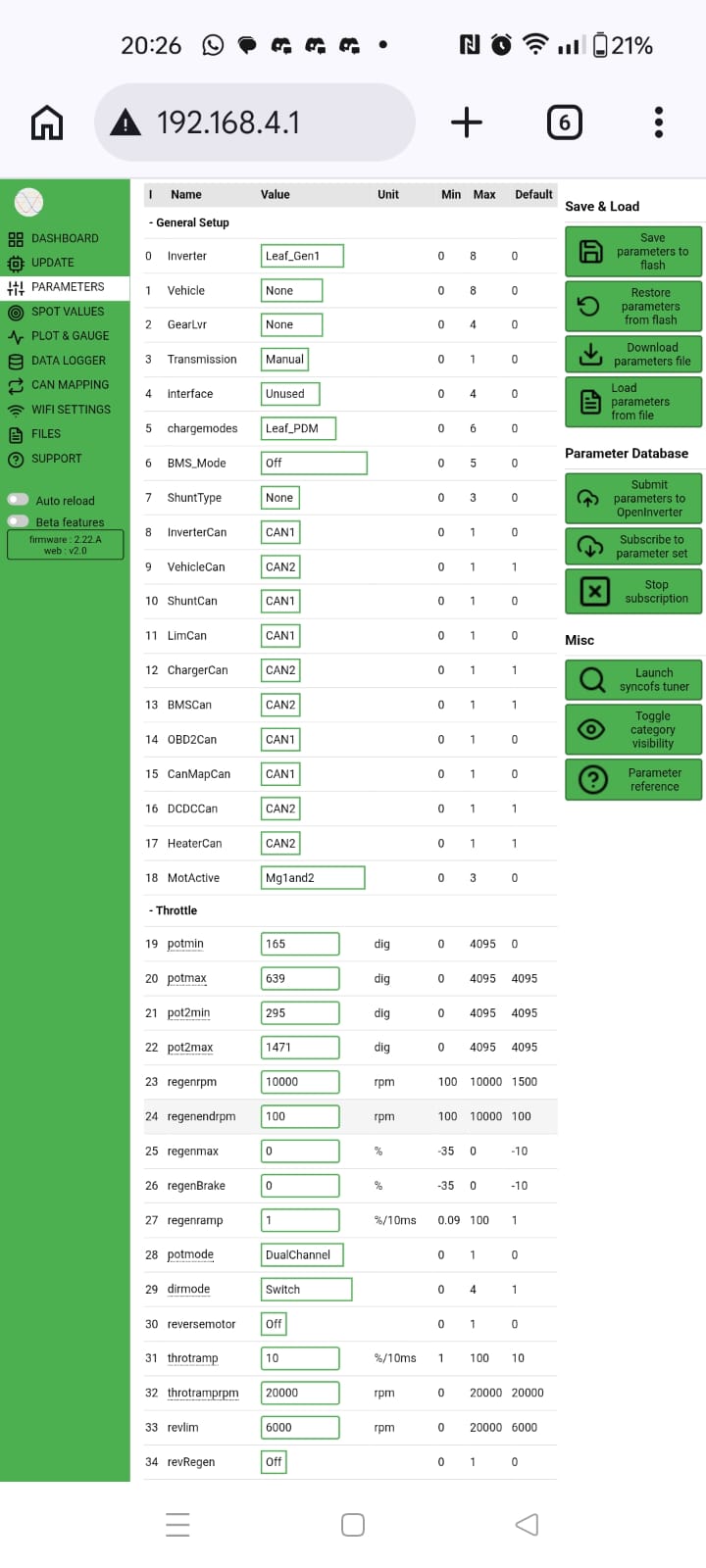

Parameters are missing please download and post.
Did you calibrate your throttle and plot pot1 and potnom to see if they track?

What diagrams did you follow to wire up the wires to the leaf inverter and zombie? Please post pictures of your setup.

Throttle has been calibrated, potnom works as it should, its a zombieverter yes. see diagram and pics
you have inverter on can 1 but charger on can 2 in your prams.
which can bus did you wire the stack to?

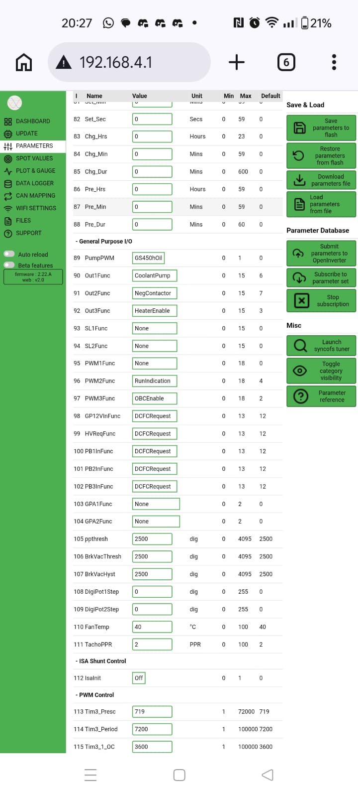

also reset your general purpose i/o. remove all the DCFC stuff.
is your negative contactor wired up to outfun2?
when you pull t15 high dose precharge function work and goes into run mode?

When T15 goes on it immediately goes into run mode. Negative contactor wired to pin 31 on zombieverter

what is the udc value when in run mode?

320-328udc

So yes, charger and inverter were connected to CAN1 but with the auto refresh and somewhat buggy interface on the cellphone it looked like charger param was set to CAN1 but it was in fact not.
I'm not sure why charger has to be on CaN1 in params for it to work? I don't fully understand this, is the shunt in the PDU/PDM? I've got the comm connection of PDU unplugg and things still work.

you can have them on can 1 or can2, but if you have the pdm and inverter in the same bus, then you need to have them selected In the interface for that bus.
the inverter measures the voltage, so you can remove the pdm and it will still run precharge.

This seems to be a bug in the Zombieverter software then. Even with PDU communication connector unplugged my setup WILL NOT run if I select CAN2 under charger parameters. The moment I do that the motor won't spin, still able to get temps and Comms from inverter but the motor doesn't respond to throttle inputs at all.
In the end it was a software bug that made me feel really stupid 🤣.
I don't see where my shunt question was answered, I probably just missed it. Luckily it's not relevant at this point.
But yes, V2.22a on Zombieverter has a bug that will cost someone lots of time in the future. I hope they find this post.
