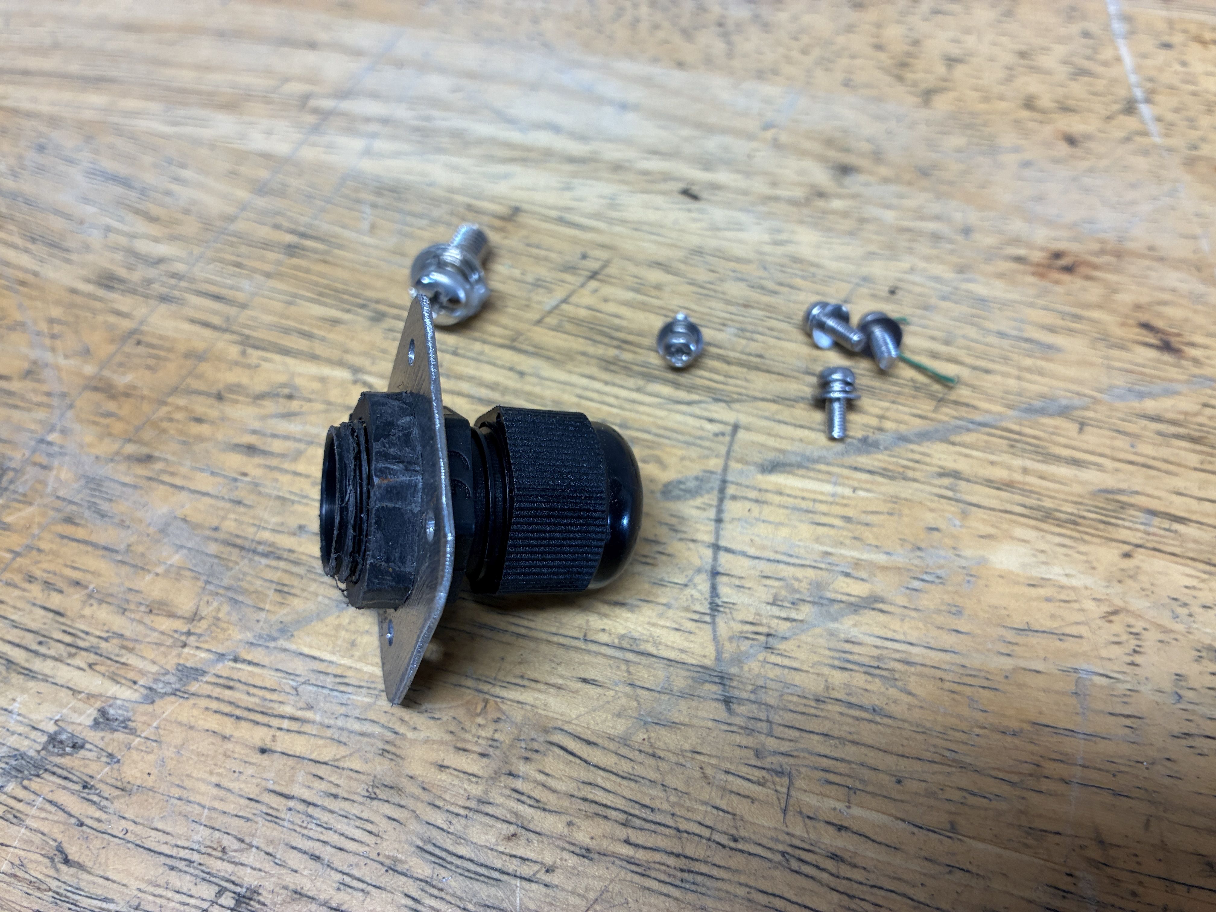

so let's start with this most complicated single wire 12 volt connector on planet earth

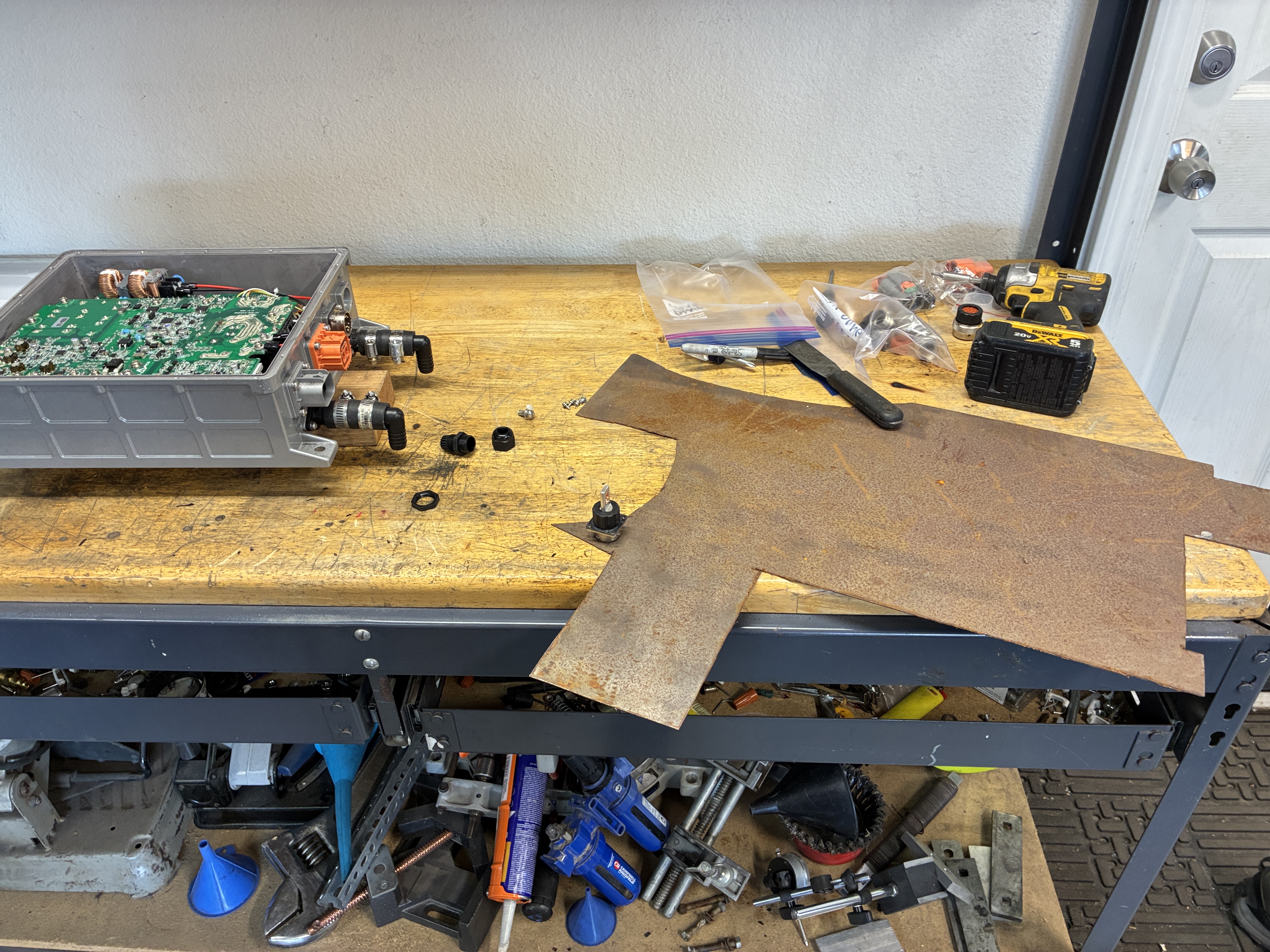

let's take a peak inside

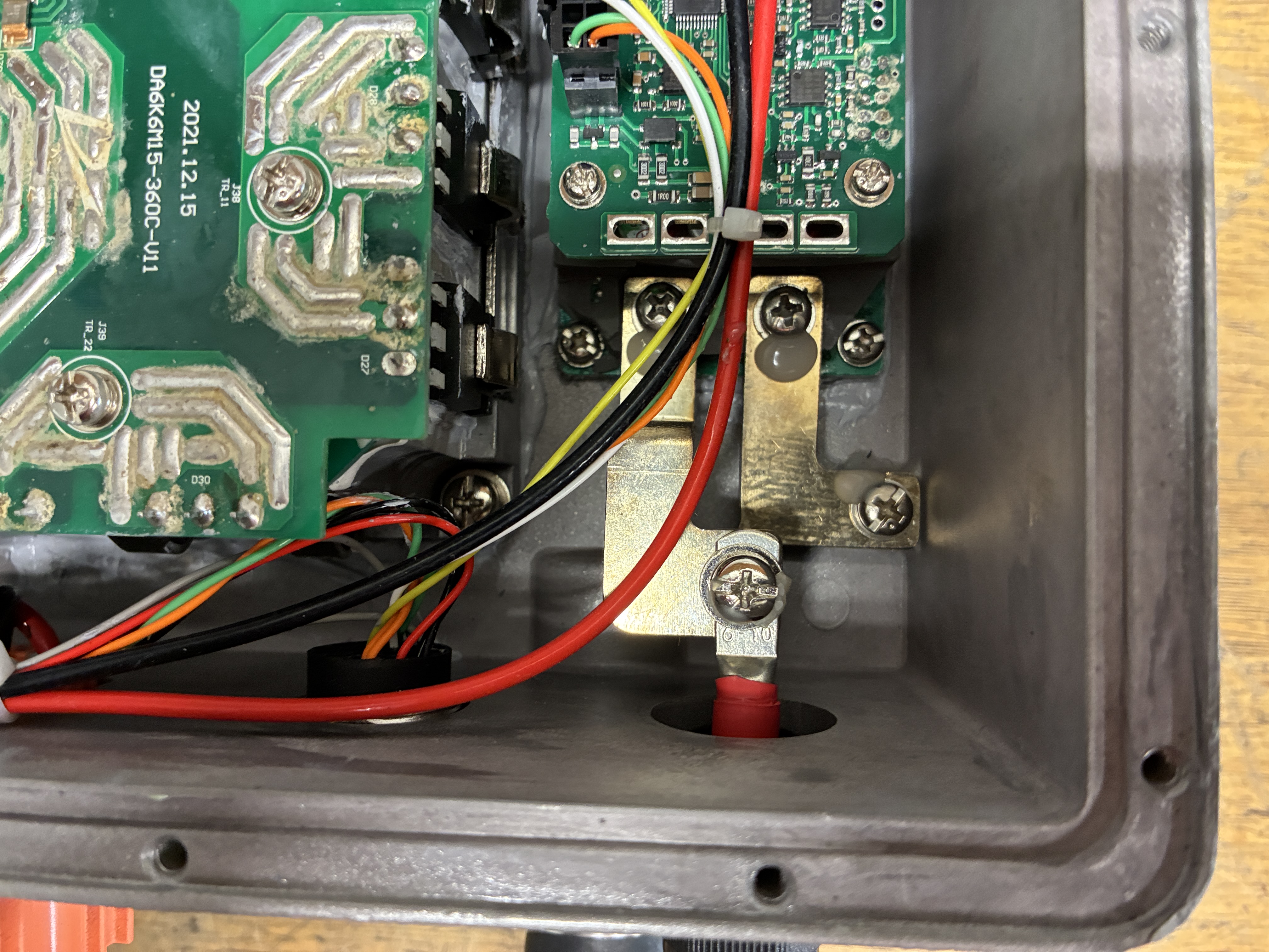

I bet it's hold on with just one bolt

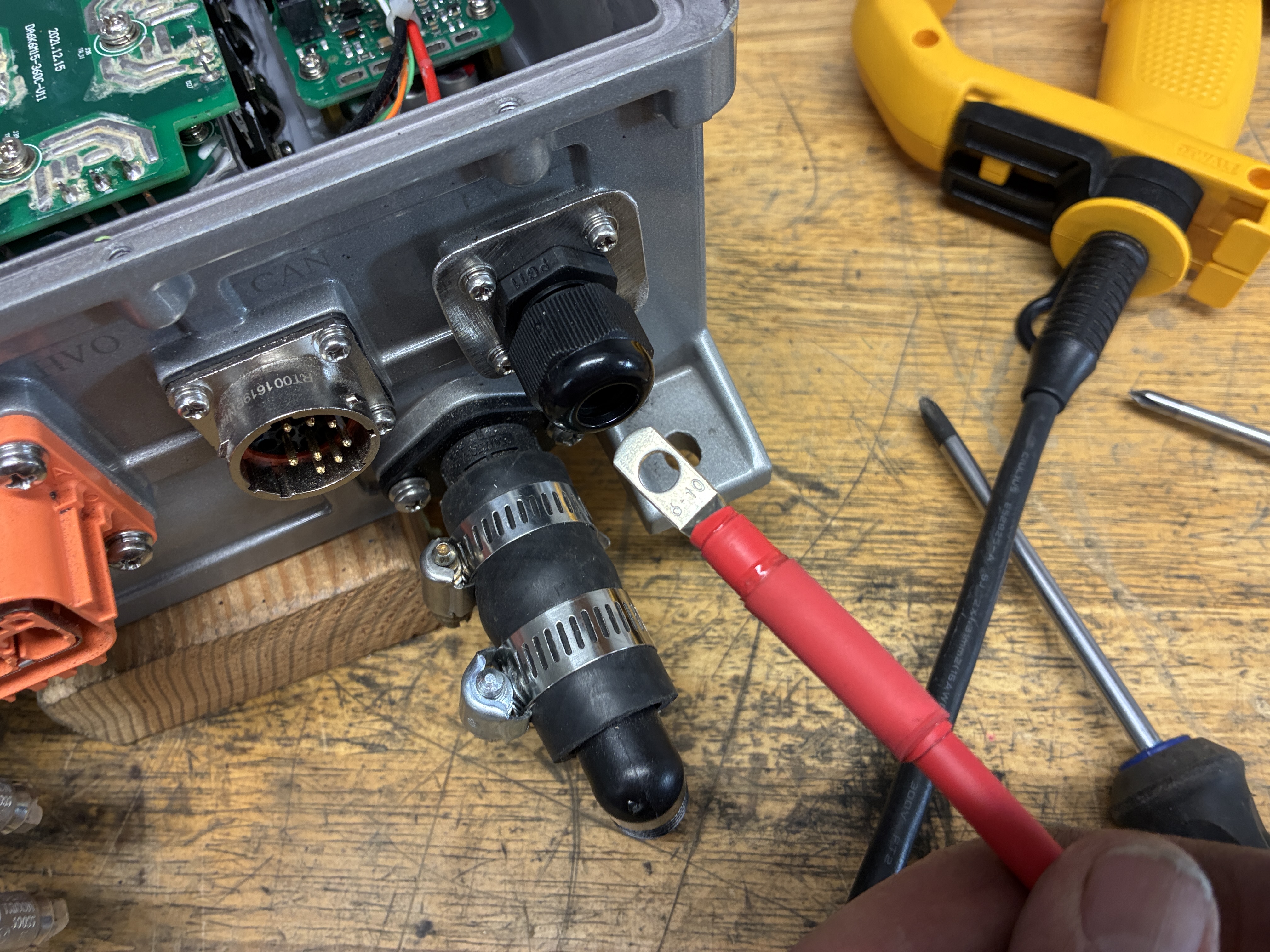

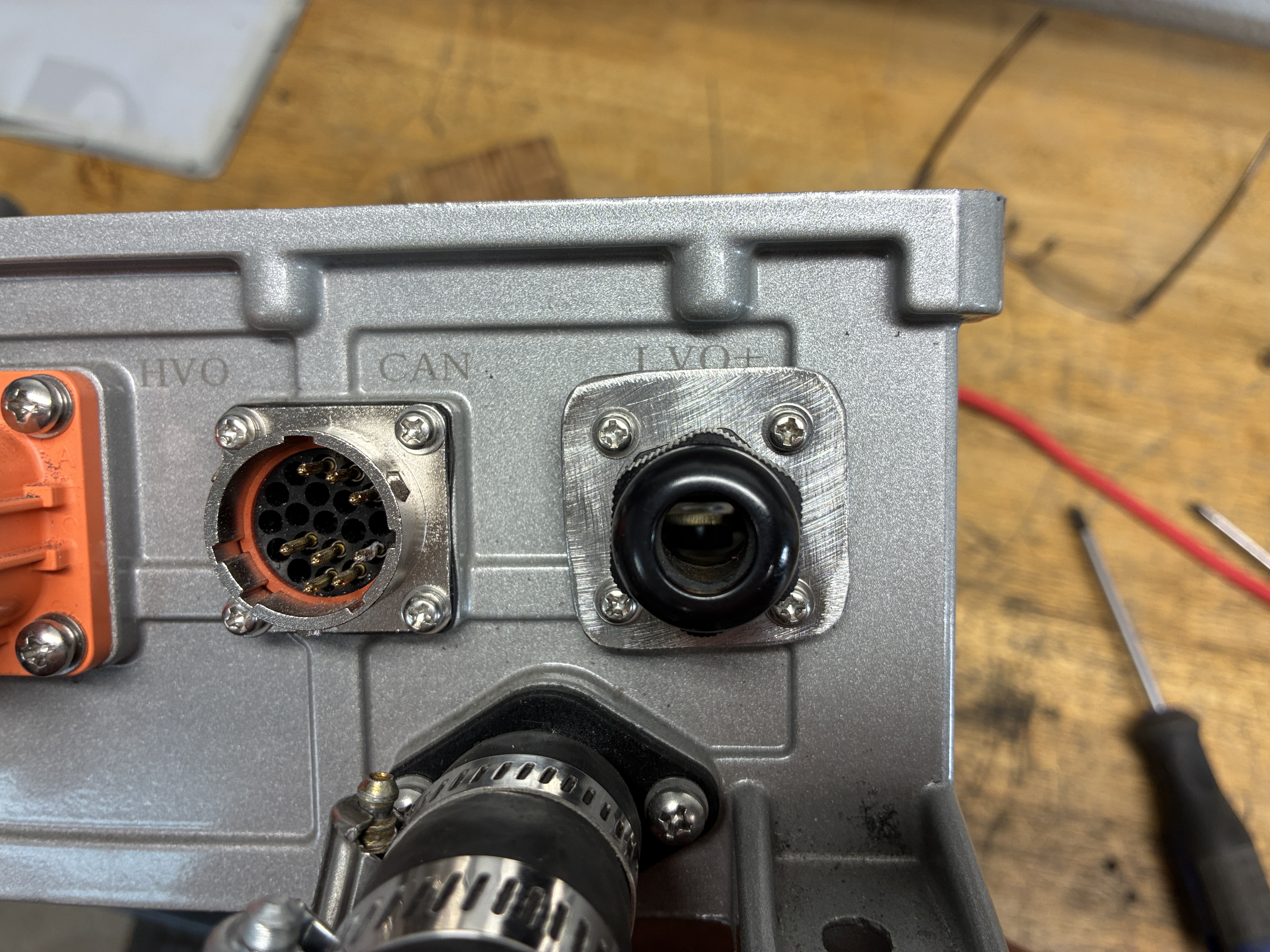

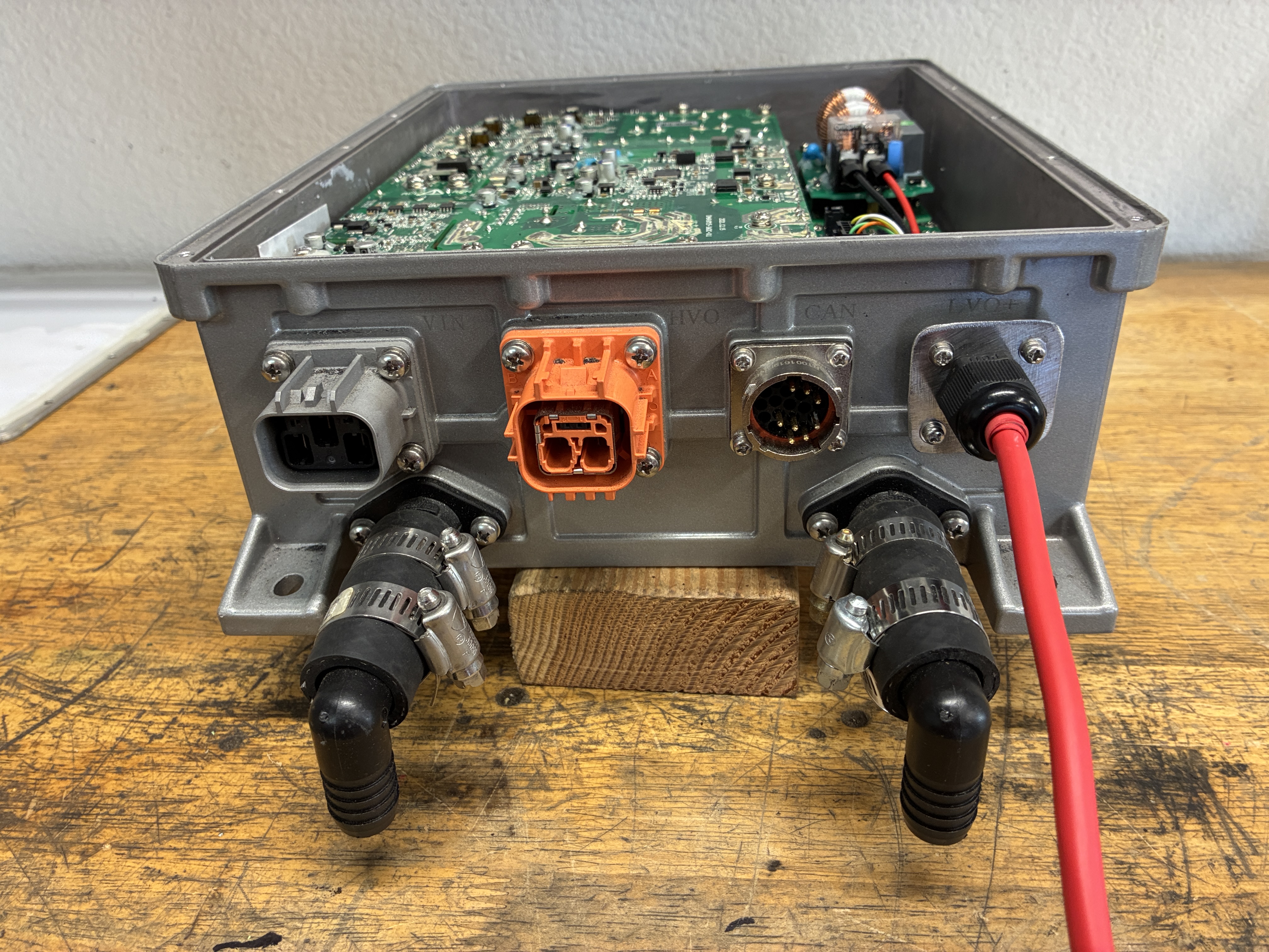

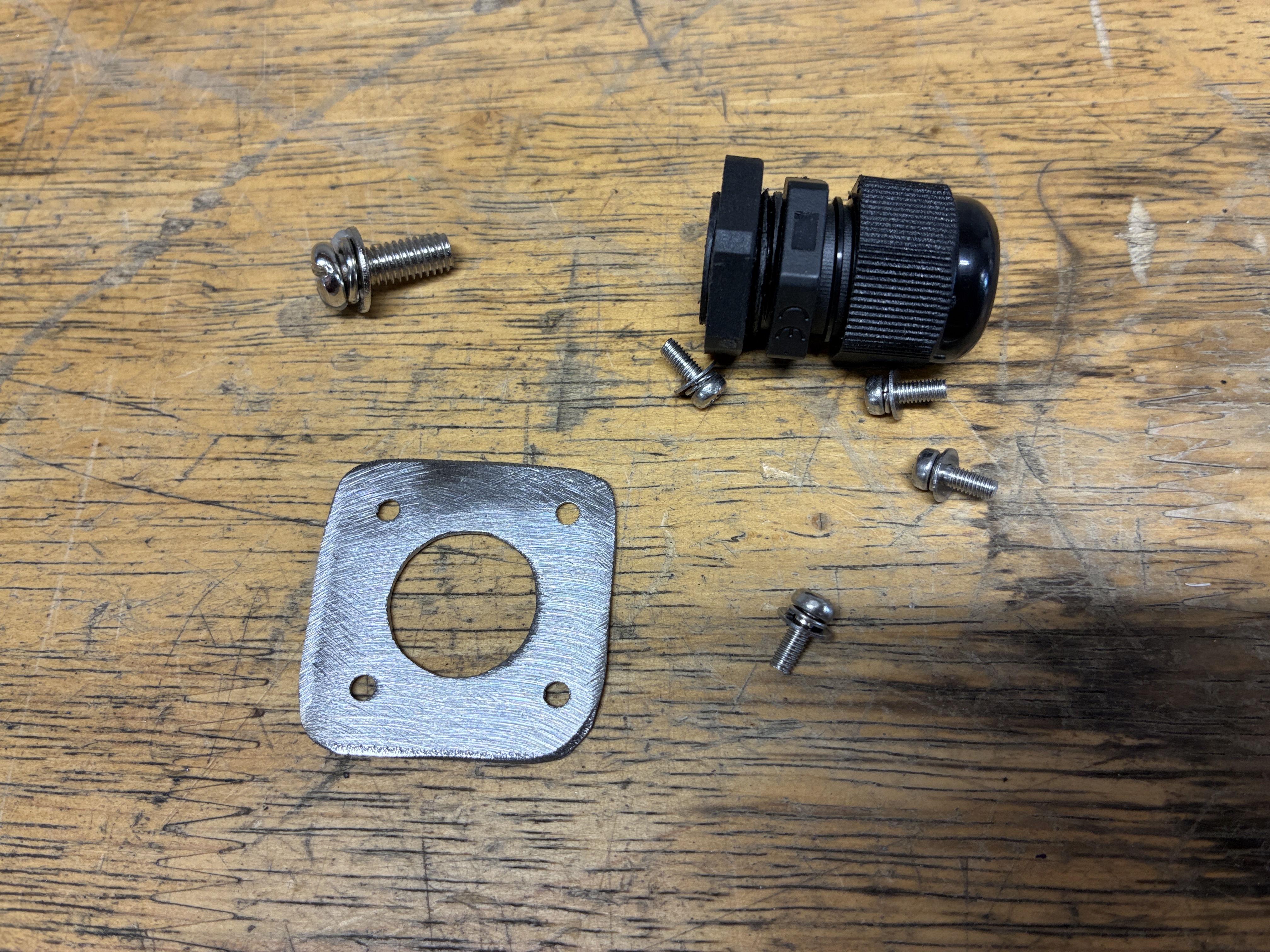

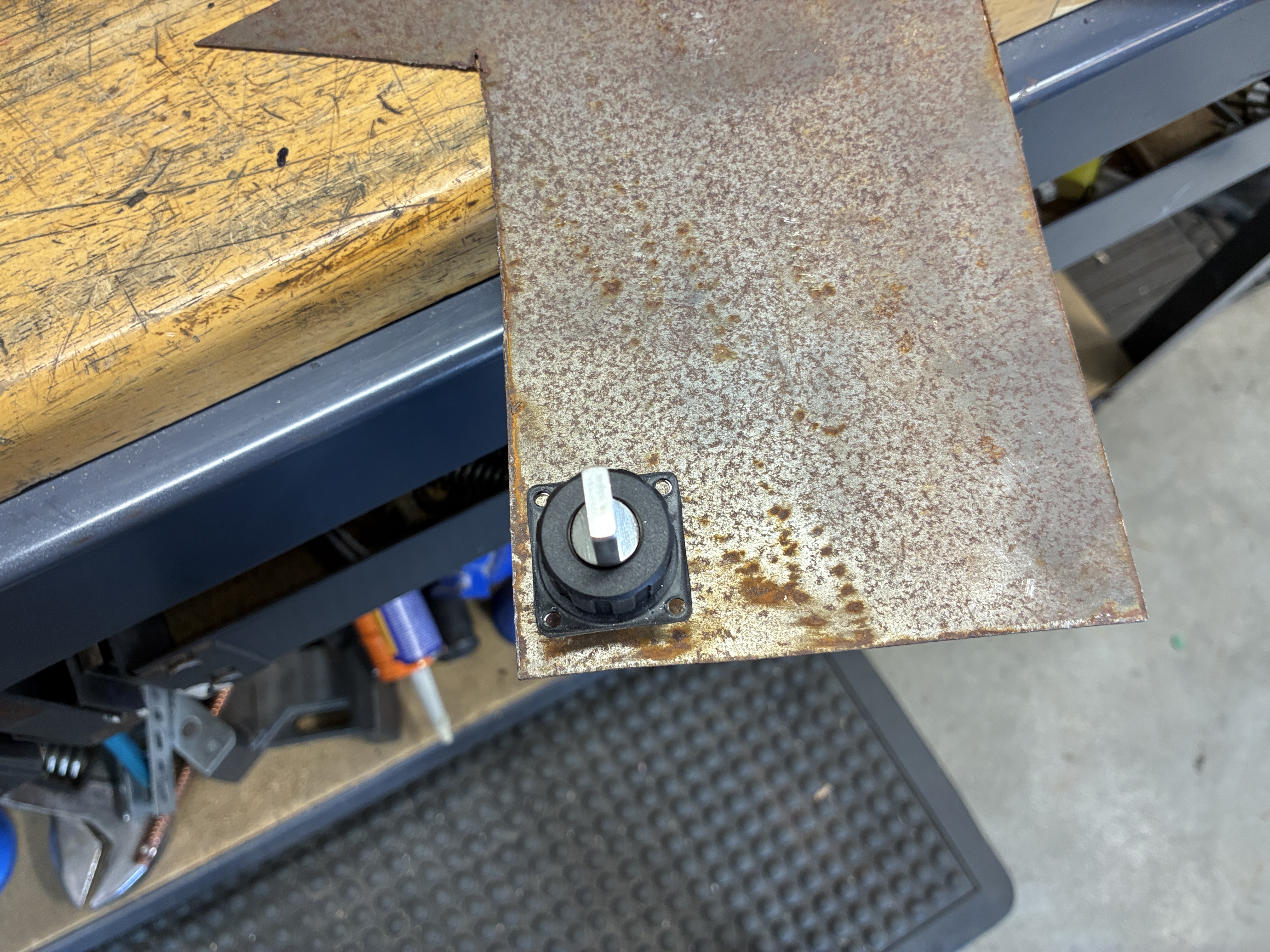

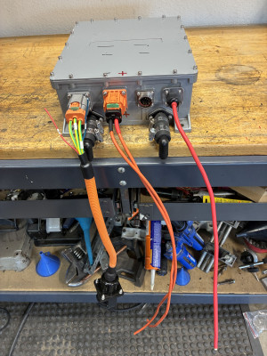

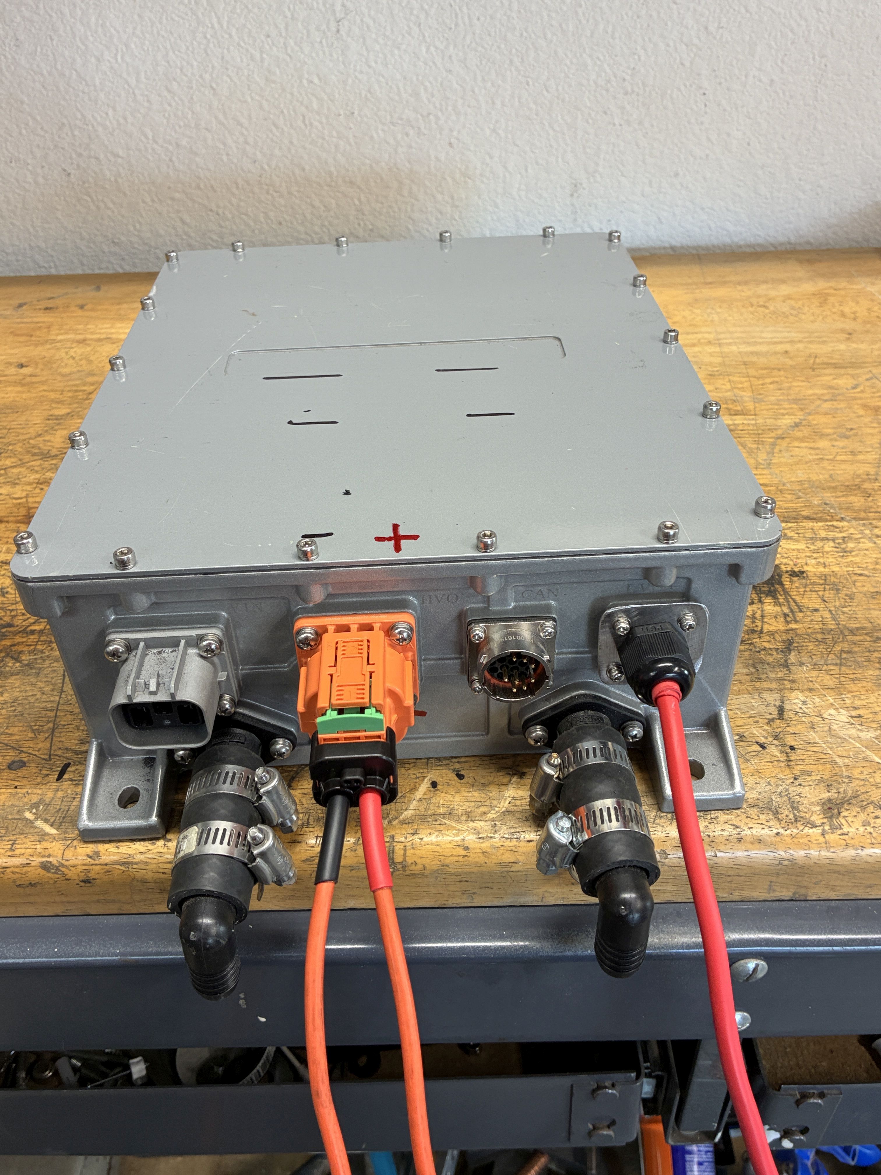

sorry folks I could not get myself to use that monstrosity so I made a simple hardwired connection

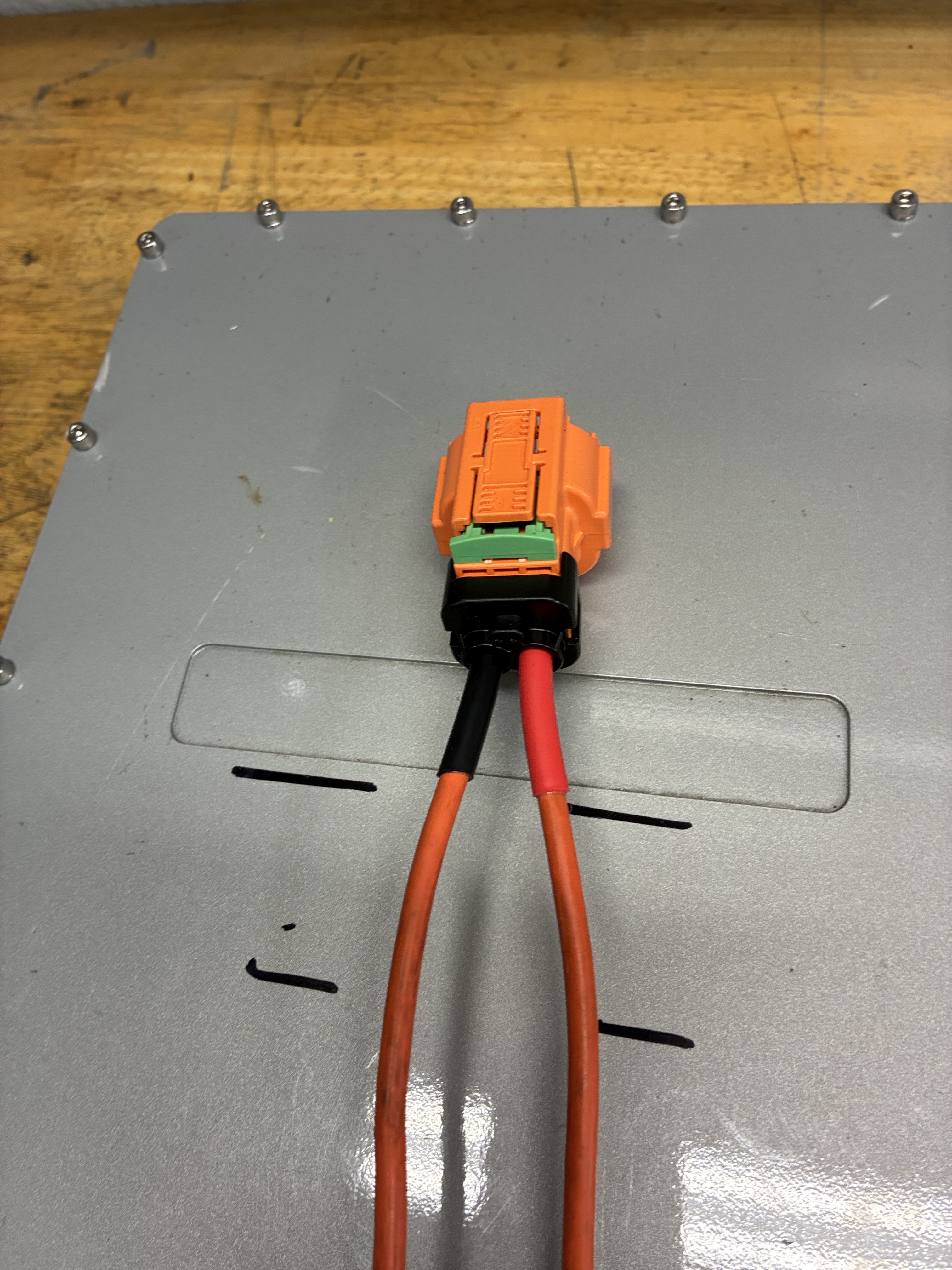

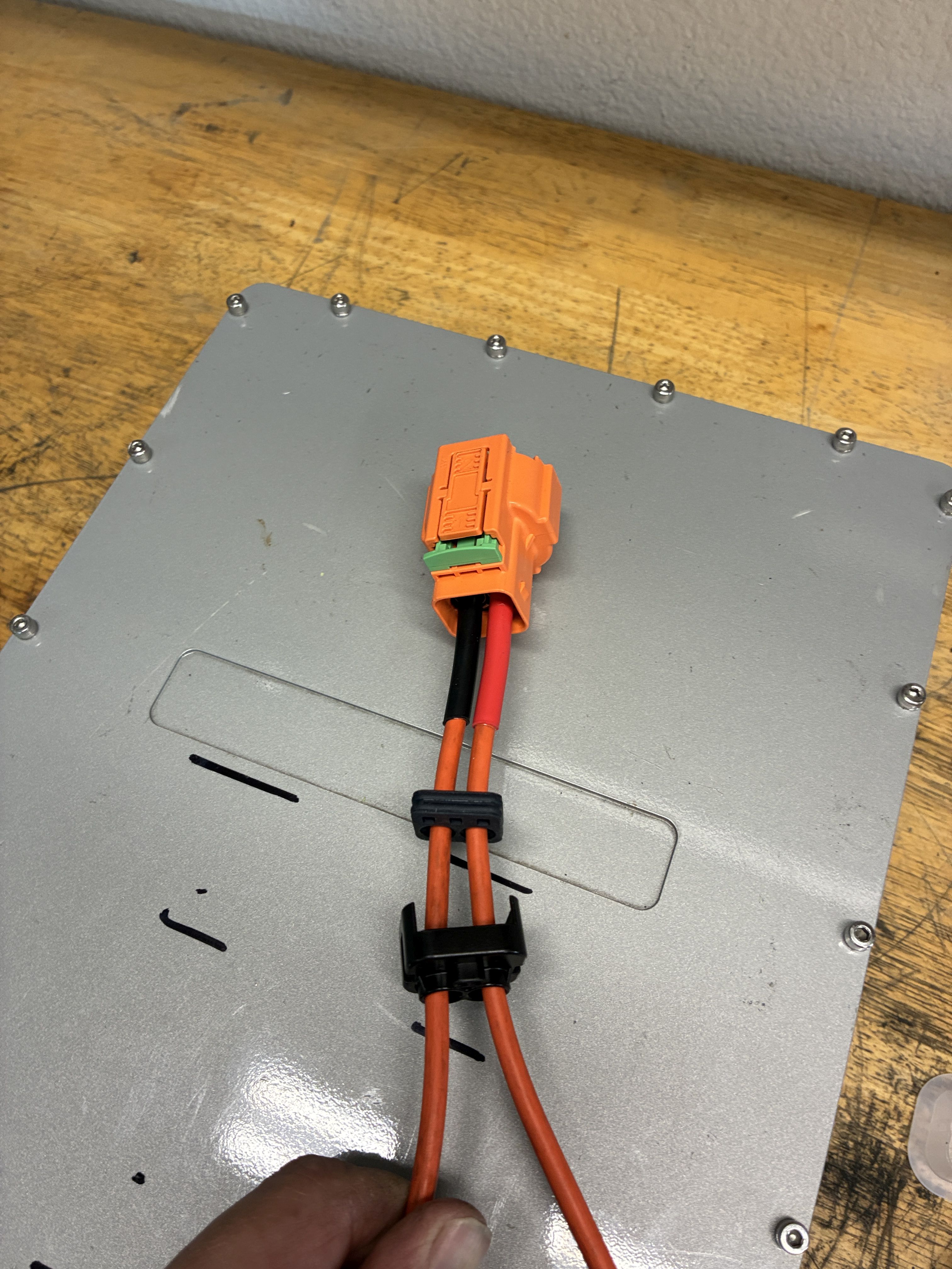

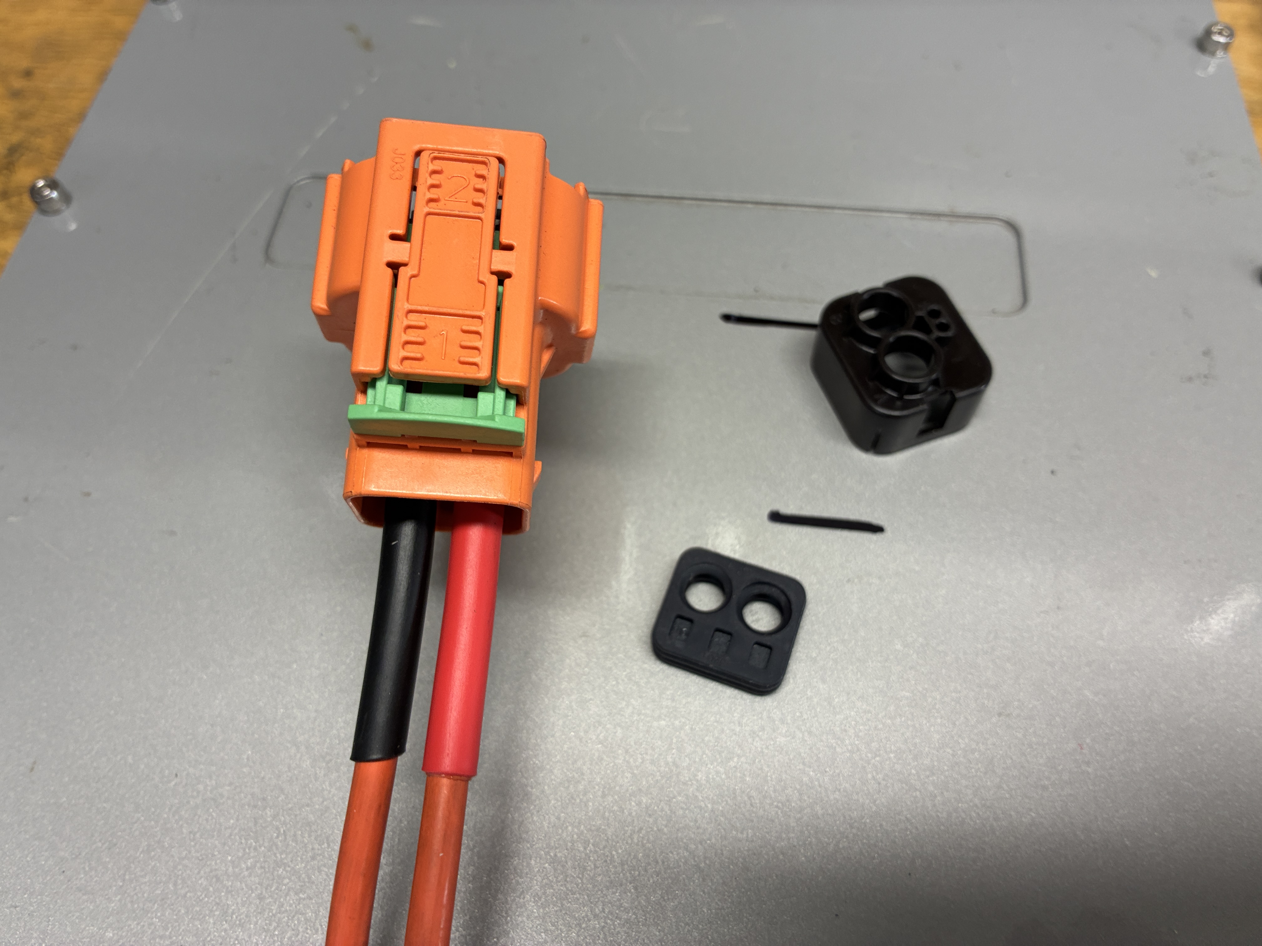

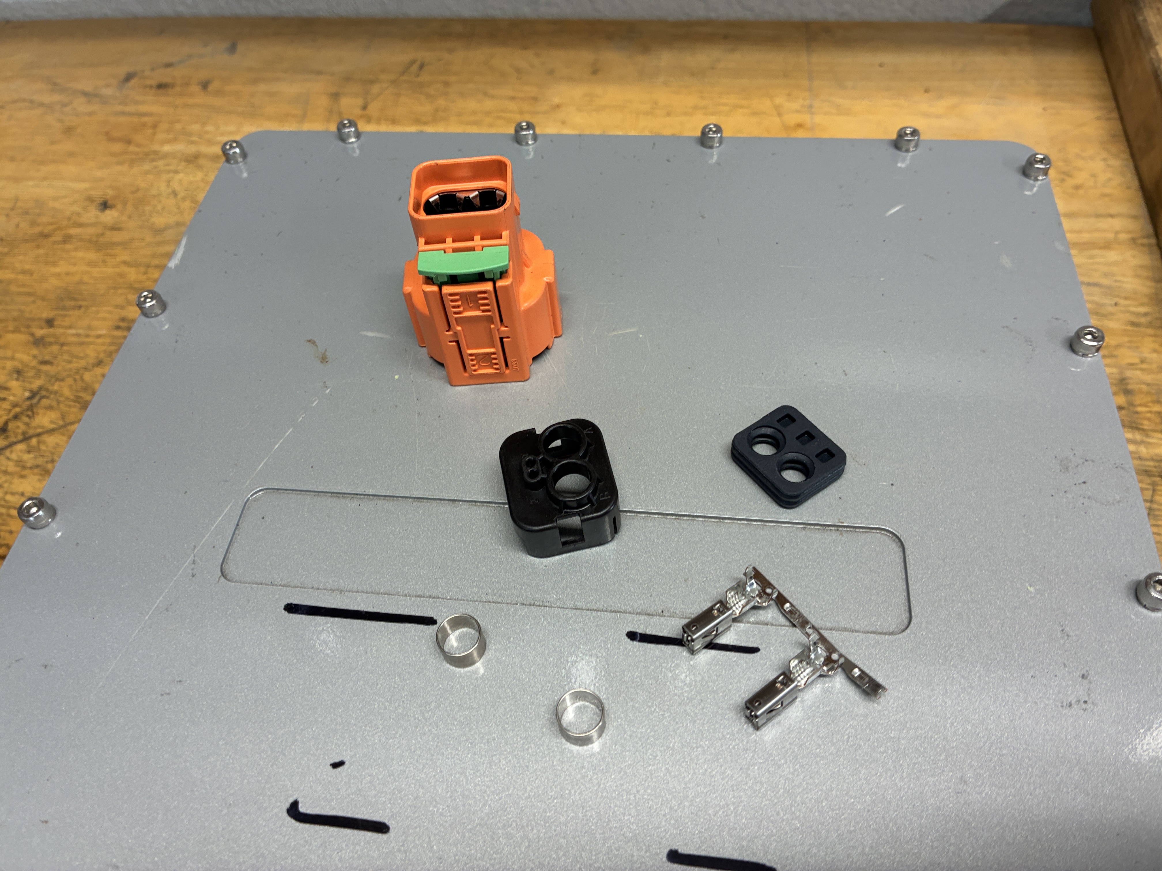

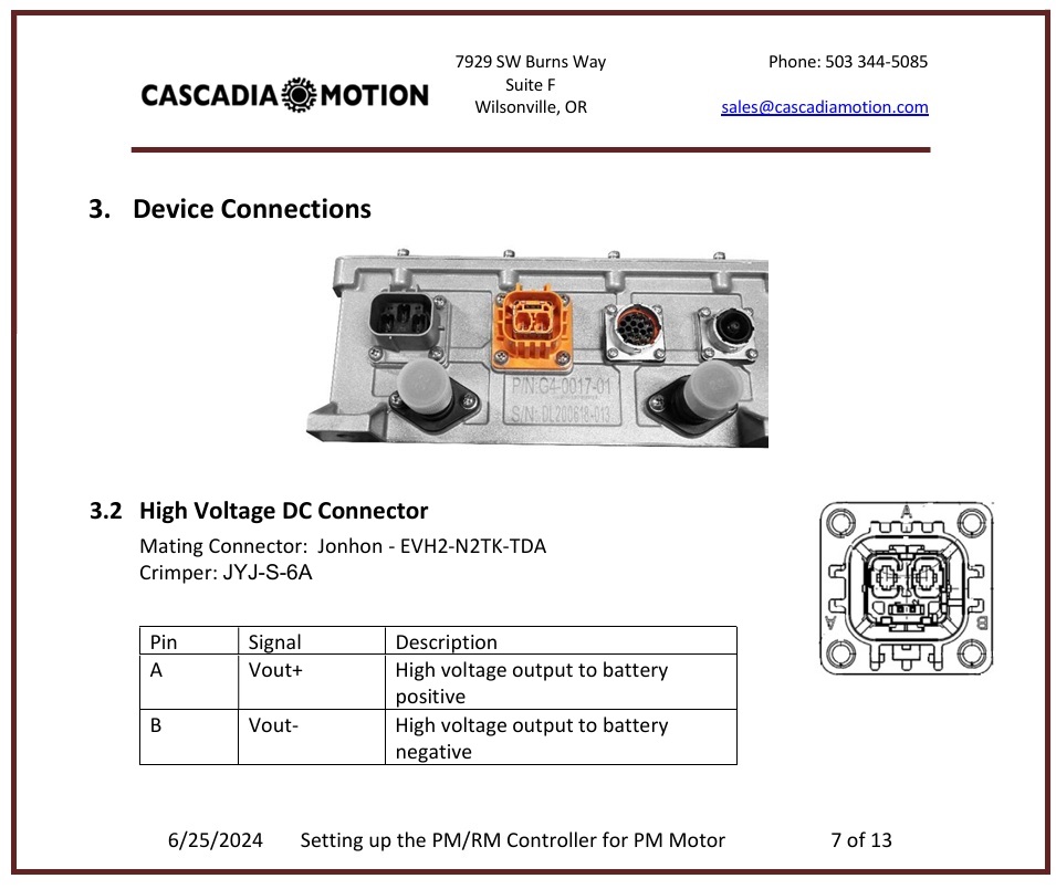

then I made the high voltage DC battery cable

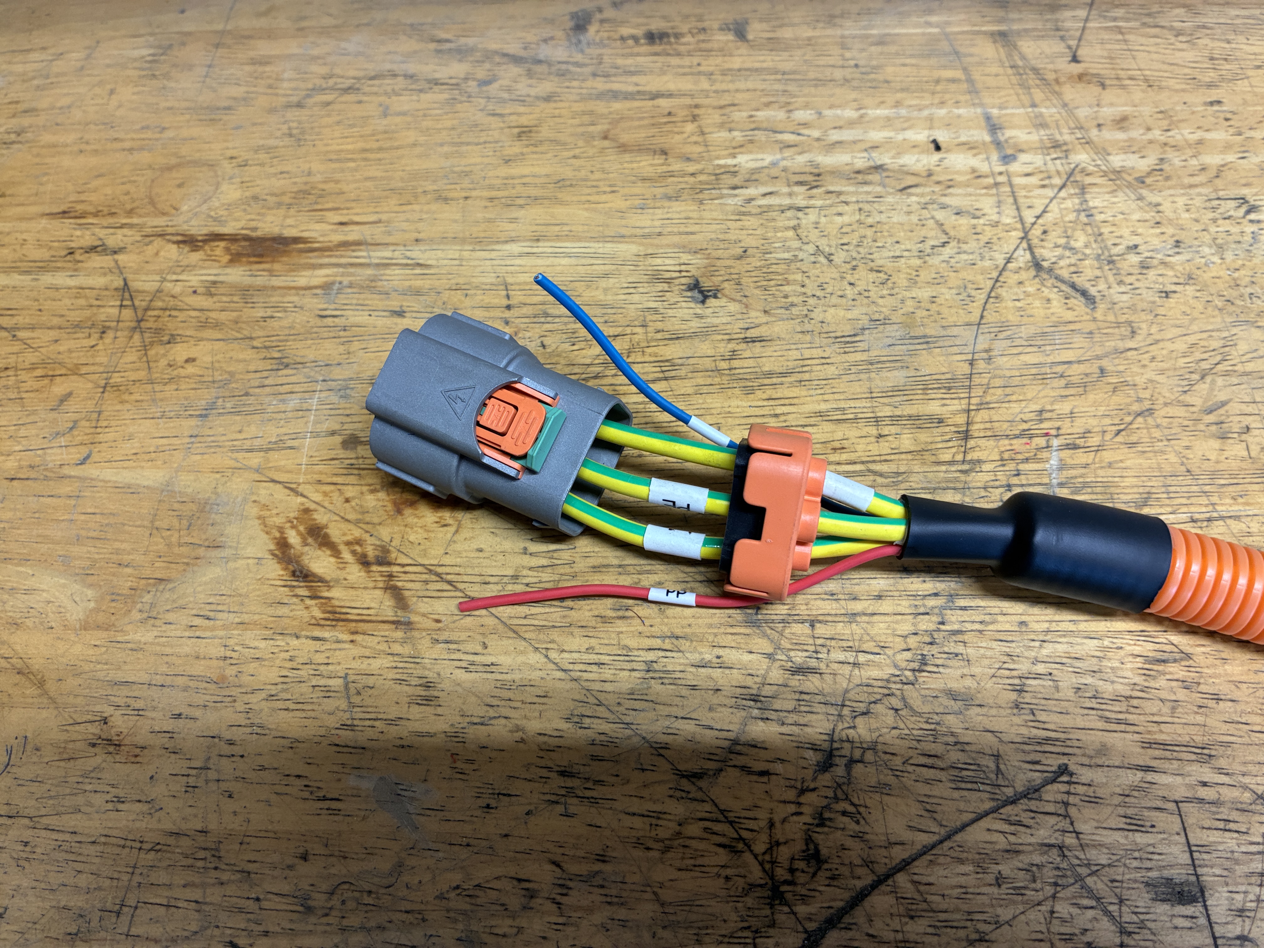

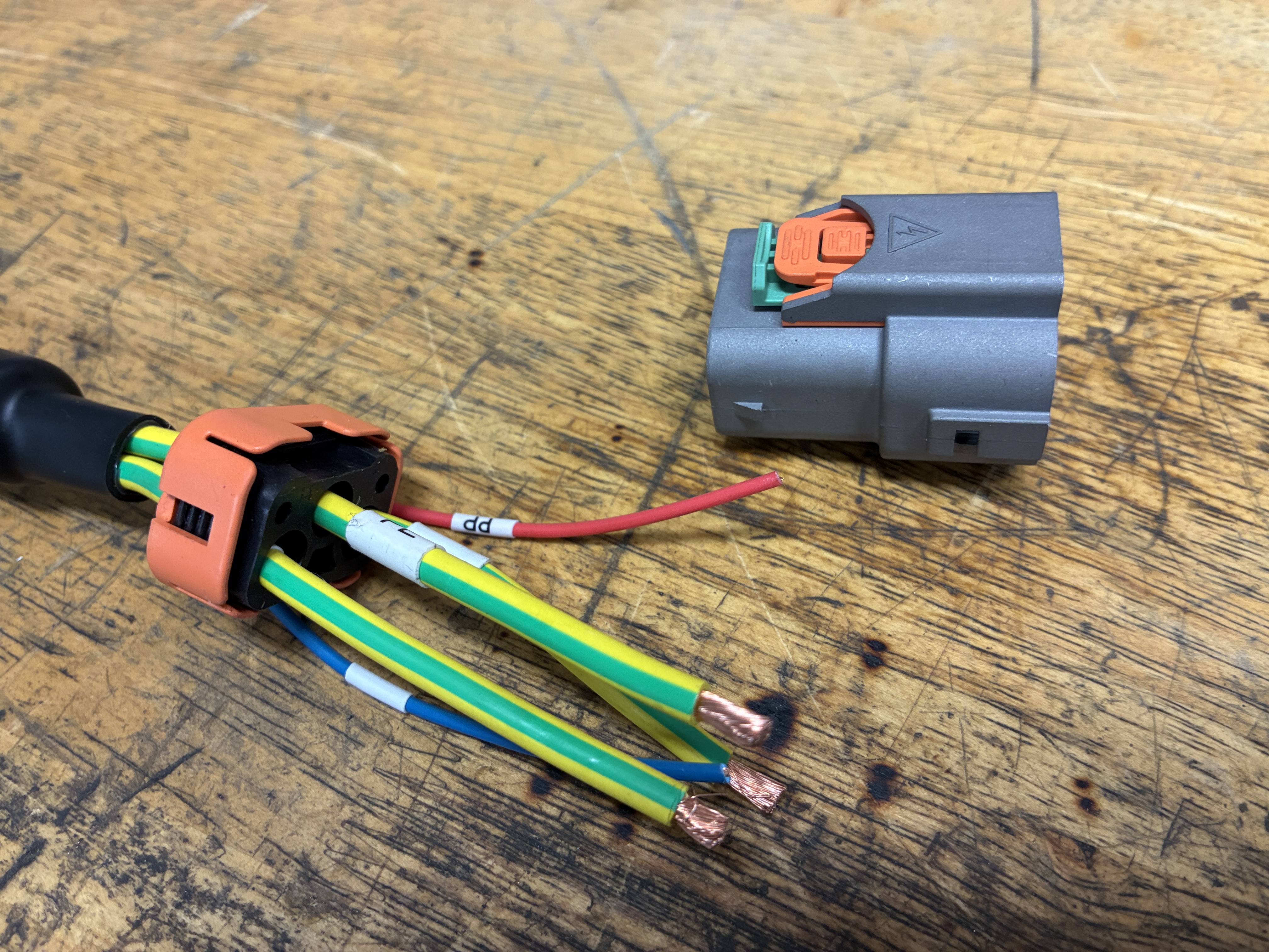

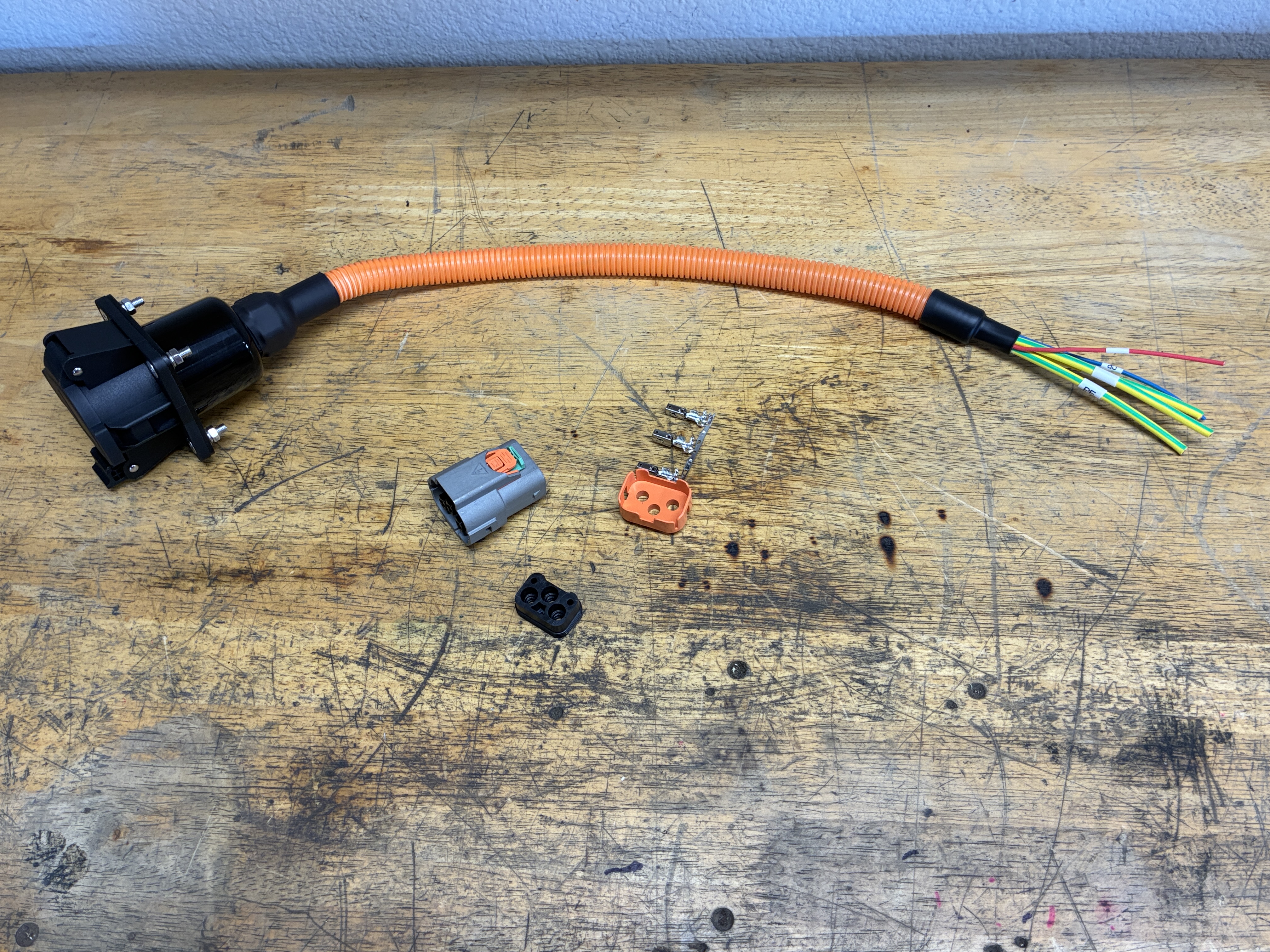

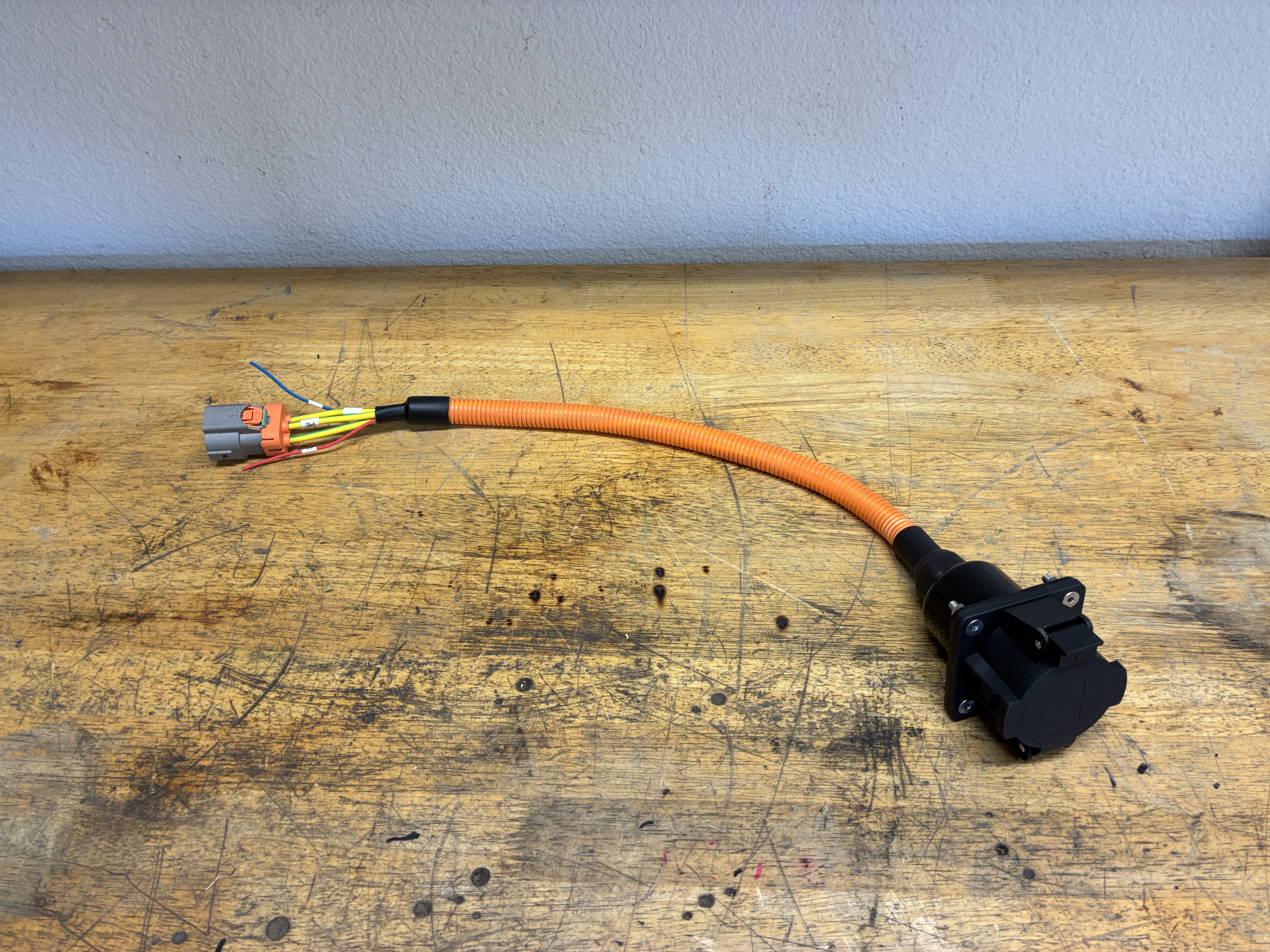

Alternating Current AC Input Connector
for this one I will be using my Walmart receptacle (I know, it has to be good)
J1772 Receptacle Walmart.jpg (25.69 KiB) Viewed 158 times
if wiring an already attached J1772 receptacle on the other end, make sure to first slip on these end caps before crimping the pins on the wire
it appears they don't use the Control Pilot and Proximity Pilot signals ???

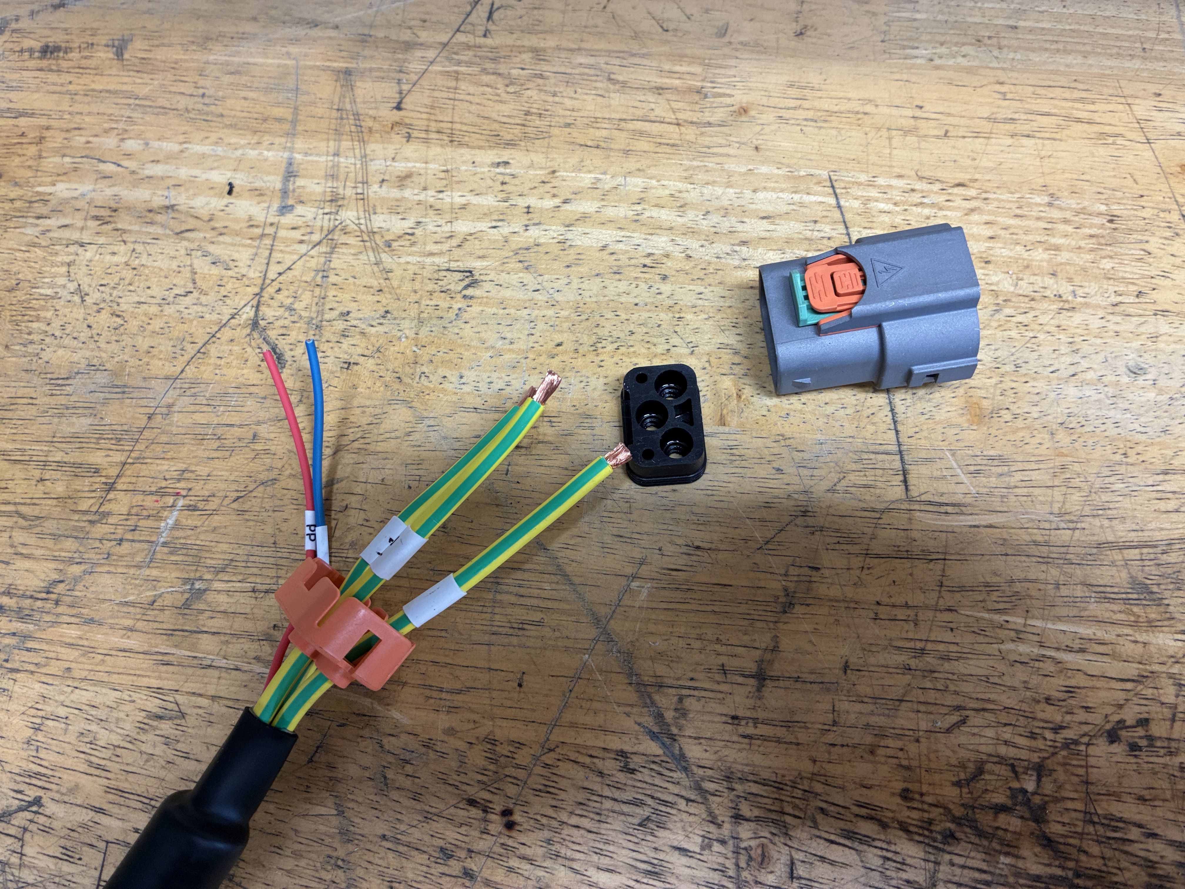

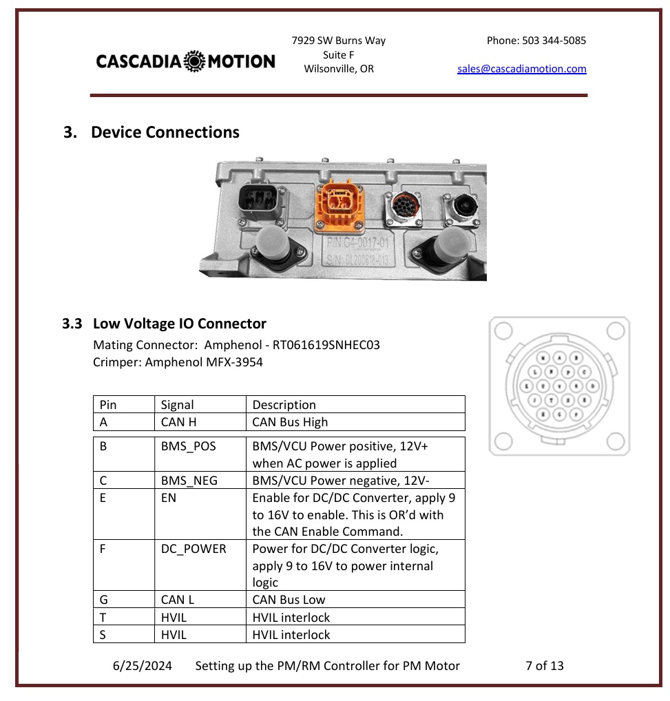

Low Voltage IO Connector
