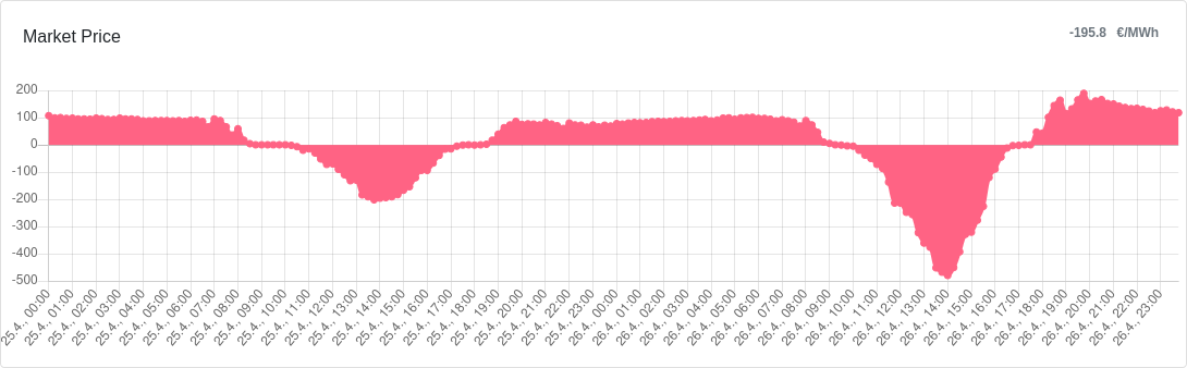

Prices are going crazy, look at this:
You actually get PAID to use electricity, so much even that it outweighs the various fees (16 ct around here). Thought I'd charge the car today, then saw tomorrows prices, where I'll get payed 35 ct/kWh to use up the surplus.
Sad part: look at the evening prices when the stupid gas peakers need to kick in. We need grid scale batteries fast, that's 100% renewable solved in the sunny months.

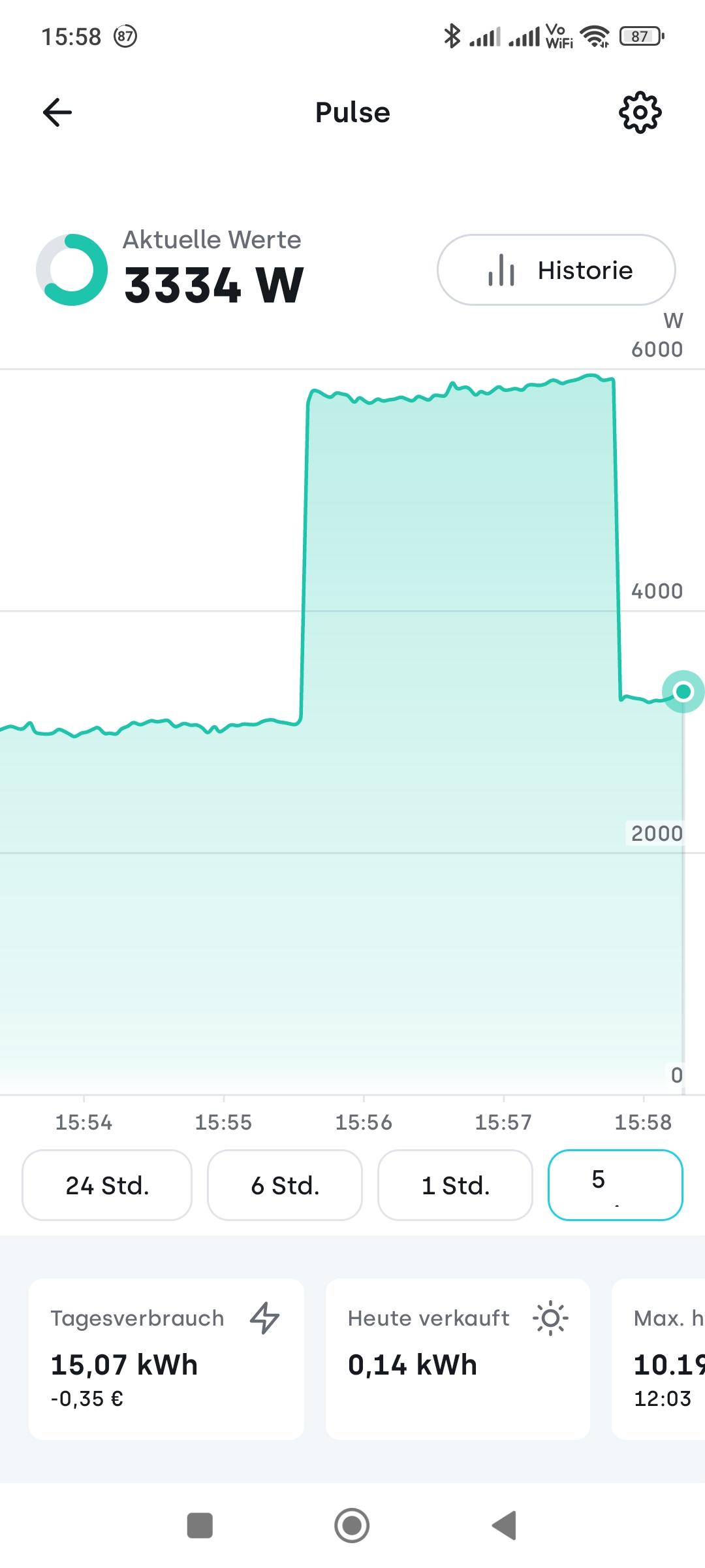

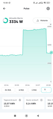

Only earned 35 ct today by using 15 kWh. My friends car was already full in the core time around 2 pm. Next time he must arrive at lower SoC :)
Others did a better job:

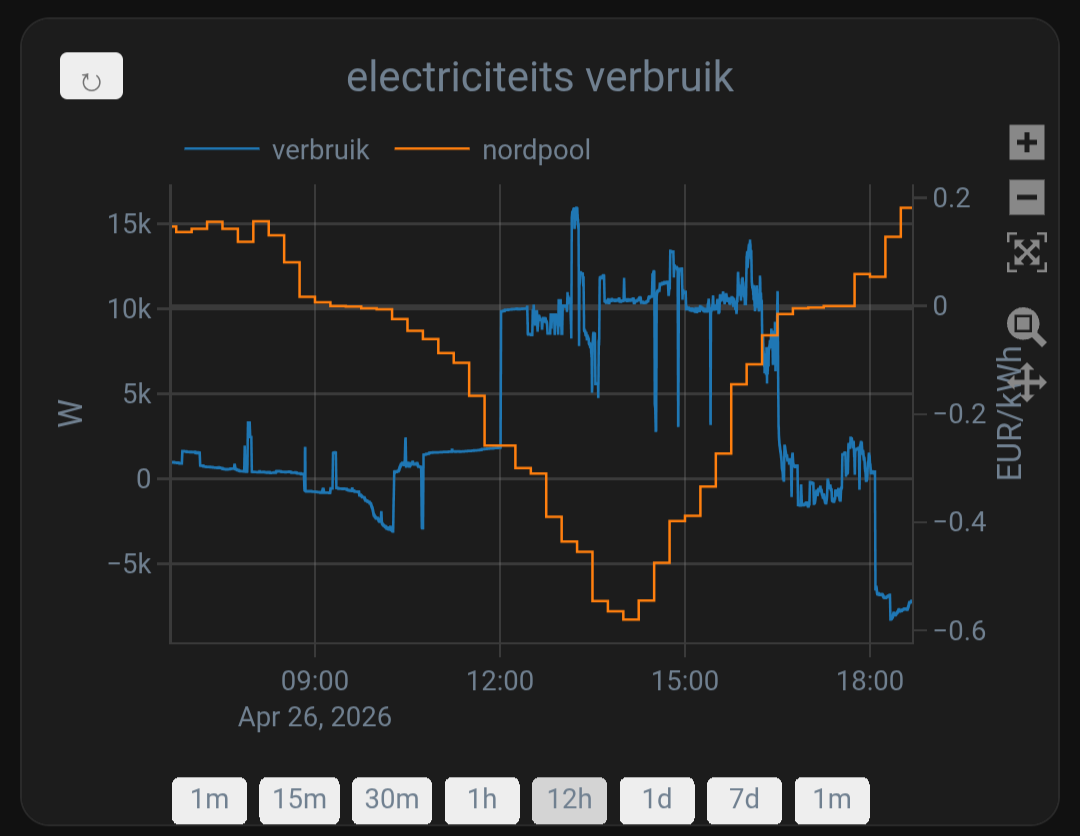

You can also turn off the solar panels, and consume as much as you can.
The Dutch energy prices were negatieve today als well. Therefore my home assistant turned of my solar system and we charged the ev, home battery.
Note: the energy prices stated here are before taxes.

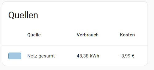

Managing to score a consumption of 70kwh today.
Getting payed about 10 euro or so for it.
