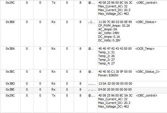

AZD
Posts: 9
Joined: Fri Apr 03, 2026 7:55 am
Re: MG Charger Hacking
Post by AZD »
LRBen wrote: Fri Apr 03, 2026 8:58 pm MG tend to iterate component quite rapidly it seems. What is the part number for the charger you have?
That issue is now sorted. The seller was under impression all Molex connectors are keyed and supplied the opne that fits from a different harness :roll:
The part number is ZS10BC6600A, the same exact charger seen on Damien's bench.
I am now a little stuck with trying to make the charger, erm, charge.
Once CP is grounded via 1kOhm, which is odd by itself, I do get AC and CP shown. Removing resistor send the CP voltage back from circa 3 to 6 volts and AC load dissapears. And that's how far I managed to get so far.

Did you look at the info on the wiki https://openinverter.org/wiki/MG_ZS_Charger
I don't know what your setup is like. But the charger needs a CP signal and the 0x29C can message to work. And the other connections in the wiki.
Here is a DBC file to see the values sent by the charger. Just change the .txt to .dbc
MG_VZ charger.txt
(4.71 KiB) Downloaded 10 times

Thank you for your input. Is it now accepted the top 1mm pin in AC Aptiv connector is another HV interlock? Damien is referring to that pin as a weird one, very likely some sort of PP wire.
My setup is exactly the same as Damien's.
I am not a CAN savvy to my great shame, and I was able to send some attached trace commands manually from Kangaroo soft no to avail.
I'm now trying to sort out a SavvyCan to try sending some logs to see what happens.
Test_trace.txt
test ASC file
(8.35 KiB) Downloaded 8 times

The HV interlock (might also be a PP passthrough) on the AC connector is connected to the LV connector (pin 11). it's not important. I will fix the wiki.
You have the HV interlock on the DC connector shorted?
your test file look good.
AC max current = 32A
DC max current = 2A
DC max voltage = 462V

Got it, thank you. I will make that PP/HVIL redundant. My original wake up wire seems to be not needed too.
Yes, I have a jumper on DC connector. I am just trying desperately to see the load on my DC circuit made of two bulbs and a capacitor from my dead DMOC before bolt the chrger to the car.
I just have unpacked a Canable dongle that works with SavvyCan and even managed to get on the bus somehow. But this is where my knowledge ends. Will need a few month to figure out how it works.
I probably need someone on paid basis to get on my PC via remote desktop to run all CAN voodoo stuff

Not sure it will work without the charger seeing voltage on the DC connector
  • PSA battery (50kWh)
  • Zombie VCU

Post by AZD »
manny wrote: Mon Apr 27, 2026 4:37 pm The HV interlock (might also be a PP passthrough) on the AC connector is connected to the LV connector (pin 11). it's not important. I will fix the wiki.
DC max current = 2A
Well, that would be too good to be true.
A real picture looks like this after feeding Damien's 29C CSV to CAN.
Perhaps you were not wrong saying it wants some DC unlike my old dead Brusa charger
Savvy traces

I was unable to find a list of DTC's for the MG ZS. But for the MG4 there are documents that describe all DTC's and the conditions to set and clear them. The DC output range of the MG4 charger is 220V to 490V a DTC is set when the voltage is outside of 210V to 500V.
The MG ZS charger is from the same family, so I assume that it needs minimum of 220V and max of 490V since the spec of the charger is 230V to 480V.

Thank you.
I will try using my 12-240v inverter and a diode bridge to try to simulate the 300V DC load. Let's see what happens :idea:
